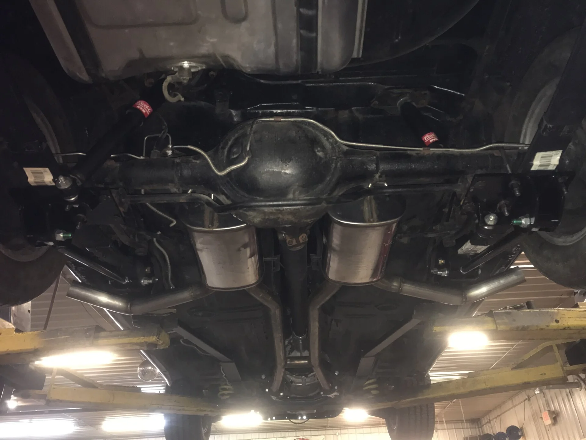

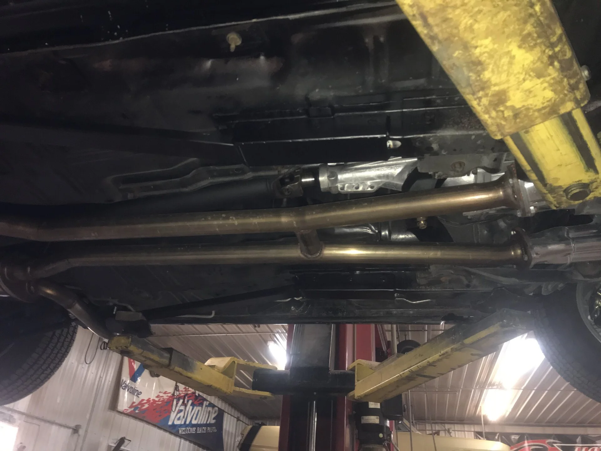

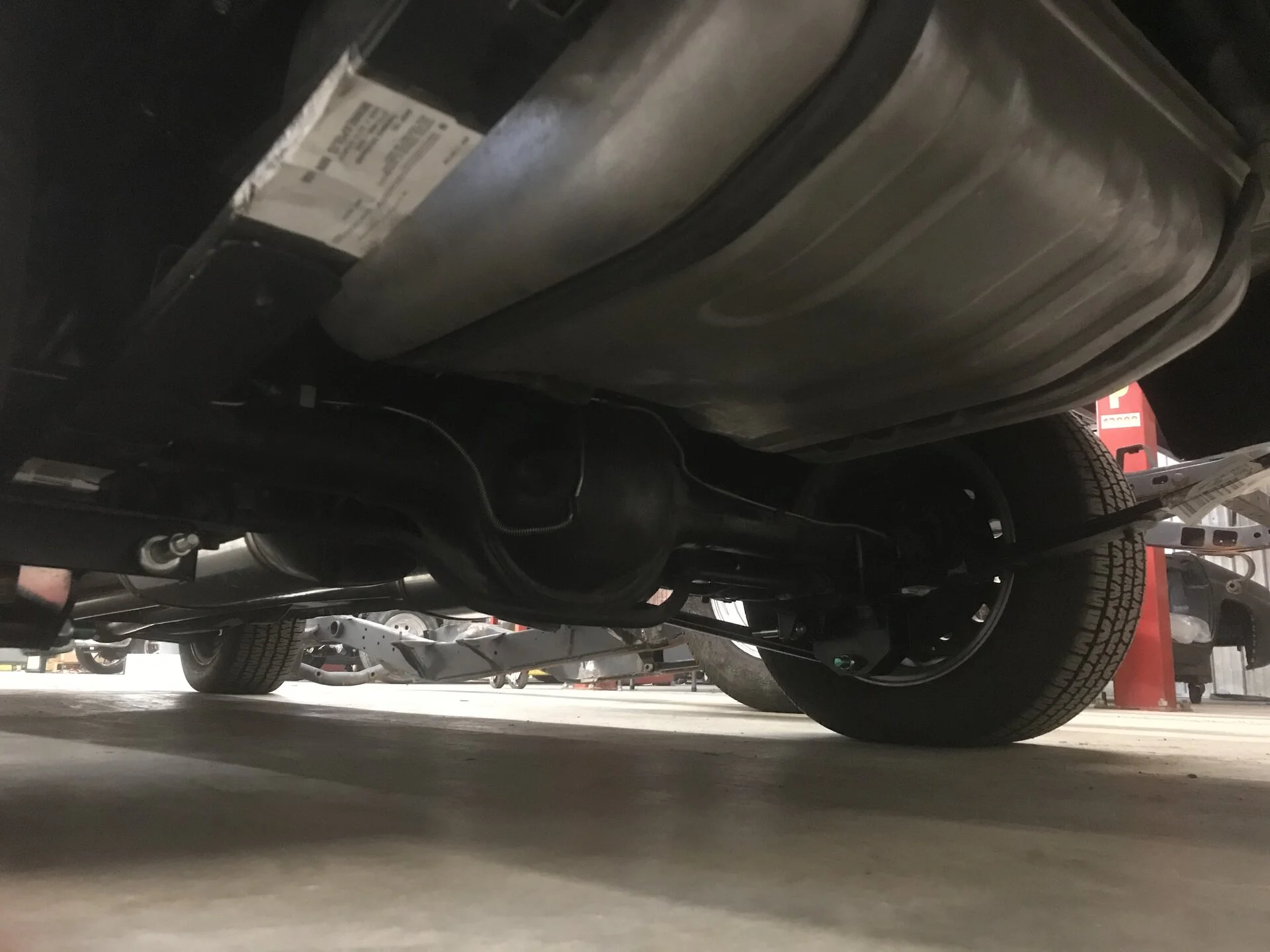

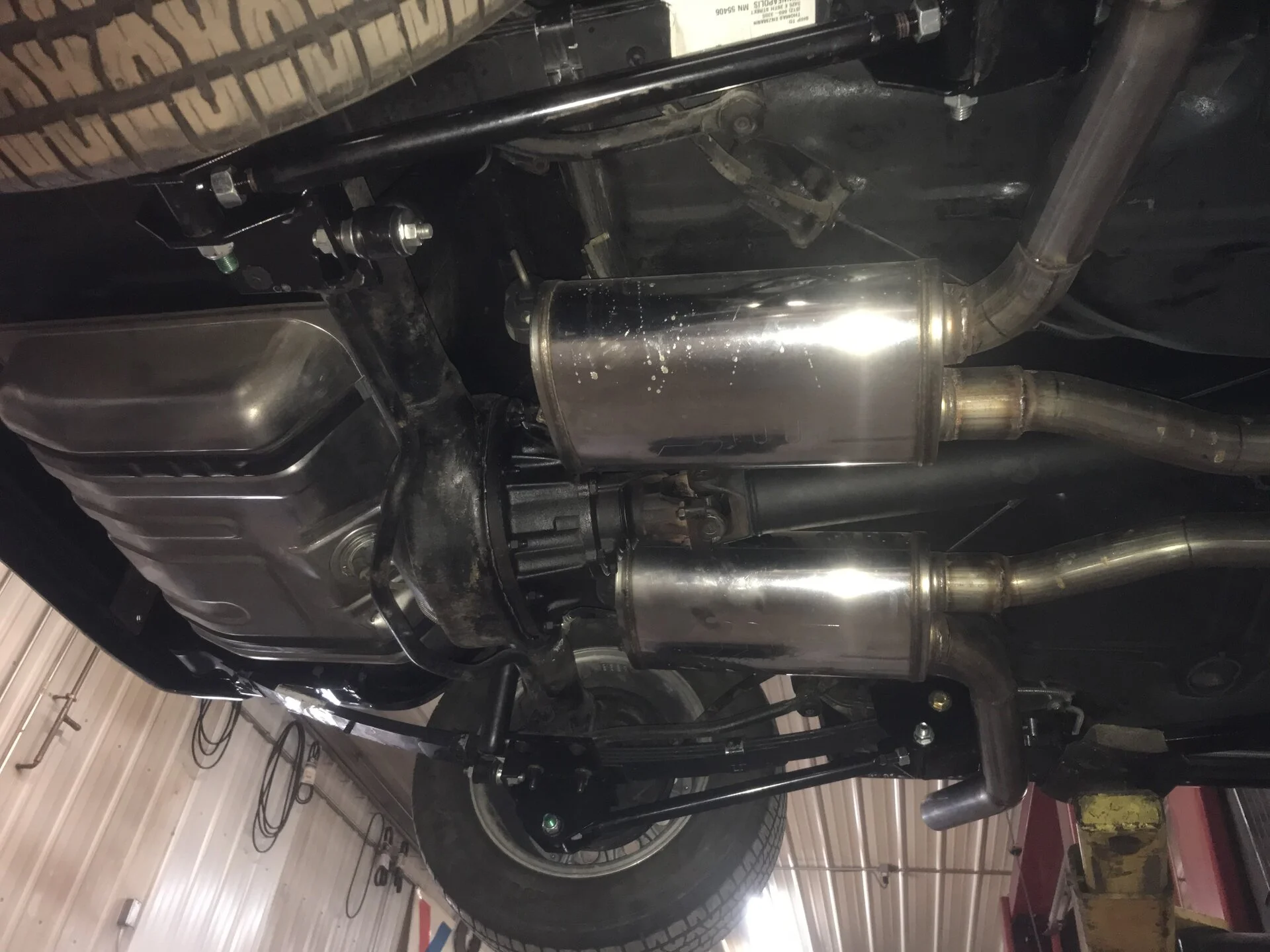

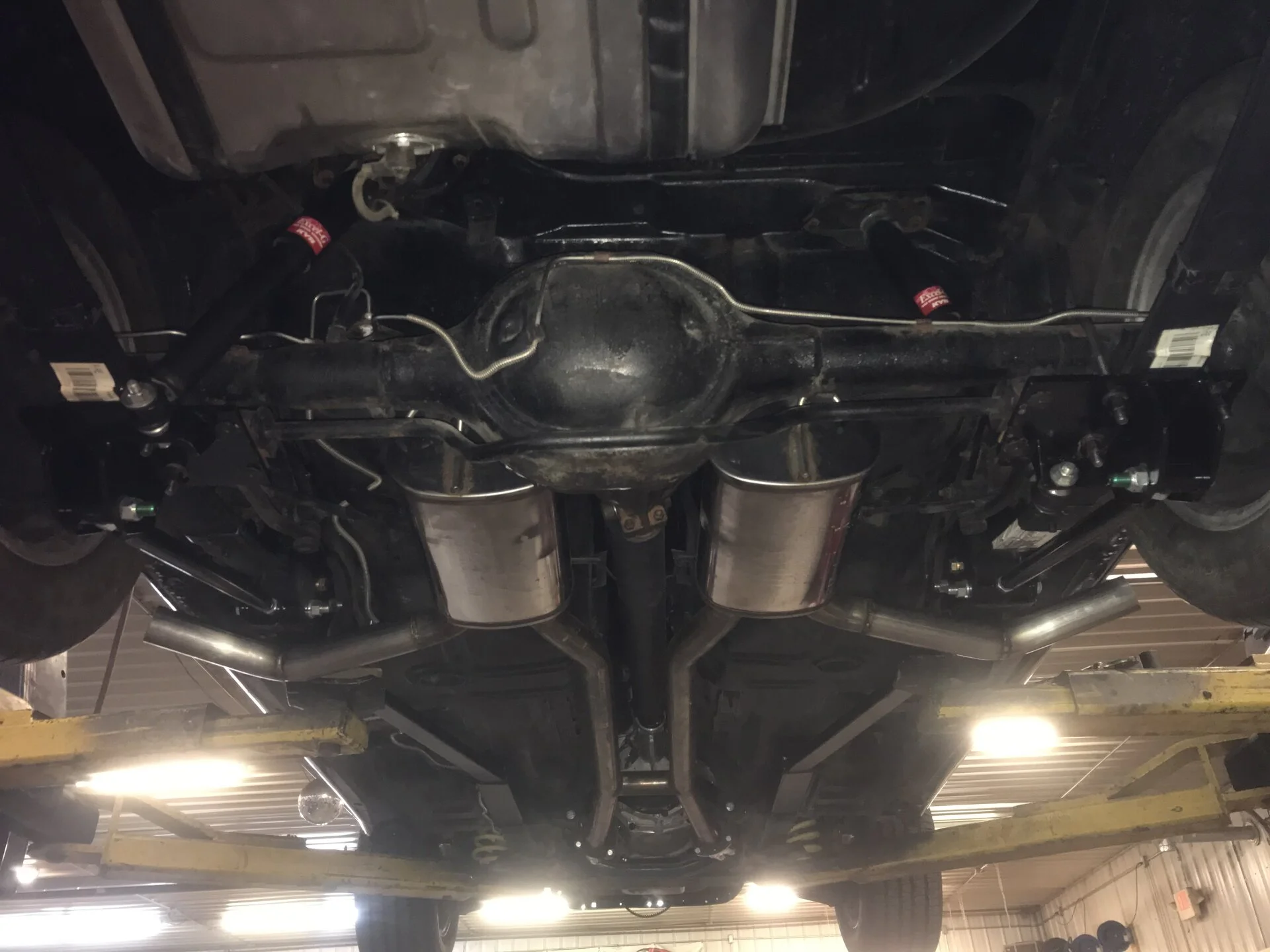

Nice pictures Enzio. I zeroed in on the great underside. Like the cleanliness, and lack of rust for a Mustang Two. The mufflers are very cool. If it was mine I would do the same thing. I hope your tips have something to them so they shine a little. Soon you will be driving that on a spring day listening to a nice 302.
Reactions: Enzio

Shocks, springs, Stumpy's bars, bad arse side-exhaust all tucked up nice and tight ready to annoy the neighbors!
And More! Heck ya! We Wondered what they was doing while you were playing in the woods, but they seem to be earning their pay in earnest.
The underside is the only thing I did not have anything done. I spent a lot of time on it about 25 years ago.
Thanks by the way.
