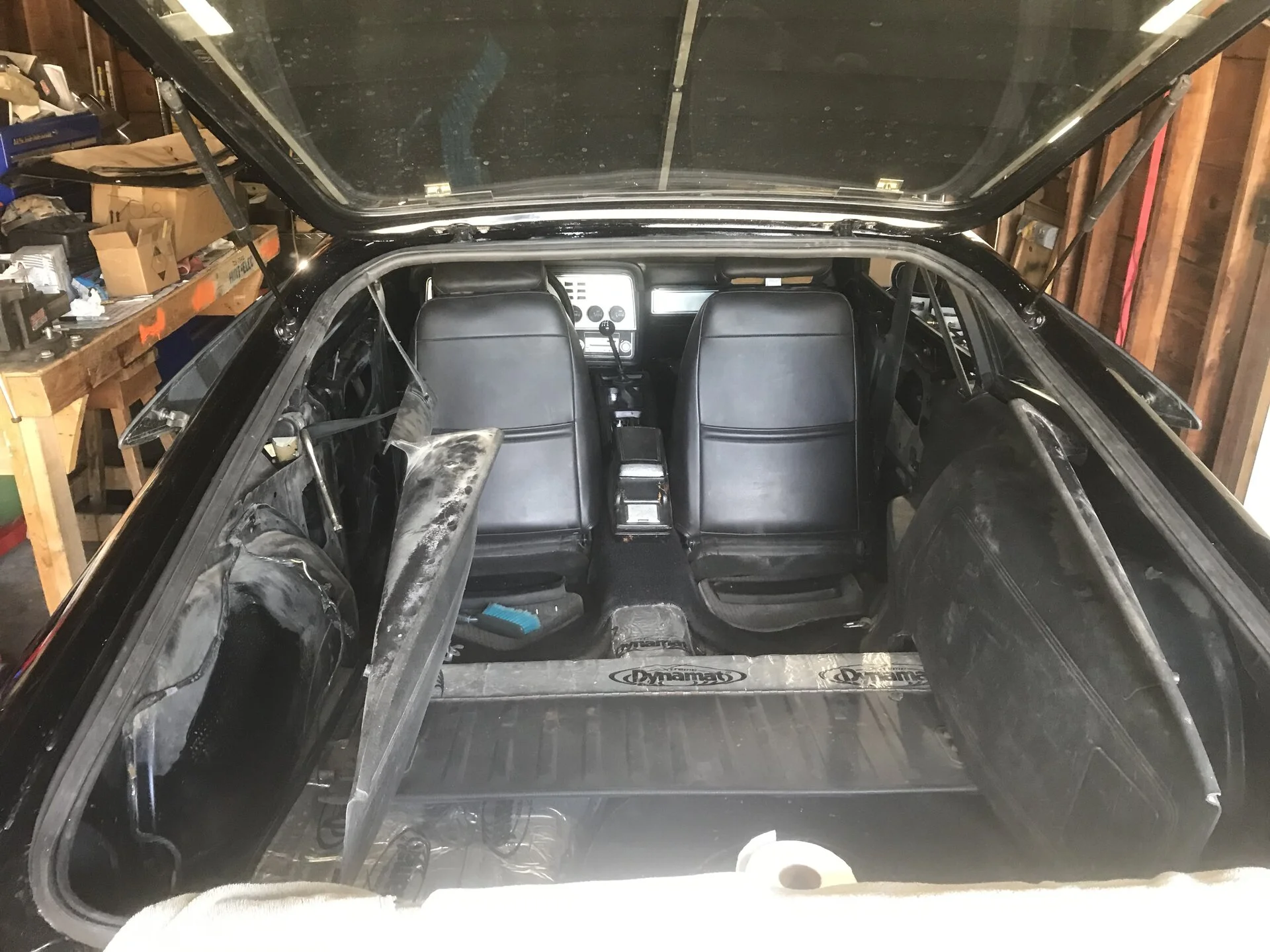

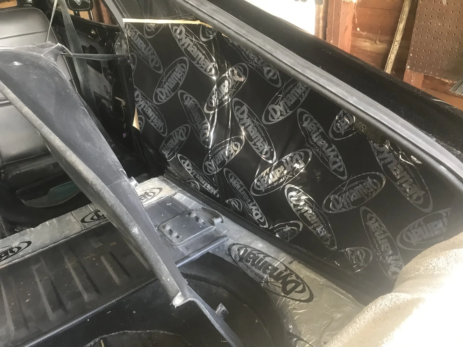

Worked on Dynamat yesterday and today. Still more to go on the doors.

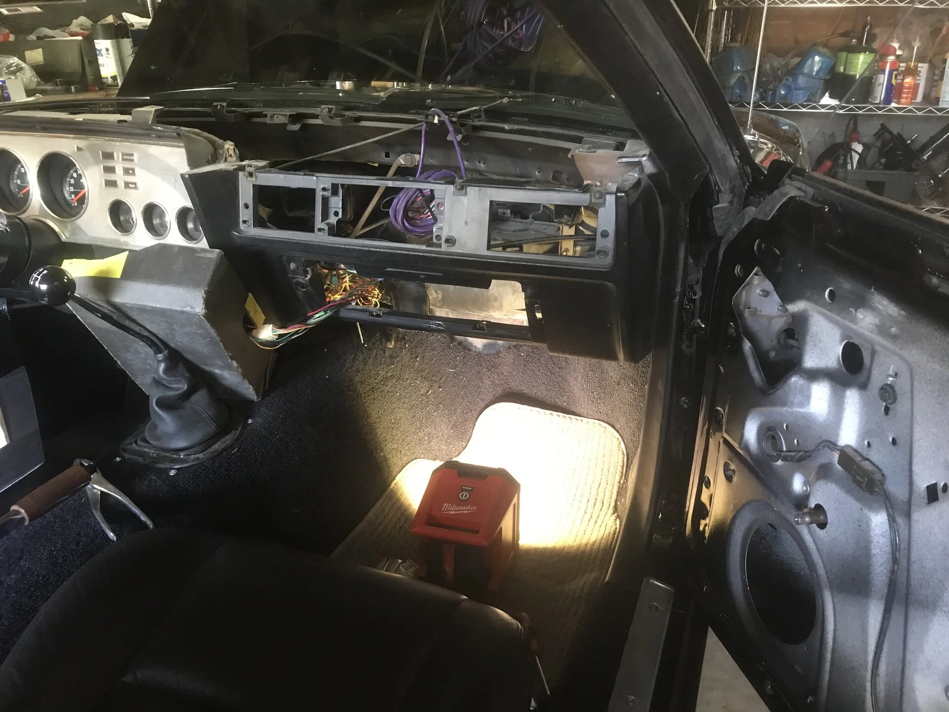

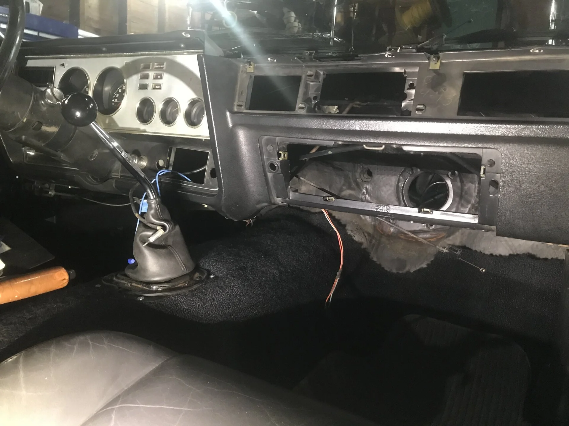

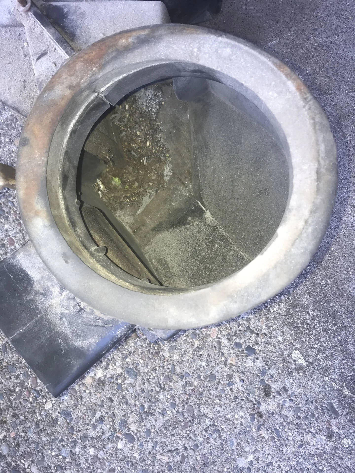

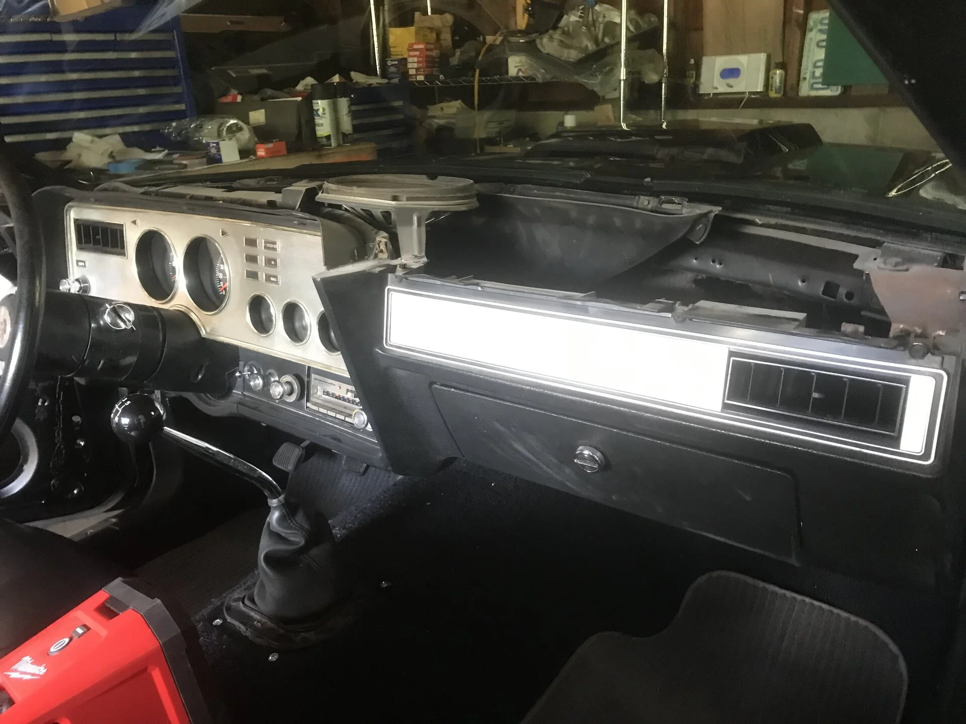

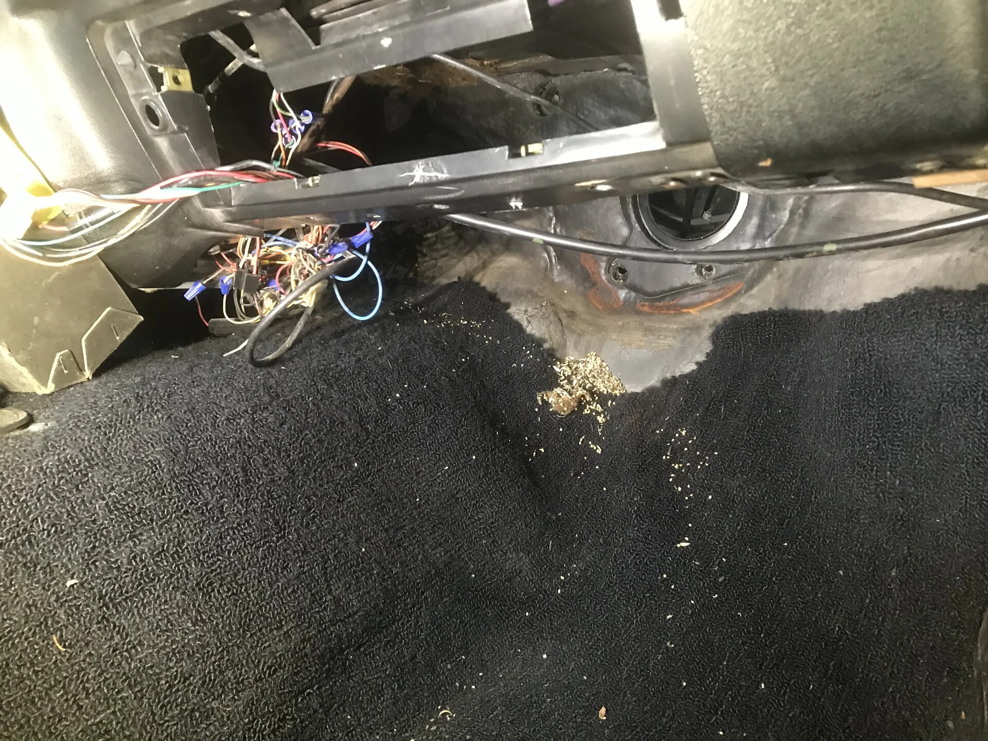

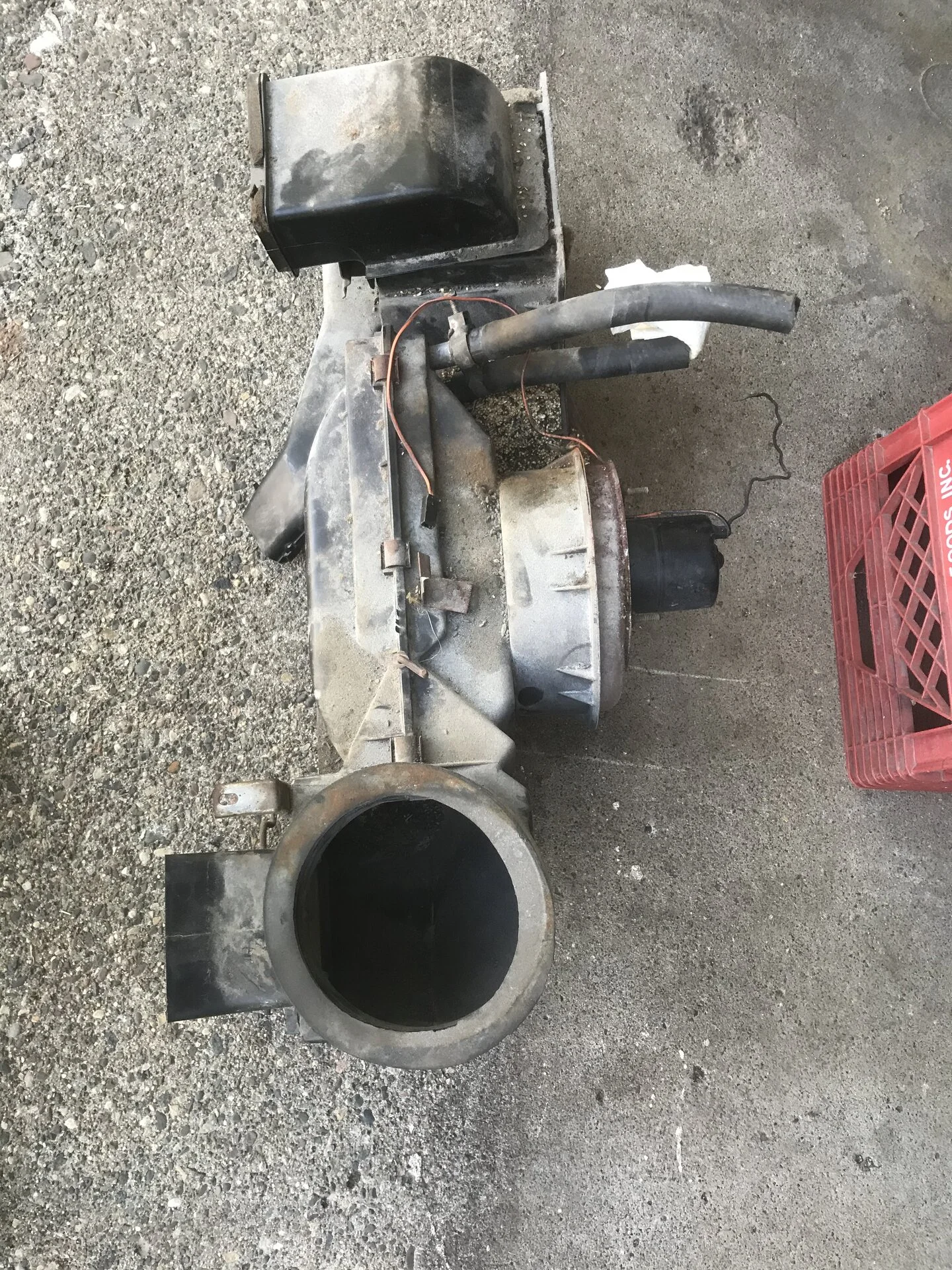

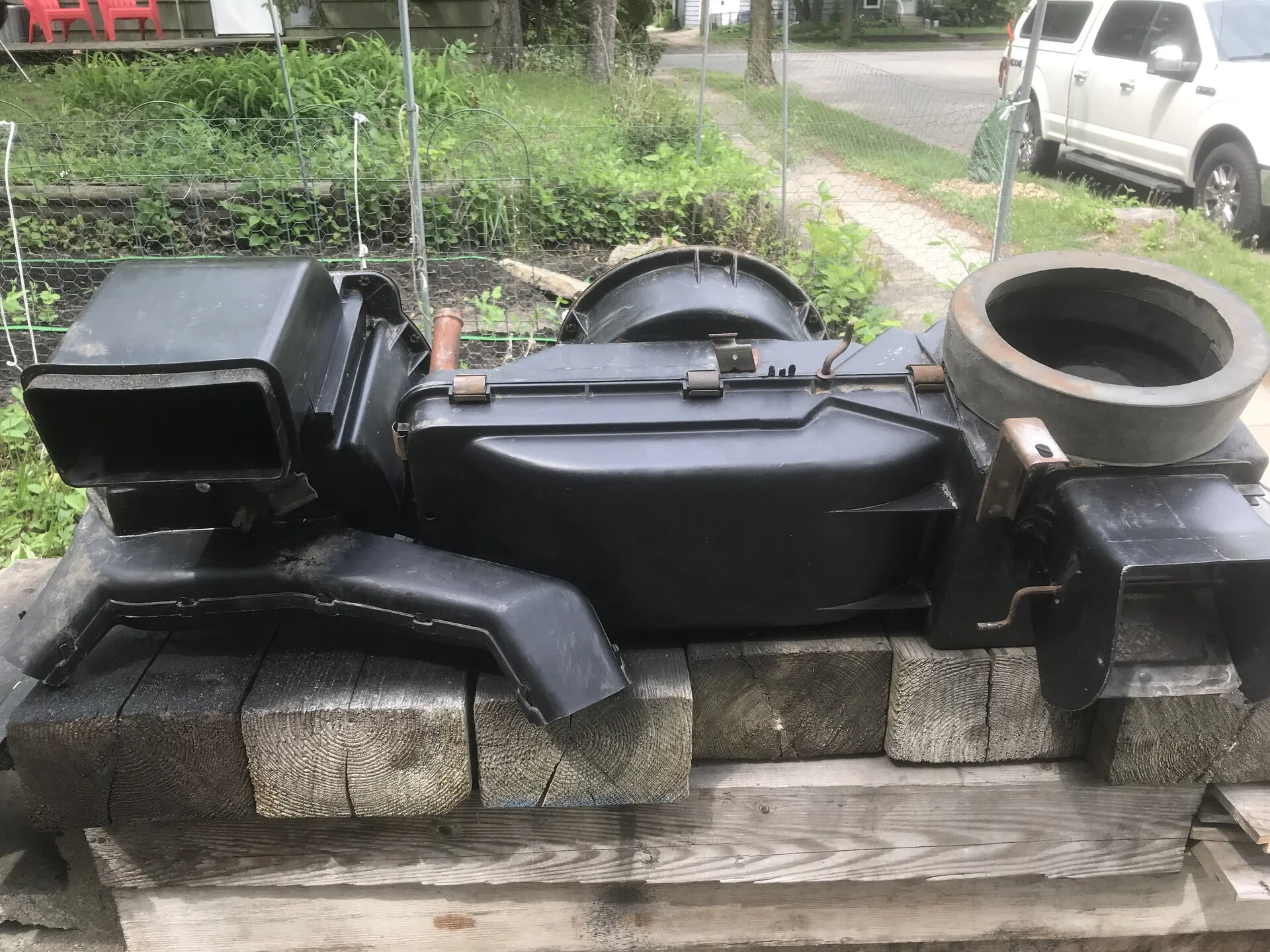

Tore the dash apart to get after the heater core. (The last time I did this my father was there to help...get more beer.) Here's what that mess looks like.
Yes there's a massive mouse nest.
So I'll replace the blower motor and clean everything up. But not tomorrow. I'm going to relax by discharging firearms.

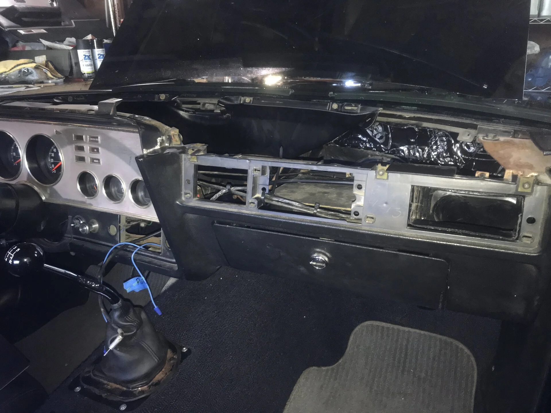

Did well today. Removed the old heater core and got the new one in the heater box. Everything went pretty well except drilling out the old pop rivets. Now I'm waiting for the replacement blower motor.
Now to take care of this mess!
I call this progress...
You were able to get it out without removing the dash?! I've only had mine out when I tore my car completely down, but good to see it can be done without tearing everything apart.
Yes. This is the third time I've done it. And, I think it was the easiest. The trick is to place some plastic in the passenger well to catch the antifreeze left in the core itself. (and most of the mouse crap)

Heater core is back in. It went well. Before I put it in I tore out all the old insulation I could reach and covered it with Dynomat. I'm still working on the dash pad and other stuff.

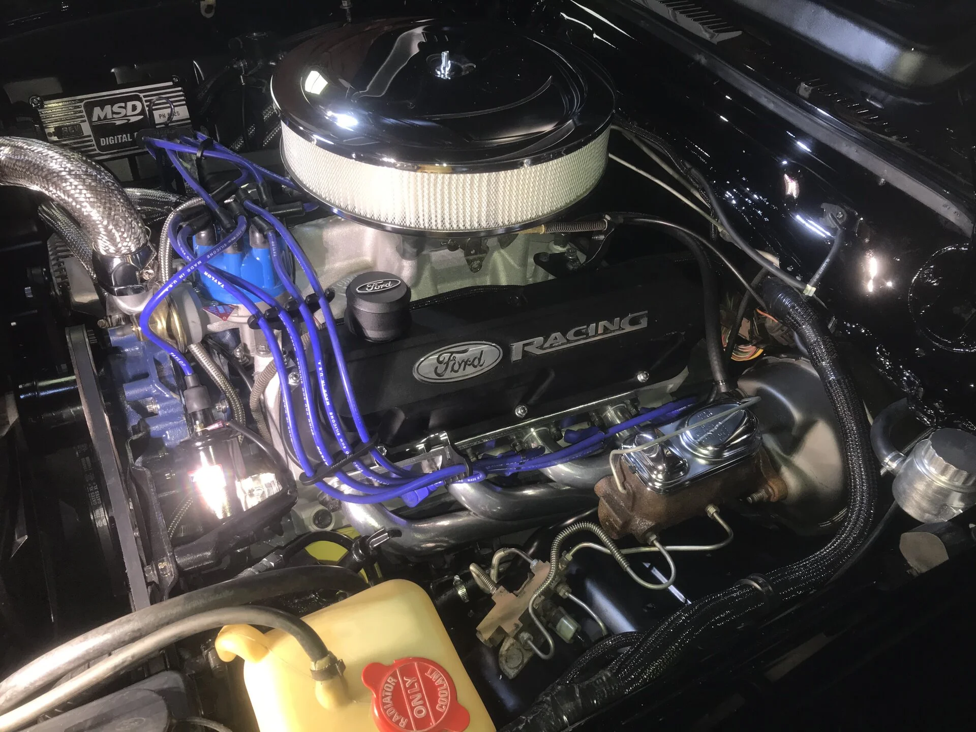

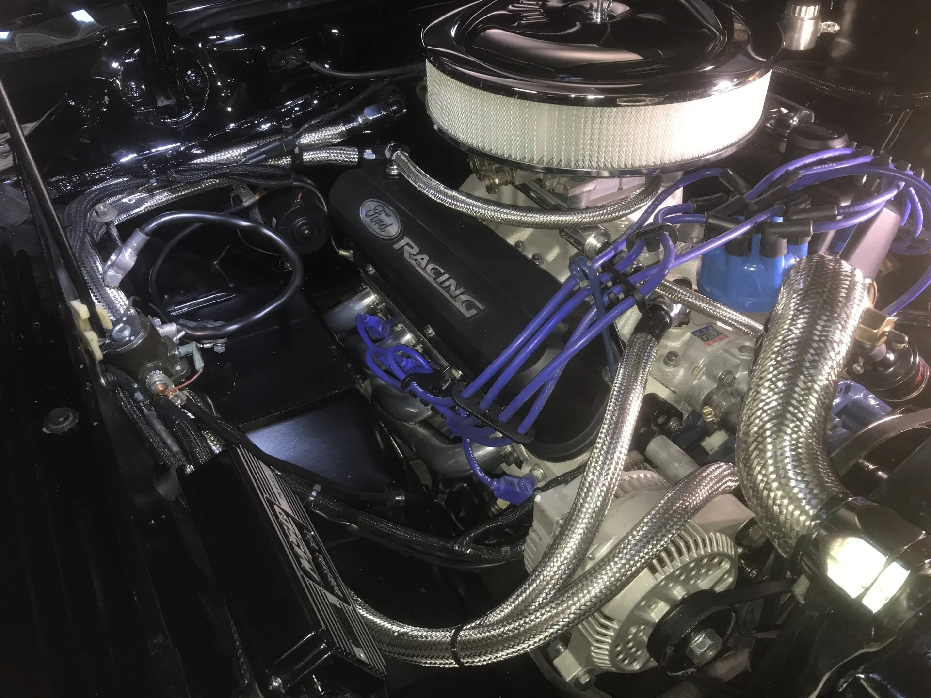

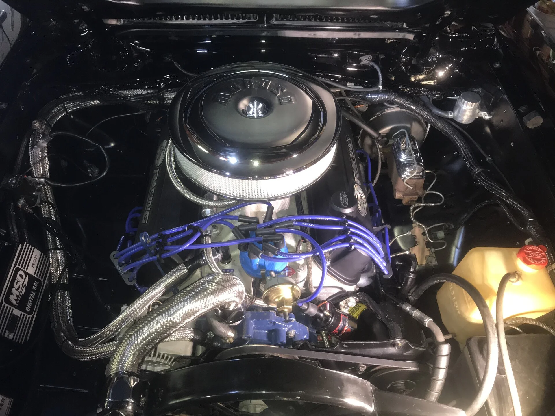

Yesterday I replaced the heater hoses and today I cleaned up the engine bay. It is cleaner now than ever before and probably cleaner than it'll ever be again. I still have some stuff to do but this is where it's at.

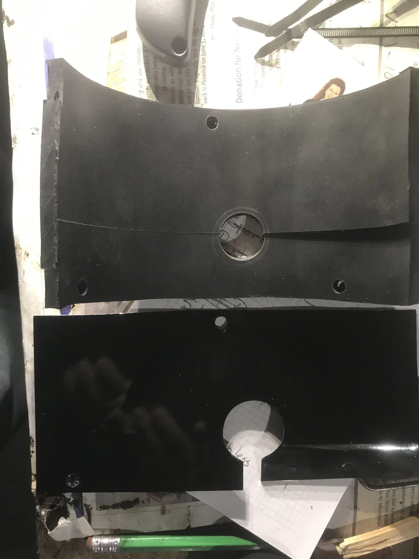

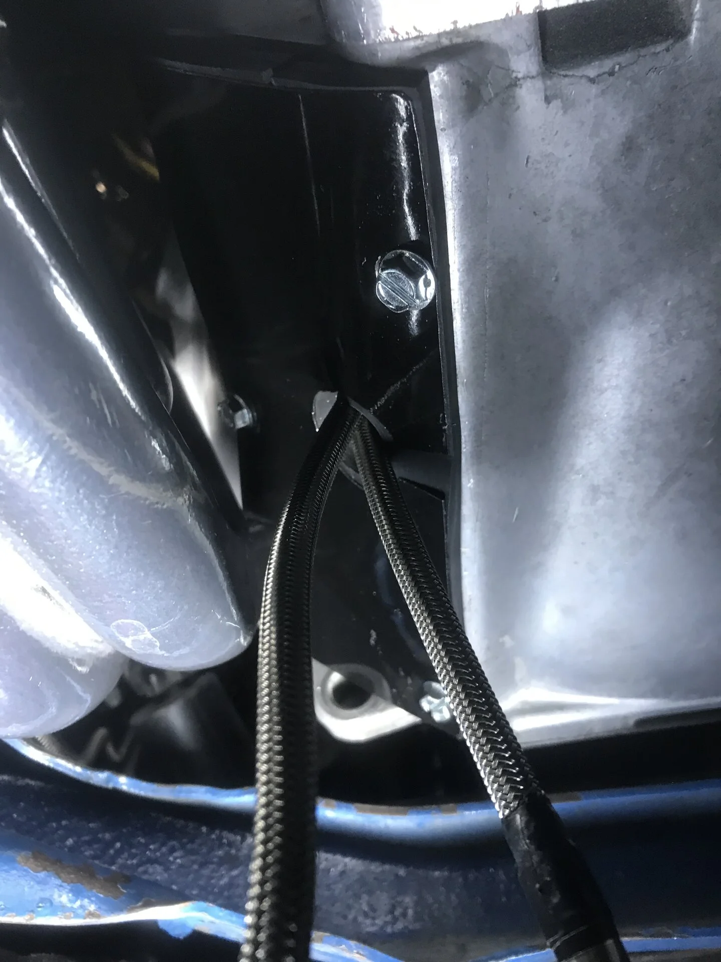

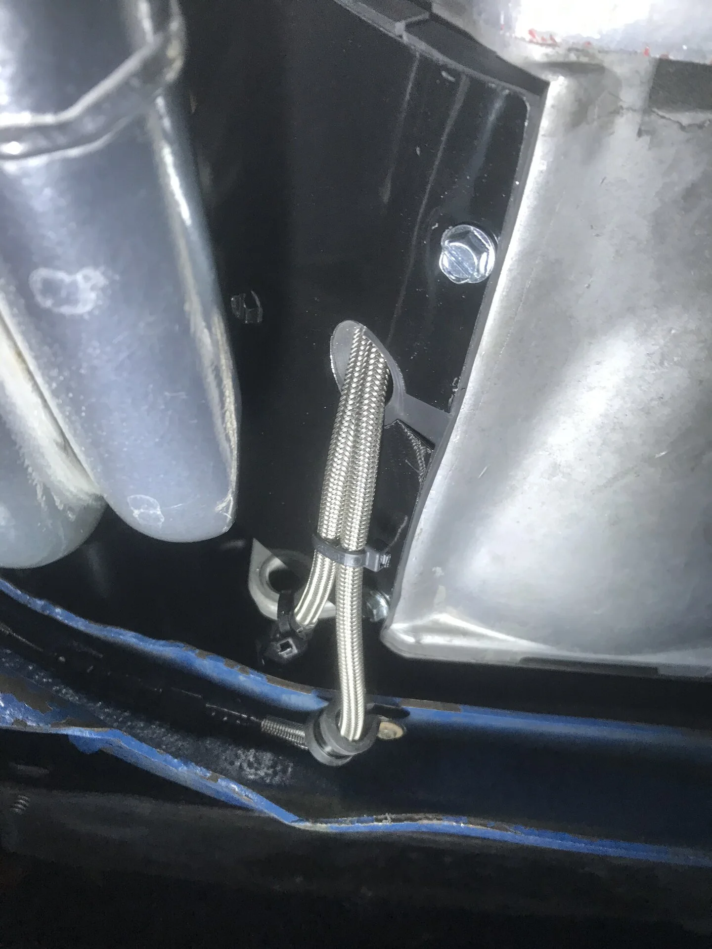

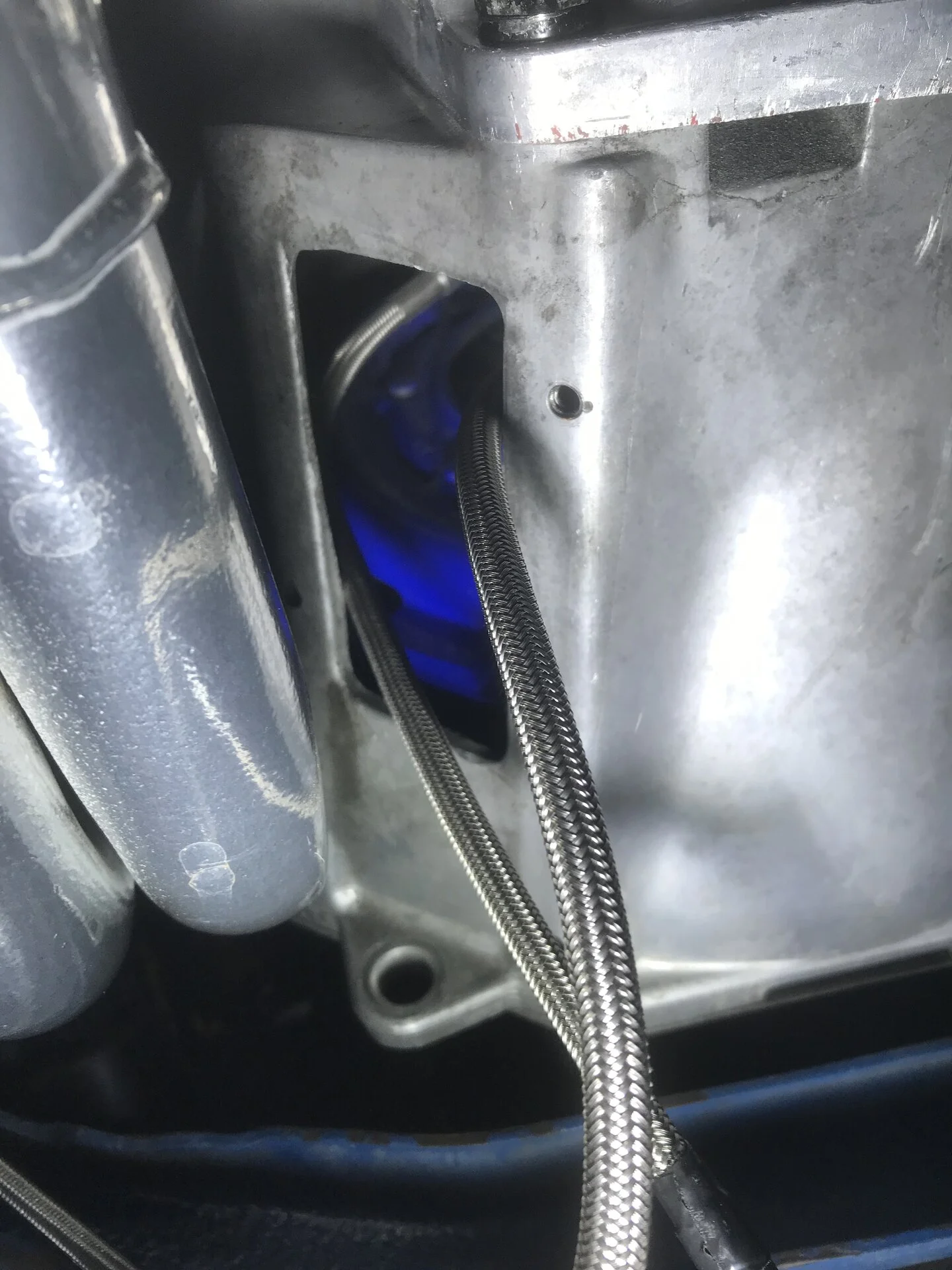

Man it's weird weather. High today of 46. Raining hard all day. I'm typing real slow cause my hands are cold. Anyway, I took care of a problem that's been bugging me for a long time. Because I've got a hydraulic clutch now I can finally close up the hole for the clutch fork. Here's what I started with.
So I went to the hardware store and bought a small piece of sheet steel, bent it close to what it needed to be. I also bought a heavy 4" rubber plumbing fitting and cut it to match.
Then after crawling under the car multiple times...
I worry about the rubber, so close to the exhaust and so few friends.
Good point! I could use some gasket material but I can't think of how to protect the hydraulic lines from wearing on the edge of the hole without taking apart the line and feeding it through a chase nipple. Then re-bleeding. Ideas? I'm still waiting on some parts so I'll take time to see what I can find.
