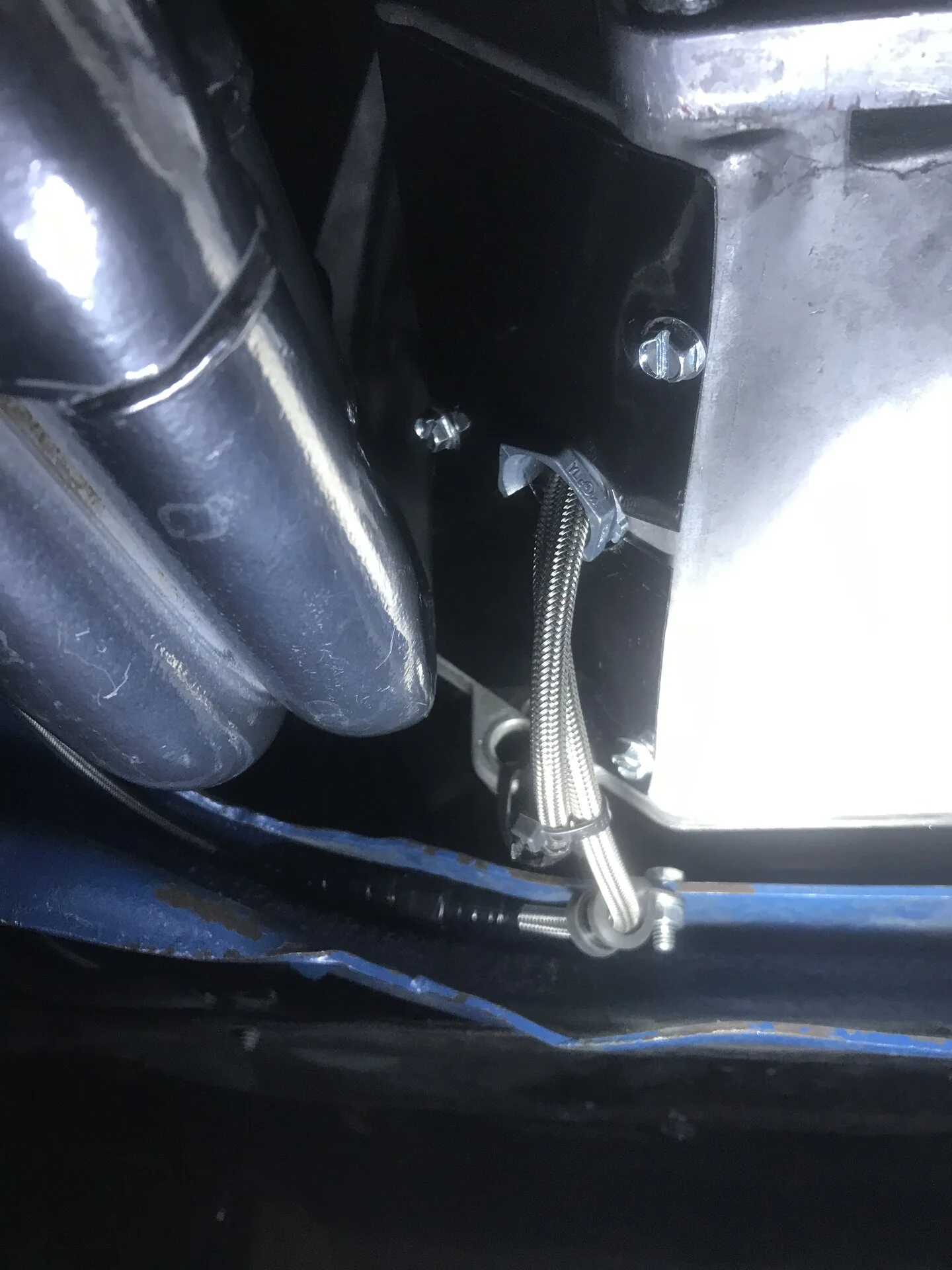

This must not be water tight. On my 66 I even had no cover or something, it was just open. No problems with that.
Will the sheet metal bolt nicely to the bellhousing, if you leave the rubber away?
Regarding the wear on the hydraulic lines at the hole: cut up a piece (2-3 inch length) of rubber hose in length direction and fix it with a hose clamp to both hydraulic lines.

Will it hold nice, if you just bolt the sheet metal to it and leave the rubber away?
I'm working on it. Heading to the hardware store.

Just edited my post and added following:

Well I think this will work much better.
Now on to the next item. But! It's beer time. Happy Memorial Day.

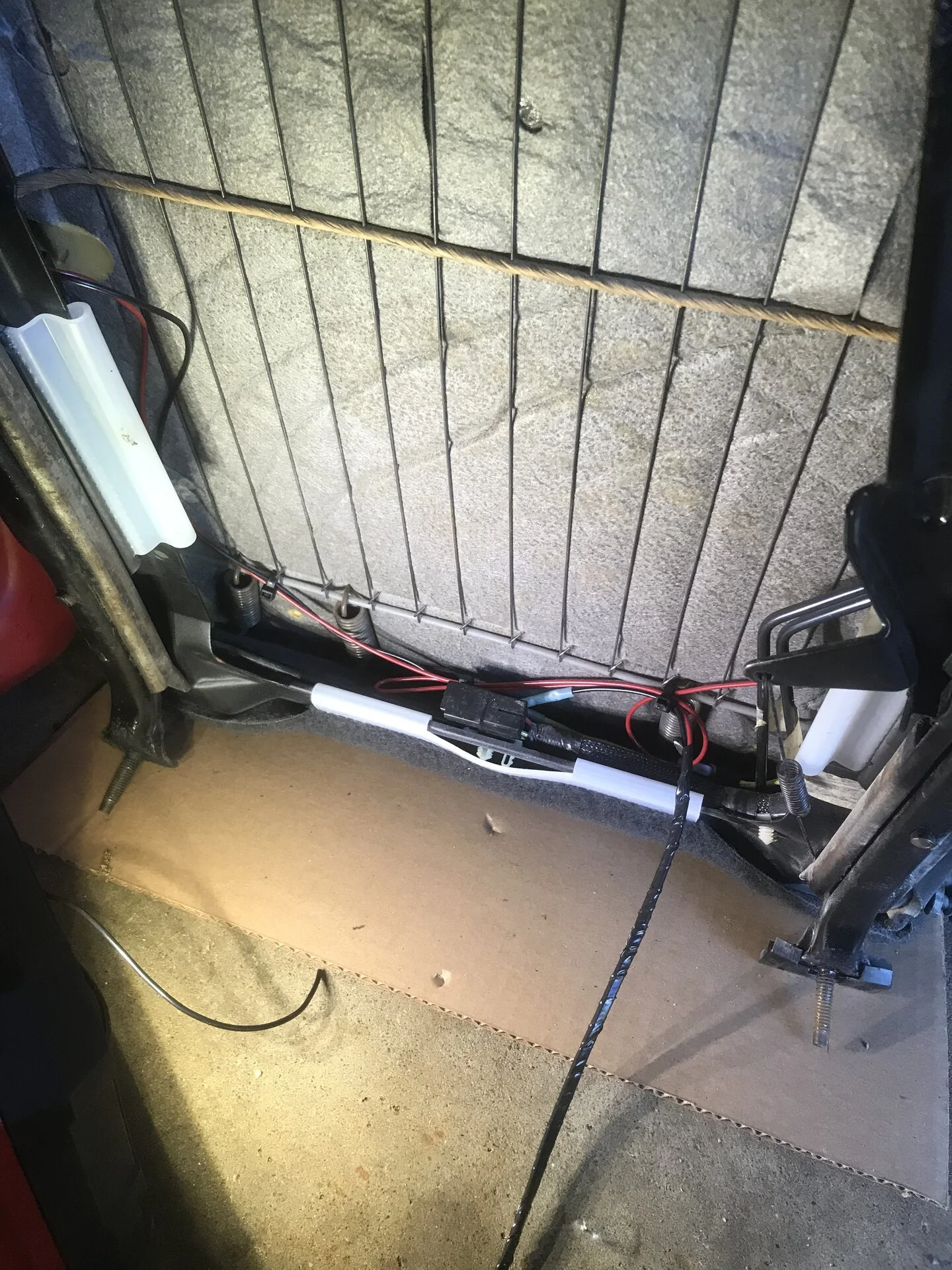

I'm done fixing old nagging problems! A little more cleaning and then a new master brake cylinder, rebleed, and I'm good to go. Tried some seat belt replacements but they weren't going to fit under the hatch window. Maybe that's why they went with two retractors...no room!
Today I decided that the driver seat was always a power seat and as long as I had it out I'd thought I'd look at what it would take to make the lumbar support. Searched the internet for electrical drawings for 2003 seats and after looking at them I went to work.
I'm smiling cause I've now got lumbar full adjustment on the Cobra II.
Reactions: LILCBRA, 2Blue2 and extra_stout

I (we?) want to see more pictures of the seats in the car!
It is nice how the MustangII rails fit onto the sn95 seats, as you described already in a previous post.
