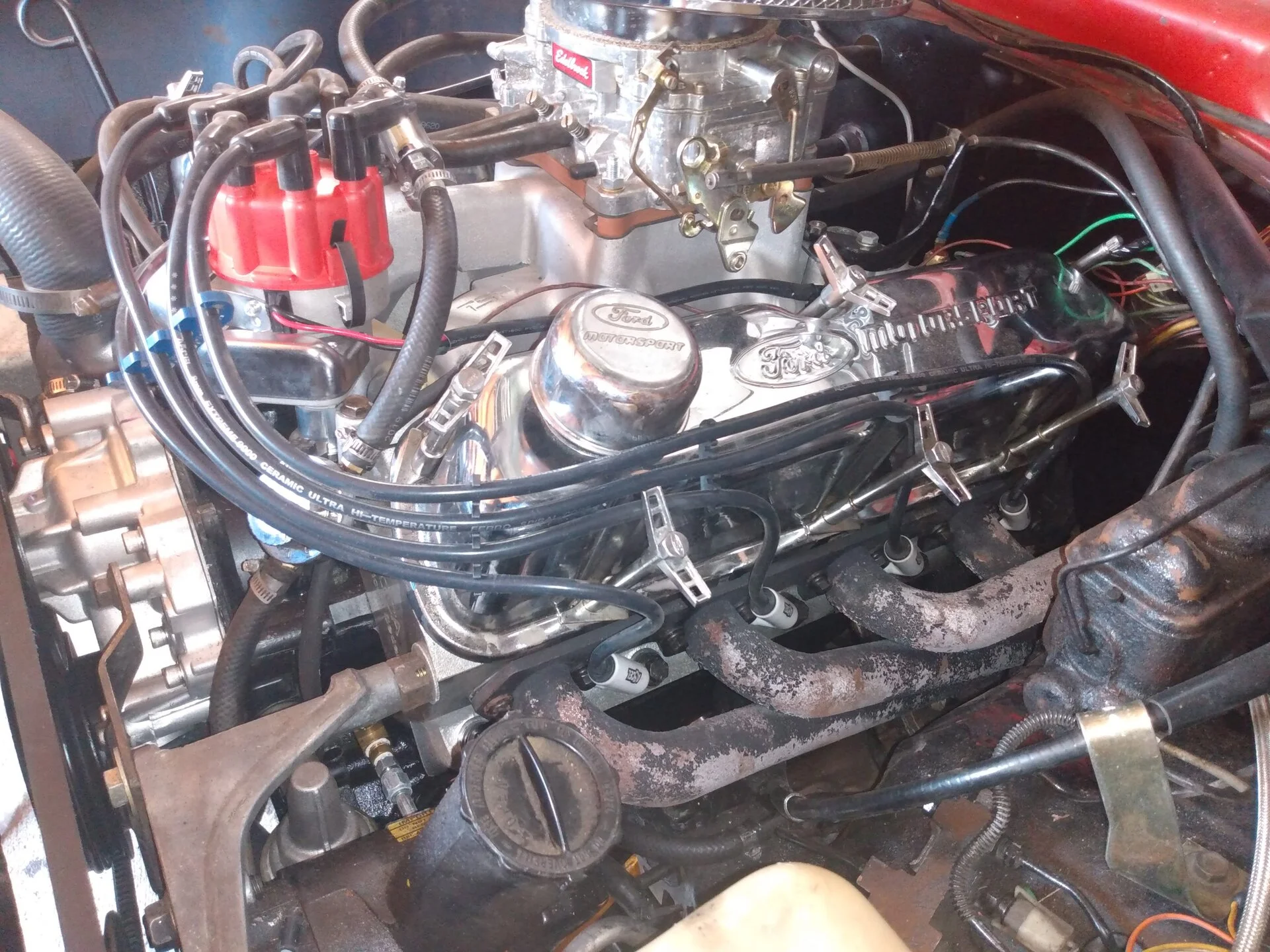

Could one of you guys with a high rise manifold post a picture of how you connected the throttle cable specifically the hardware to mount it on the manifold?
LILCBRA
Mod Dude
Dec 6, 2005
6,446
5,427
194
Corn County USA
Jul 30, 2020
#150
  • Jul 30, 2020
  • #150
I'm at work now so I can't supply a pic, but I used the stock bracket on the adapter that came with the intake I bought.

Okay. When you have time a pic would be great.
Thanks.

Thanks for that. I was freaking out on how to install the cable. That's the factory cable bracket and it looks good.

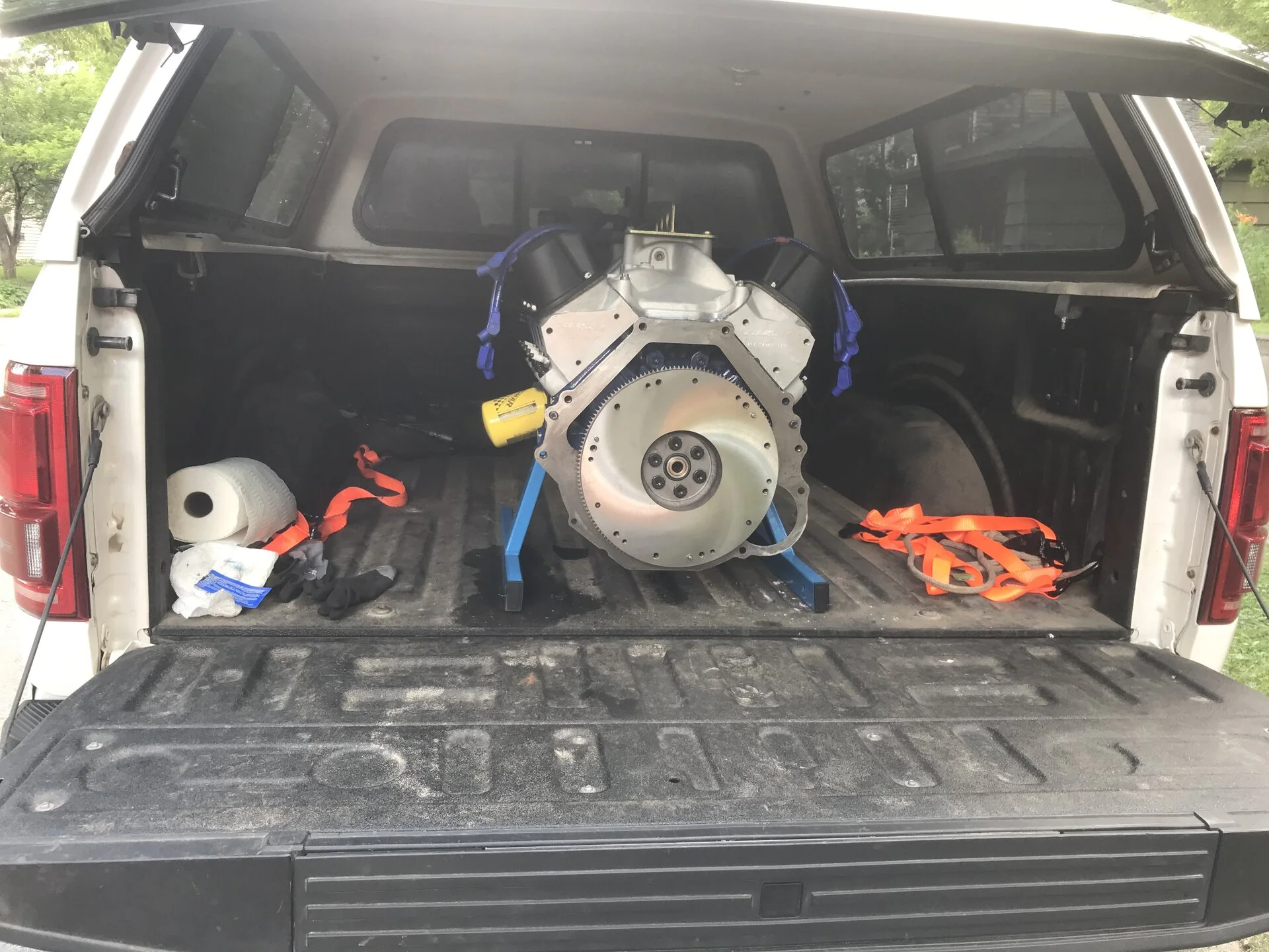

Progress today. Truck build....
Reactions: IICrew, 2Blue2, extra_stout and 2 others

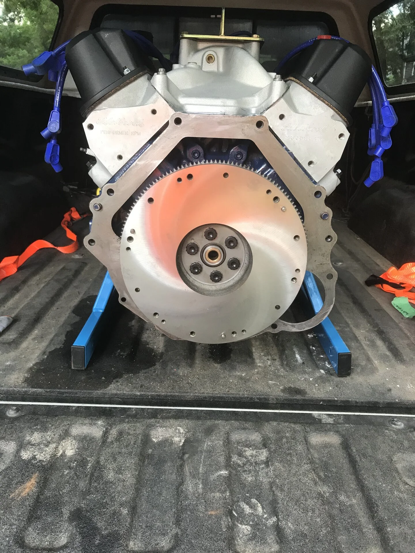

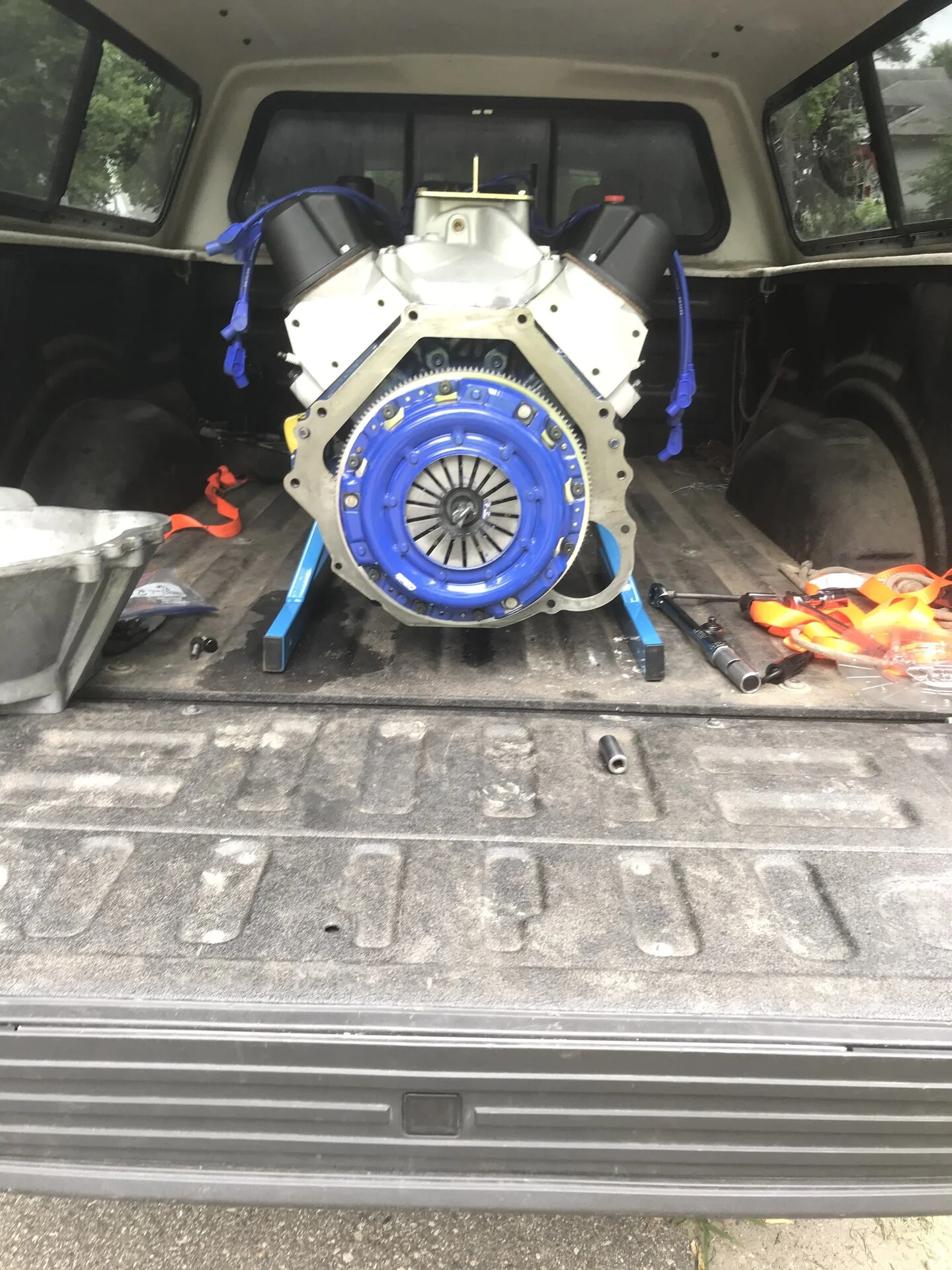

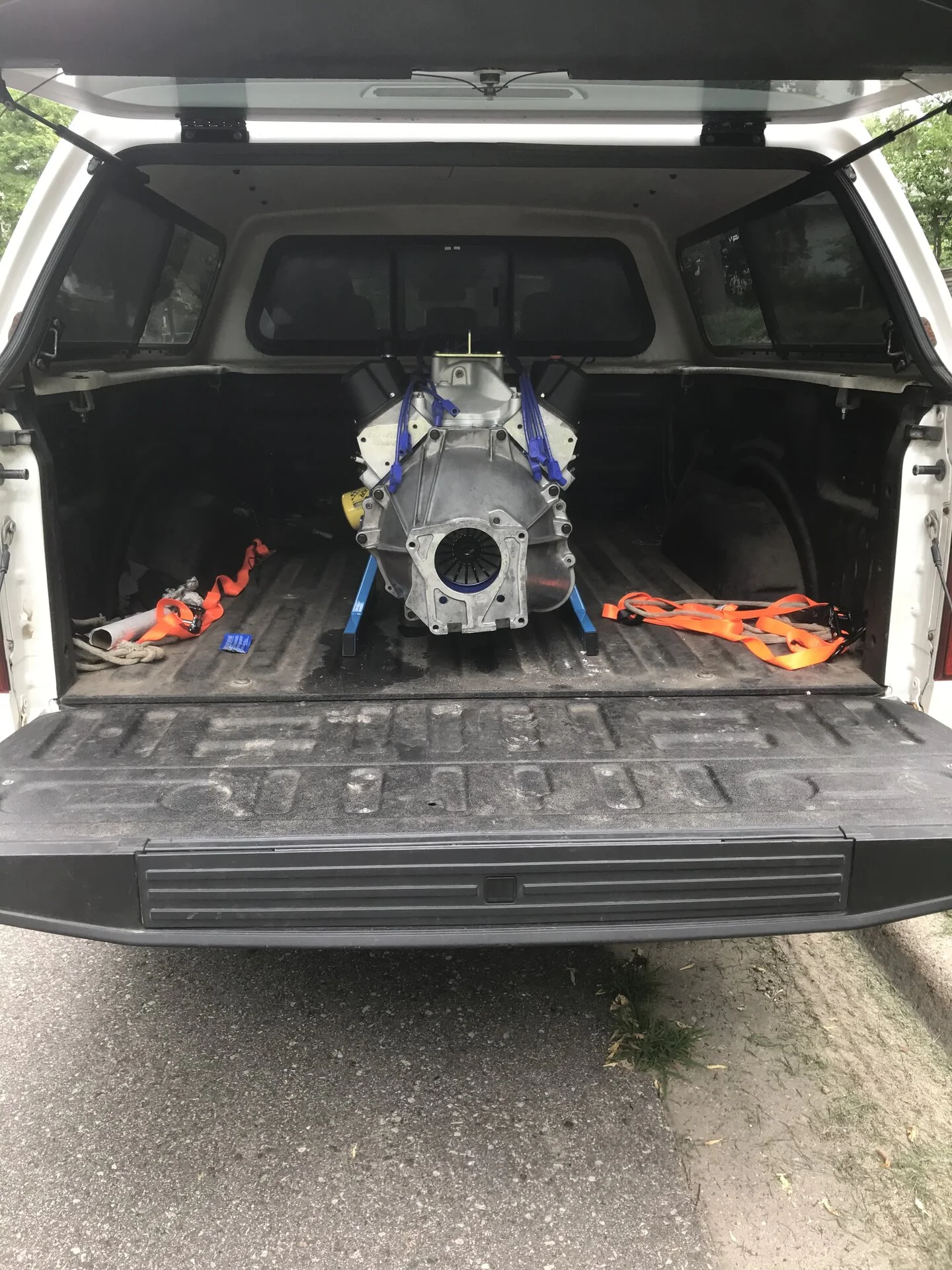

Today's progress.
Reactions: LILCBRA

What bellhousing is that? I've read back through and don't see details on the clutch, engine spacer or flywheel. Other then most is from MDL.
I'd say you deserve a few beers.
Reactions: Enzio
Enzio
Dang it. I was hoping mine would get 3 more inches
5 Year Member
May 14, 2019
1,055
841
133
Minnesota
Aug 1, 2020
#160
  • Aug 1, 2020
  • #160
Stock bell. Now that I think of it ... Almost the last thing...stock.
Clutch, Classic Auto.
Engine spacer?
Fly wheel stock. Balanced to the nuts. (see classic auto)
Transmission is from mdl.
