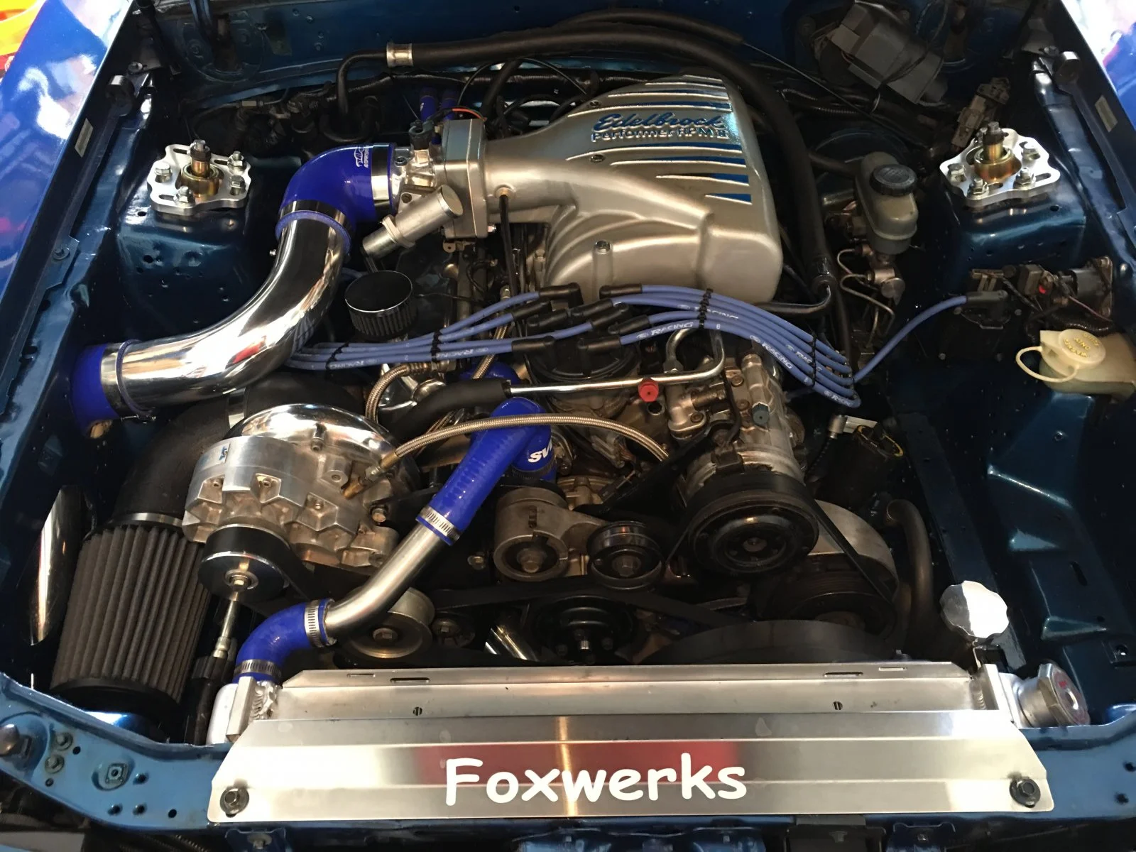

Looking for some ideas for help with my tune. Car starts but stalls unless I hold the throttle and let it warm up. Any tips on where to start adjusting?
Combo is a 1990 Ford Mustang GT with a Microsquirt.
306 with Edelbrock RPM heads, 1.6 Rockers, Lunati 51014 Cam, Edelbrock RPM 2 Intake, Accufab 75mm TB, 60lb injectors, Vortech S trim with intercooler.

What you want time off? :) Certainly interested in remote tuning help and class on proper use of the software and not break stuff. I suspect I may be approaching the magical range when stock blocks could decide to split...Visual in case that provides any inspiration.
