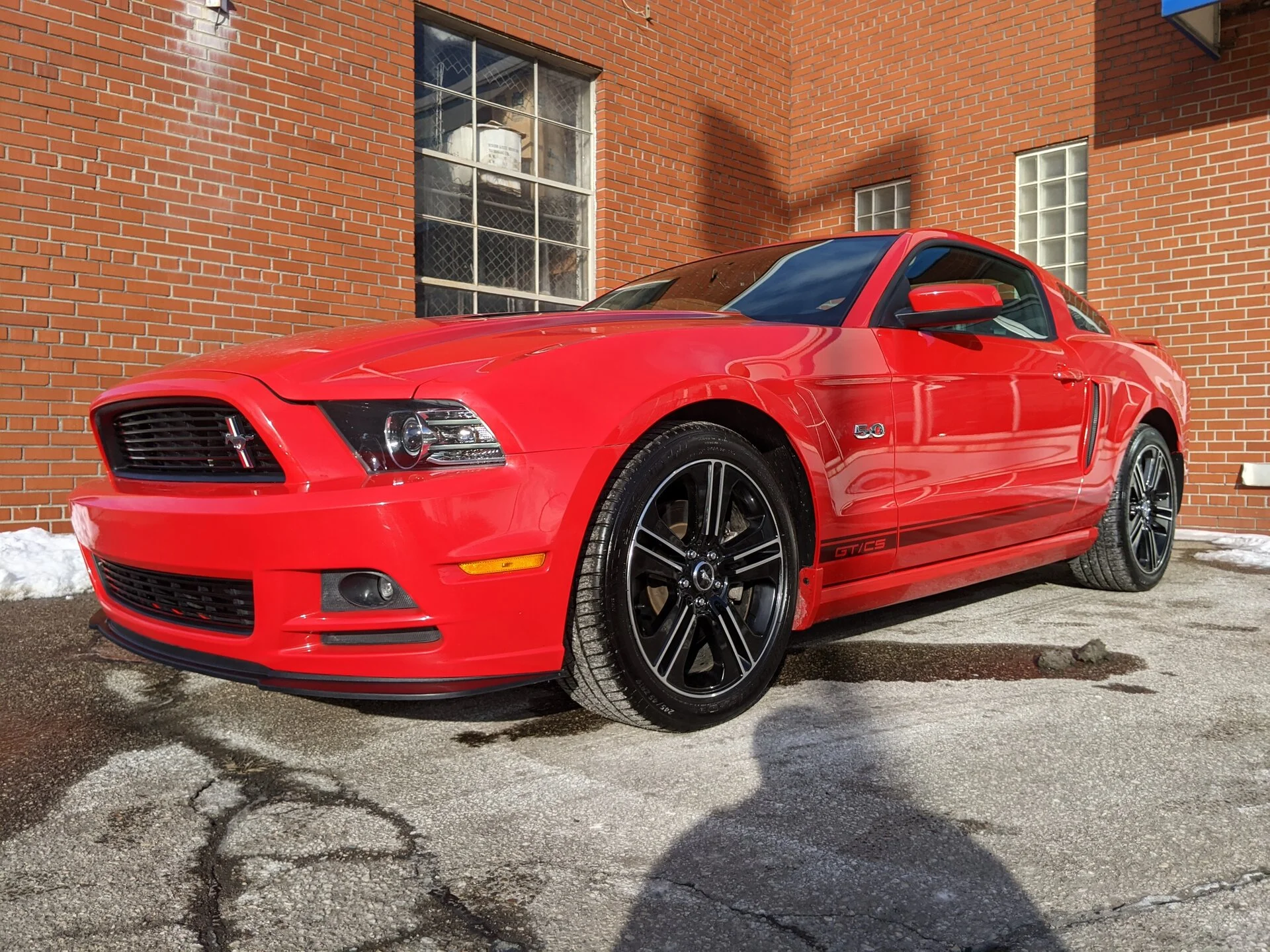

Hi all,
My garage isn't near warm enough for me to work on this engine without my fingers going numb, so I did the next best thing (in my opinion)
I ended up getting a 2013 Mustang GT California Special. I'm not stopping the build, but at the moment I just moved into our new house and heating up the garage is one of the last projects I get to work on.
