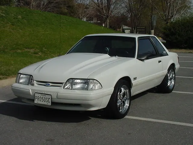

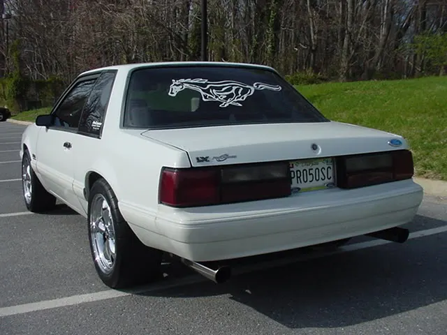

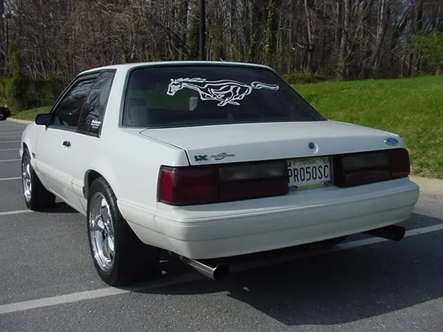

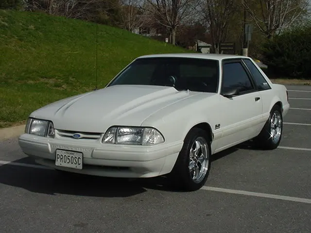

91 lx 410hp engine I want this bullet style to fit without rubbing and quad removal. Car has 51000 or so on it, about 1000 a year for the last 6 years. I jsut fabricated 304 stainless 2.5" exhaust his no cats, expipe with flowmasters. dont wanna touch exhaust. Wife does most of the driving. $ 15000 in new parts, stroker347 etc. My eyes are going buggy reading all threads. Want new parts since everything is new already. From what ive read, sn95 front assy, and ranger driverside axles. Not looking on upgrading brakes, although would be nice, tires need replace before driving and have a $2500 dollar budget for this year per the wife. That would include Drag radials and fronts, rims, and 5 lug conv. I have upr upper and lowers with lakewood traction, koni ajustable shocks, bbk lowering springs on shelf that will go on at time of 5 lug conversion. with this info , can someone make sure im on the right track with parts? Size of drag radial? Thanks a million.
I ran a 275/40/17 on that exact rim w/ no problems. Quads removed
17x8's on the front though.

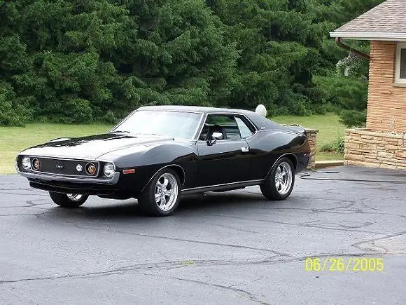

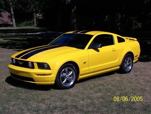

Nice Car... Love white Fox body. What size front tire? and your rims have the same offset as these on ebay only fronts were 8's? Thanks
