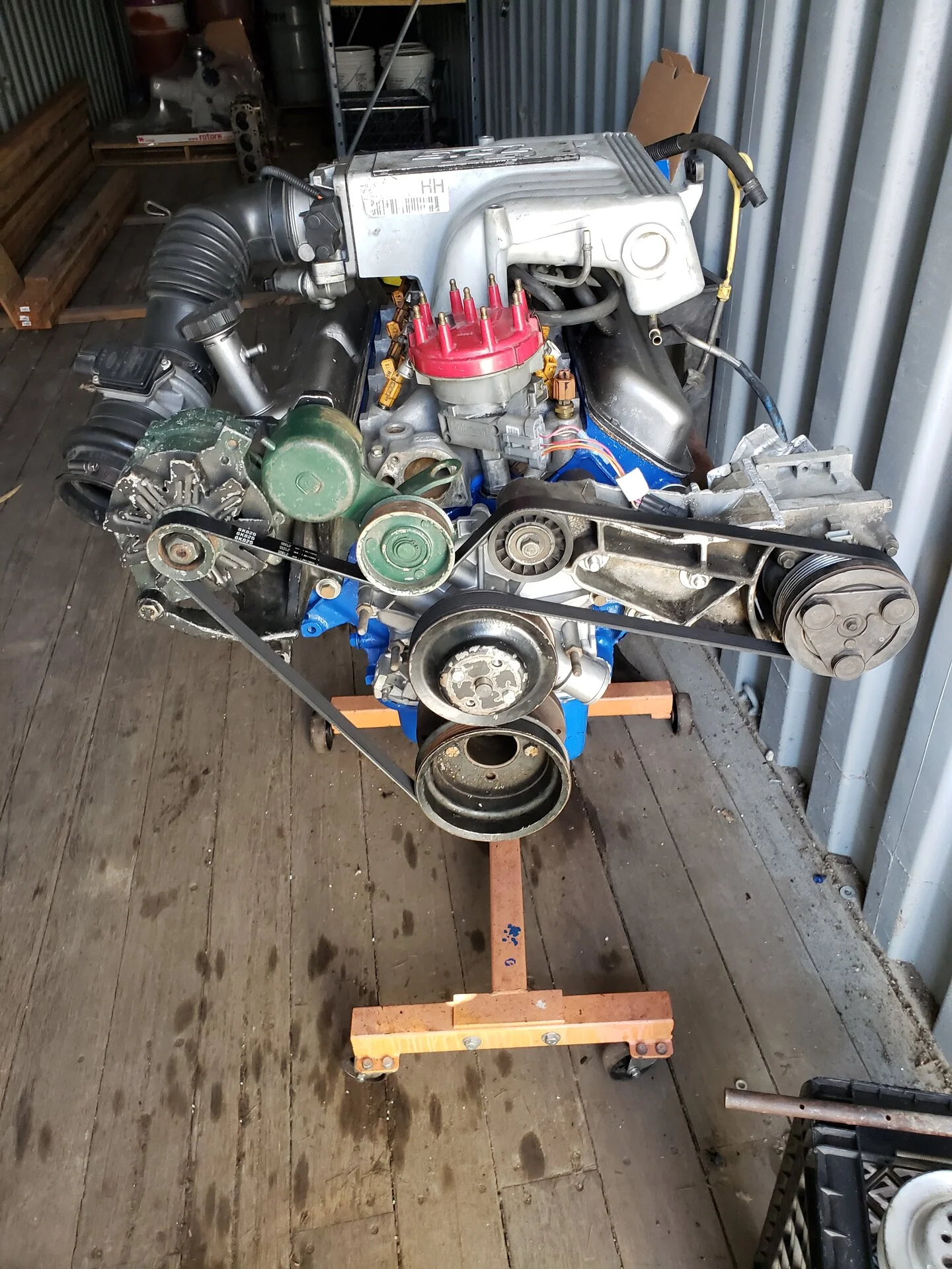

As mentioned I have a MustangII front end in it and the shock towers are gone. There is lots of room. The bracket came from an explorer I cut the upper half for the steering pump off. The fixed idler and 1 wire alternator is for a GM LS I hope it doesn't give my engine any cooties. Oops the picture shows the Ford alt.
That ac bracket would give me the hebegeebees or at least a WTF reaction all hang'n out in mid air like that.
You couldn't use a fox bracket to bring it in closer to the engine?
I'm not criticizing, but it does look odd.
