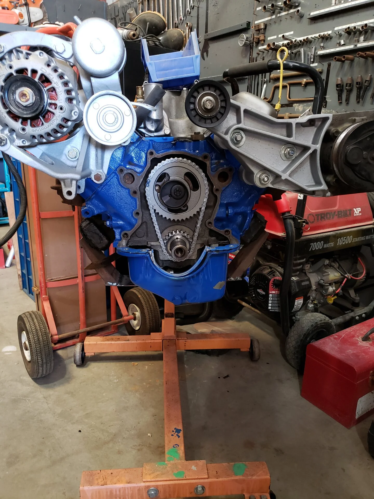

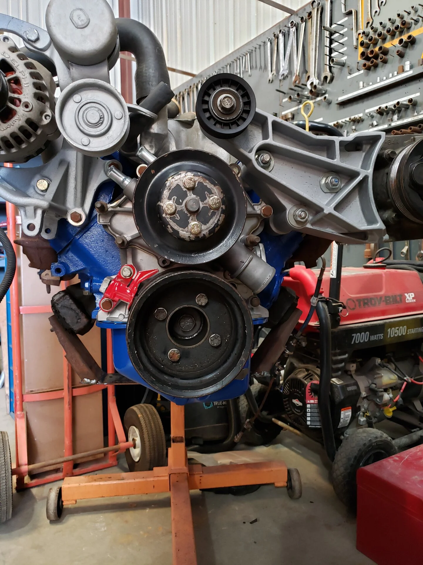

It had already been removed from the intake donor and was just laying there. I new I'd be needing one so I snagged it. I know it's kind of ugly but the nice thing is nothing is bolted to the timing cover or water pump so I can do my cam swap without removing the alternator or AC compressor.

See quick and easy. Well on the engine stand anyway.
Any guesses on what kind of HP it will make. Specs are stock 88 car block and pistons, E5 heads, 91 HO cam and lifters, 2000 ish Explorer intake and fuel system, iron exhaust manifolds, running on an 8LD ECU through a Painless stand alone harness. My guess is around 200HP but not over.

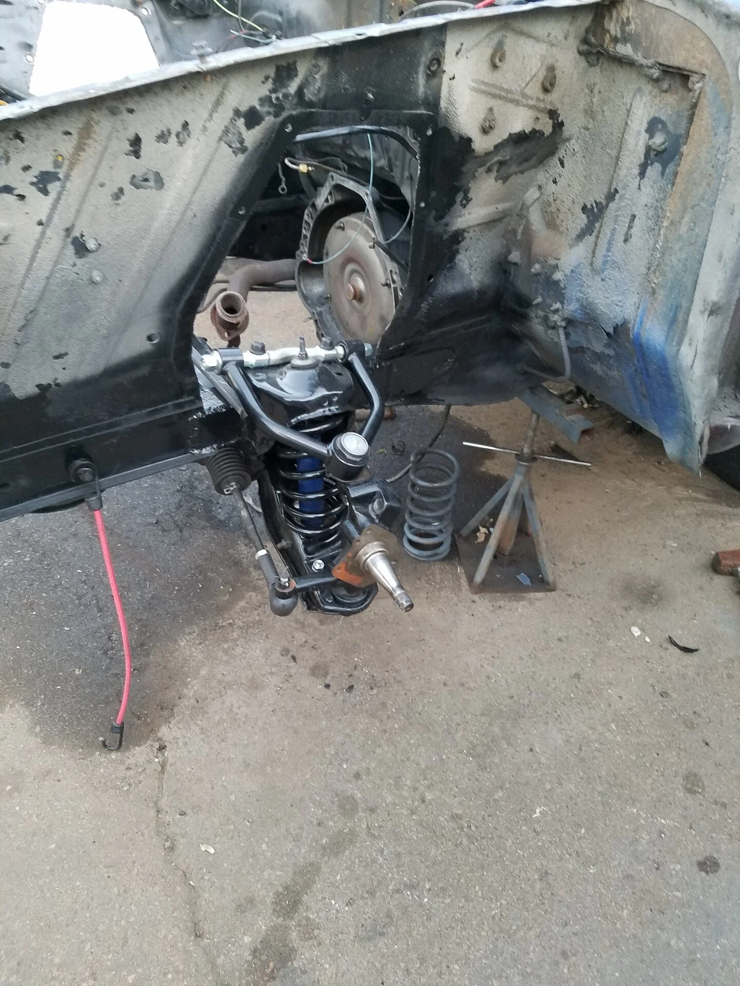

Well the weekend engine swap did not go as planned. I have a couple of clearance issues that need resolving. I need to roll the rack and pinion back to lower the steering shaft, the right exhaust manifold hits the frame rail while the explorer upper plenum hits the brake booster. I found that a Datsun B210 booster is only 5 1/2" in diameter so I ordered one. I'll see if I can make that work. I know R&P brackets are out there and it's just some more welding after that. I did take a couple pics but nothing helpful to anyone watching.
