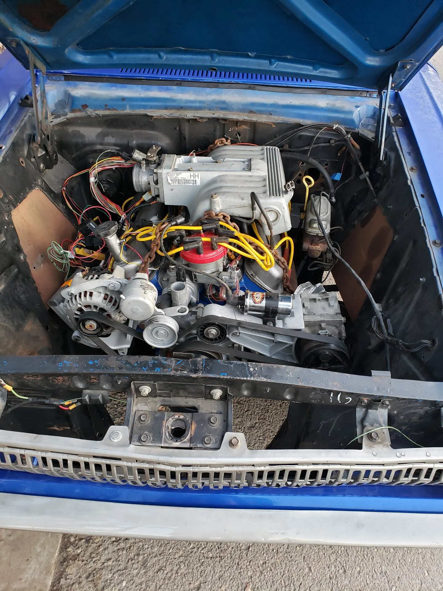

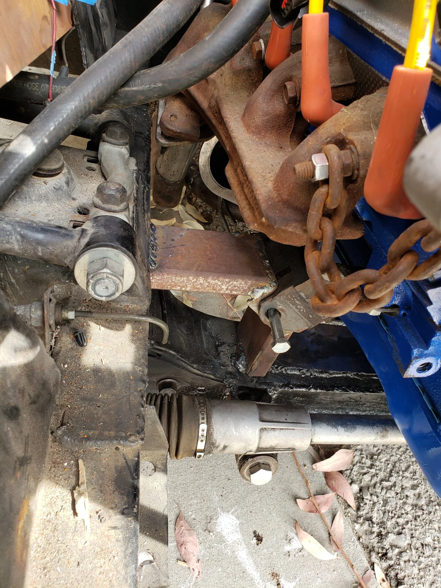

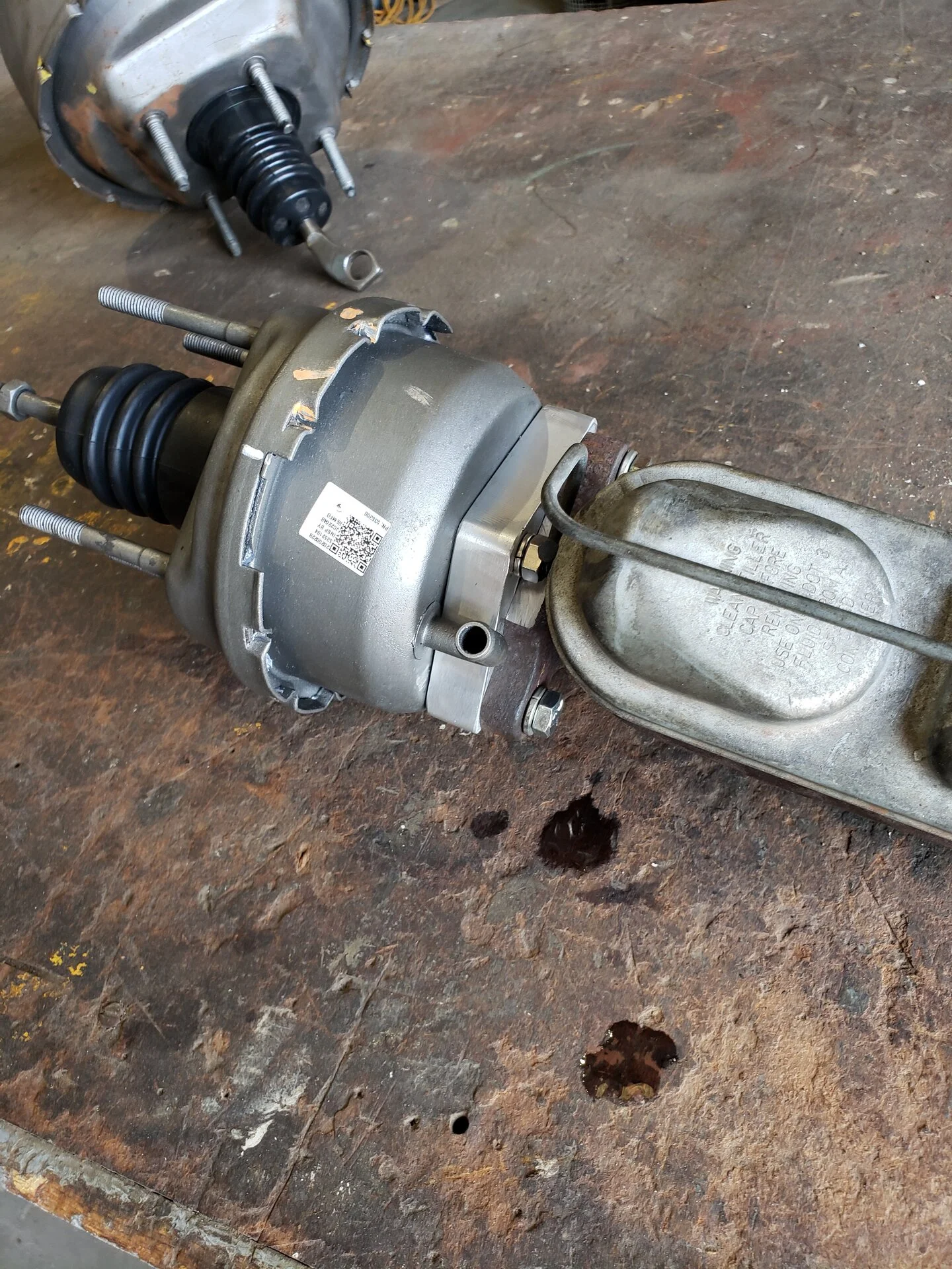

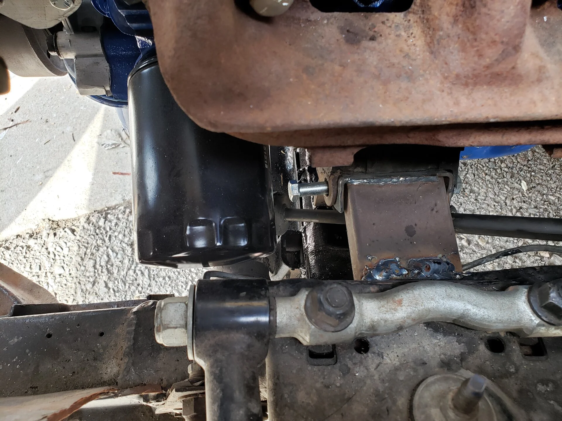

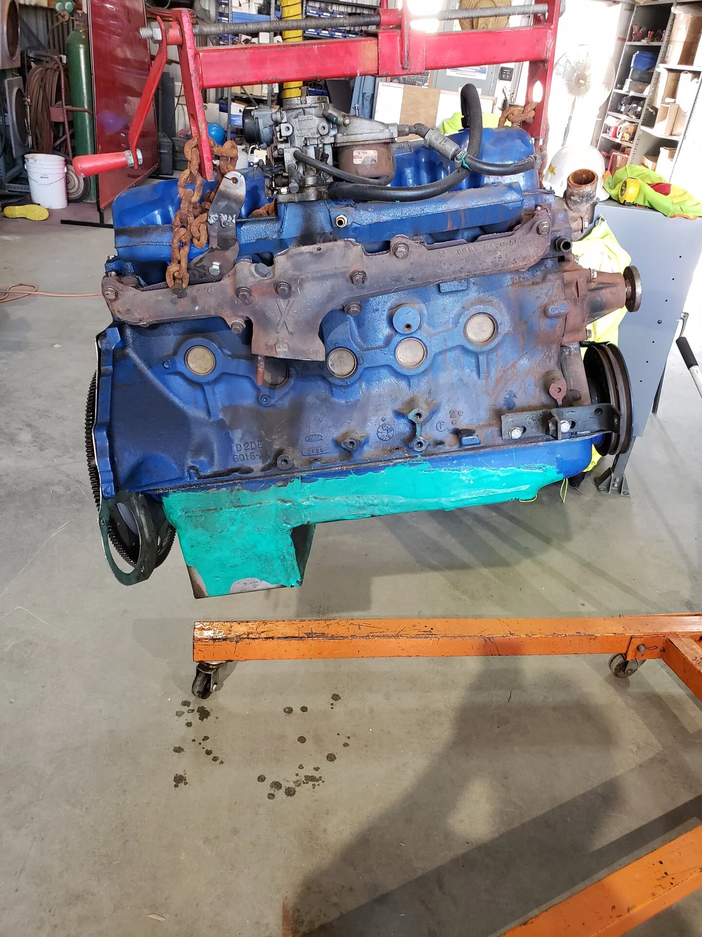

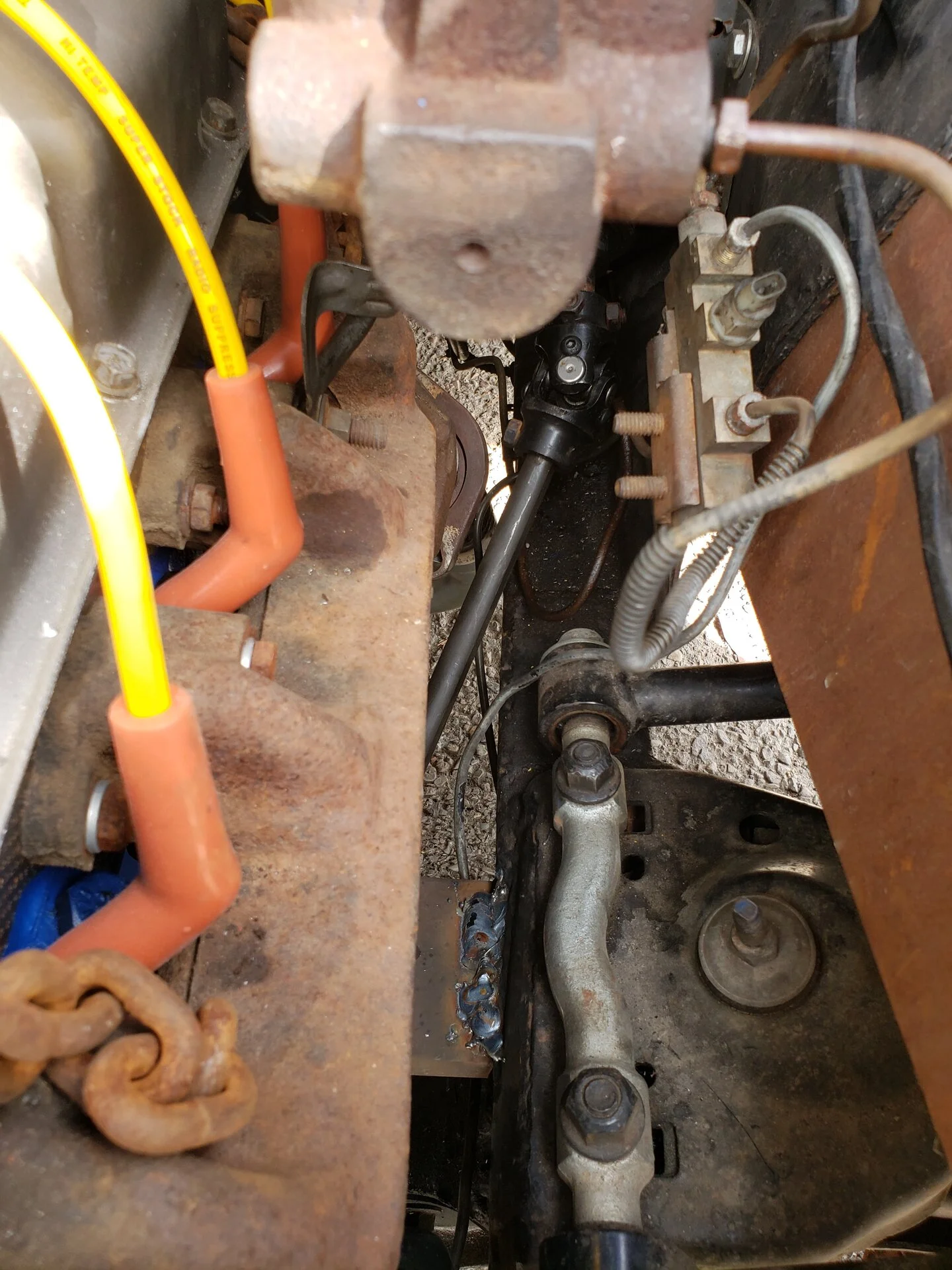

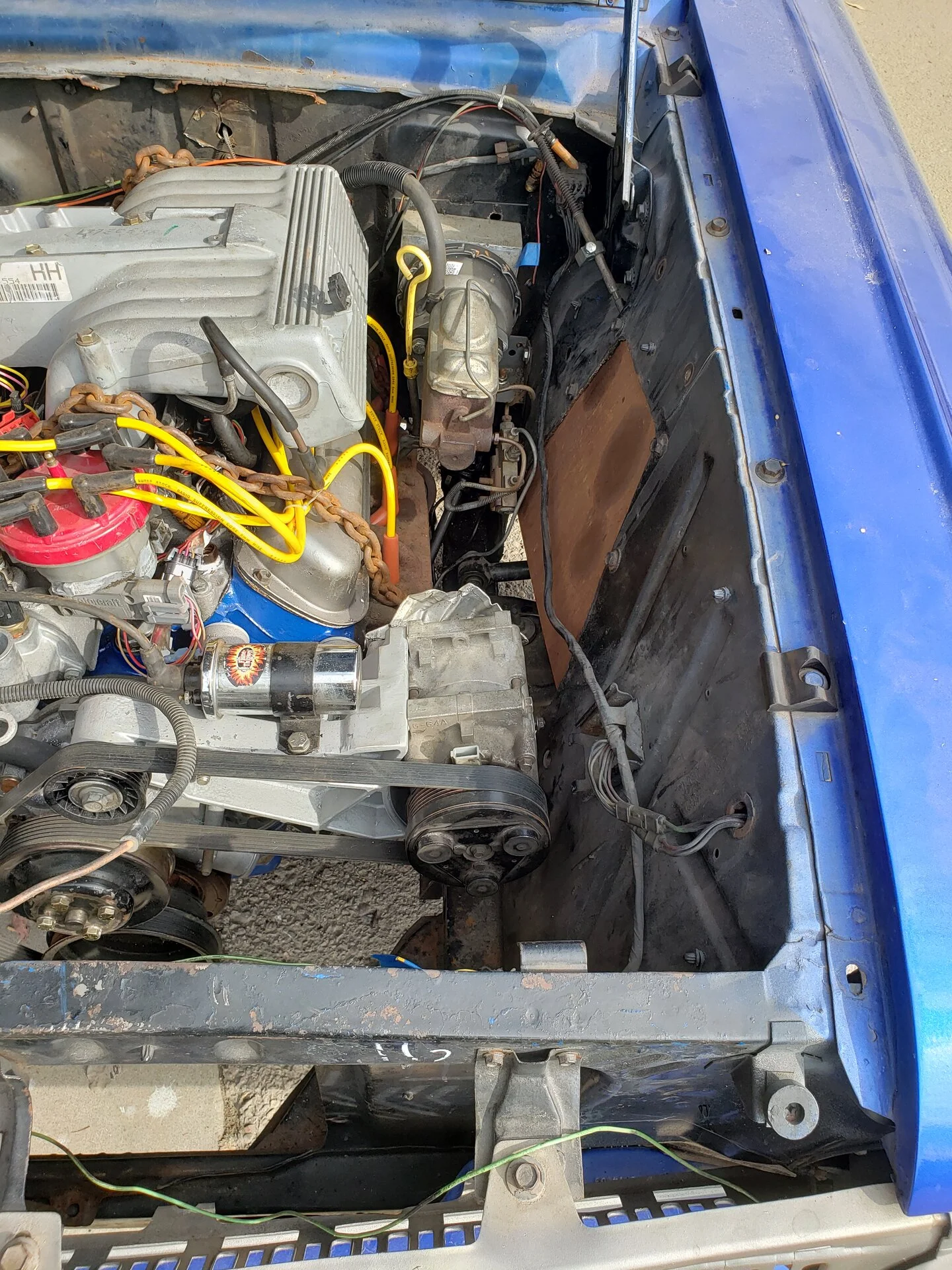

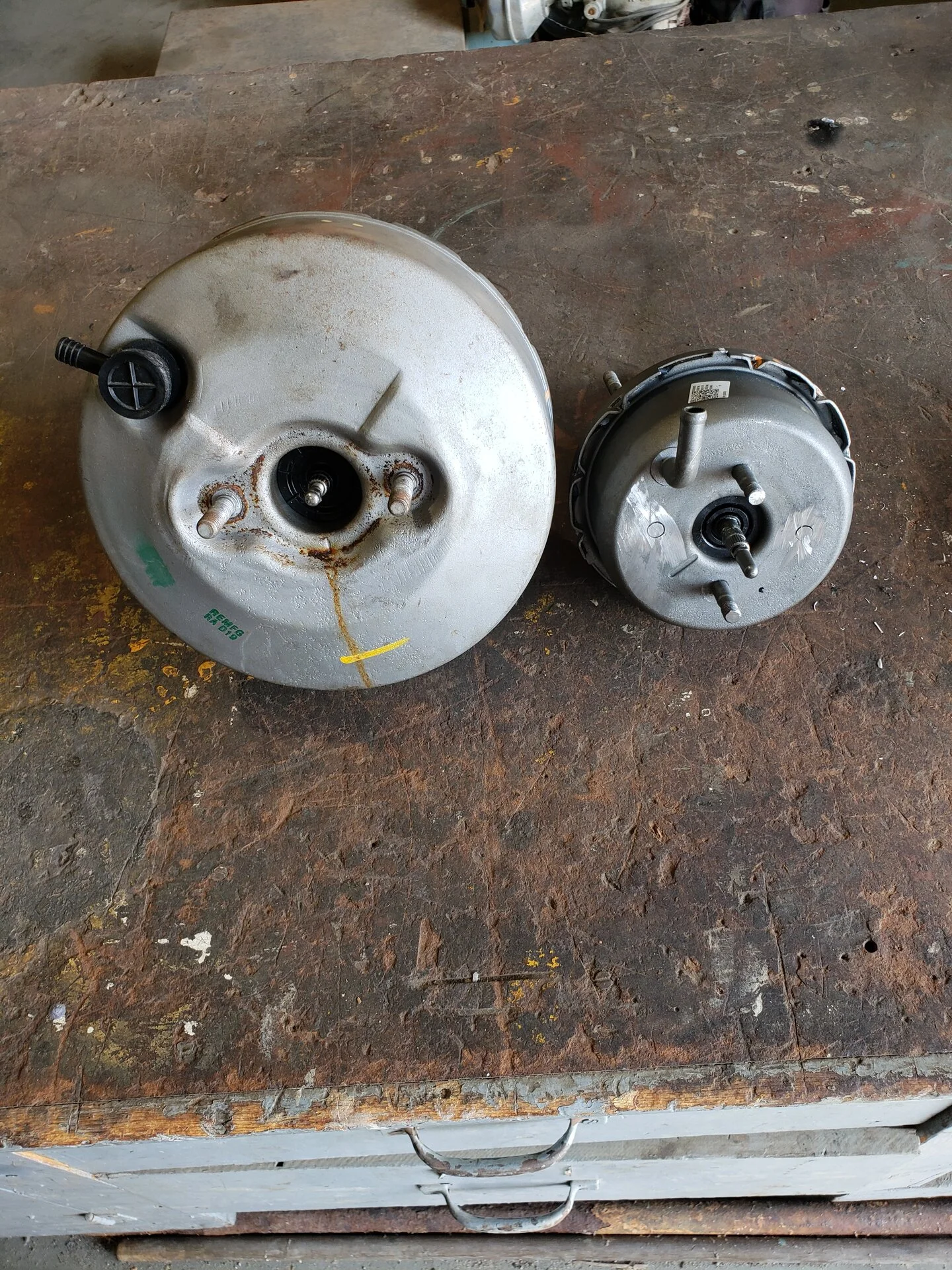

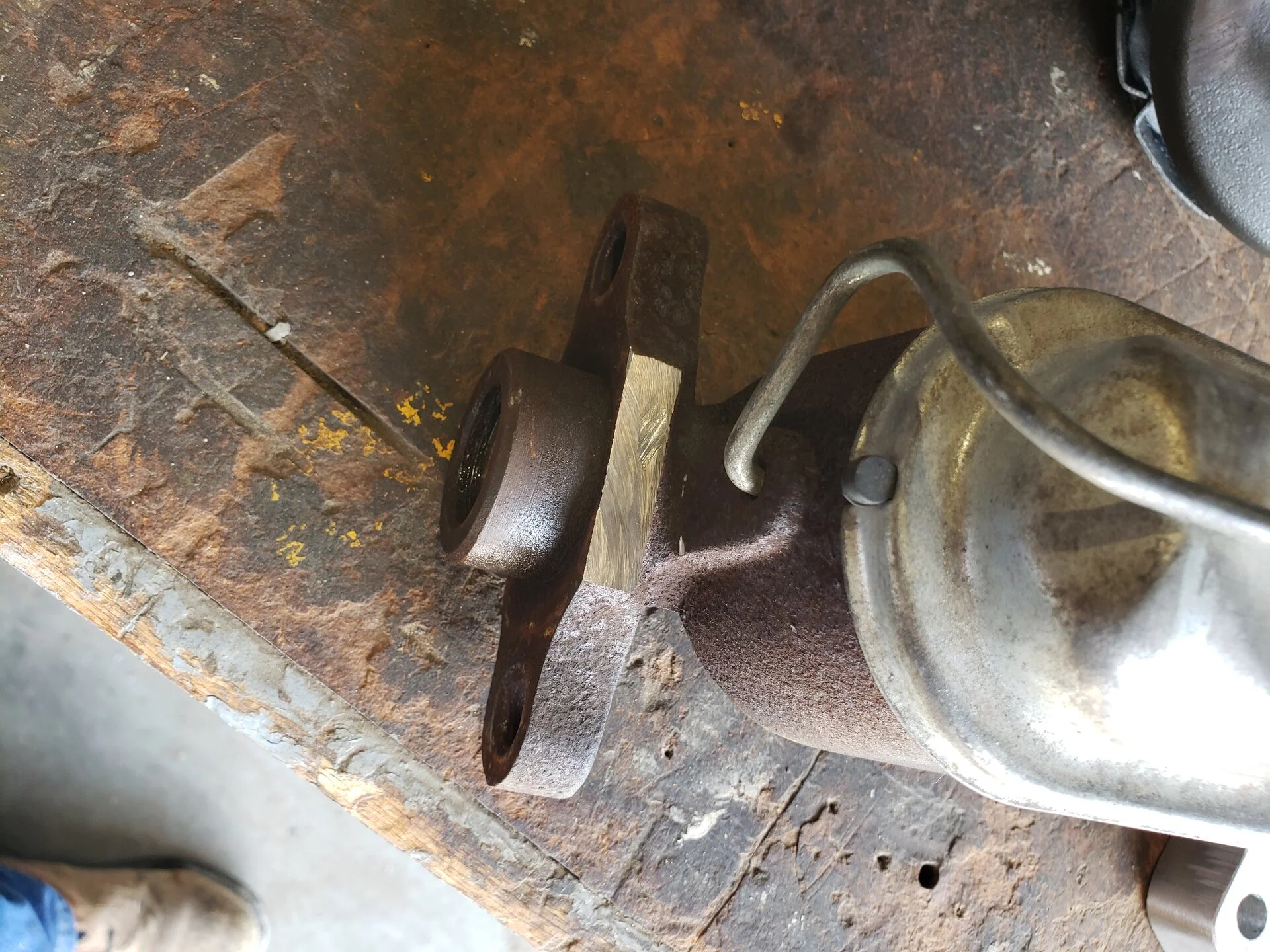

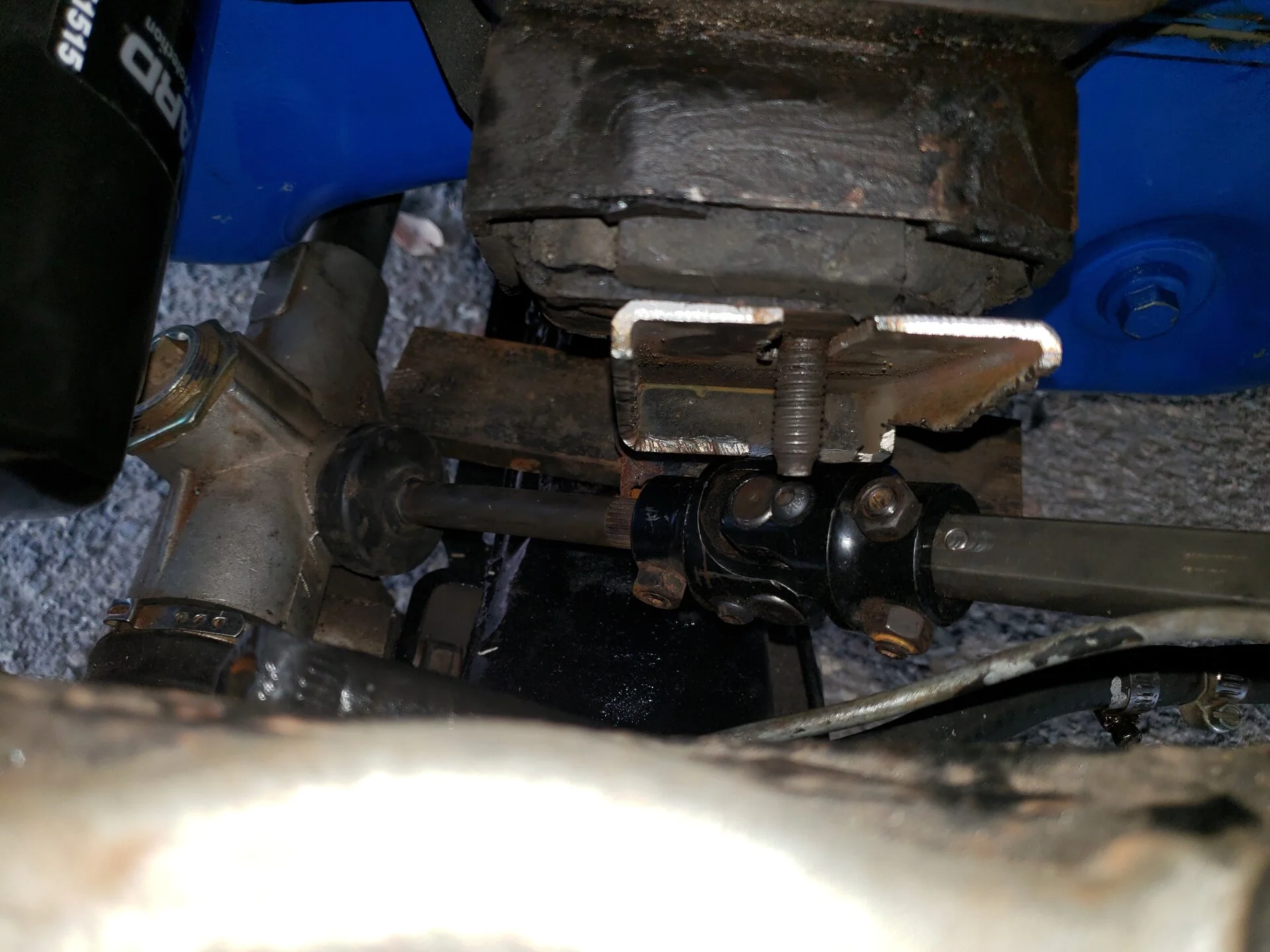

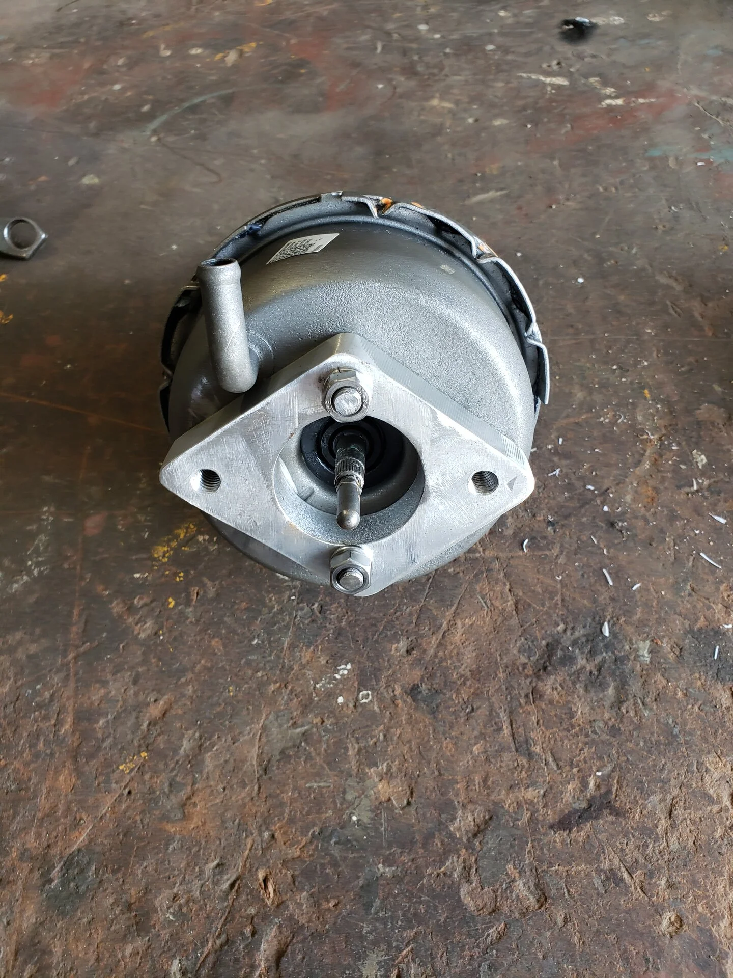

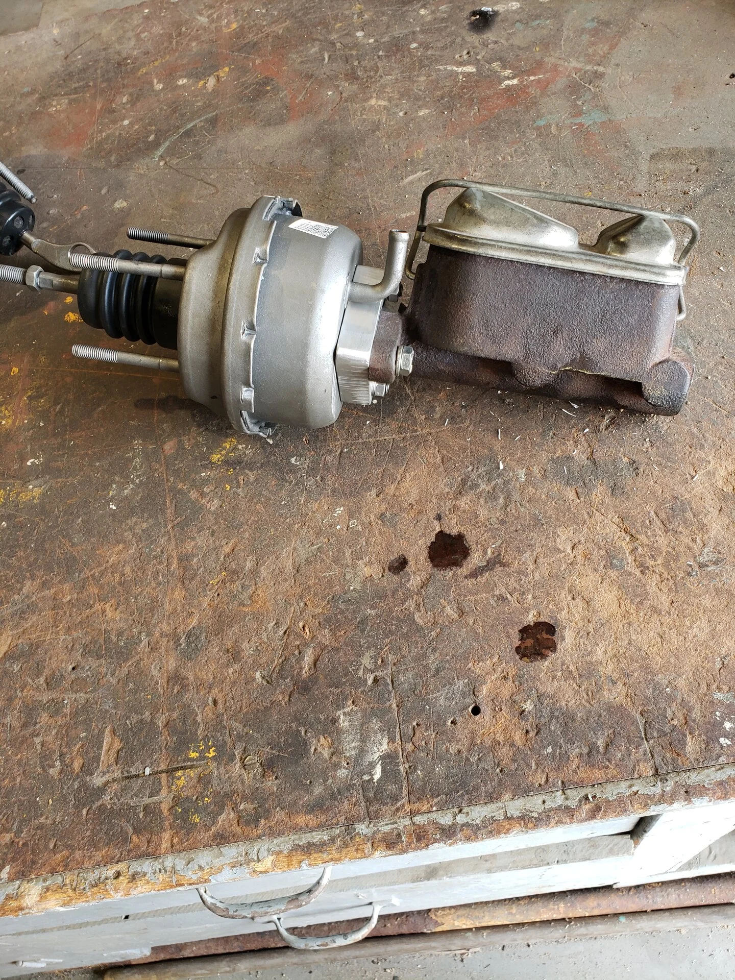

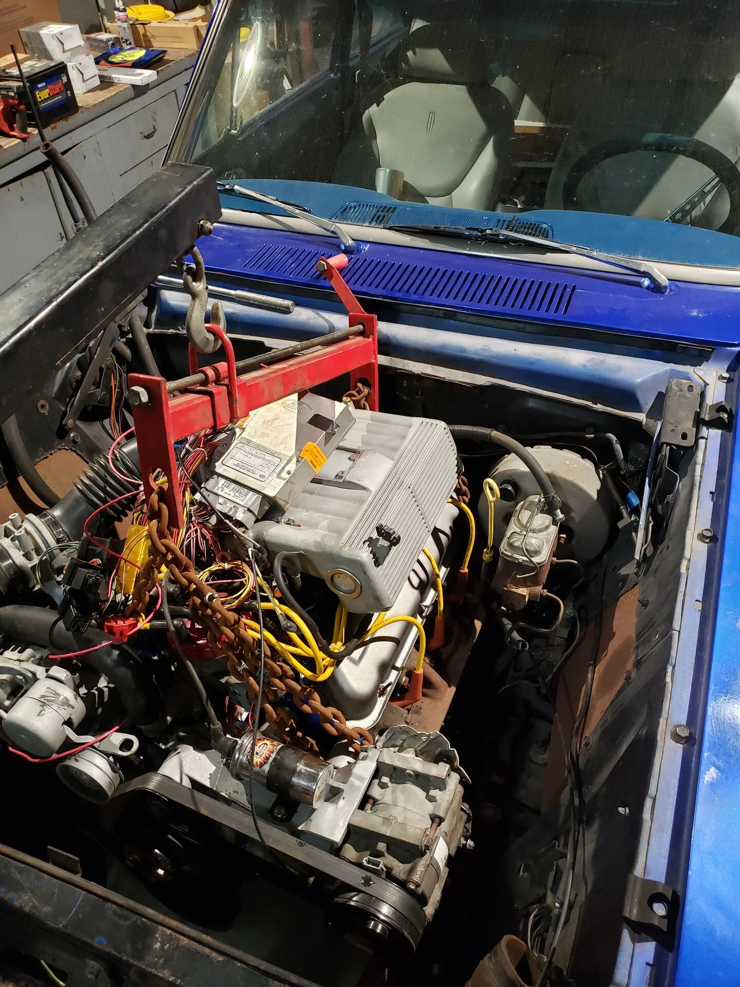

The 302 is in and bolted to the tranny. I get the smaller booster later today. I'll get that mocked up and then I can do final positioning. I need to see which set of motor mounts will give me the most clearance at the steering shaft. I have both stud and bolt through. I can then fab the mount pads.

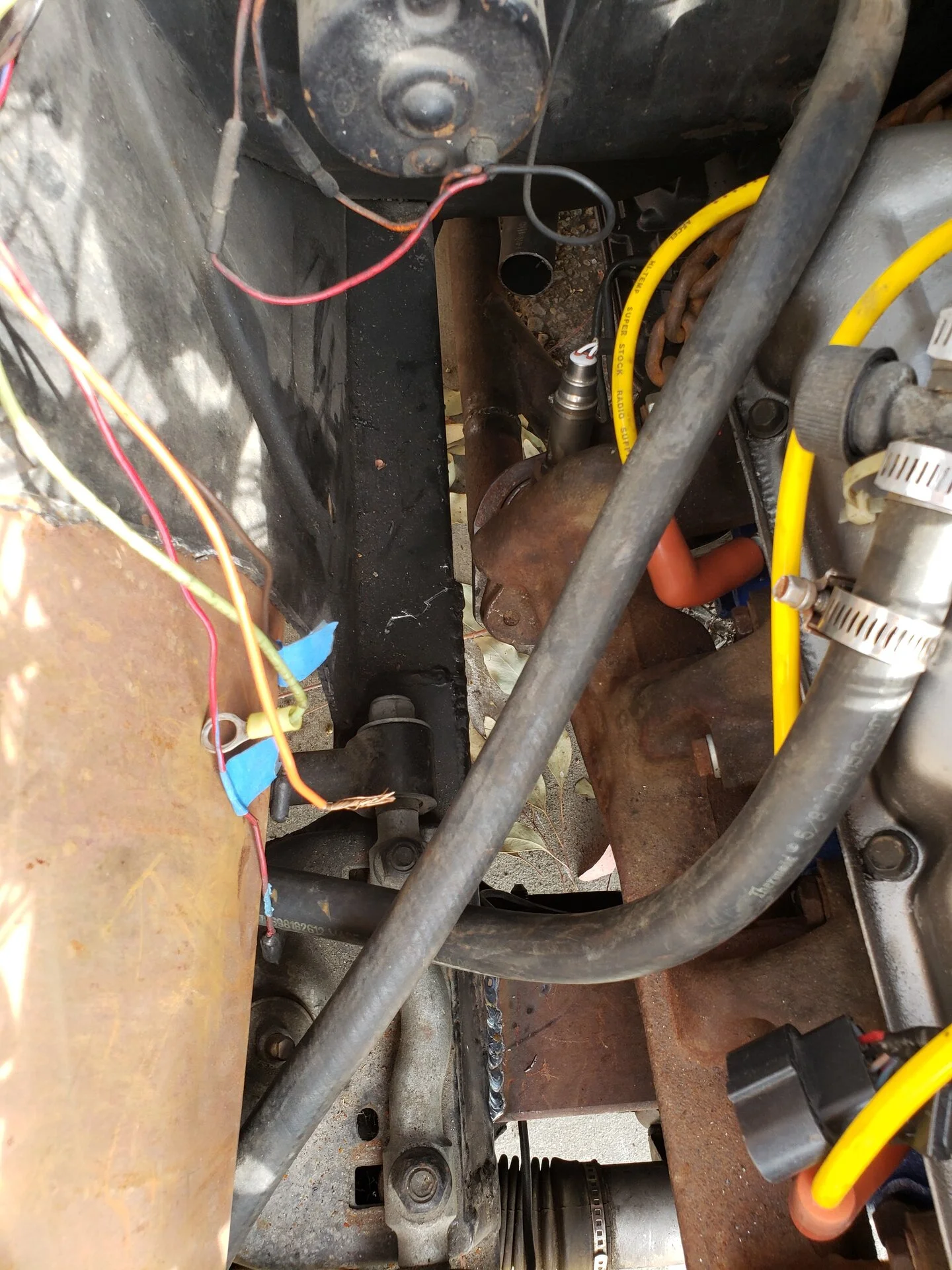

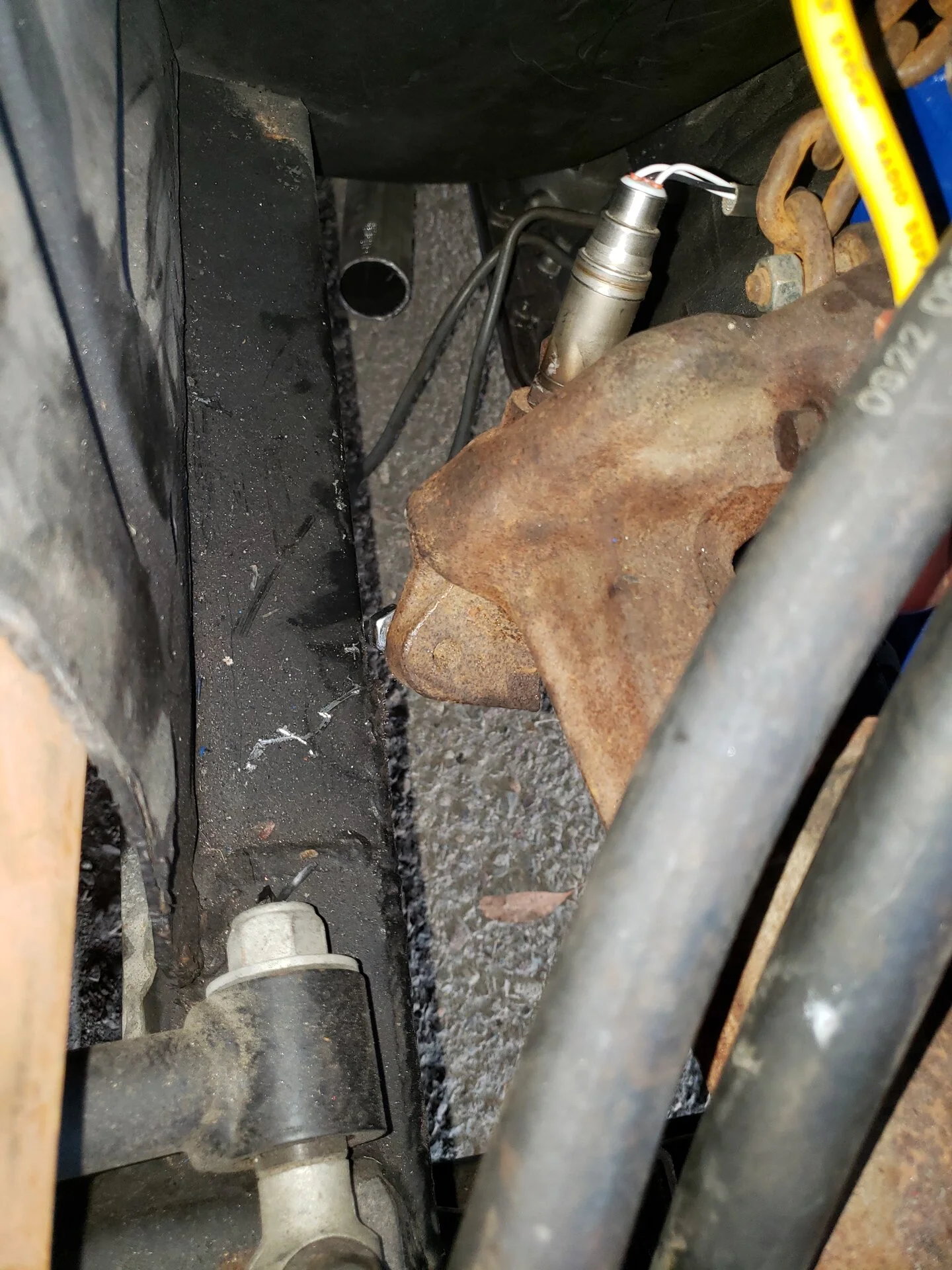

Maybe possibly, do you have a pair you'd like to donate. After that I'd have to do complete dual exhaust. I'm trying to work with what I've got. If I can accomplish that then I know down the road headers is an easy upgrade.
I already have a Y pipe fabbed up to connect to the existing exhaust. I have 2" of clearance on the driver side exhaust manifold to frame. My local exhaust shop quoted me $300 to dual it out to the back bumper. The Y pipe was $16.00 and some cutting and welding. Remember I still have to make motor mounts, I might as well center the engine as much as I can.
