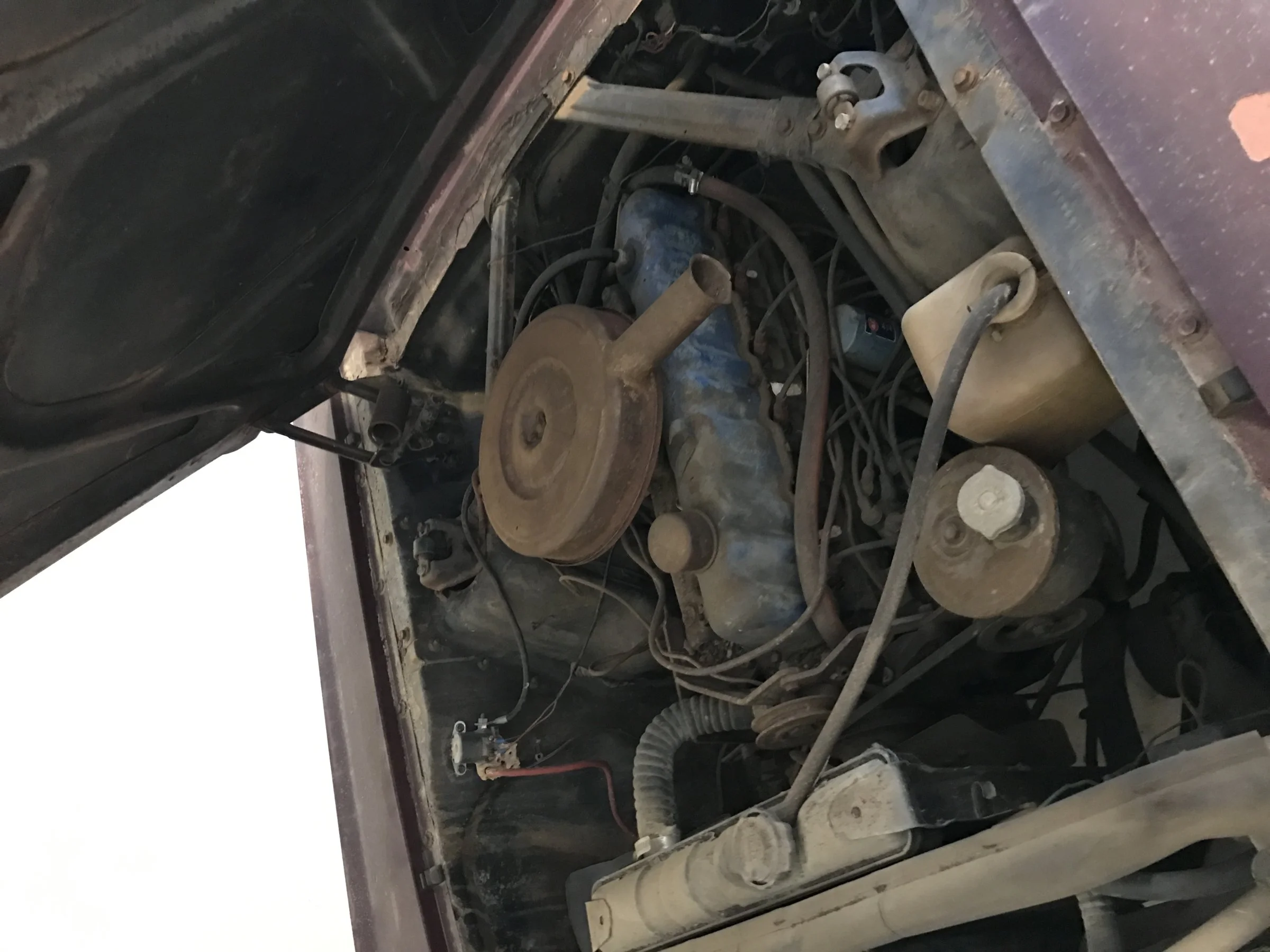

If the goal is to restore, then you have to go with the 170 6-Cylinder. If a mild resto-mod is the plan, you could do it with a 6, but it would appeal to a wider audience with a V8, but keep in mind you will have to upgrade everything to handle the V8's power and weight (front suspension, all the steering linkage past the box, engine, transmission, rear axle, wheels, etc). Are you sure you even still have the original engine? It should be black with an orange-red valve cover and air cleaner. That valve cover is 1966 and newer corporate blue.
The orange-red valve cover 6's I have seen online where in late model 65's where the 200ci 6 replaced the 170ci. I guess it is possible someone could have replaced the original 170ci with one from a 66 Falcon or Mustang. Only proof I have that this is original engine is the VIN is a "U" code and it's a 6 so we are assuming it's the original.
