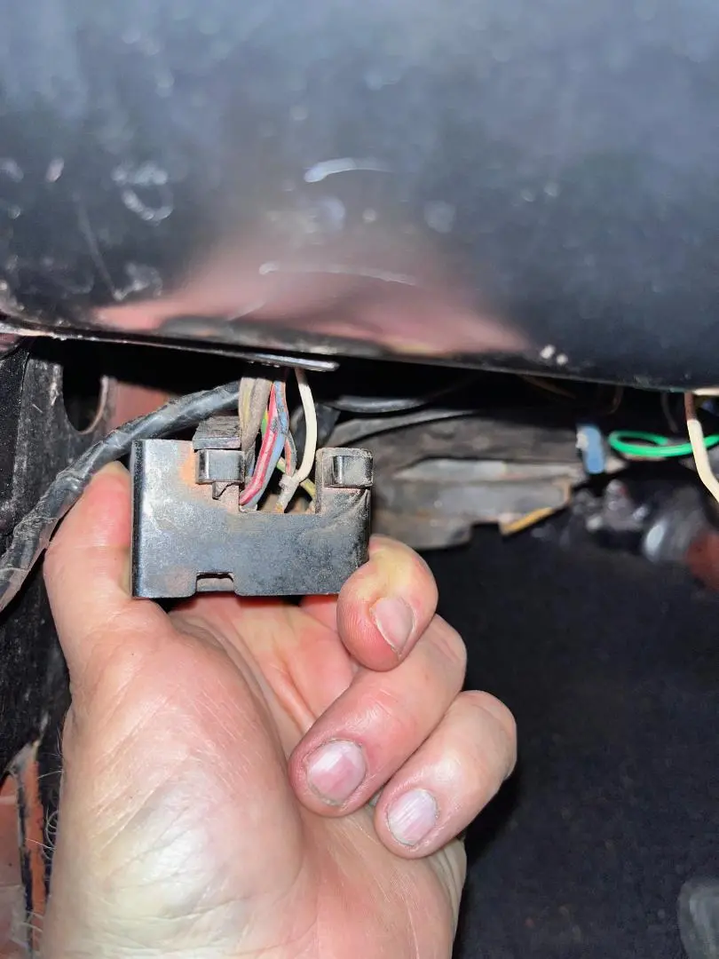

OK, I have more info. Here is a picture of my fuse box turned on its side and the wires spread out. It clearly shows a second wire going to the accessory fuse. The Black-red wire is in all the diagrams. The White wire isn't in any diagram I found.
Where does this white wire go? I found wiring info on the internet showing all wire colors for 66 Mustang. There are only 4 white wires (35,58,95,806). I can find 35 white wire in the alternator to regulator circuit. 58 wire is in the wiper circuit from switch to wiper motor. I cannot find 95 or 806 wire on any diagram I found. Yet my fuse box clearly has a white wire going to it. I believe my white wire is shorted to ground somewhere but I need to know where it goes to unhook it and check for a short.

If the white wire is NOT on the diagram it was probably added by a previous owner, the quickest way to figure out where it is going, is CUT IT OFF, and see what doesn't work. It may not be used at all. Why aggravate yourself? These cars are simple, don't make it complicated. :-)
The White wire was not added by a previous owner. It is factory.
Just cut it? I hope I get the opportunity to work on your car so I can just cut things. I’m trying to solve this problem in a more professional manner. I simply want to see a wiring diagram that has this wire so I can trace it.
Thanks for your response but I’ll keep looking for another answer
I didn’t cut any wires. I cut the tape and unwrapped a portion of the harness above the fuse box.
The white wire was a pigtail with a female end. From research it was for dealer installed options but for an unknown reason isn’t on wiring diagrams.
Someone had a pale yellow wire plugged into it which went to the fuel level sensor in the trunk. That would be a short to ground. I also found other things plugged into the wrong places. It was a pain but I think I have it sorted.
