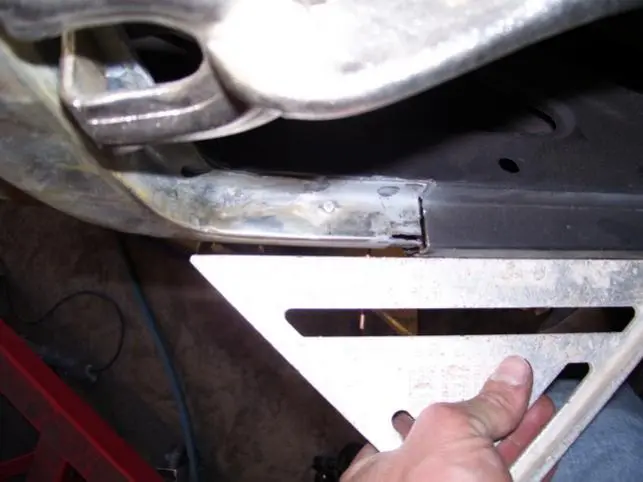

Tony R
May 29, 2008
102
Vancouver Wa
Apr 17, 2009
#13
  • Apr 17, 2009
  • #13
I just replaced the skin. The framework was fine but the roof looked like it was hit with a baseball bat in a few places and I didn't want to try to fill it with bondo. If I had to do it again I would go to the bottom of the rear pillar where the original seam is from the factory instead of cutting at the top. In this pic you can see how bad my panel fit.
