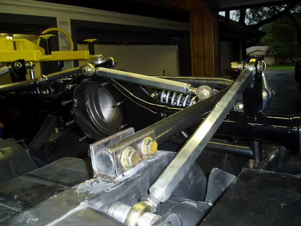

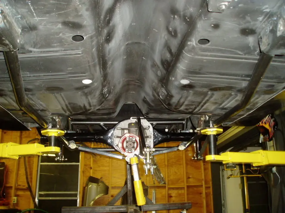

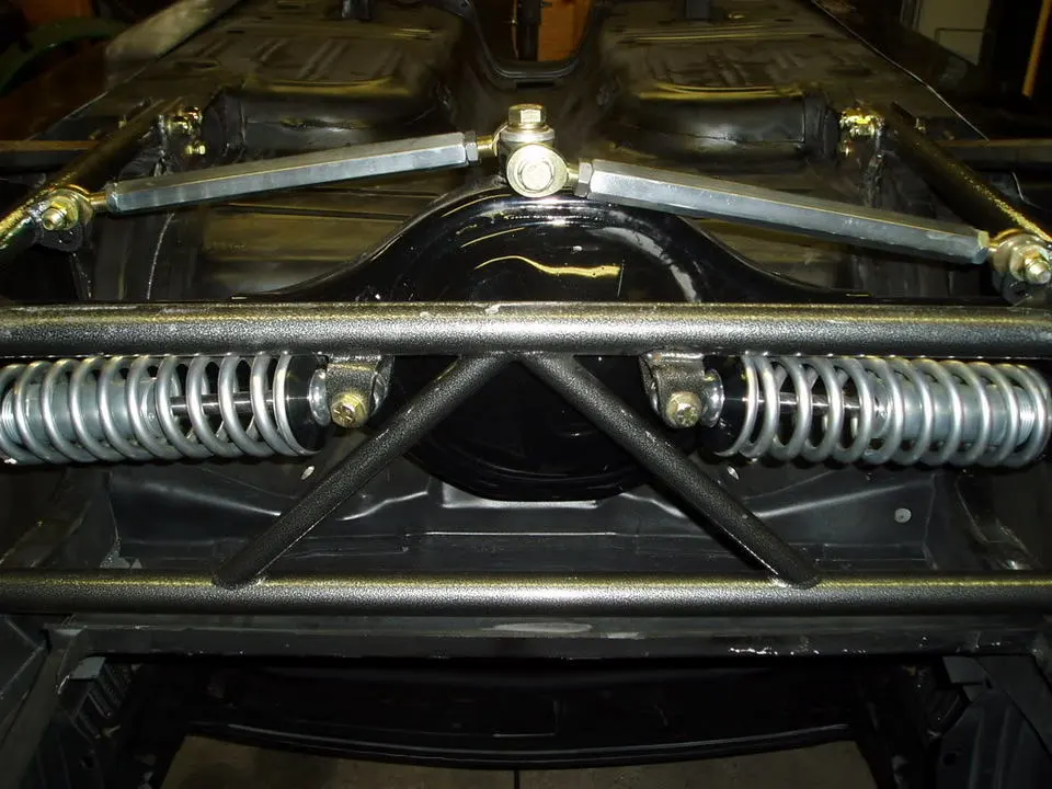

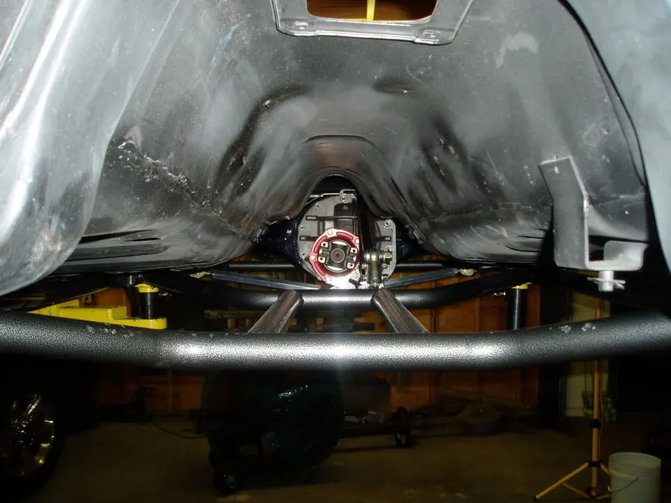

Got the coilover rear end home.
After carefully measuring, I tack welded it in place. Loosened all the bolts, measured again, and then finished the welding. I also installed side mounting plates to give additional strength.

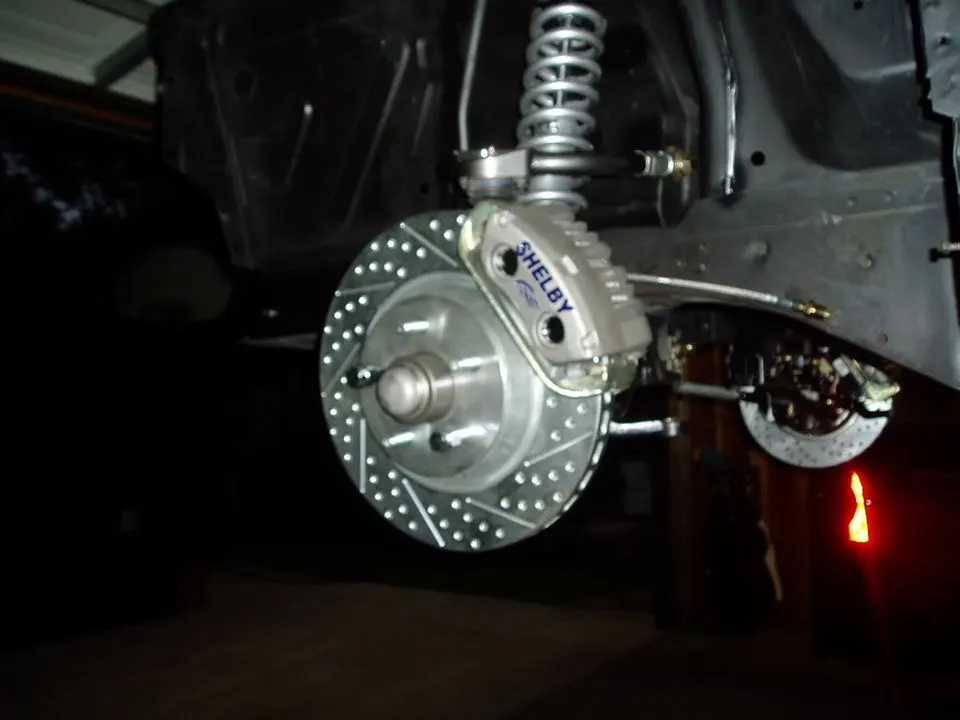

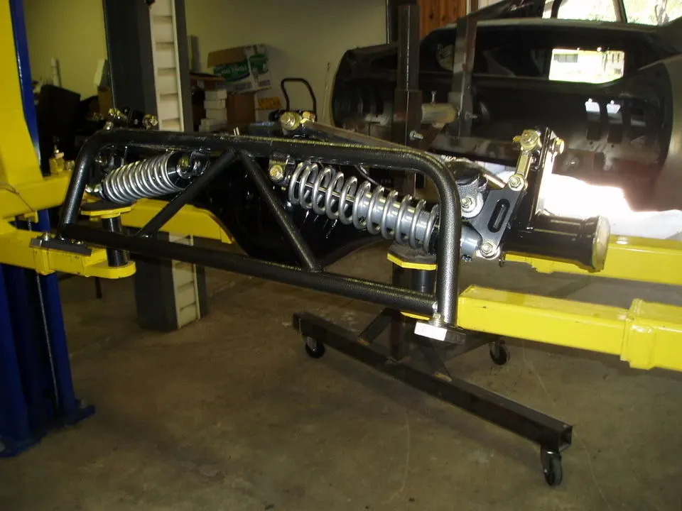

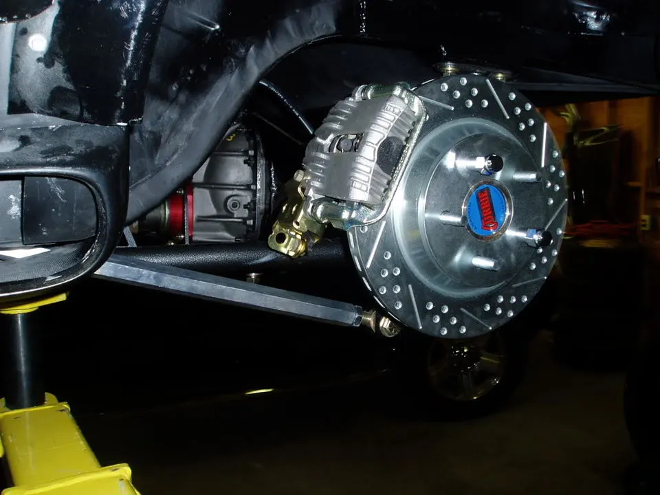

Got the chance to install the X Brace, Rear Shelby 12" brakes and lines, UP front coilover suspension and Shelby 13" front brakes. Wow, a lot more work behind the scenes that is not mentioned.

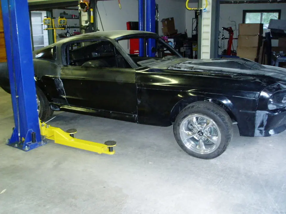

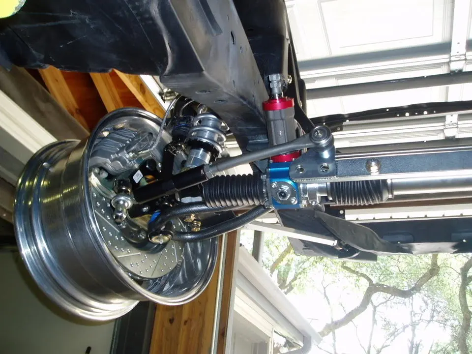

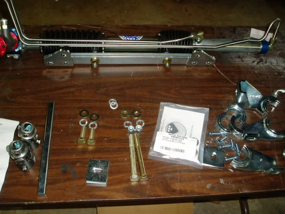

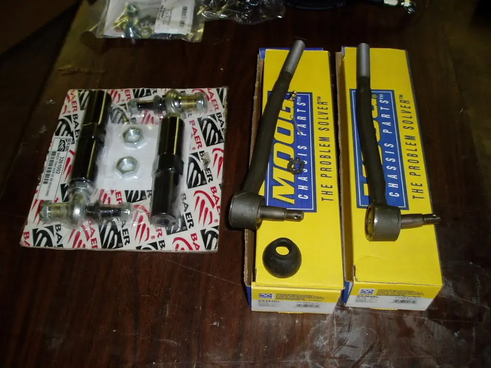

I got out the TCP Power Rack & Pinion, Baer Bump Steer kit, and installed them.
As if that weren't enough for the day, I dropped the car to the ground, removed the new wheels, put on the old ones. Then I rehung the doors with new hinges. After that I loosely hung the fiberglass on front.
