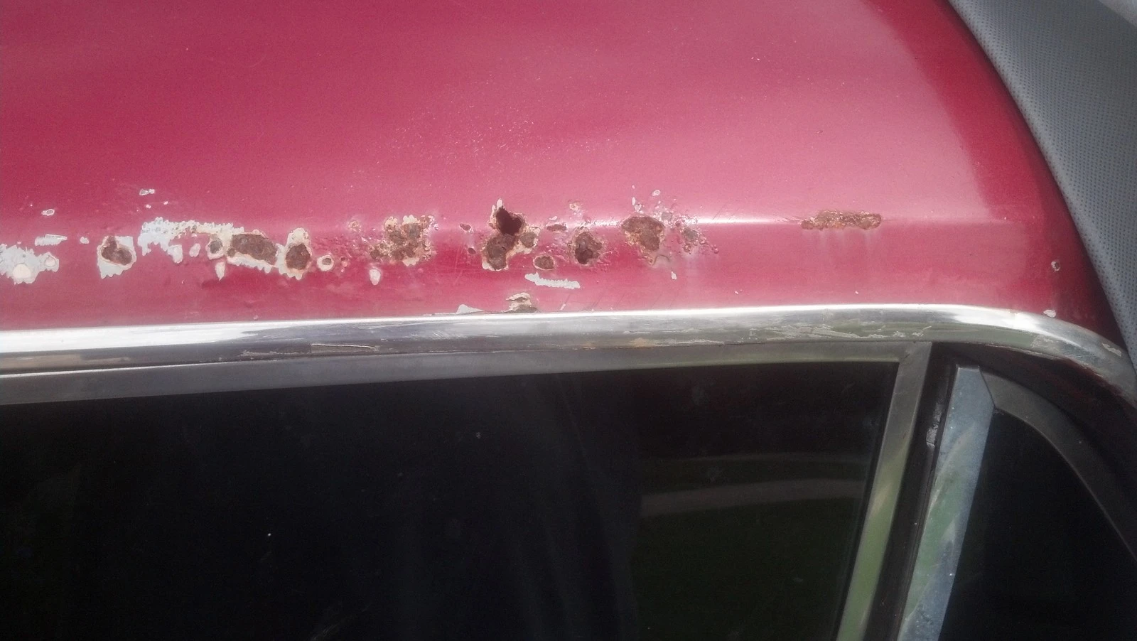

Hello everyone,
New to this forum. I just picked up a 68 coupe with significant roof rot in the A Pillars and the area just over both doors towards the front (no damage from the middle of the roof to the back window). My question is....does the aftermarket fastback roofs hold the same contour on the front half of the roof as the coupes and coudl i get an aftermarket and use it to replace the front 1/2 of the roof of my coupe?
Also, what are the advantages/problems with shaving the driprails? They are rusted through in several places as well.
Thanks for your input.

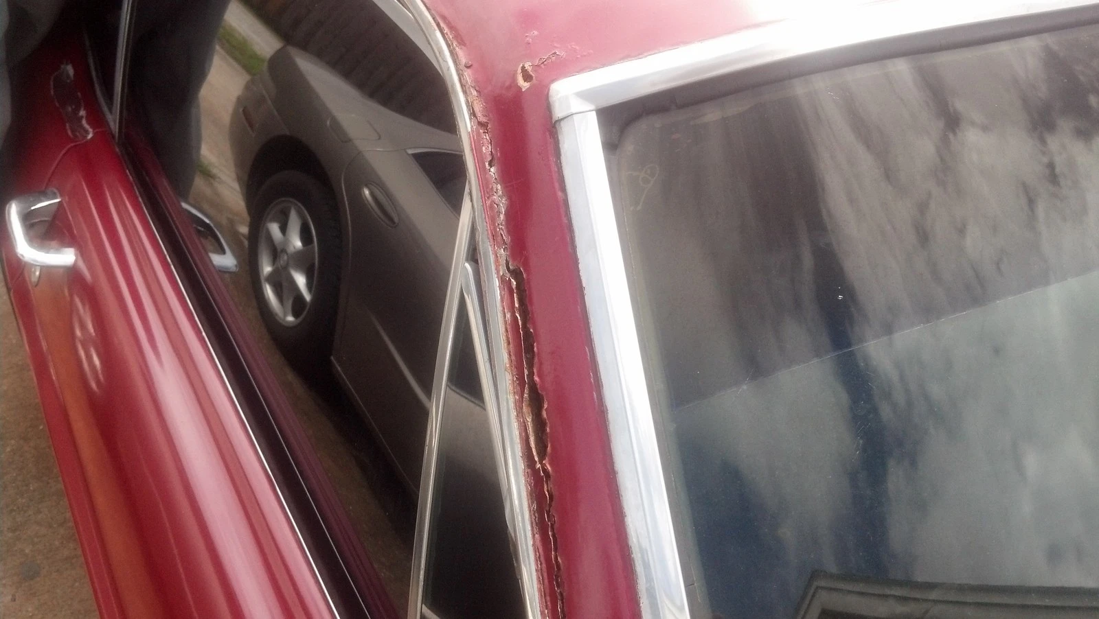

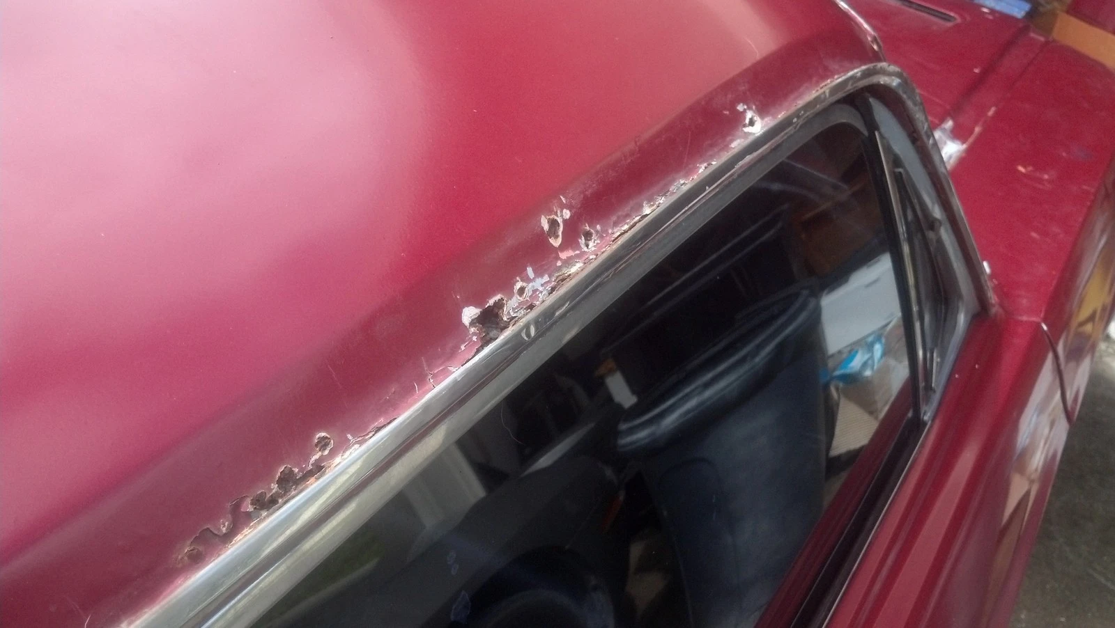

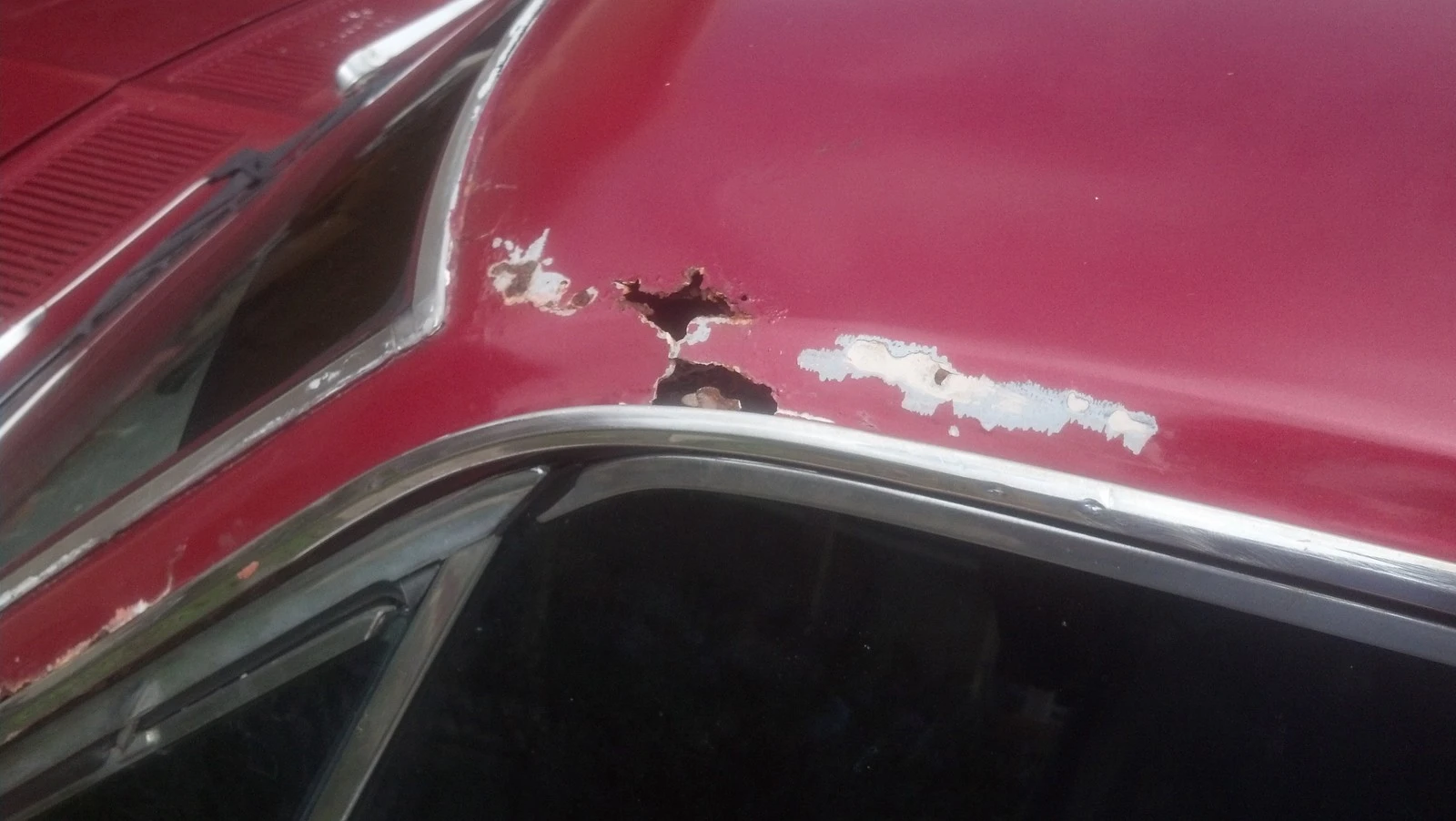

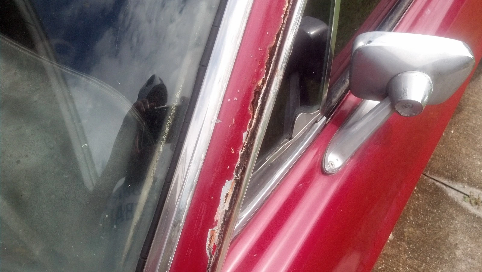

IMG_20130714_153625_203.webp IMG_20130714_153631_837.webp IMG_20130714_153656_419.webp IMG_20130714_153707_939.webp IMG_20130714_153718_510.webp

rlross20,
It sure looks like once you get into it, you'll likely need a whole roof, including at least the front pillar on either side of the windshield. If the floors are (amazingly) not also rotted, I would guess that car had a vinyl roof in the past. Vinyl tops, especially in Florida, are notorious for causing exactly the kind of rust, in exactly the locations you are experiencing. There is likely much, much more hiding under that paint. If I were in your shoes, I would strip that roof down to bare metal and remove the headliner to determine how bad it really is before looking for any replacement metal!
Just My $.02,
Gene
Horse,
You're right about the extent of the damage. Not sure if it was a vinyl top or not, but it does need floorpans as well as the roof. Also needs the trunk corners (typical mustang rot area). The hood and trunk skins are in decent shape, but the support pieces in each have rot as well. Definitely going to be an extensive project. Need to repair some previous front end damage that wasn't fixed right the first time.
Thanks for your $0.02. I will take any/all advice offered.
Ron
