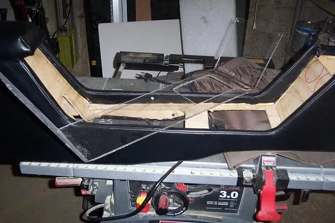

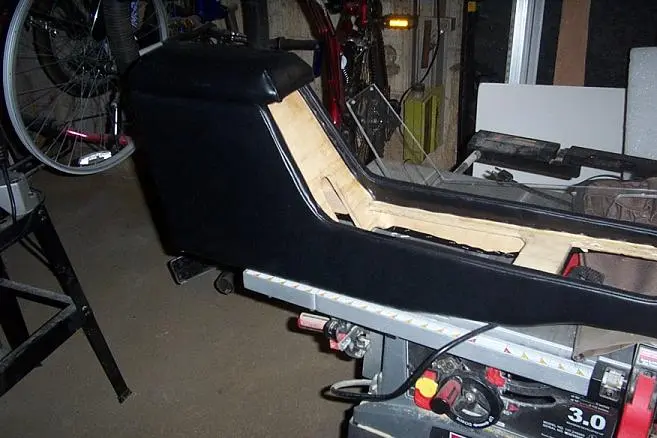

I made one similar to the Shelby console, Changed a few thing..center e-brake, aux switches, arm rest height etc.. I'm trying to finsh it using, are you ready for this........ aluminum shelving adhesive paper. I already used the paper to cover the beat up aluminum plate on my 67 overhead console. Can't tell the difference. Just need to find a way to mold lexan plastic for the brake lever area....

I do wan tto change the arm rest. I don't like the way the cover came out, but for a first time use of a sewing machine it's not too bad :p

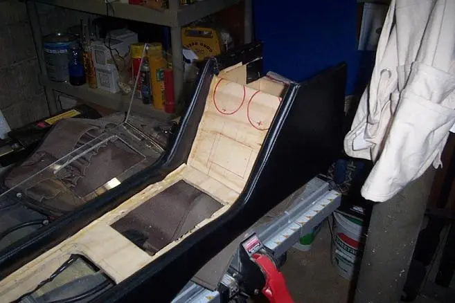

Here's another
The idea was to copy the Shelby console with a late model (mid 80's) arm rest and fit the e-brake. It's all 1/2 plywood that's routed, glued and screwed together. I borrowed my Mom's sewing machine and made the cover out of vinyl. I just need to find a way to mold a plexiglass cavity for the e- brake handle to rest in. The pic with the plexi on top is an insert that will be cover in the "shelf paper".

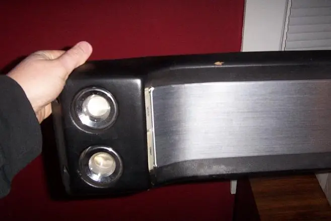

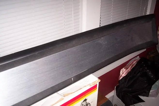

I'll post some pics of the upper console when I get home today. It's a stock 67 coupe upper with the paper over the original aluminium plate. The plate was scratched up in storage and my move back to NJ from FL (still not sure why...). The paper is pretty thin so it conforms to irregularities well that there are a few dents in the overhead panel that are visible.
tweet, i like your affordable bling alot. For molding lexan, try a wooden block shaped to the mirror image of what you need and throw it with the lexan sheet on it in a low temp oven or use a heat gun. It is formable. Good luck.
