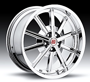

Finally bought my new wheels for my 68 Vert - Shelby Chrome CS67:
I'm running a Rod & Custom Mustang II Front Coil-over Suspension And Their 4-link Rear Coil-over suspension
Front - 18x8.5; 6.4" BS; +42 Offset
Rear - 18x9.5; 6.82" BS; +40 Offset

I tried 285/40 18's on my car with a TCP Gbar rear and had some serious rubbing issues when the axle articulated. The tire rubbed all the way through the paint, 2 weeks old and driving in the driveway the first time, and destroyed a brand new tire. I had to to go down to 275/35's and now everything is good. I have the same tires you are looking at and the next time I need rubber I will find some that are 285/35's in a different tread.
They are really pretty and so far are working very well. I drove the car in the rain today for the first time and it was sure footed. I didn't get on it much but for sane performance driving it was good in the wet. On dry pavement I think my car handles as well if not better than my Lexus IS 300. Some of that is the suspension I am running and some can be attributed to the tires.
I was worried about backspacing, but they look like they fit fine as is. Plus I'm probably still going to mini-tub when the rear quarters are replaced. I'll probably have the tires on next week sometime, trying decide if I should go local or buy from the tire rack. Local is a little more money, but they mount and balance them; plus if I have to change sizes later they said they would do it. I've been getting our cars serviced at this place for years.
