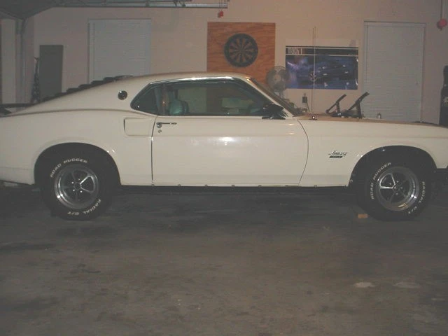

I couldn't help but jump in here because the setup you described is what I did on my 69 except the front springs are 600's and I have P2357014 tires. If you take under consideration, that between our tire sizes we have almost the same total height, I had about 2-3in clearance between the top of the tire and the fender lip. This was similar to the rake look you see in the previous post which was too much for me. So I then installed 1 in. lowering blocks in the rear and now it looks great. This would point you to the Mid-eye instead of the standard 4 1/2 leafs. :shrug:

I will get you a photo and let you see as for what 68 Darkhorse said yes that car has shackles to raise it up but when you install those new 4 1/2's you will think that you haid a pair of shackles, especially because I did the shelby drop. All I can tell you is what my real experience with my setup is, maybe 68 has a 69-70 as well?
Did you say that you did the Shelby drop in front? It is hard to tell by looking at the picture, but it doesn't look too low. The rear looks a bit high but with my 265-50-16 tires, maybe it will fill the fender well out and look a little better?????
Yes, I did the Shelby drop up front and I think the front is just where you want it about an inch above the tire. The only thing you have to remember is that my hood is not installed and front clip so if anything it might come down just a little more. Remember the rear is with 4 1/2 leaf springs and a 1 in. lowering block installed, that's why I would go with the Mid-eye or even reverse. The only thing I don't have in the back is the spare but Ialso have the fold down seat option which adds a few pounds.

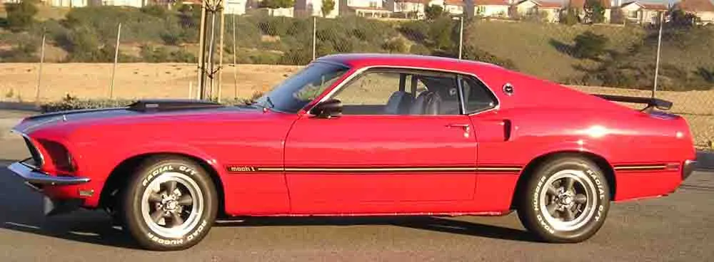

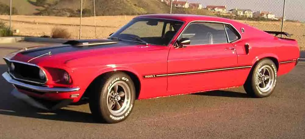

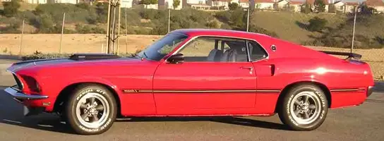

I wasn't going to post my car, but it might give you an idea of what you might get with mid-eyes. My car is lowered about 1.5" in front and I used 5 leaf mid-eyes in the rear. I don't think the number of leafs should effect ride height, but rather the rate of the springs. The tires are 215/65/15s... Anyway, here it is...
attachment.php
Overall, I'm pretty please with the angle of the stance, but want to lower it a bit more yet. I'm still waiting to see if the rear settles before deciding about lowering blocks. I'm definitely gonna lower the front a touch more.
Hope this helps... :shrug:

I like the 5 leafs a lot... the suspension is taut but not overly harsh or bone jarring. Its important to remember that the springs are part of a system, including the rear bar, shocks, chasis, etc. With that in mind, I think these same springs would feel very harsh and brutal without the subframe connectors, the shocks I'm running (Monroematic Plus), and the rear bar. Previously, I hadn't realized how much chasis flex and body roll control definitley contribute to how springs feel.
Anyway, the general rule is either stiff spring & soft shocks, or soft springs & stiff shocks. I'm not sure which is better for the street, but so far I like setup I've got. I need to put more mileage on it (less than 500 miles currently) to get a true sense though.
