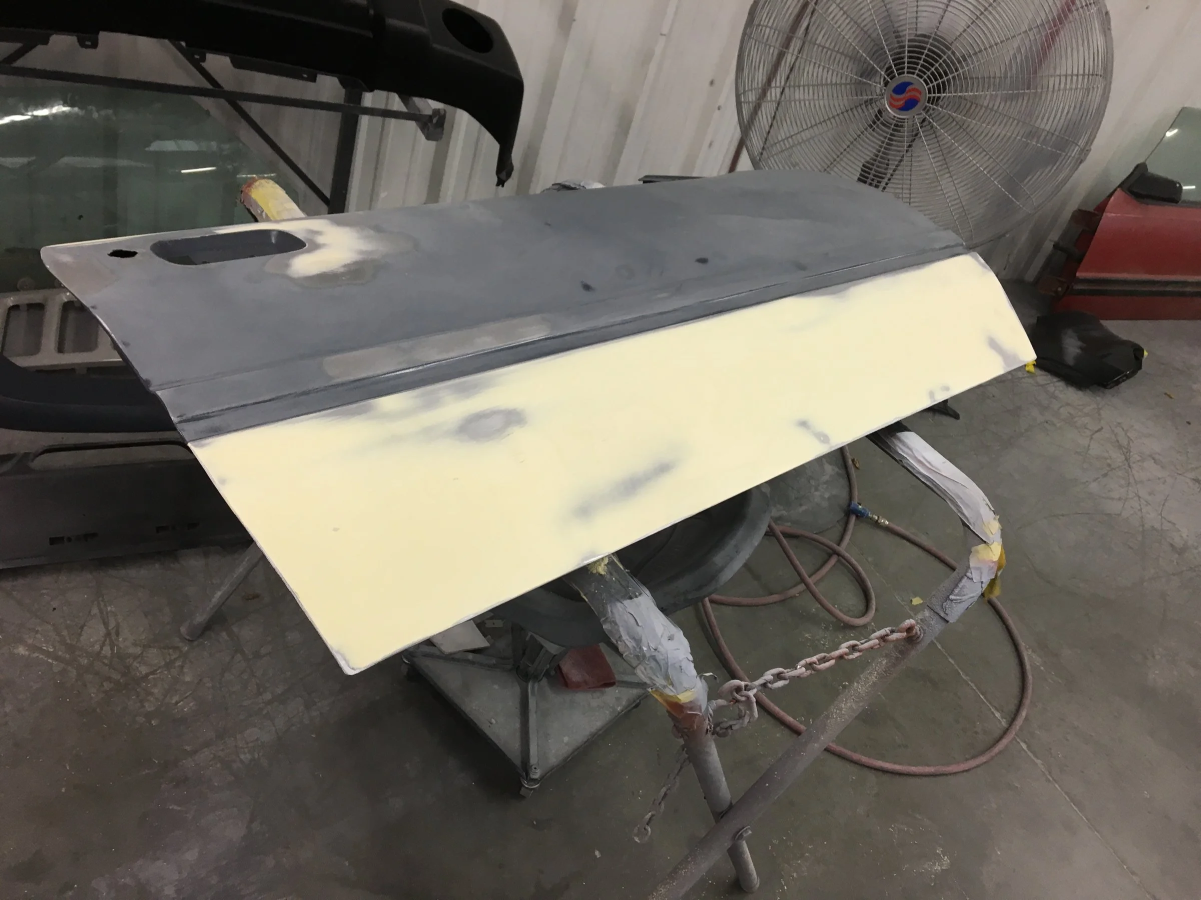

So you etched the door, primed the door, and then took it back down to metal for Bondo?
Yes sir. I etched first because it was a hunk of bare steel just dying to rust. Then I primered it to get a good idea of every single dent in it. I found these through blocking the door down with 220.
Once I found all of the dents, I pushed most of them out so I could use a light glaze coat to finish them off.
Then, to provide proper bonding for the mud without the varying adhesion problems of mudding over various substrates, I stripped the primer completely off in those area and laid the mud out.

There's the mud on the bottom of the door, I know it looks like a lot, but it's not. It's a very thin coat. And boy is it straight now! No ripples, no nothing!
I still have to put a little glaze across the top of the door where I welded up the trim holes.
Ahhhhh gotcha
