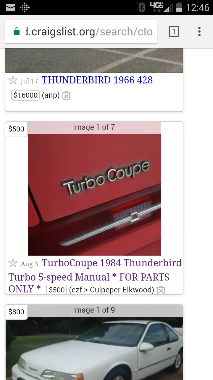

Do not confuse Super coupe w/ Turbo coupe. One is a Fox and the other is a MN12 Chassis. Big, wide, and stupid. I cannot see anyway in hell that any part from that car would fit your car,..and even if they had an IRS, it's not gonna be the coveted Cobra IRS.
Engine harness/ECU/ accessories and the related bracketry to drive the huffer,..the rest of the car is unusable I think.
