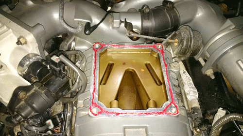

I just looked at the supercharger pics again and damn, did the PO have like a caulk gun of orange Permatex or what?
Speaking of which... Cut your own gaskets out of material designed specifically for mating aluminum to aluminum and forget the sealant altogether.
Edit:
Or maybe the clear red stuff. I remember using it on the KenneBell.

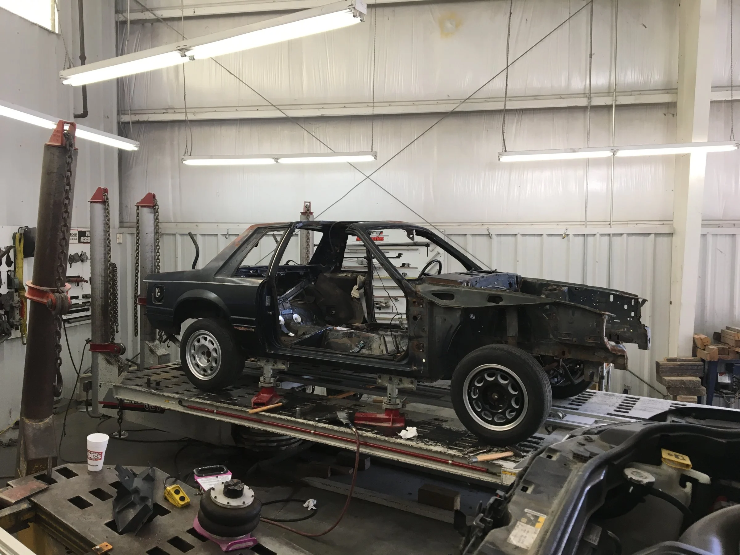

Finally had time to put Scuby up on the frame machine today. I was pretty thrilled we had the measurements in our computer for fox mustangs.

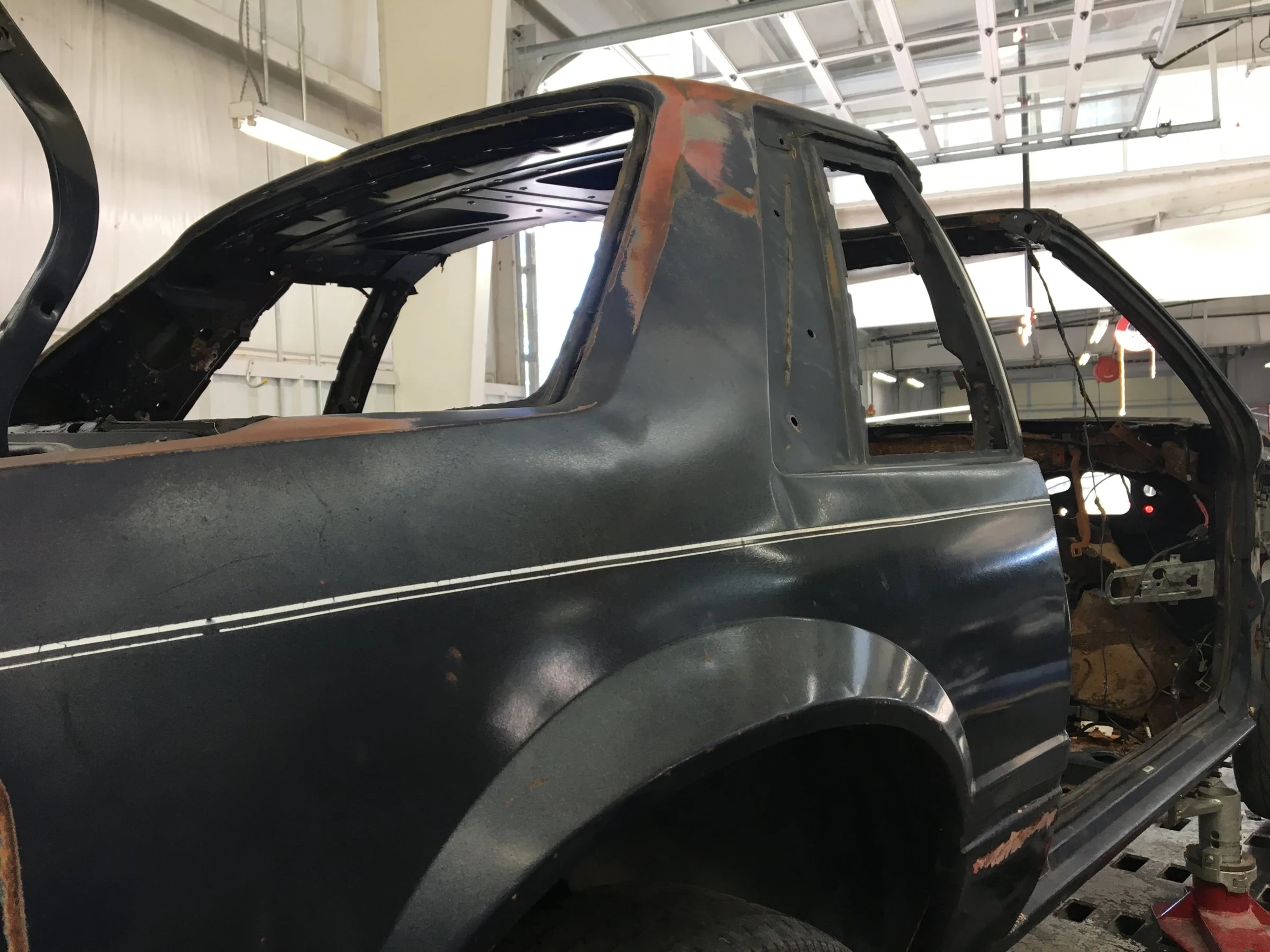

He was out a little bit on the right rear, pushed up and out a little. A couple tugs backwards and downwards and the tweak on the right quarter sail panel area popped back in.

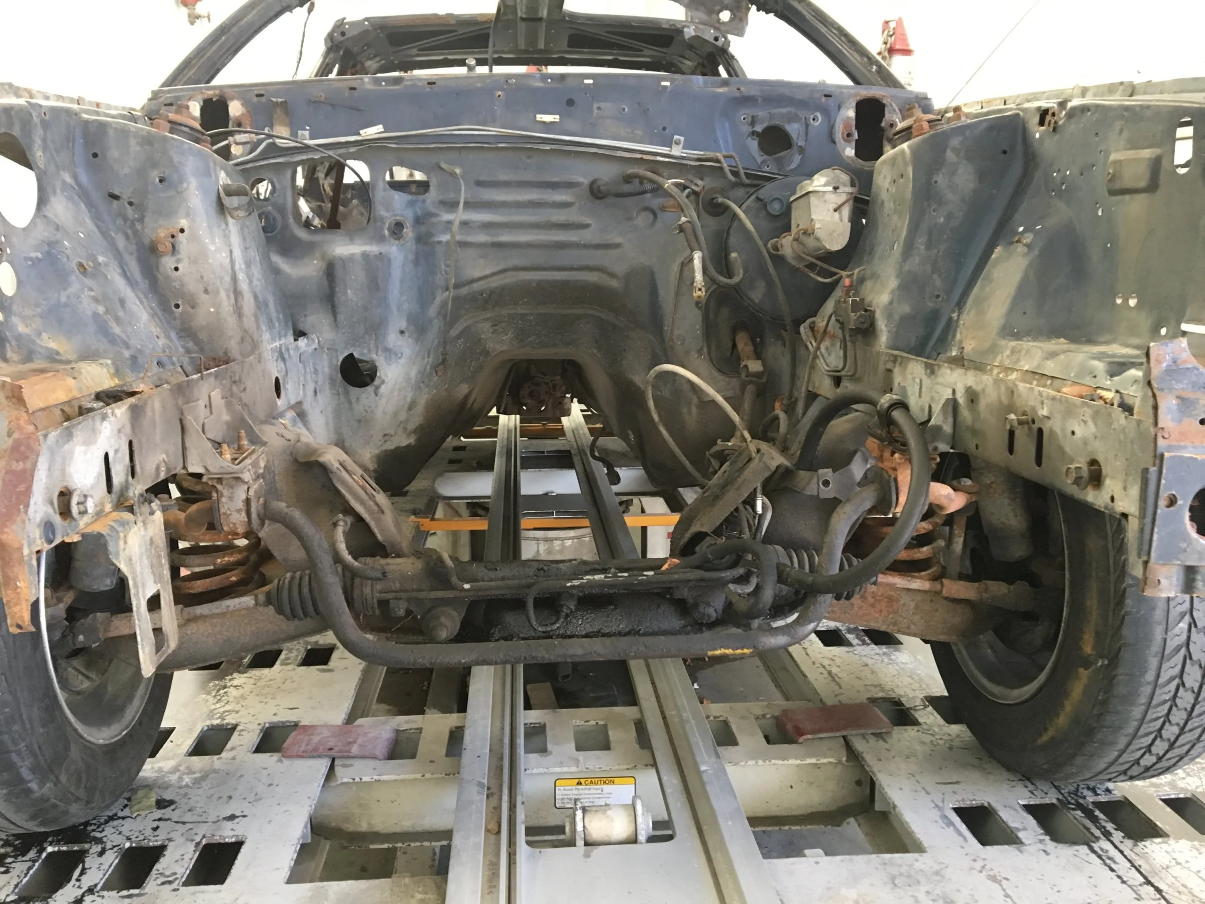

From side to side the rear subframes are different by 7mm now, they were close to twenty at the beginning. This is plenty good enough now for me. Hell, just watching that big outy suck back in was good enough.
The front subframes are marvelously straight and even between sides.
I’ll drop him down off the frame machine tomorrow and he’ll head back to the storage unit.

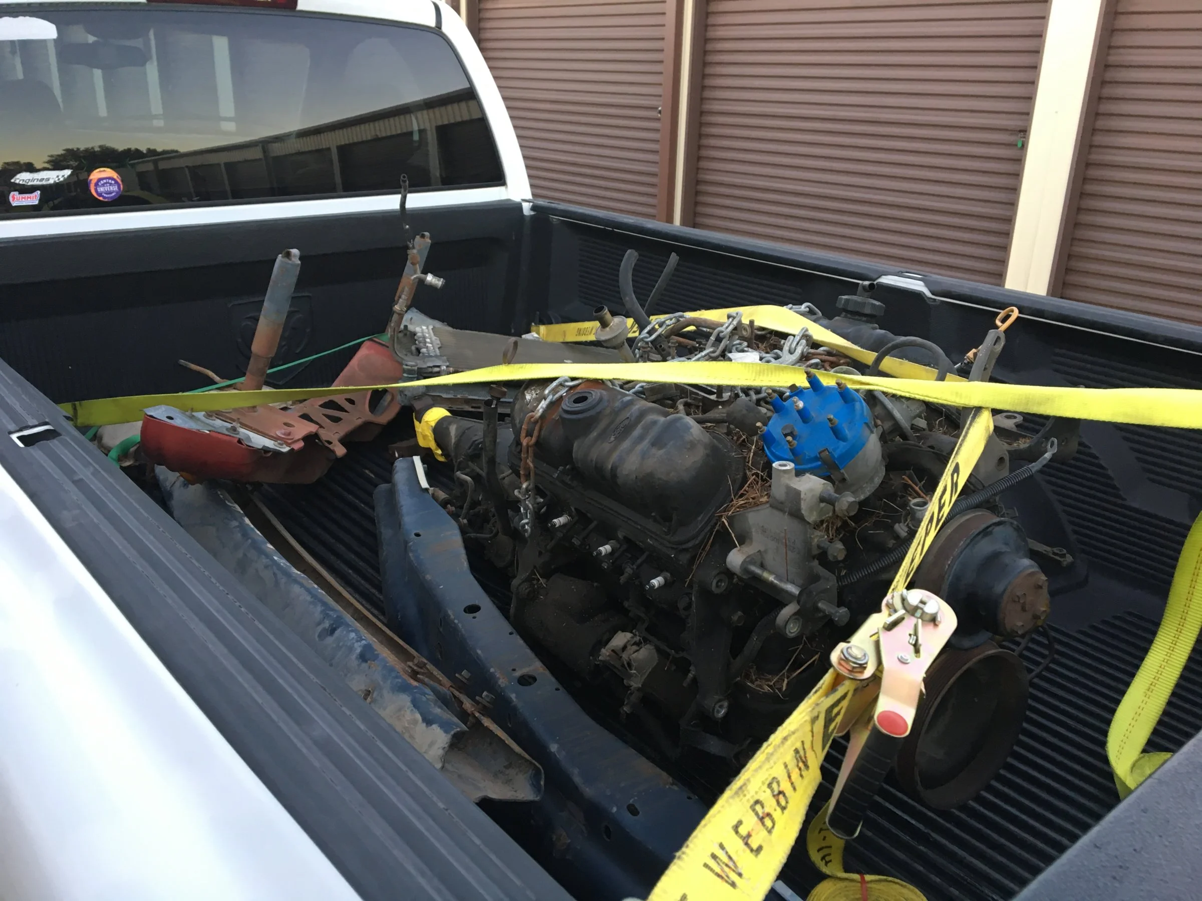

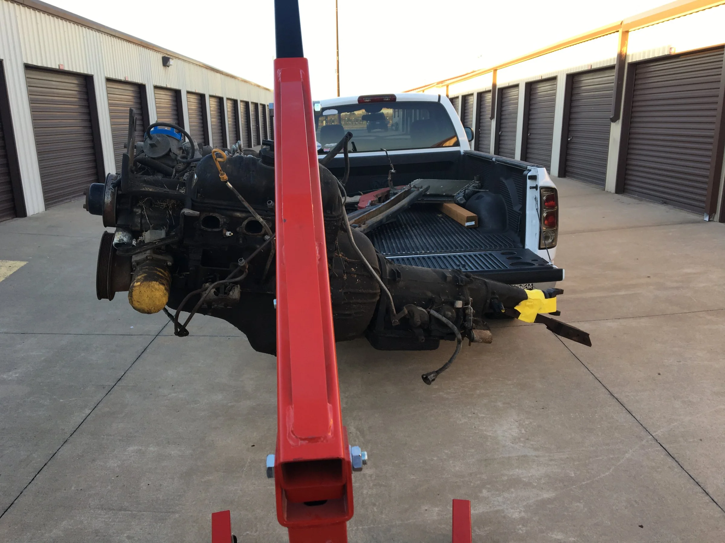

Nothing big today, just loaded up the old engine onto my pick up without any breaks, gouges or scratches on my body. I'm pretty proud of myself.
It seems like I can go buy new pillows and end up with a four inch gash on my forehead.
I'll be dropping it off at the yard tomorrow night.
Dave have you considered keeping the brackets and pulleys off the old motor,maybe the distributor any other might be hard to come by parts?
I would Chris, but the SC engine is quite a bit different. And, oxymoronically, similar at the same time.
I am keeping all of the SC brackets for right now though. There will be a bunch of modifications with this engine as I develop a way to make it look "right" in Scuby's engine bay.
