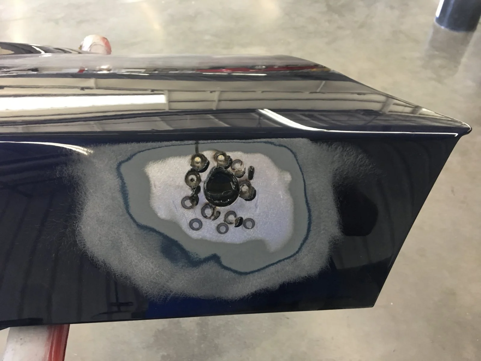

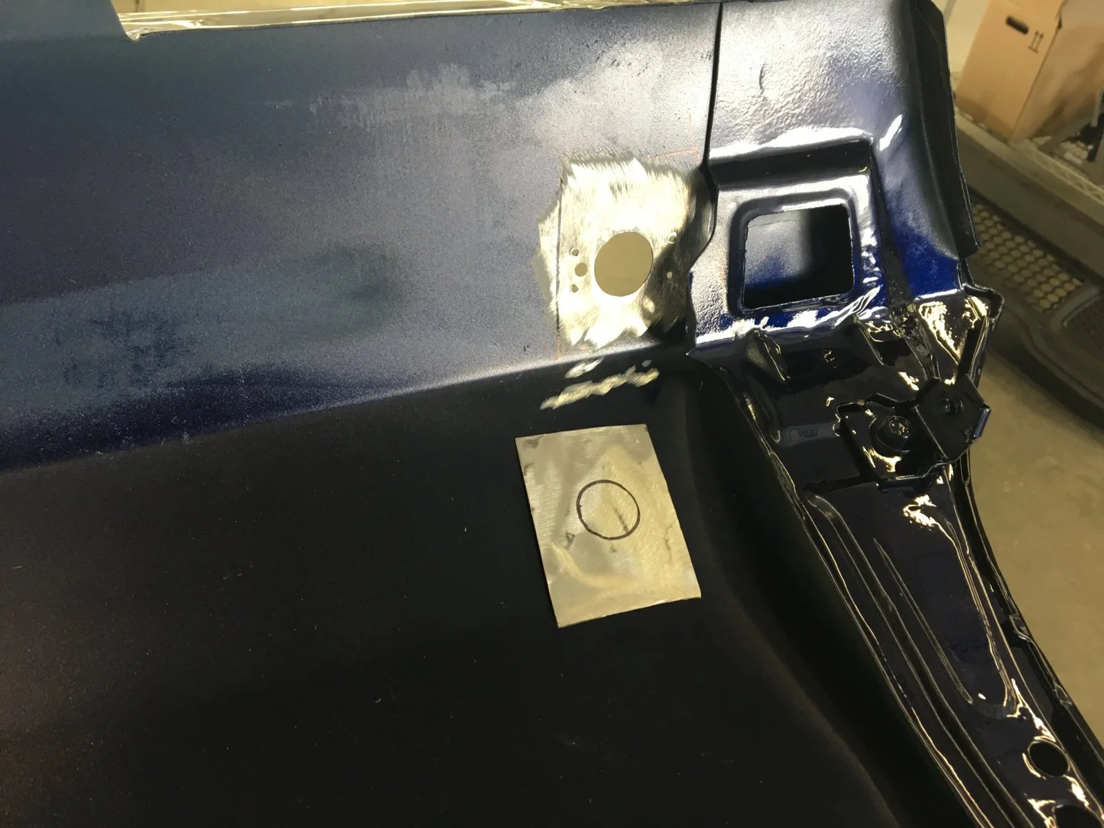

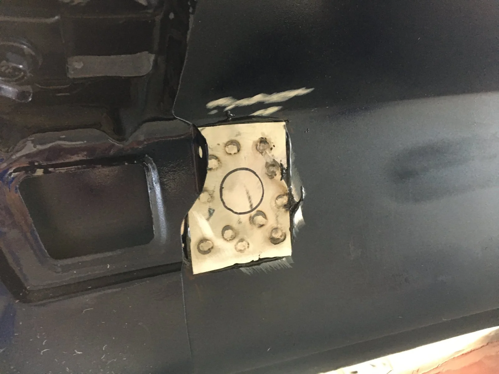

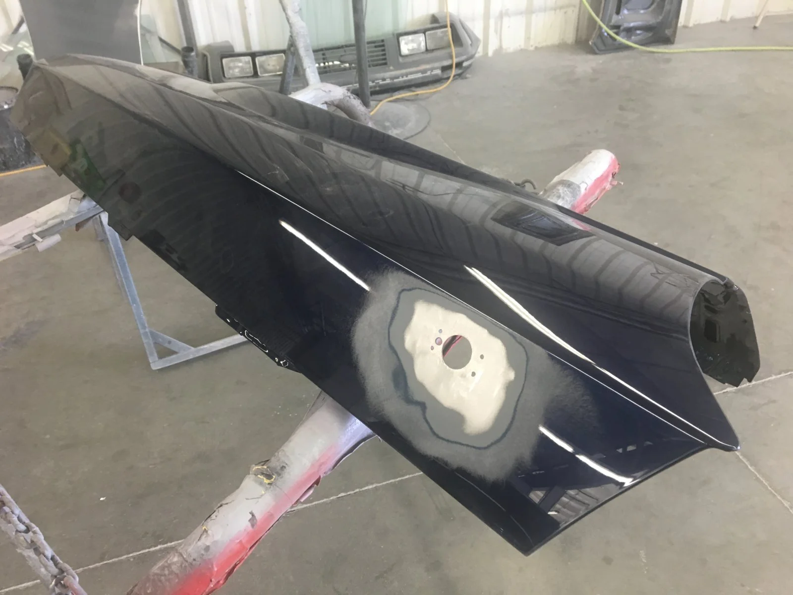

I decided to shave the antenna. I will be putting one of those button roof antennas on the roof (eventually).
One of the bodyman here convinced me that this is so much easier than cutting out a 1.125” blank and spot welding that into the hole.
What I did was to take a small piece of scrap metal, grind around the antenna hole on both sides, smeared some of my favorite PBA on the piece, stuck it in place and pinched welded it.
I didn’t know that I could weld through PBA. I definitely just did though. In addition to added strength, the PBA will seal the bare metal. It is ferociously attached now.
Another new thing to me, an electrical charge hardens the PBA almost instantly. Kind of neat.
