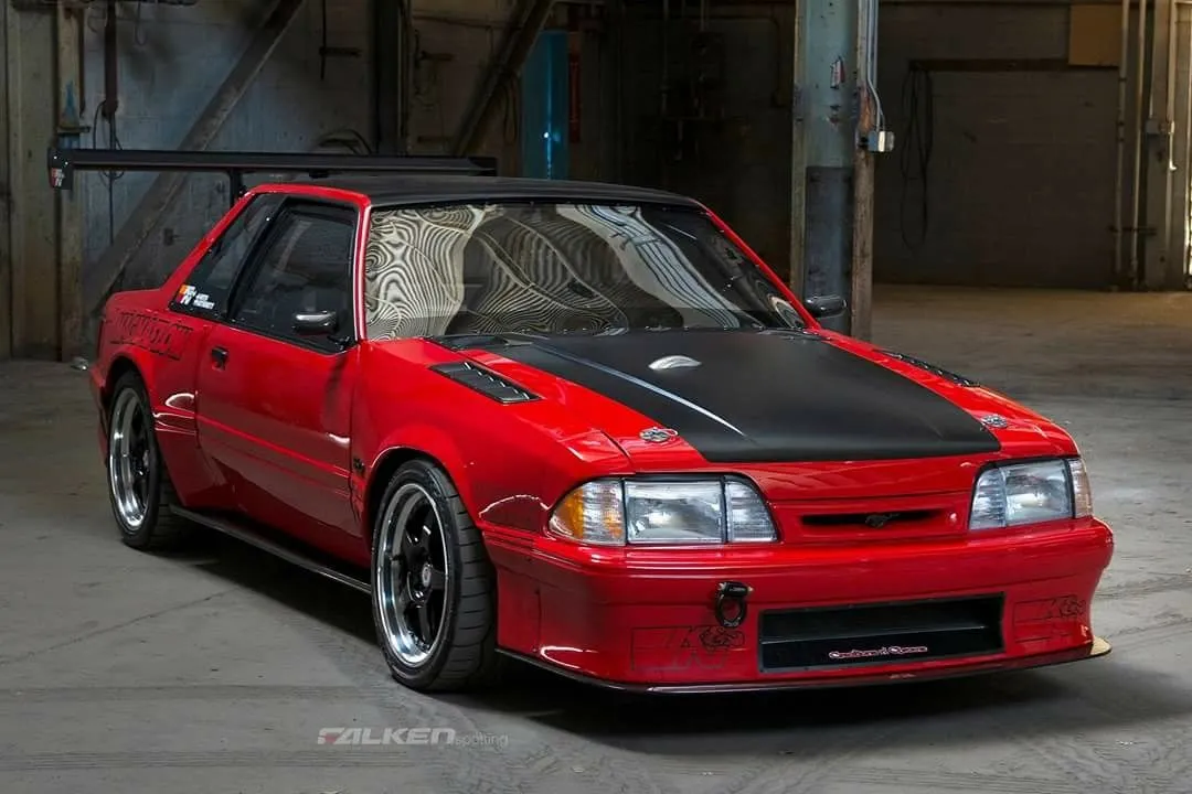

Another view of that pretty mustang. Are those Maier flares?

Yep, Maier Racing flares. You can get them in 1.5" or 3" (I personally am going with 1.5"). I like the fact they replace the entire front fender and can be blended into the back quarter fairly easily. I don't like riveted or bonded on flares. Last I talked to them, they can also offset the front fender wheel opening to match offset control arms so you don't have that "too far forward" look of the front tires.
Are they metal?

Fiberglass. So yes, the rear will needed to be bonded and then blended. I know it's hard to not get a line/crack to appear where the two materials meet together, but I've seen it done successfully. And I know you have skillz
Hummm......I could make them out of scrap metal for next to nothing, just a little time is all.

To make the quarters look like that flare I will have to cut the skin off and mini tub the outer tub with a taper leading to the rockers. Then I’ll start fitting the original skin back to it. Trim here and there, split parts of the panel and patch, patch, patch.
It won’t be a new skin I’m making, I’ll be heavily modifying the original.
