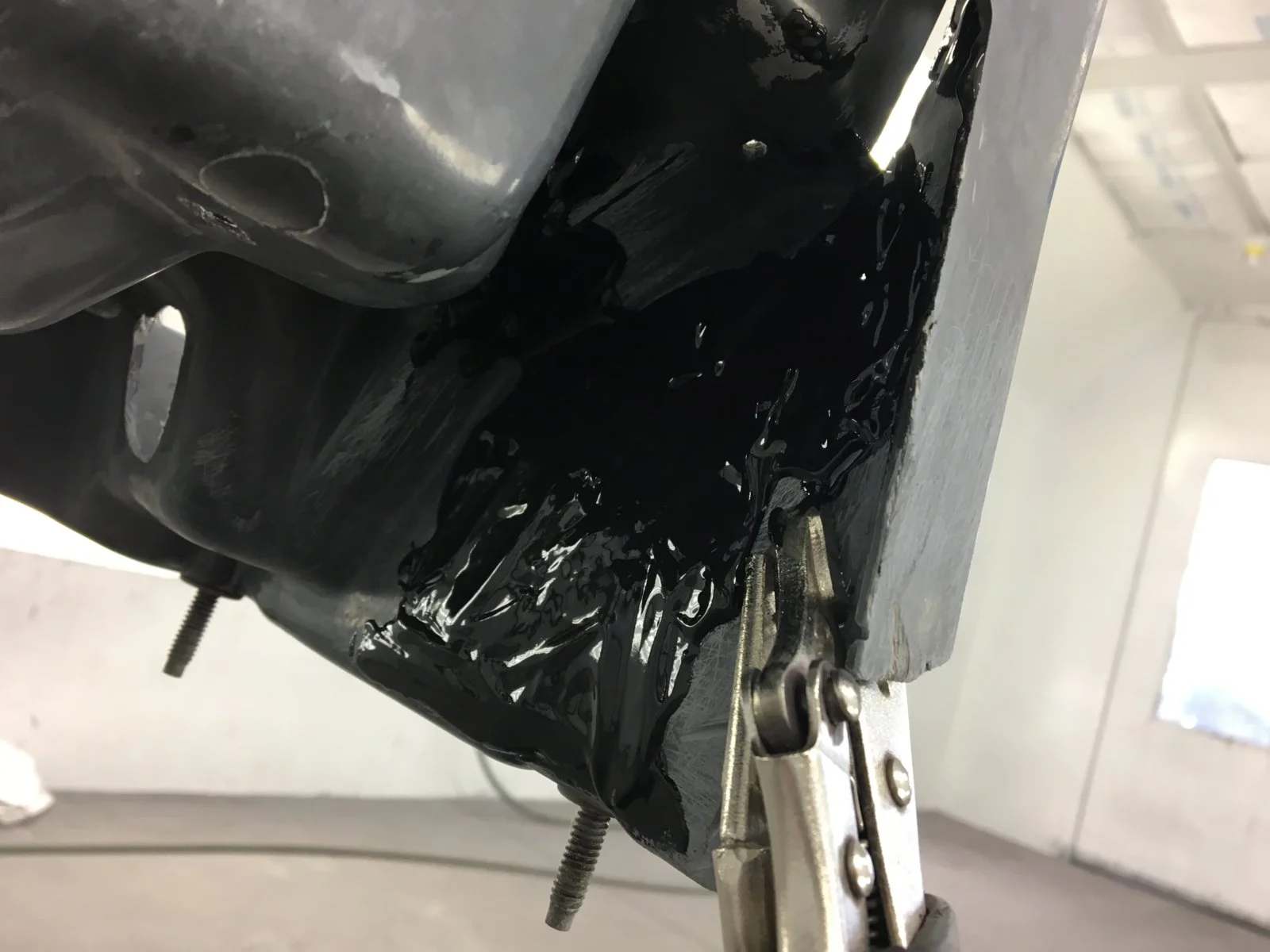

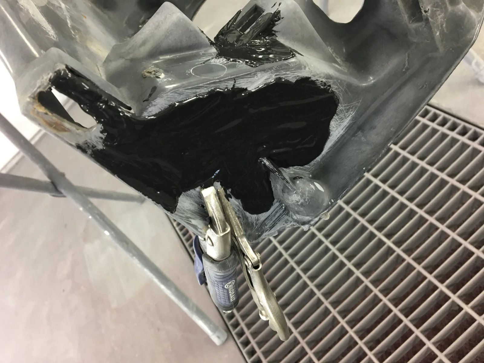

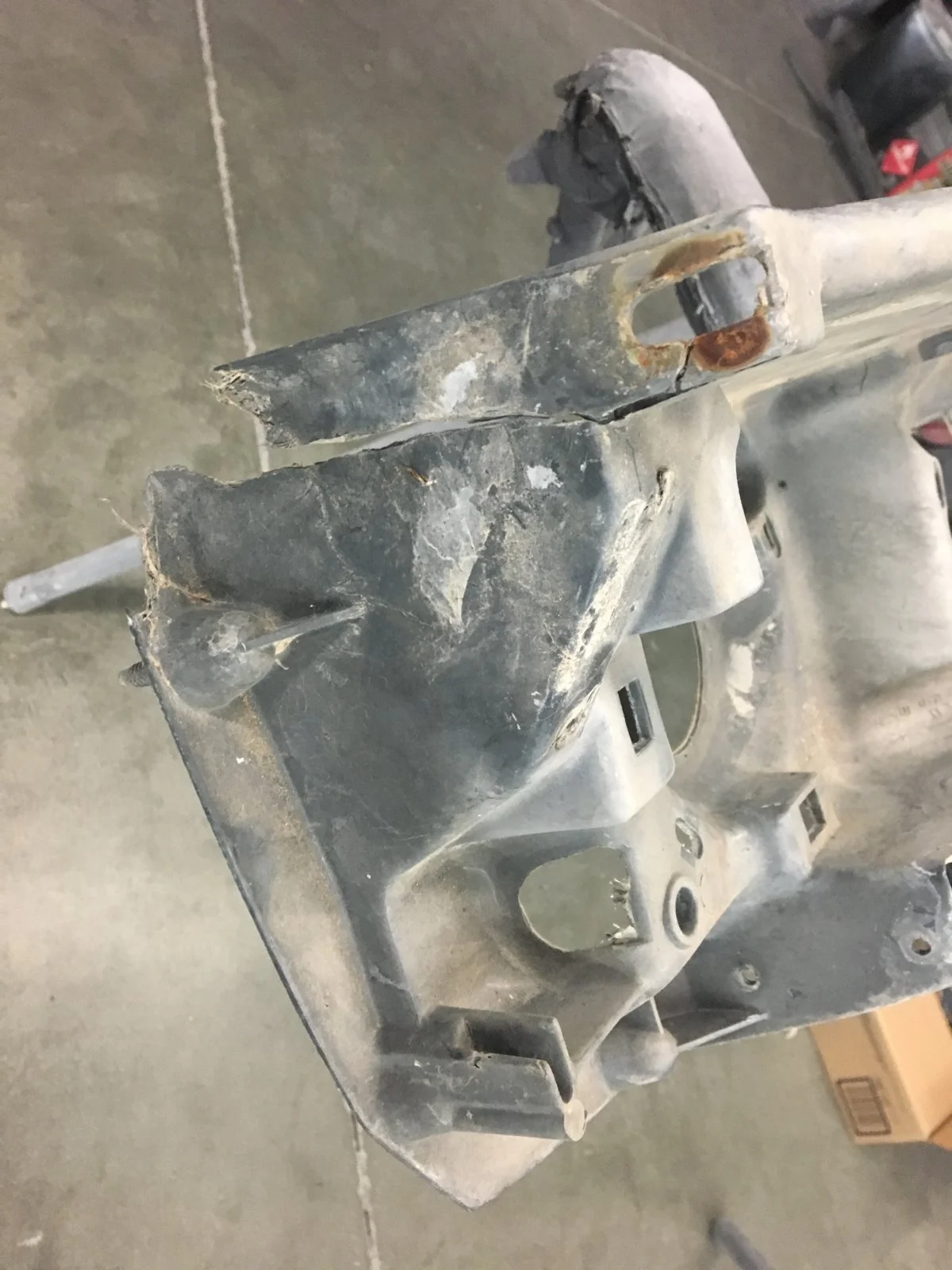

This repair will have to be done in steps.
I fixed the inner area first so it would all line up again. I baked it in the booth for about an hour so I can probably do more this afternoon.
I’ll have to build the edge now.
Ah well, pictures of the first part.

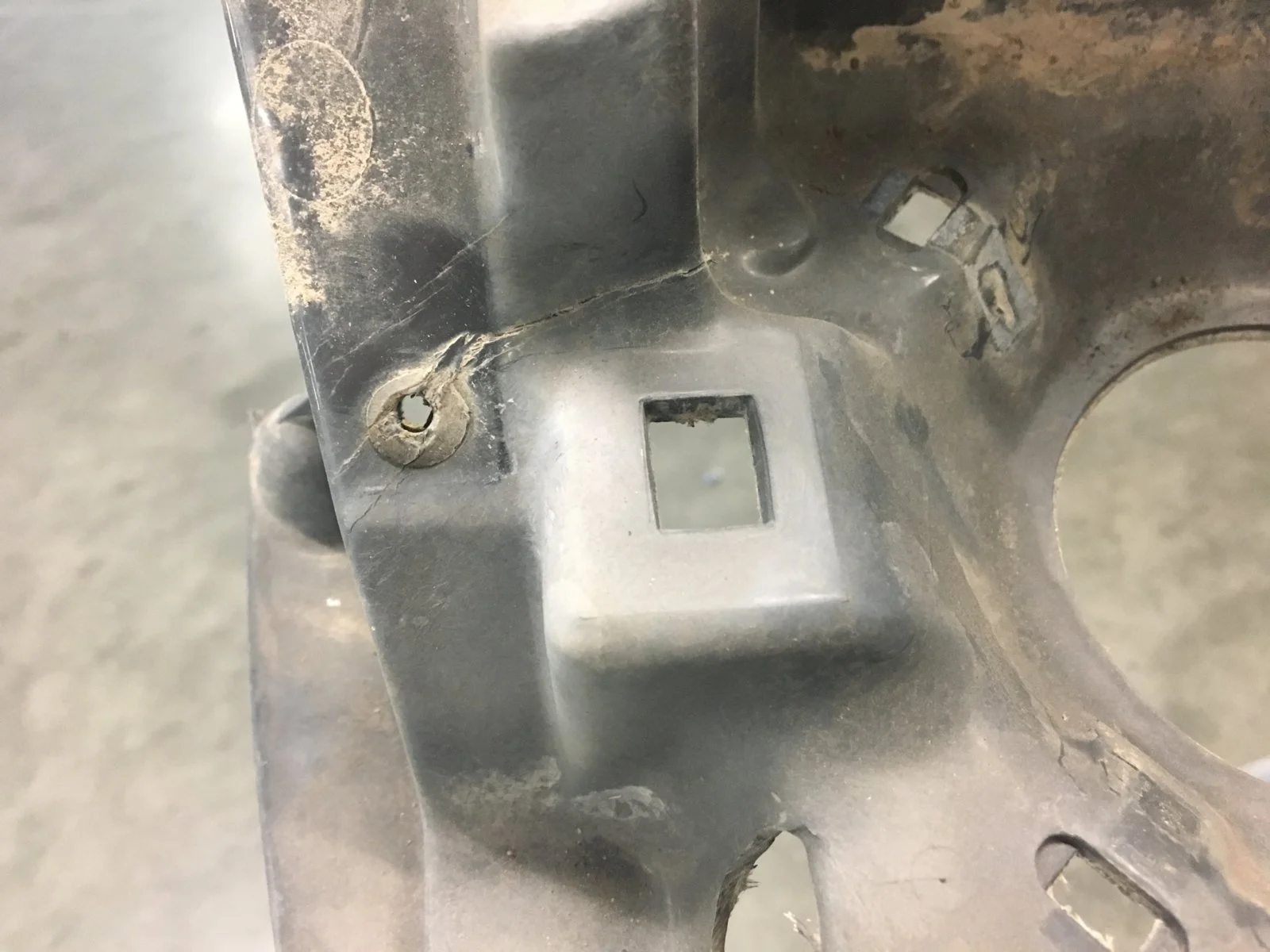

I used a cutoff wheel to clean up all the cracks first and made some criss cross cuts to give the PBA more to bite into. I also sanded the whole area with 40 grit before spreading the PBA.
