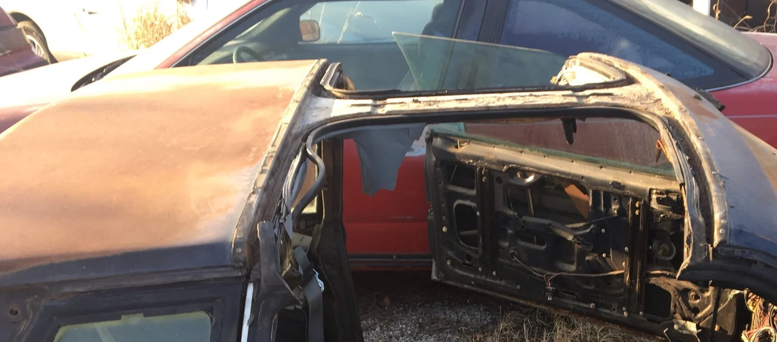

I spent some time looking at the roof as well. I believe I'm going to drill out all those rivets for the t-top and send the brace off to be sand blasted and powder coated. It's just ugly enough to need some special attention. This will allow me to completely take all of the rust off of the roof as well. Right now the rust goes up underneath the t-top frame.
