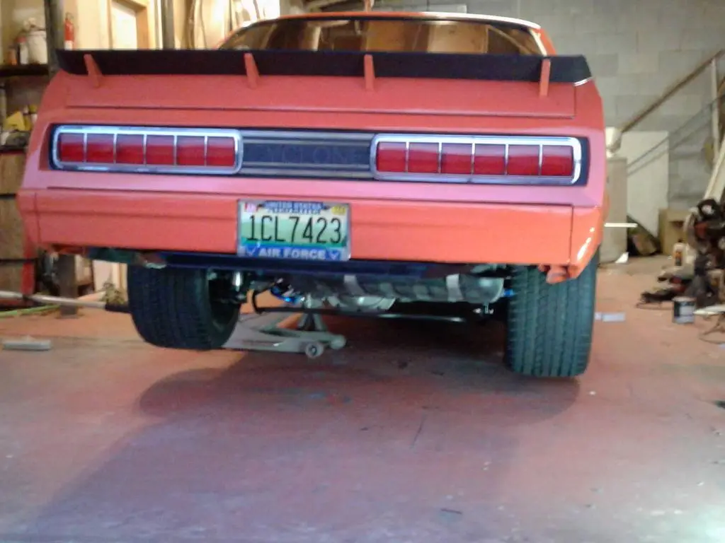

when I mentioned about frame flex earlier it didn't occur to me that the engine was out so yeah it shouldn't be a big deal I would think
I still thought about bracing it though, the t-top structure doesn’t provide a lot of support.
But, as you can see, I didn’t. I really think it’ll be fine.

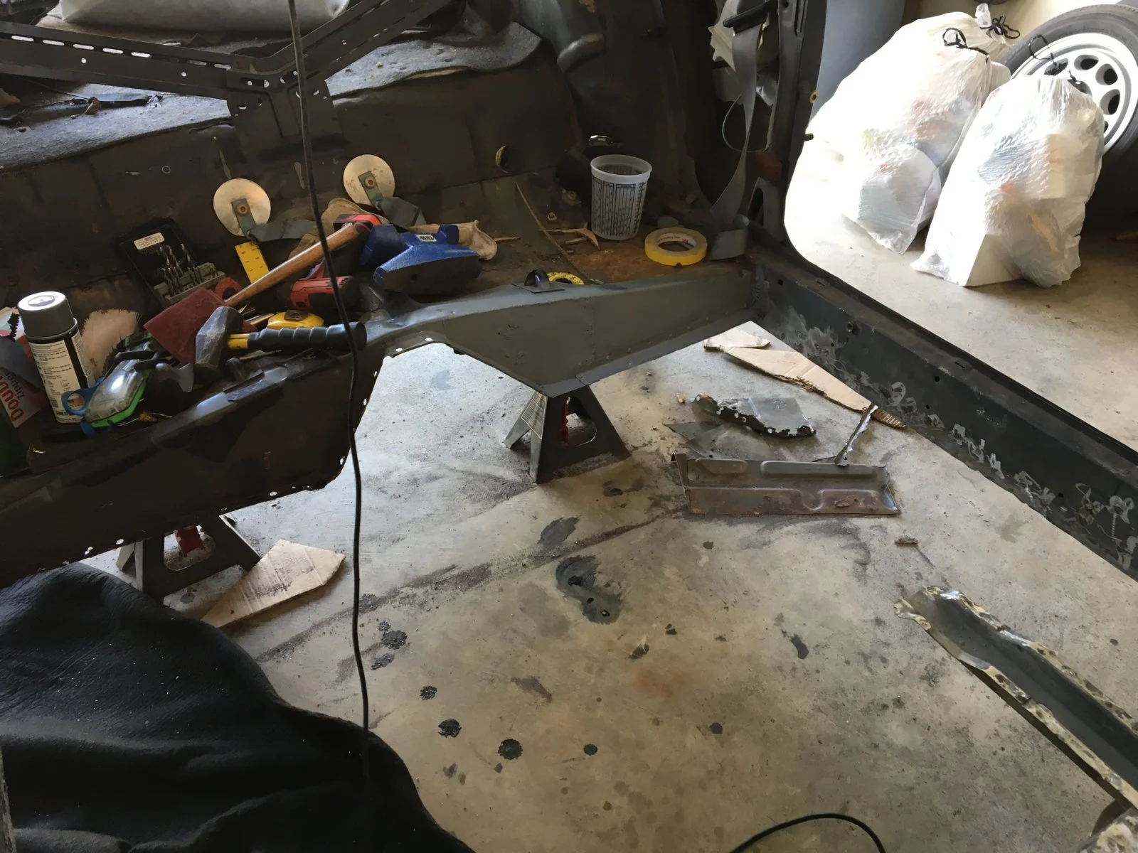

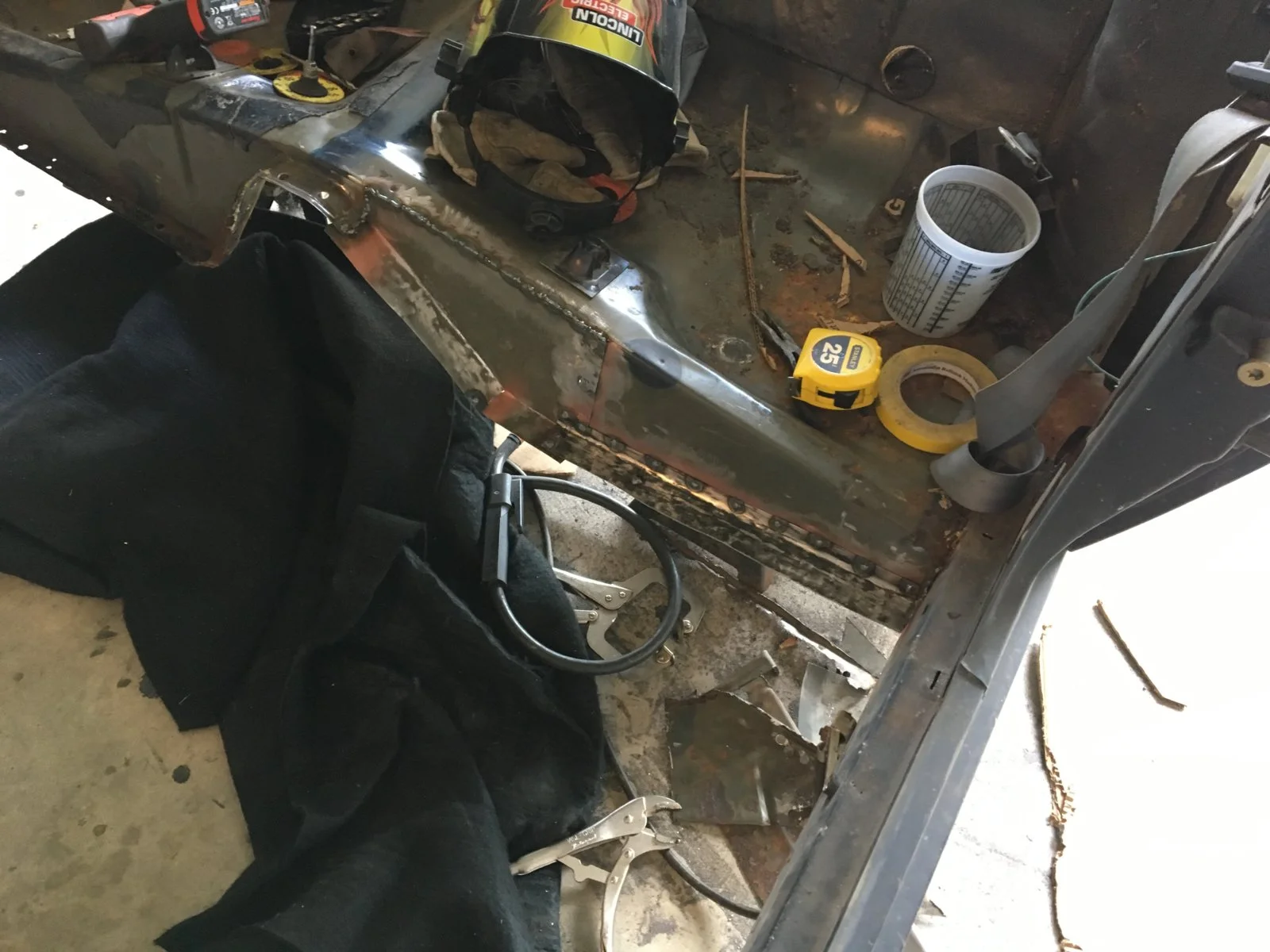

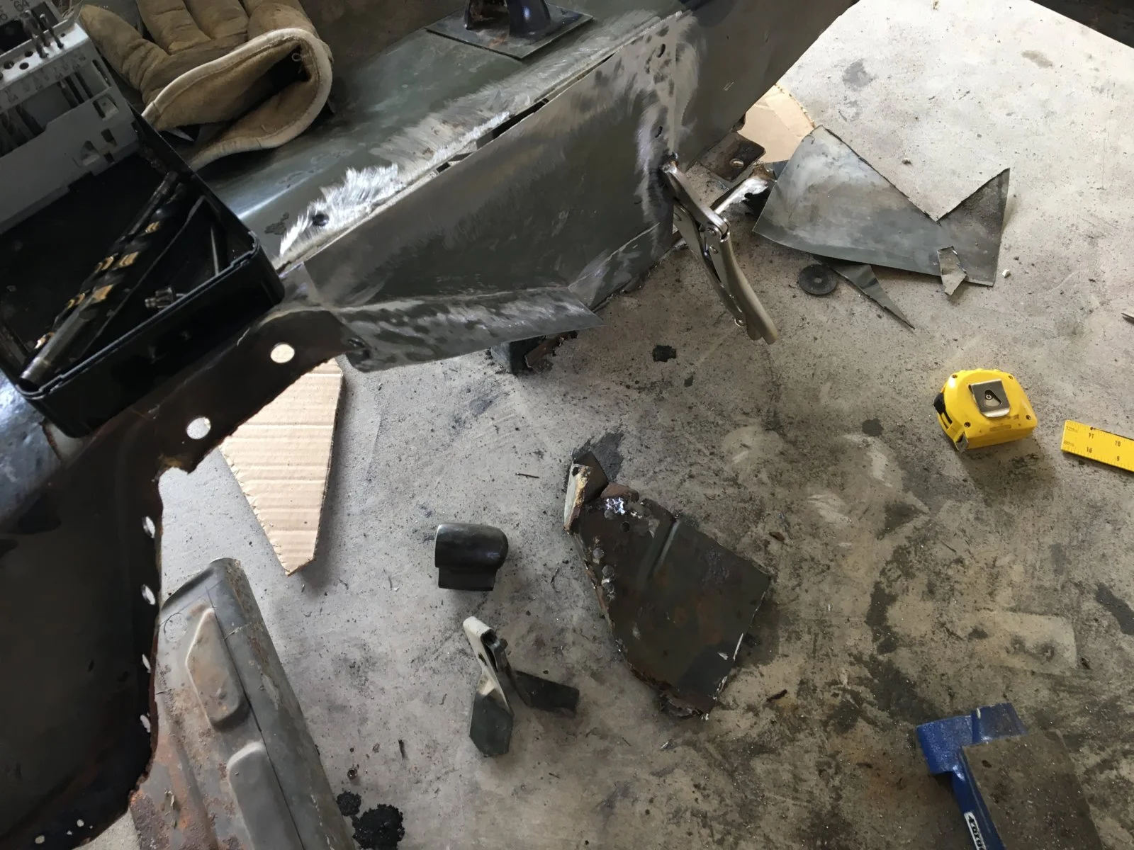

Ok, finished up the old floorpan removal.
So I have two repairs that I intend to tackle tomorrow. First the lip that is welded between the rear floorpan and the front floorpan.
I'll replace the front part of the rear floorpan where the eb bracket is too.
I'm going to make Booger feel good about this repair using original floorpan pieces.
Tomorrow Ill try to finish the dressing of all the spot welds I cut out (and btw, there's a sht ton load of them),

Ive been busy drilling out the seat bracing that goes from rocker to rocker what a nasty job finding all the welds
Boy do I understand that!
Can you believe I cut all of those spot welds with one spot welder cutter bit from harbor freight? It earned it’s five bucks.

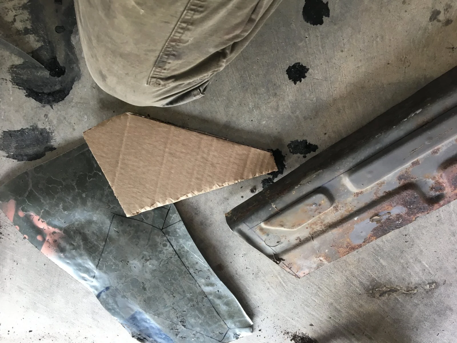

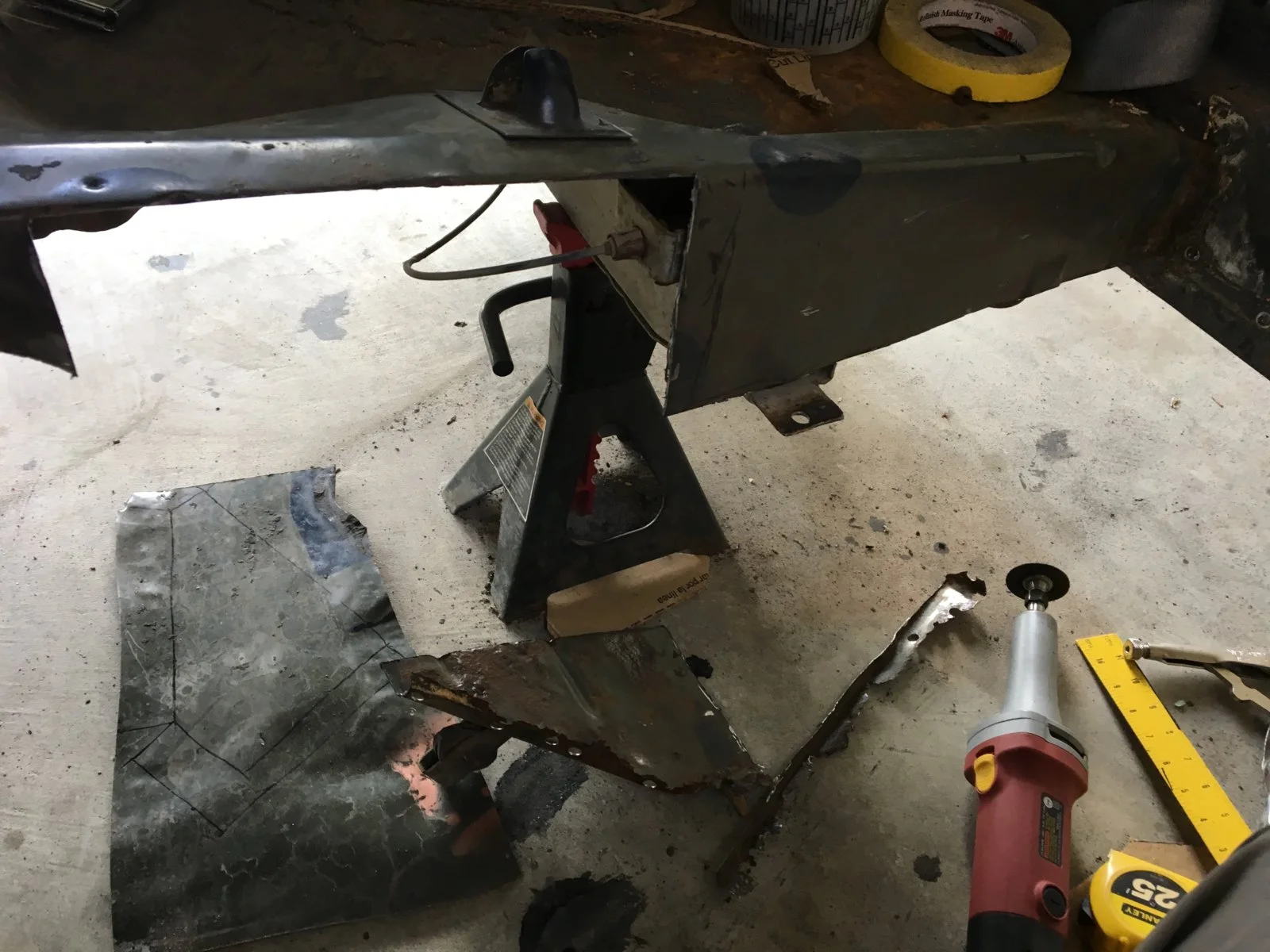

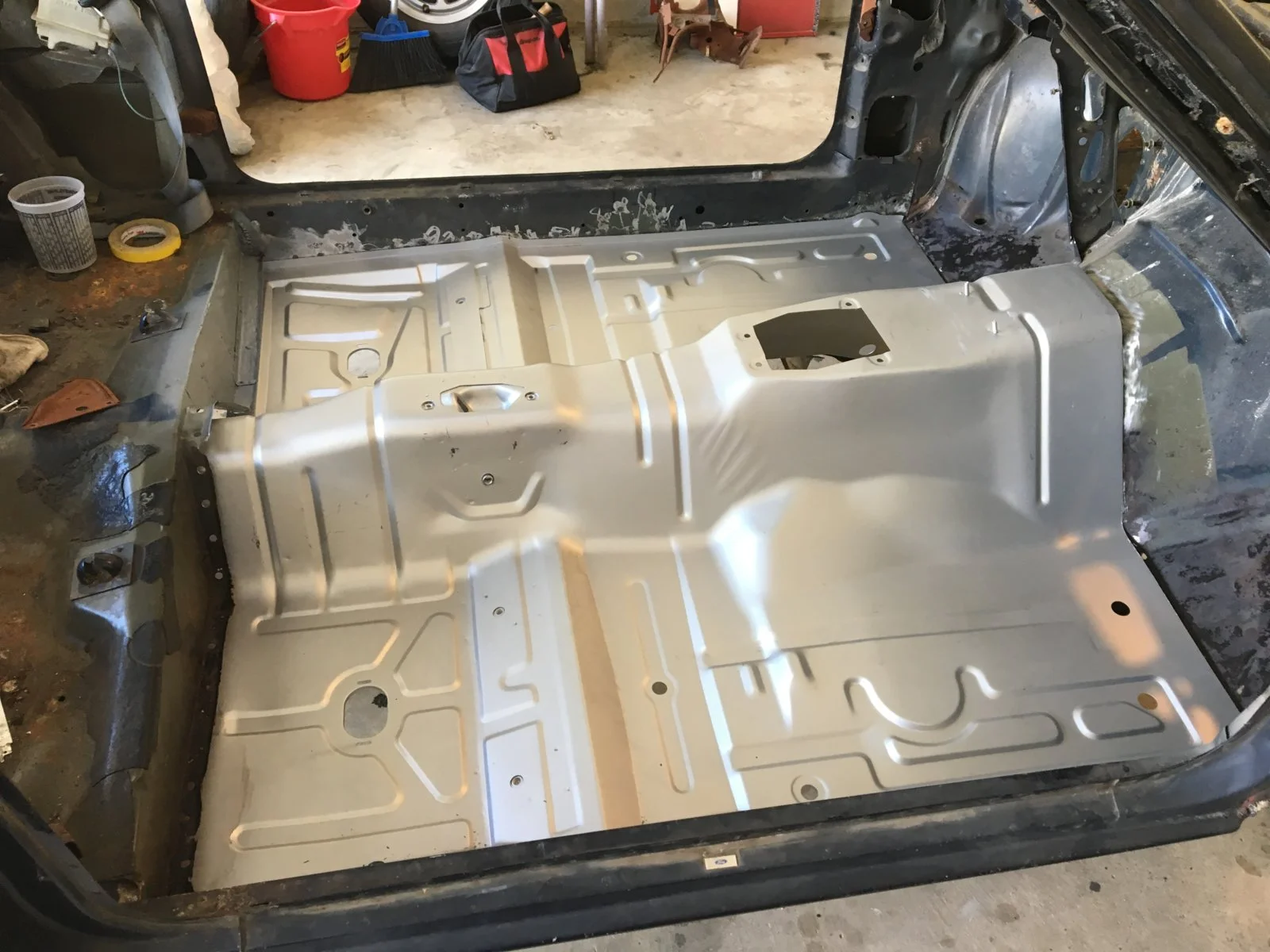

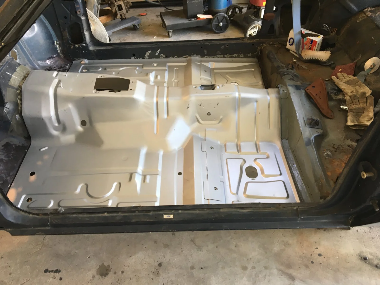

This is it for today. I got the eb cable bracket welded and coated all the bare metal there with an etch paint.
Then, for kicks, I slipped the pan in to see what trimming I'll need to do. It fits pretty nice, I'll need to take off about and inch across the front.
That floor is interesting because seems like the factory used automatic floor pans and added the squared off part later for 5 speeds. Never liked how they did that with a half hazard hole on the floor with a spot welded panel covered by sound deadener.
That floor looks great !!!
I'm watching but don't have much to add. Just learning as you go.
Funny you mention the auto floor pan thing, I never knew this til this past week.
I was buying the lower shifter boot when LMR recommend the 5- Speed Hump conversion.
