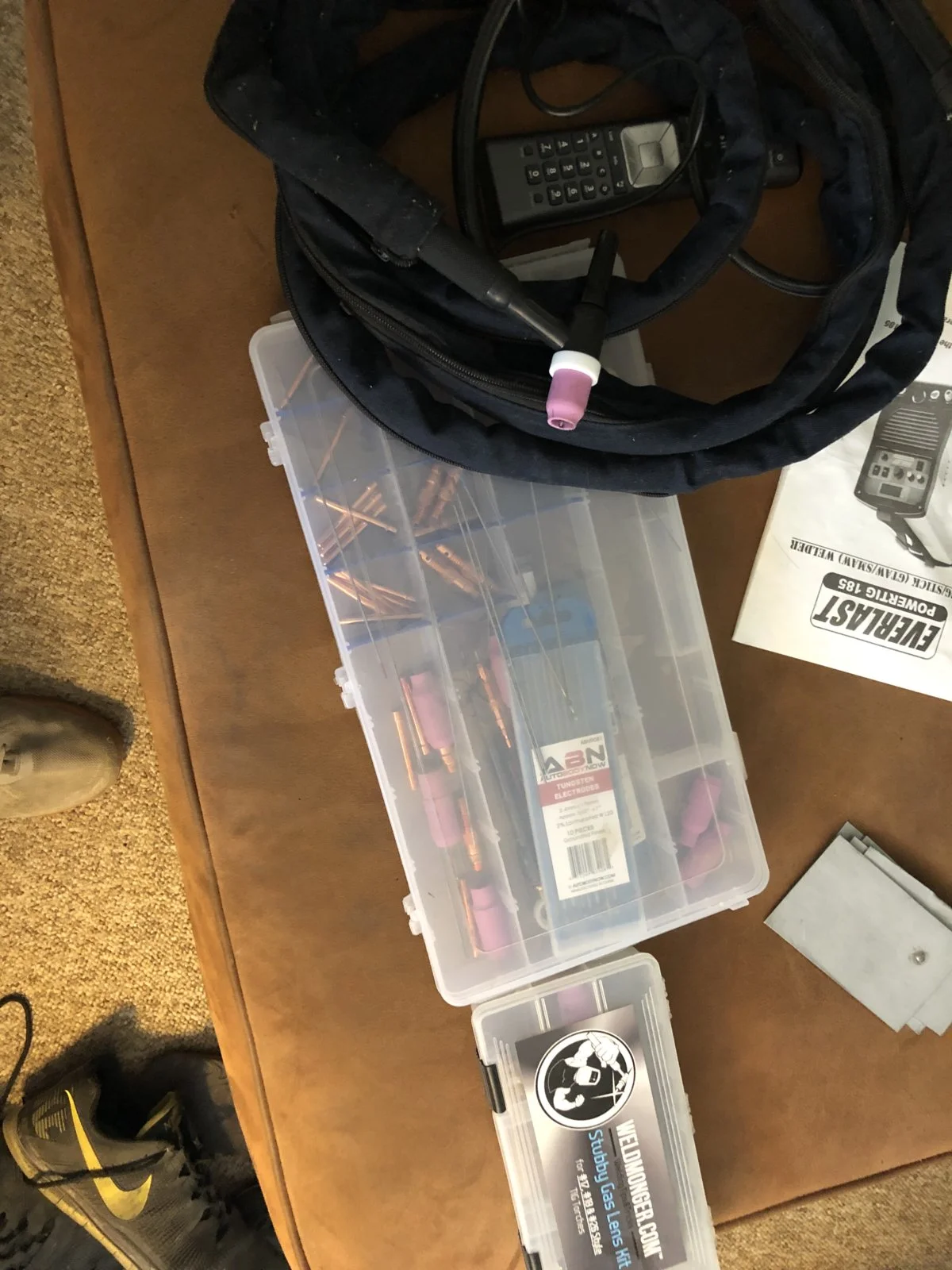

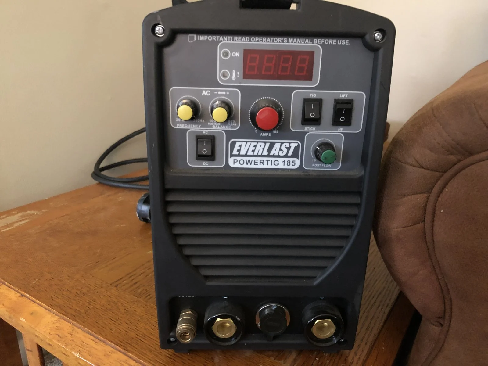

I picked up my brother's tig welder this morning.
It's an everlast powertig 185.
It's 25* outside right now, so no playing with it at the moment.
He bought everything to weld anything from mild steel to stainless to aluminum. Even gave me a nice big bottle of argon! I can't wait to give it a try.

I really need to buy a hand welded though. What's the power needs on that bad boy? I just put in a 30a 220v outlet

Ok, Maximum Inrush Amps (hitting the trigger) is 24.5a@ 220v/22a@110v.
Maximum Operating Amps is 14.5a@220v/13.5a@110v.

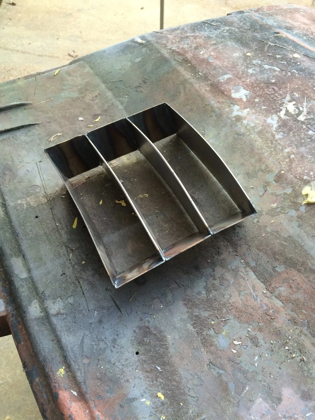

Towards the end of the original monster build, I used the tig to control fusing two pieces of steel together purely by melting them w/o the use of any filler rod.
The g gill....made up of 8 pieces of steel, with 4 of the pieces making up the two center gills.
It always worked great for me as long as they touched each other..if there was a gap, I'm burning holes. It got to be where I rarely used it.
And I sold that combo machine with a full bottle of argon, regulator, foot pedals, and a trigger torch for 300.00.
