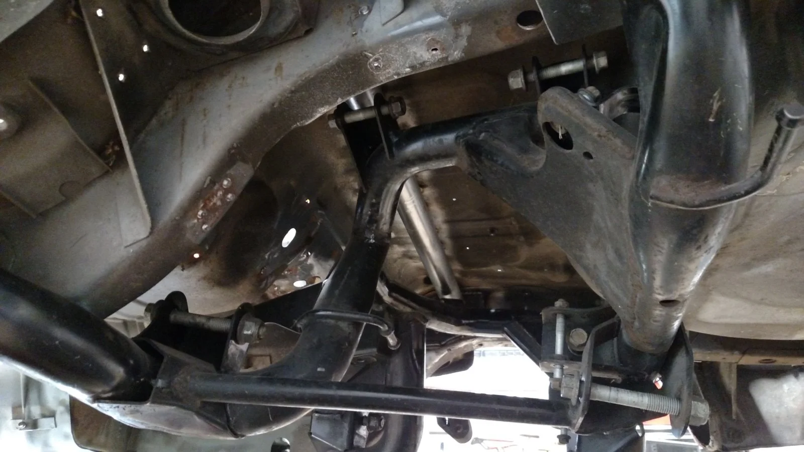

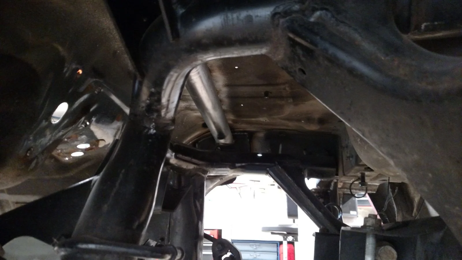

I would stick to 1-1/2" stock if I were you. I prefer tubing (1-1/2" DOM .120 in this case) but I think you would be fine with square tubing as well. The reason I say nothing more than 1-1/2" stock is once you go over that, you risk having some interference issues with the upper control arm mounts on the IRS cradle depending on where you locate the lateral support.
In the pics below, I used 1-3/4 .120 DOM tubing for the lateral support between the frame rails. I have the tube pressed tight against rear floor plan and with the IRS installed, I have less than a 1/4" clearance between the upper control arm mounts and the bottom of the tube. With tubing, you can play with the positioning a little to gain more clearance, I just didn't think that far ahead and got really lucky on mine :). I didn't do any bracing like your planning to the frame rails, but I did weld the lateral support to 1/8 plates and added two triangulated gussets from the tube to the frame rail on each side to provide additional support and provide clearance around the upper control arm mount.

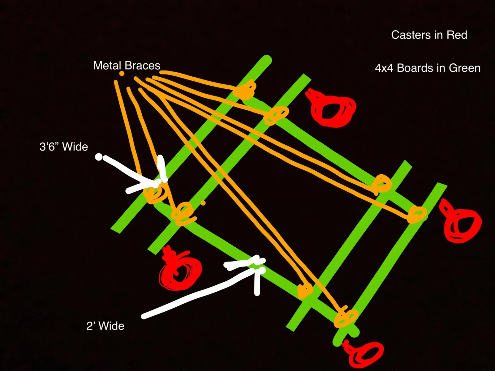

Tomorrow between games I’m going to start to piece together the rear end cart.
If I can get everything cheap enough, I may go ahead and build the front end one as well.
I’m making two seperate carts because my garage is so stinking small and two separate carts will be easier to put in. Plus I’ll be able to crawl under the middle of the car still.
Help me out with any thing you can think of here.
I want two carts, 3’ ish wide by 18” ish long. I just want to make it about 6”s wider than the sfc’s. The car will rest on the sfc’s.
I‘m going to be using 4x4’s to build them. I want the height to be an 18” lift for Booger (well, 18” off the floor to the sfc’s that is).
I’ll probably connect the 4x4’s together with some sort of metal bracket. Tomorrow morning I’ll head to Lowe’s to see what they have.
So it’ll probably be two high on the width and one in the middle for the length.
Casters from HF, btw.
Any problems y’all see?

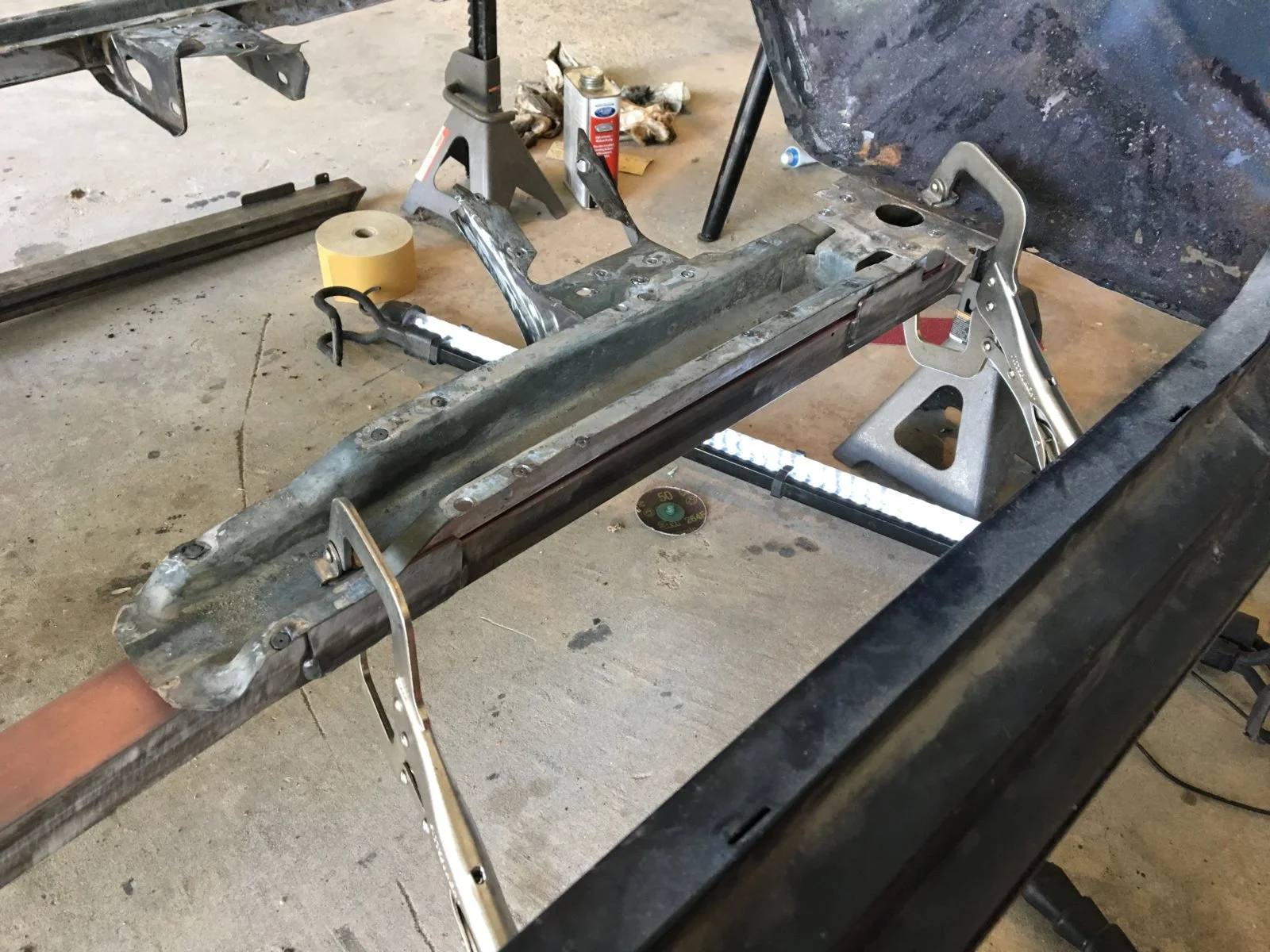

So I got out into the garage for a bit today.

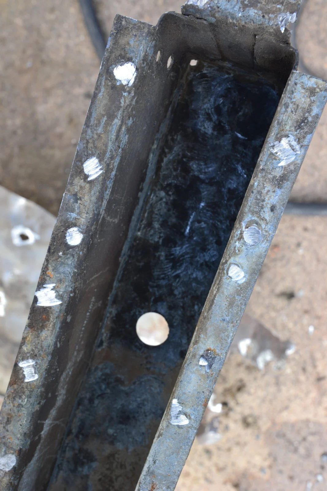

I wanted to get all the rosette weld areas drilled along the pinch weld and clean up all areas to be welded. Those spot weld holes took me a little over an hour to drill out by themselves.
I put the cs up there to mark where I need to clean the jacking rail for the rosette welds.
I sprayed weld through primer over the bare metal areas and will do a final grinding of those areas to reveal enough clean bare metal for welding.
So tomorrow night after work I’ll at least spot weld a few areas to hold it in.
I’m going to use my TIG torch to maybe seal up those holes before adding filler. Hopefully to block out the crap that made the other rocker such a pita to deal with. I’m pretty interested in seeing what this will do. I’ll let you know.

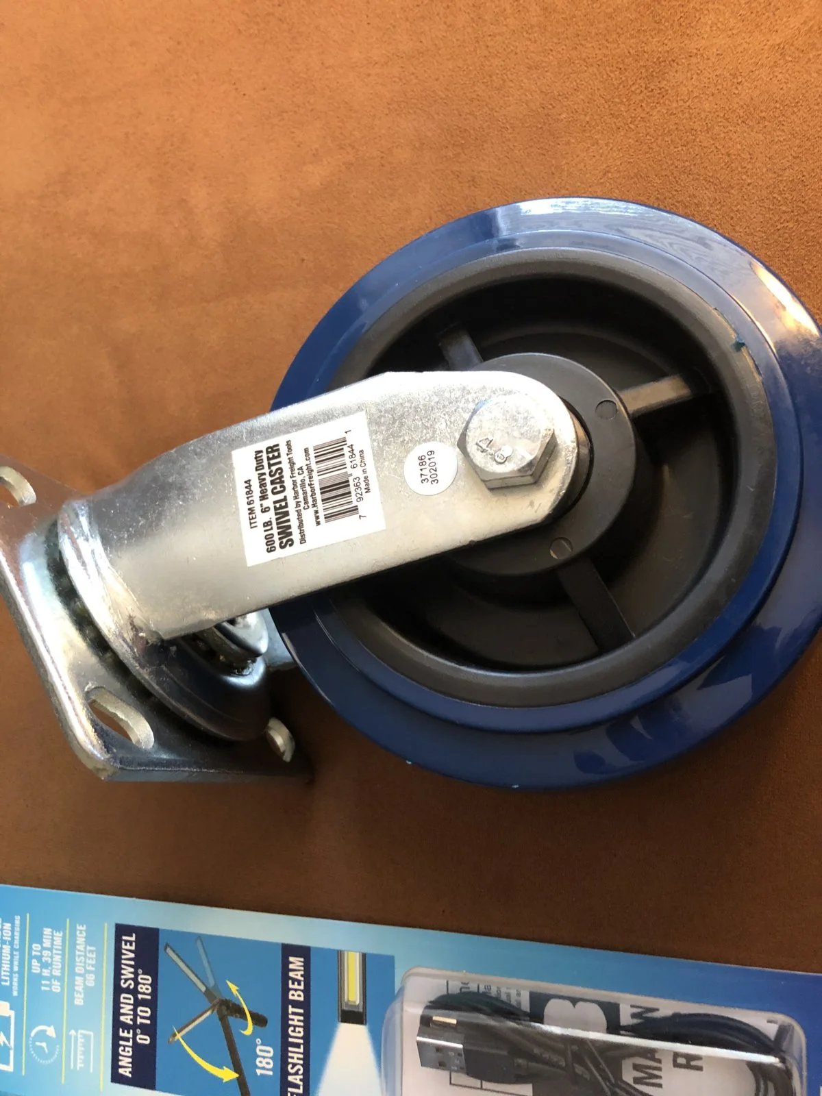

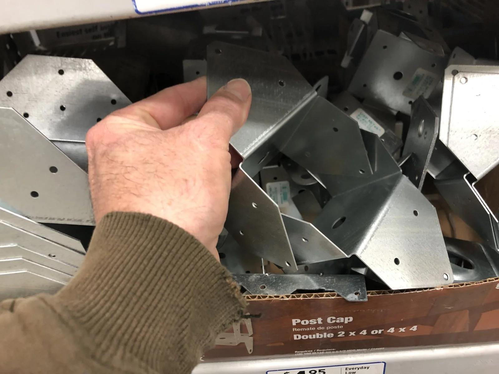

I gave a little thought about The cart/ Booger Dolly.
The drawing isn’t the greatest, but it’ll give you an idea of what I’m thinking about.
Heres the metal brackets from Lowe’s, I’ll need eight of them.
The casters from HF.
Total cost of about $120 per cart.
