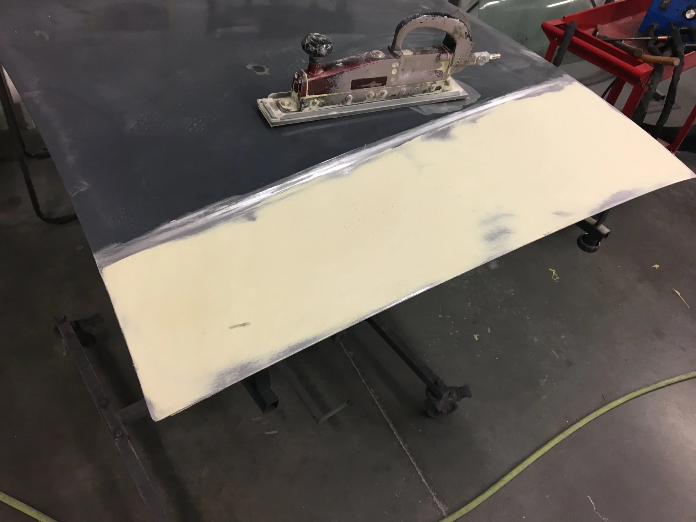

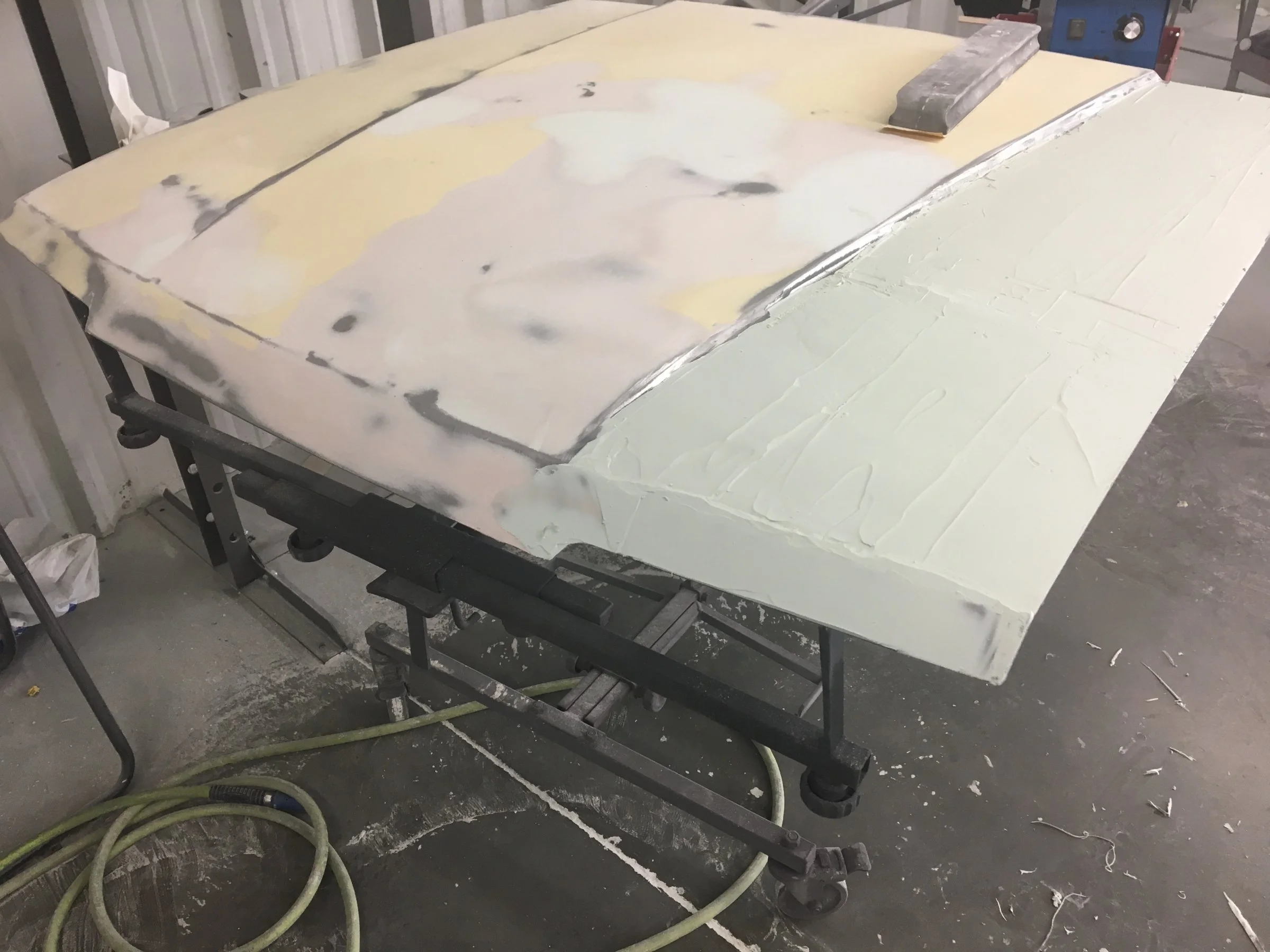

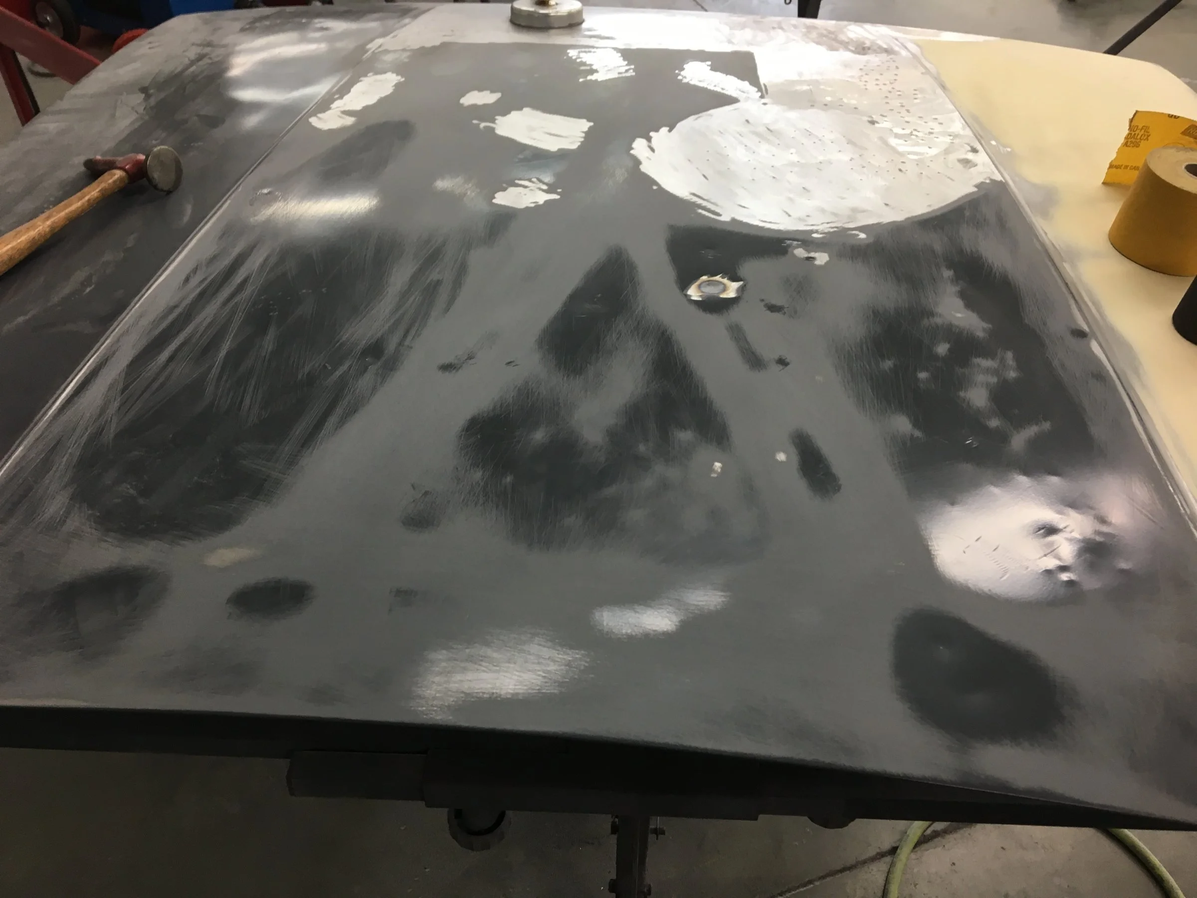

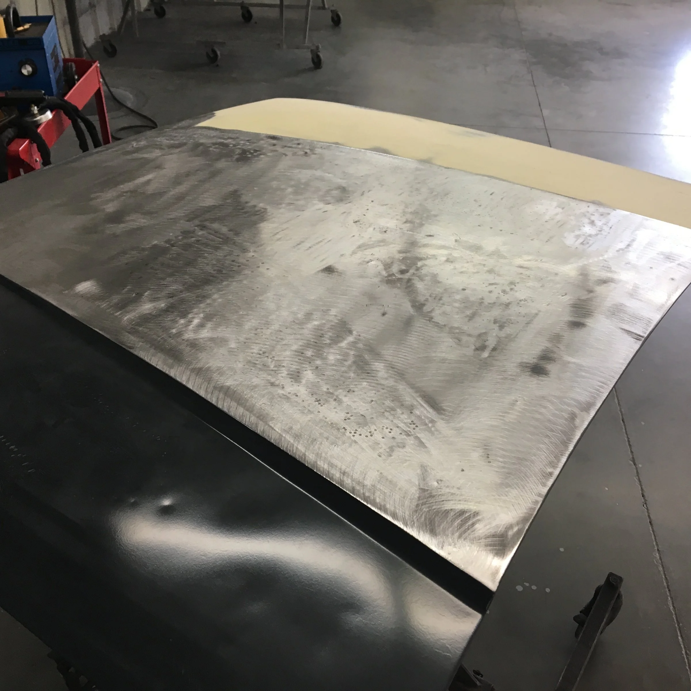

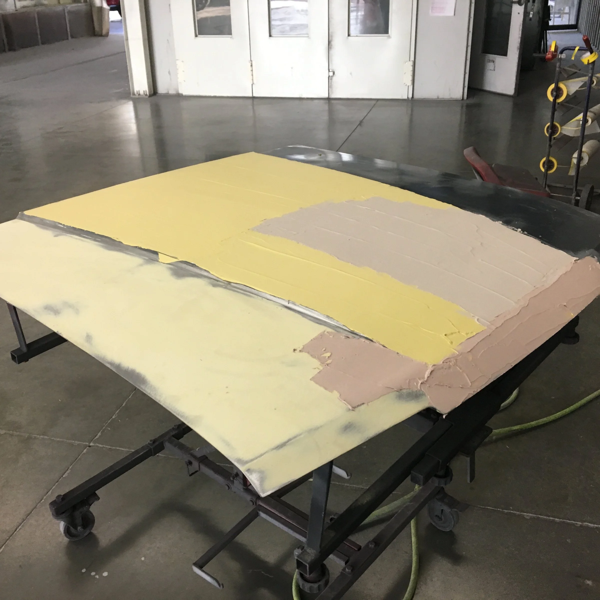

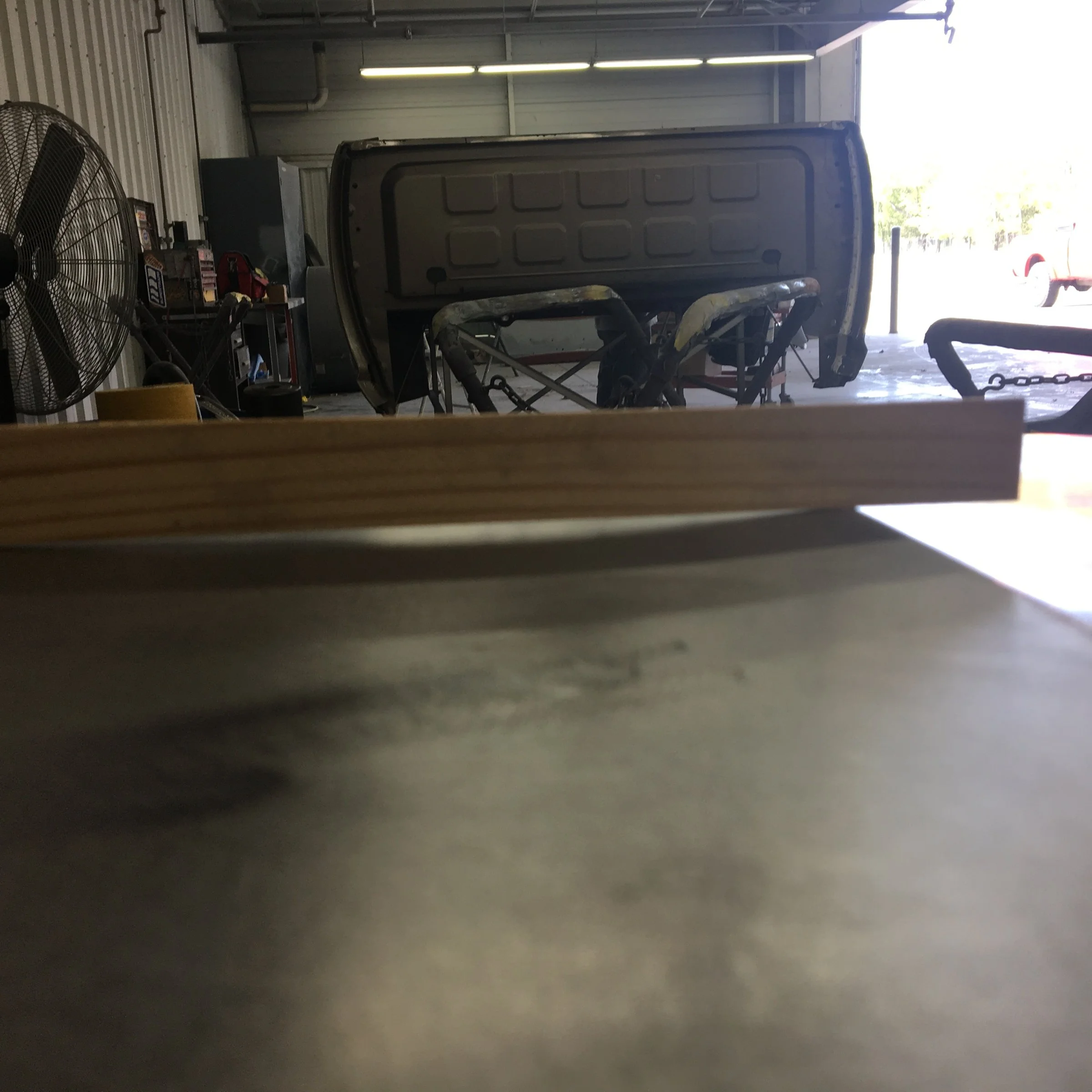

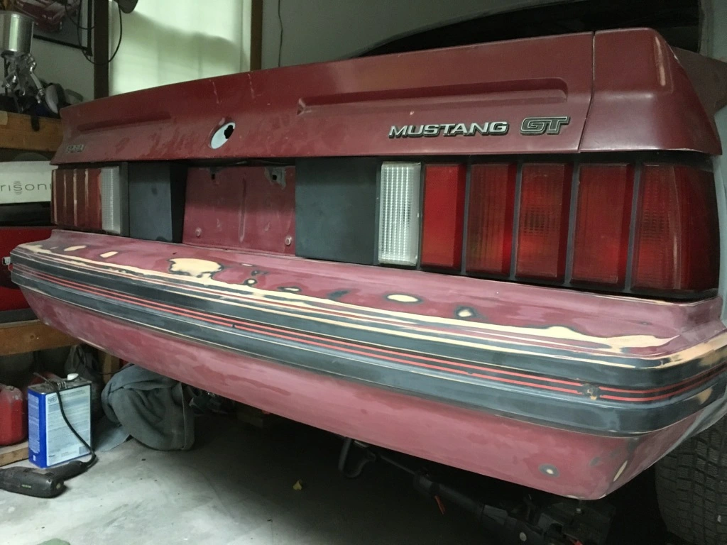

Now that is starting to look like my hood. All you need to make a perfect duplicate is to heat it in the middle w/ a torch next,...warp the pis s out of it,...beat on it w/ the pointed end of a body hammer, (trying to shrink the warpage because you don't know any better) get that close to tight, attempt to float out all of the remaining low/high spots w/ a dolly, cause it to start tincanning,...smack it low, and fill it w/ an obscene (for you) amount of filler.Did the initial sanding of the bondo, it feels pretty good.
I'll have to wipe it again to get the couple small low areas and fill in all of my pinholes. I whip my mud maybe a little to aggressively,gets air bubbles in it.
Then you'll have a clone worth of being on the Monster.
