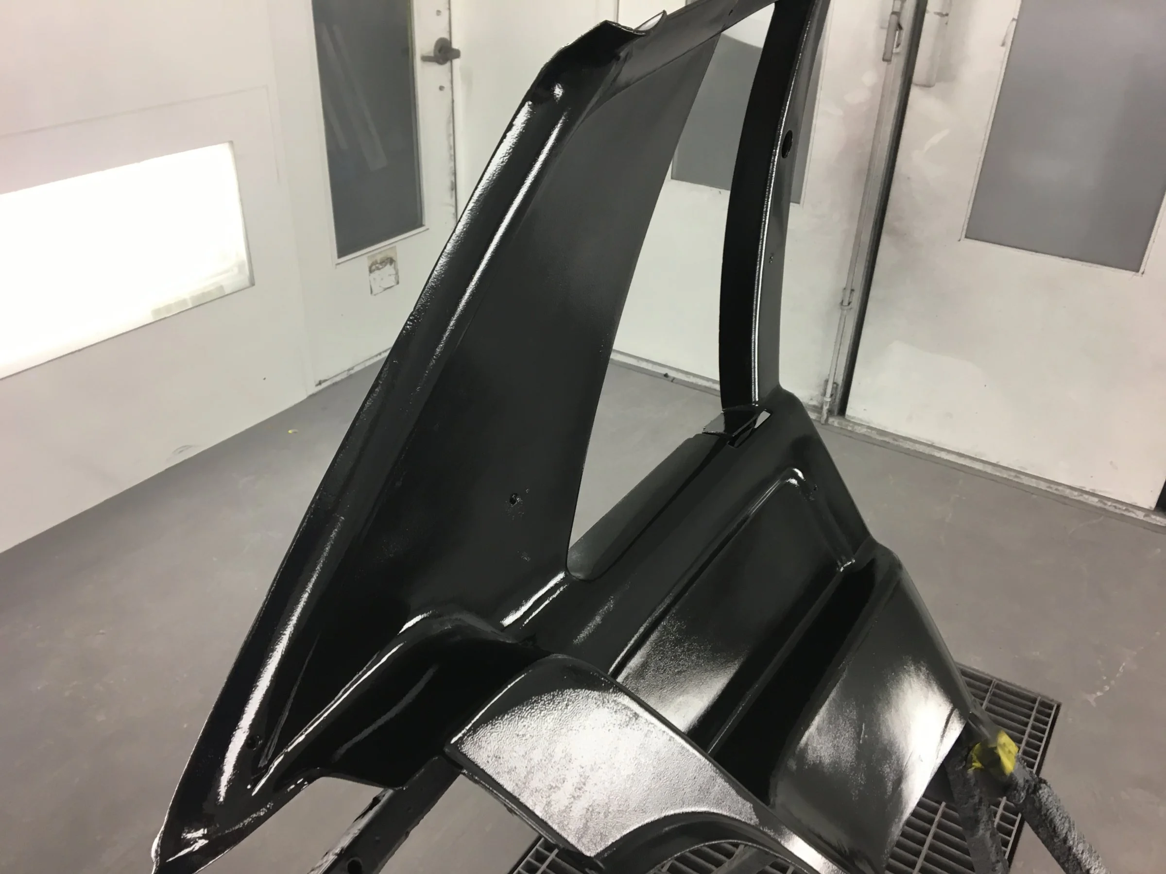

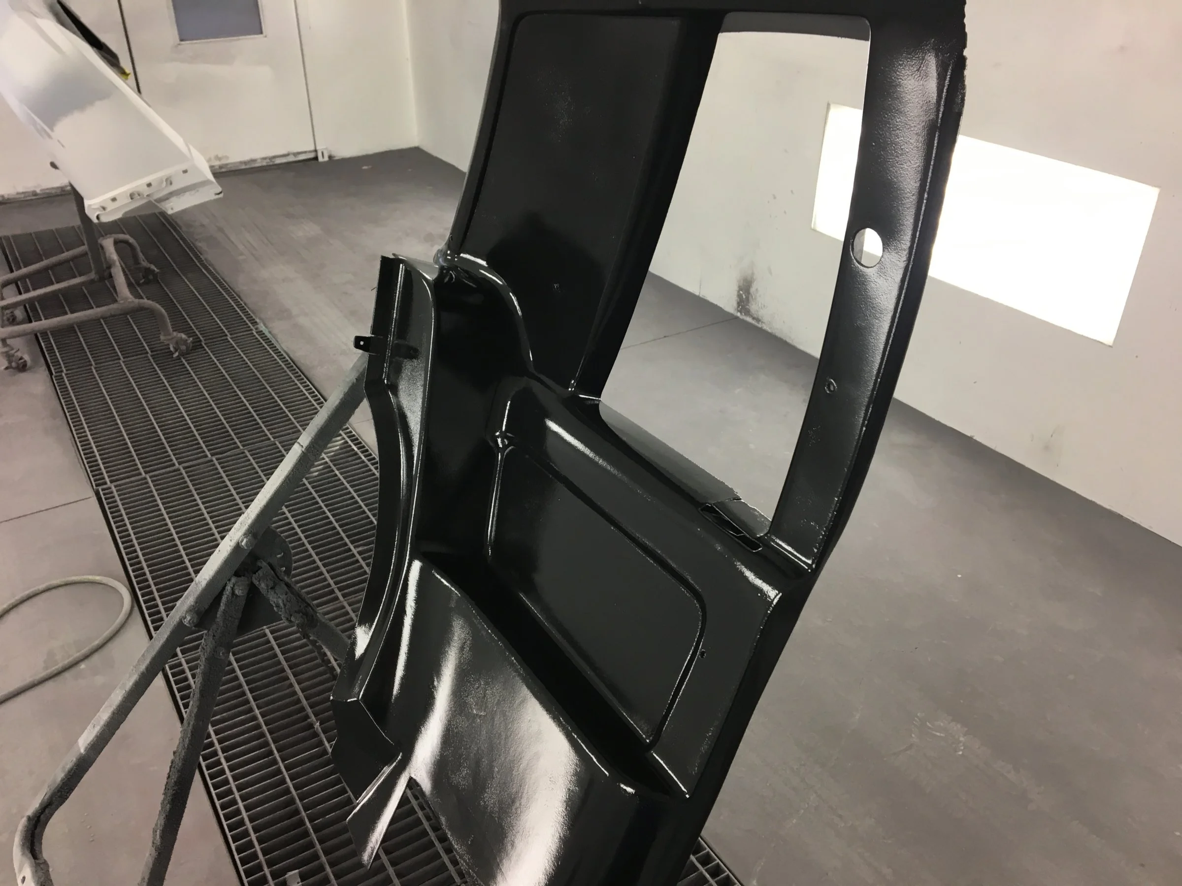

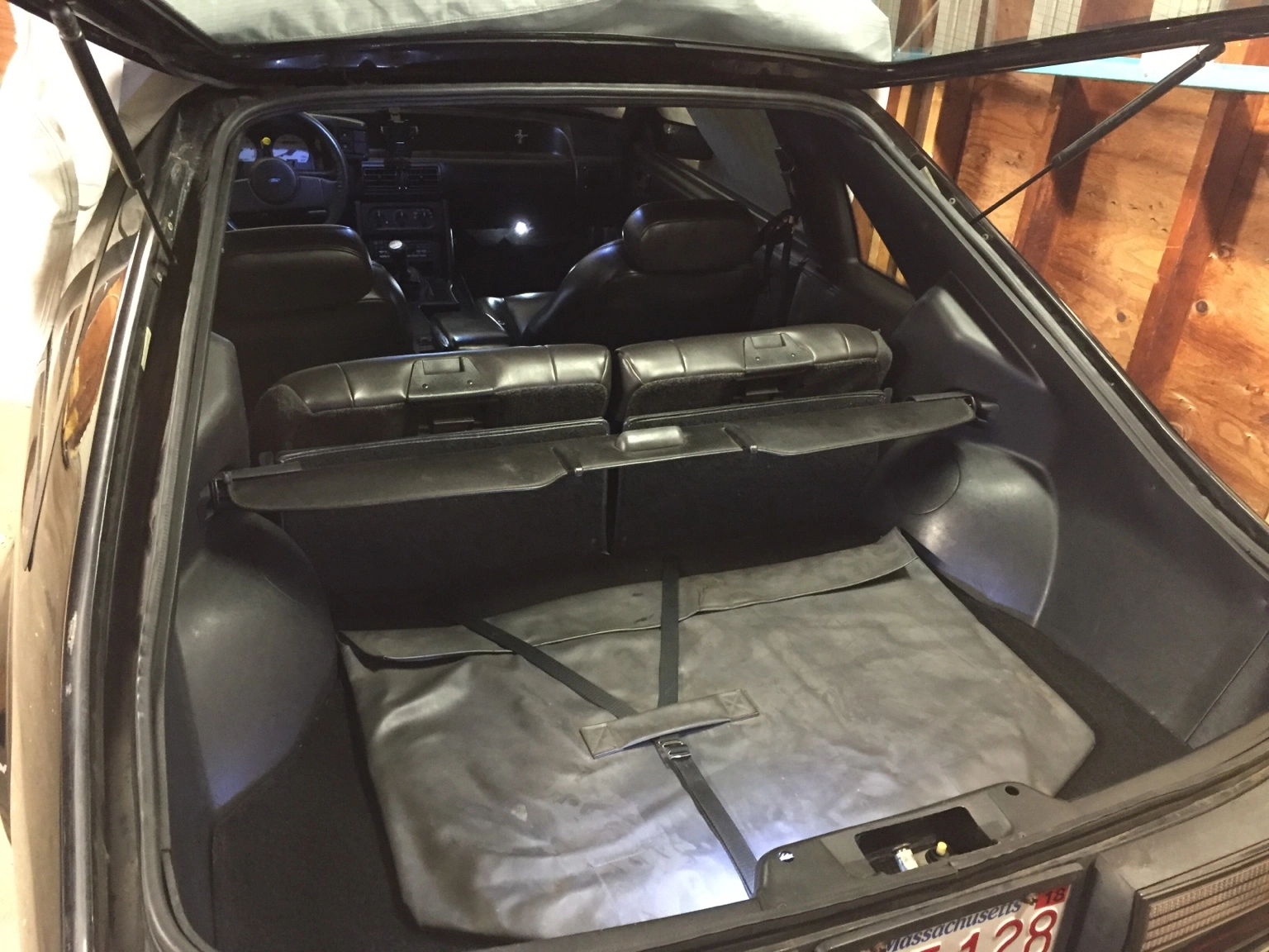

I wouldn't go too shiny. The oem black interior in my car doesn't have much shine to it. Back when I first installed it, I had a few painted parts that had some shine too it and they just stood out and said "I'm painted".
But, I wouldn't cAll it matte either
Best pic I could find of actual sheen
Edit: wait. What color are you doing the interior?

Black, you're post is perfect. Eggshell it is.

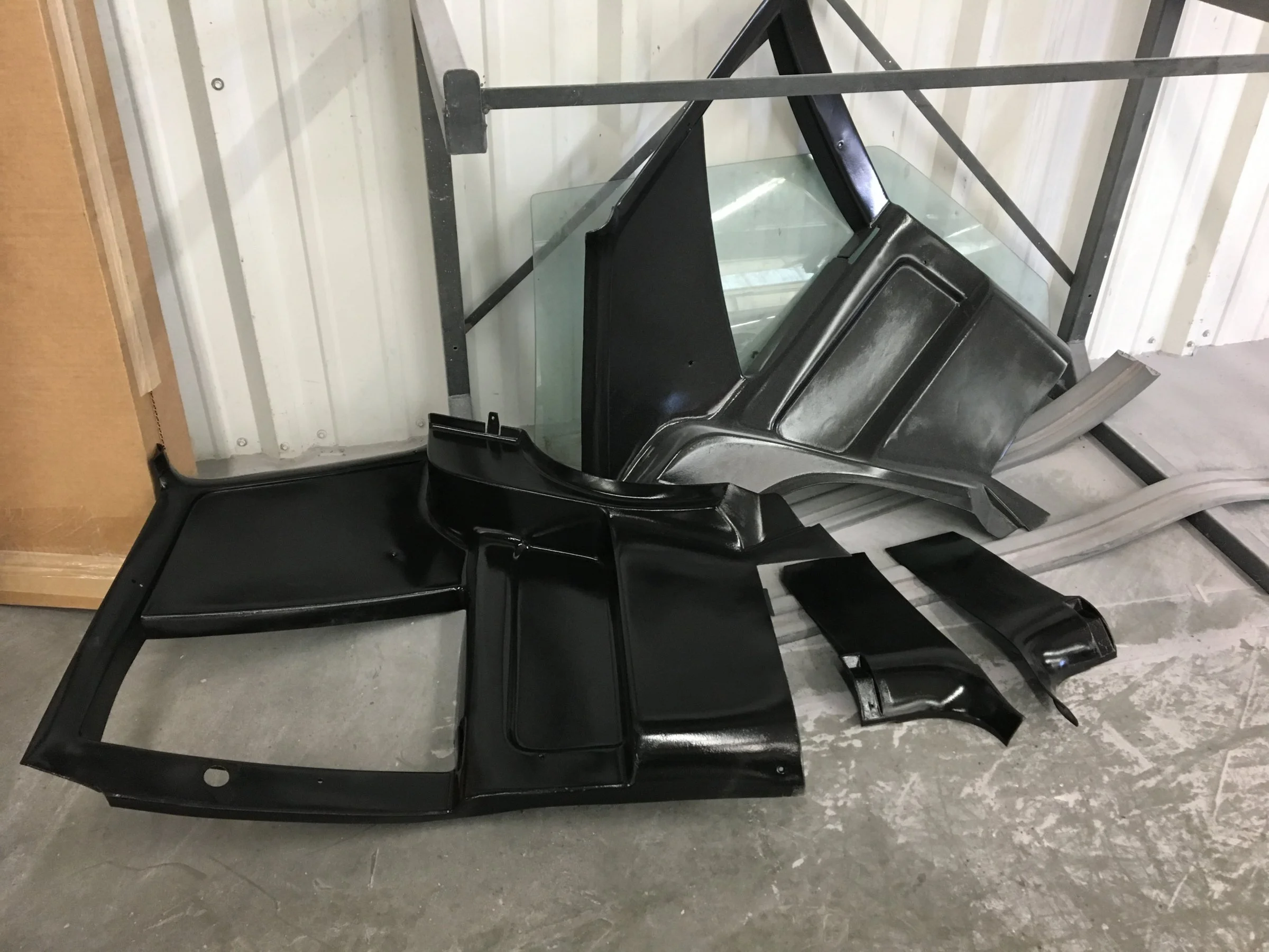

maybe i missed it, but what kind of paint is this actually? i know you said its not a "dye" like lrs/cj's/am would sell you, but is it something actually made for interiors/plastic?
I've used a plastic adhesion promoter and sprayed primer that has flex additive in it. My clear coat will also have flex additive in it. It's the paint system I use at work.
But we using it on bumper covers, wether they be raw plastic or primered with really good effectiveness.

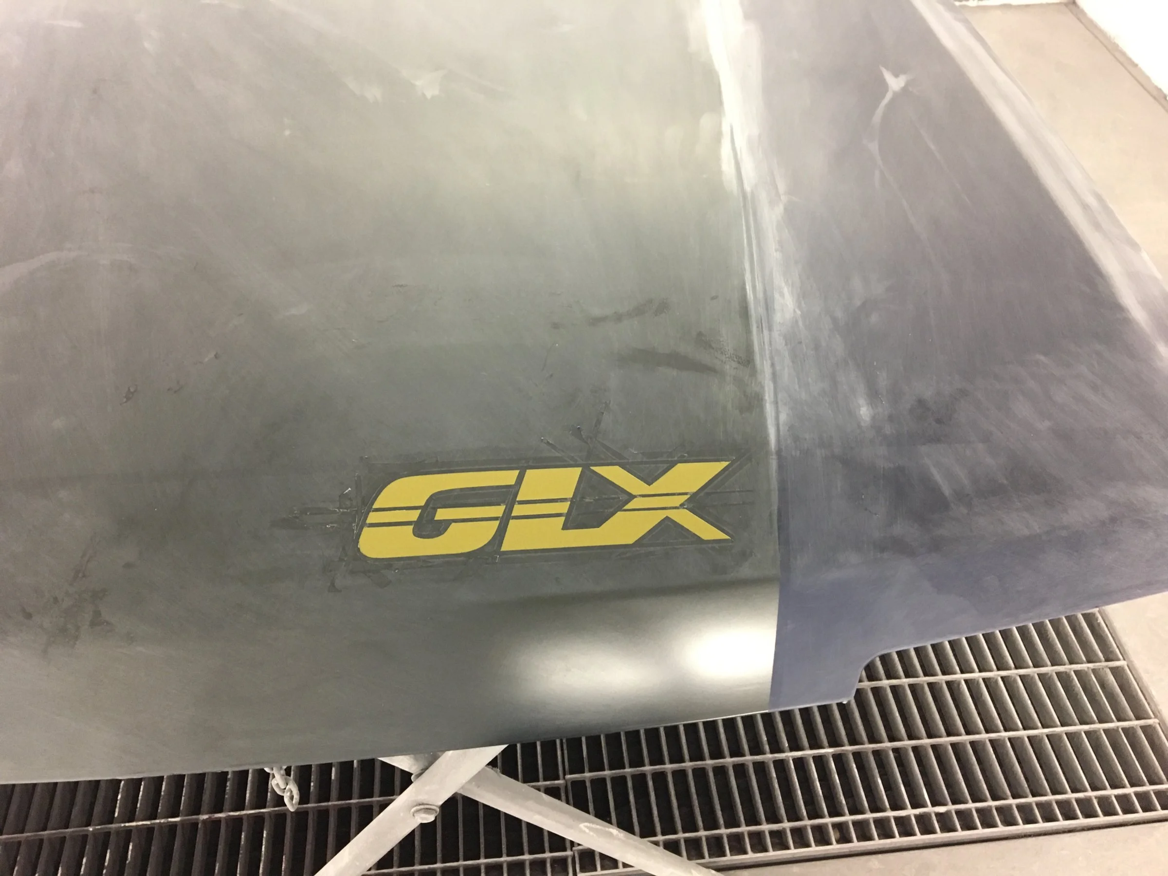

Ok, so I may have a AR (anal retentive) problem.
I didn't like the way the GLX looked. Some of the lines where just not straight enough.
So what am I doing right now? Repainting it. I know.....I know.....
I used 1/16", 1/8", and 1/4" fine line tape and made it nice.
I'm letting the letters dry right now so I can clean up the tape residue. I'll clear coat it again shortly.
It will be a little brighter this time than the first time. I sprayed more color to obtain coverage. I think I like it this way.
Anyhow, picture of the GLX that makes me happy.
