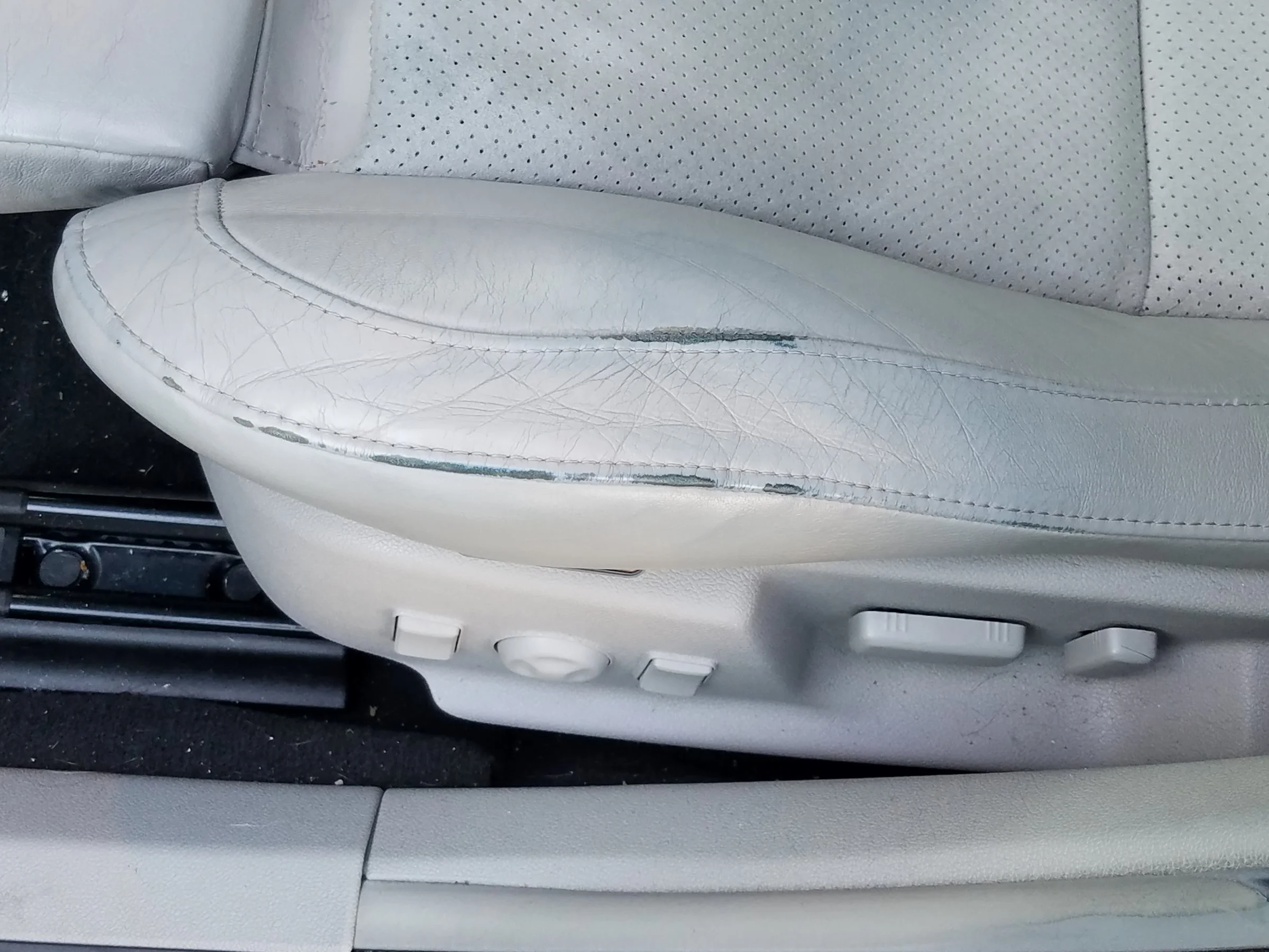

Leather. It's the CTSV. If I have to pull the seats, I will likely just order a new seat bottom.
I was looking at something like this: http://www.ebay.com/itm/VOLVO-LIGHT...CH-UP-KITS-XC90-S80-S60-V40-V70-/171035792515
They have them for Ford and GM too.
I haven't researched the leather dyes like I have the vinyl stuff, but I would definitely start with that.
Be sure you clean the hell out of that seat though, use what ever they recommend to clean it. Leather absorbs stuff real easy, which also makes it easier to dye.

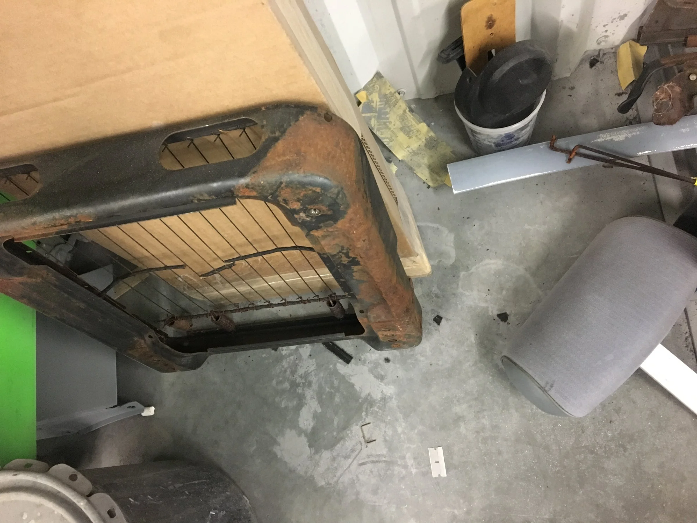

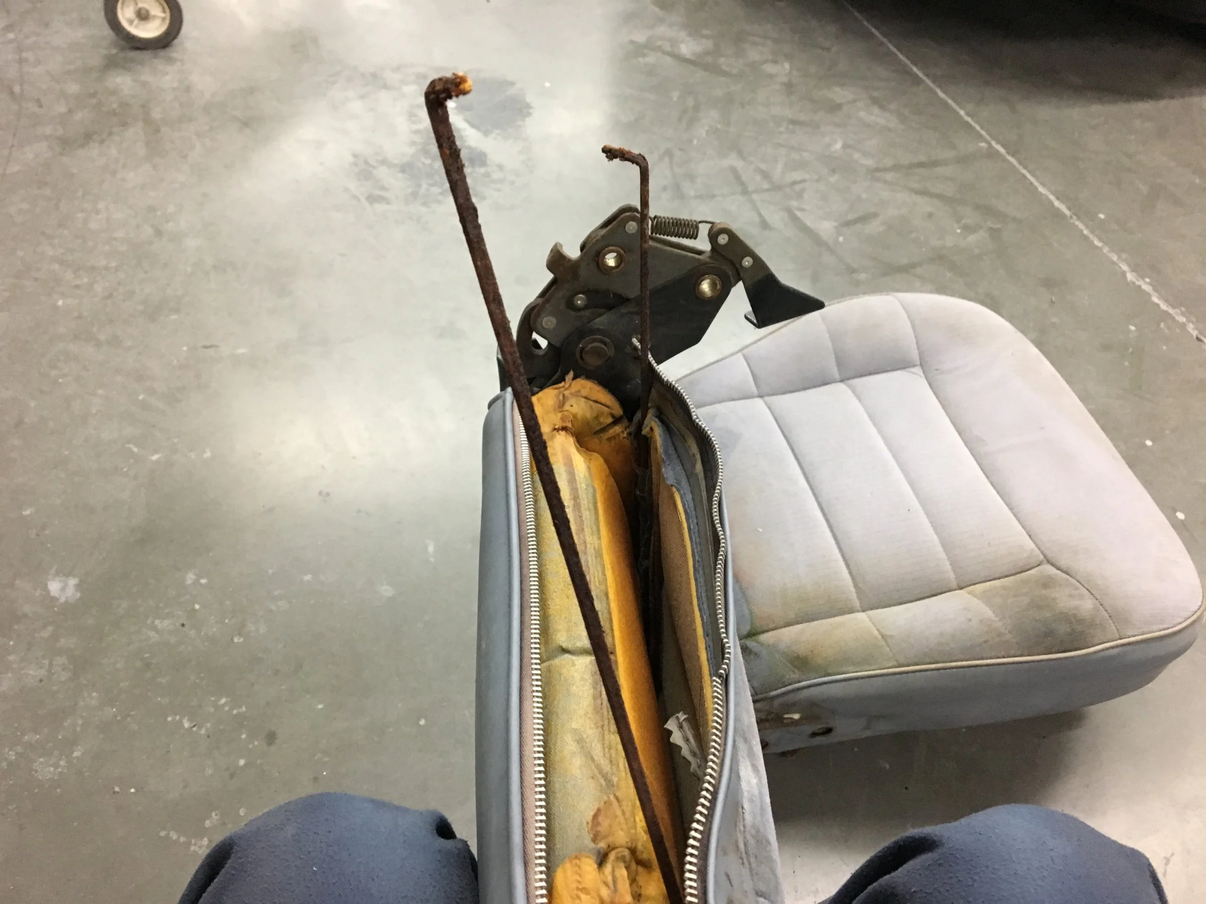

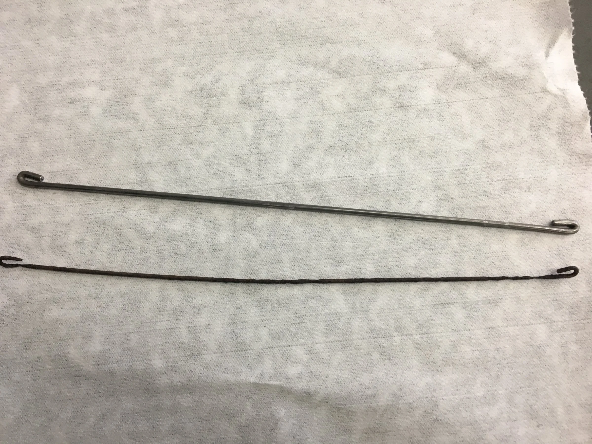

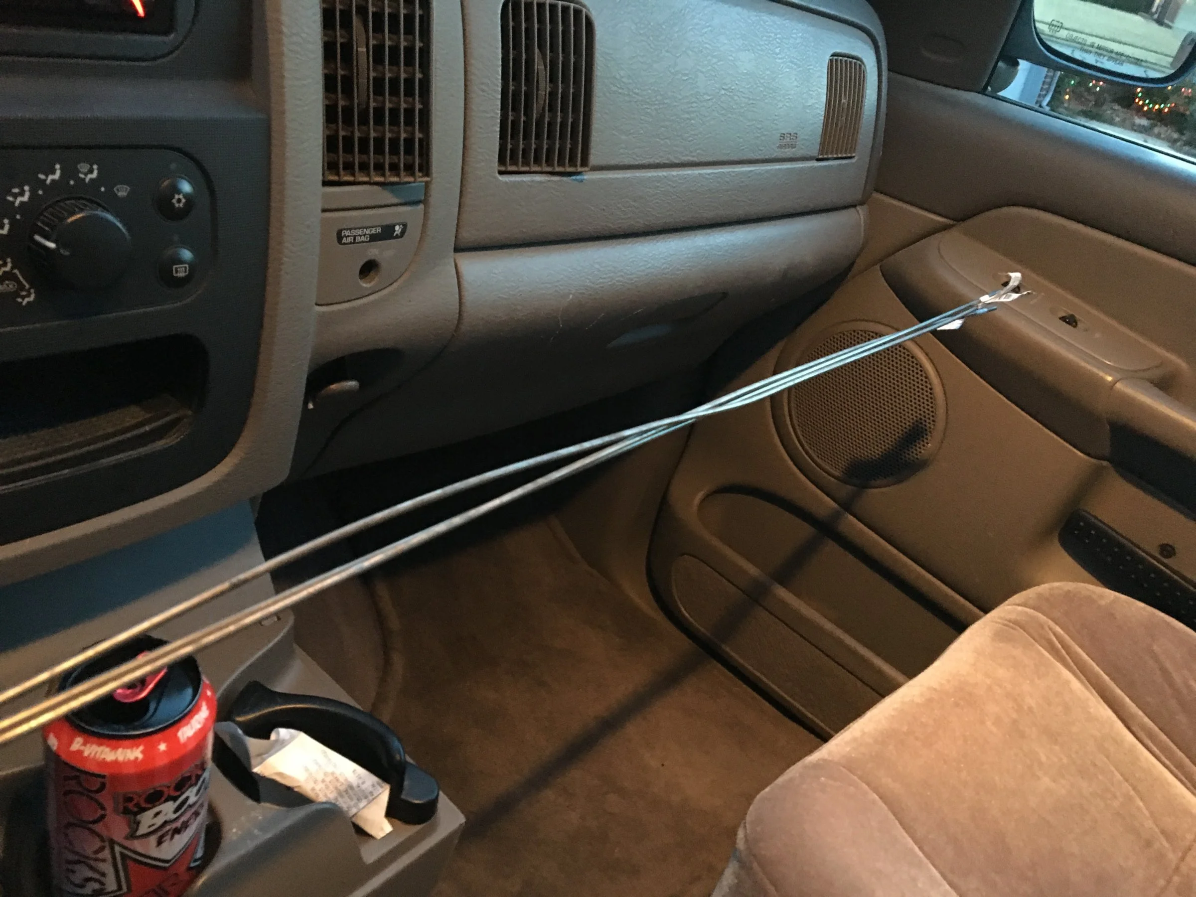

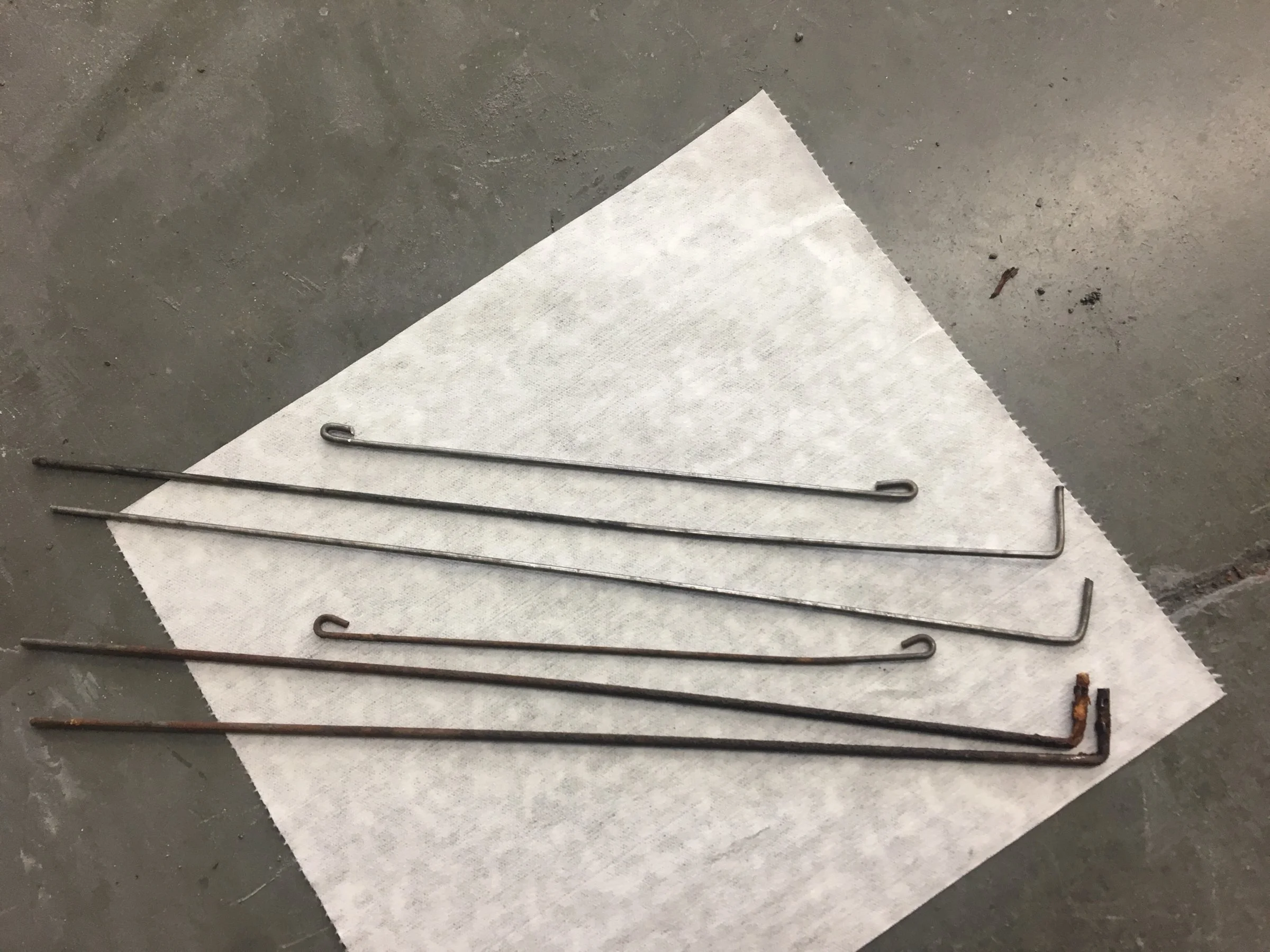

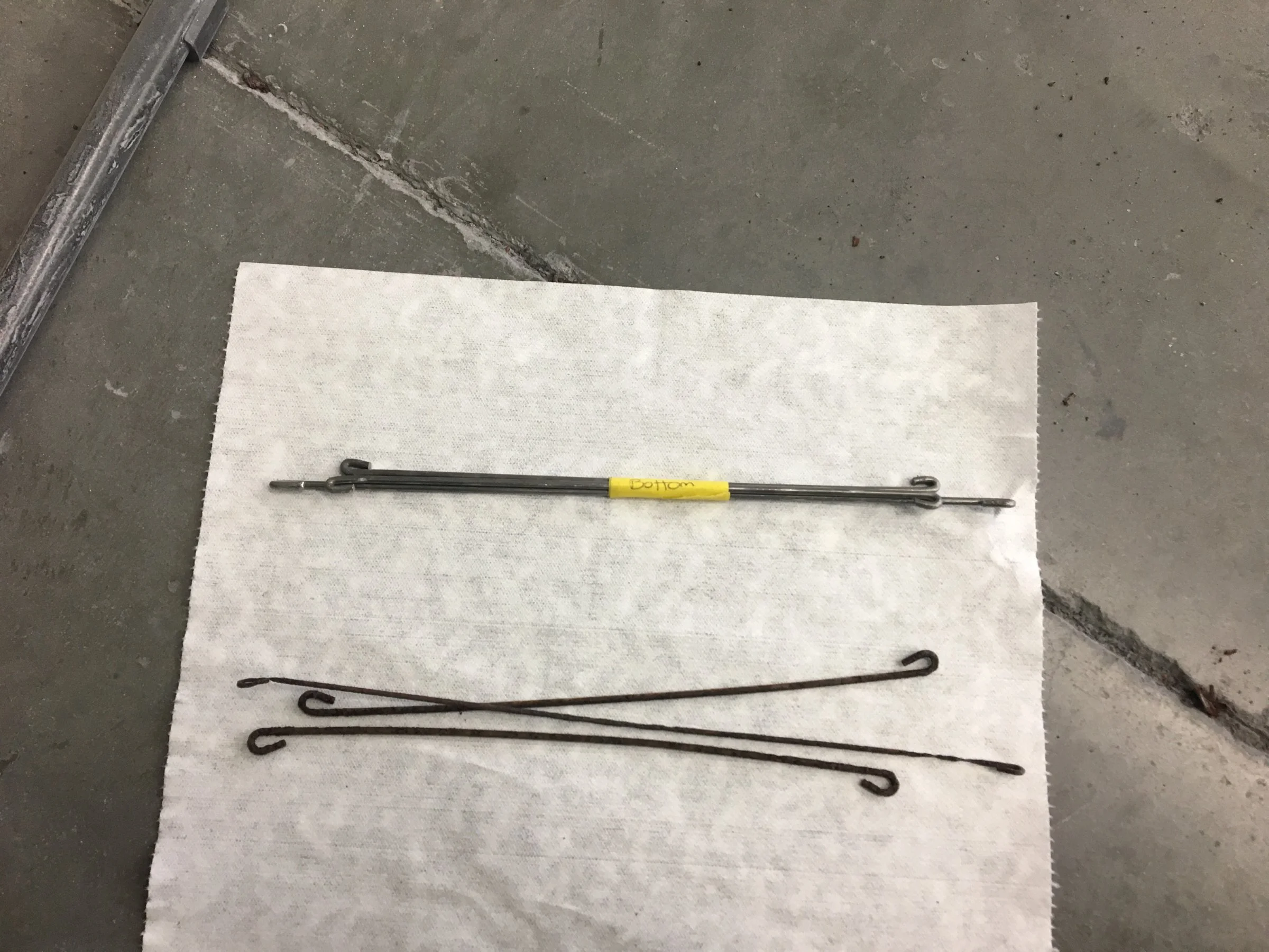

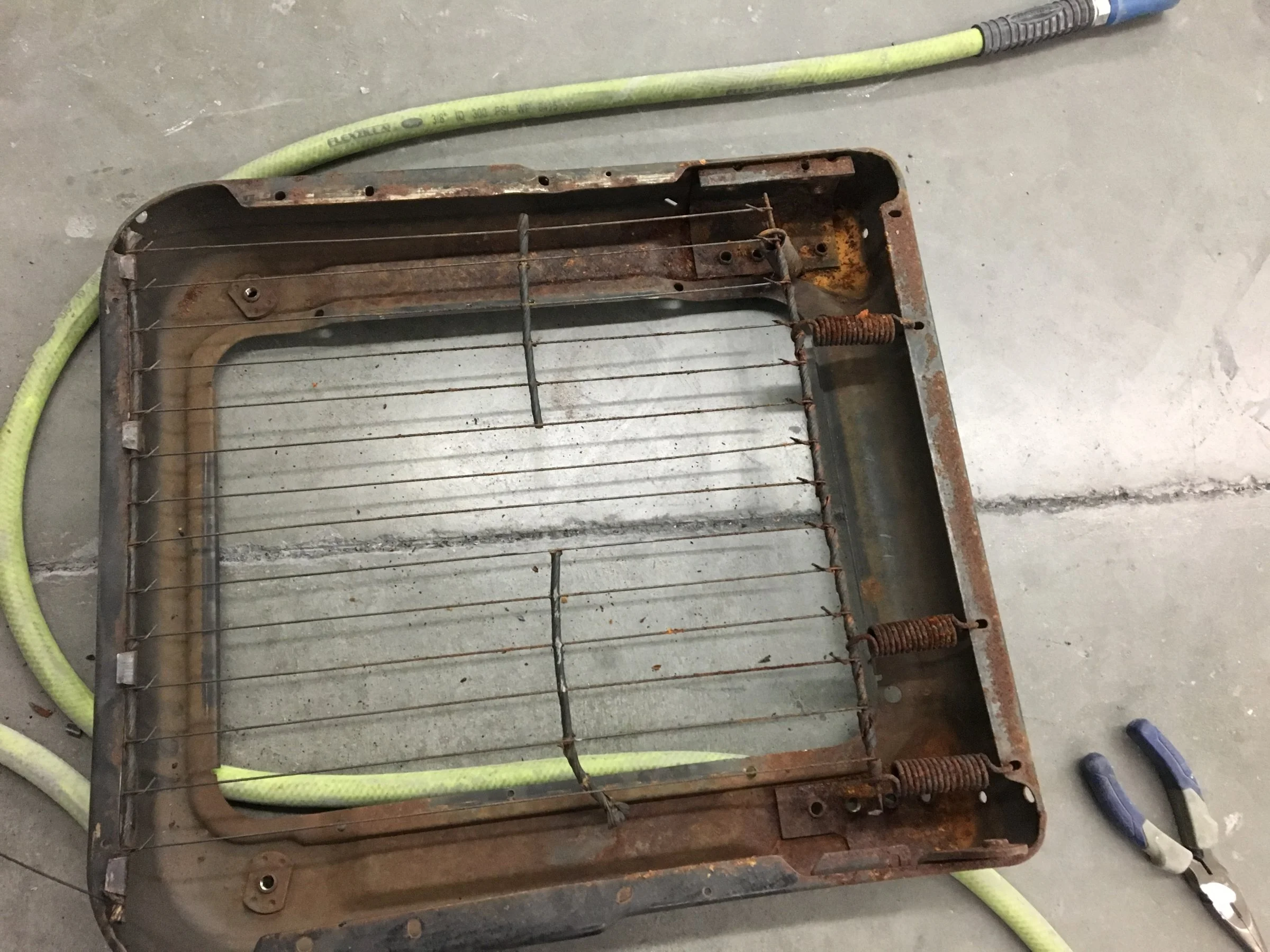

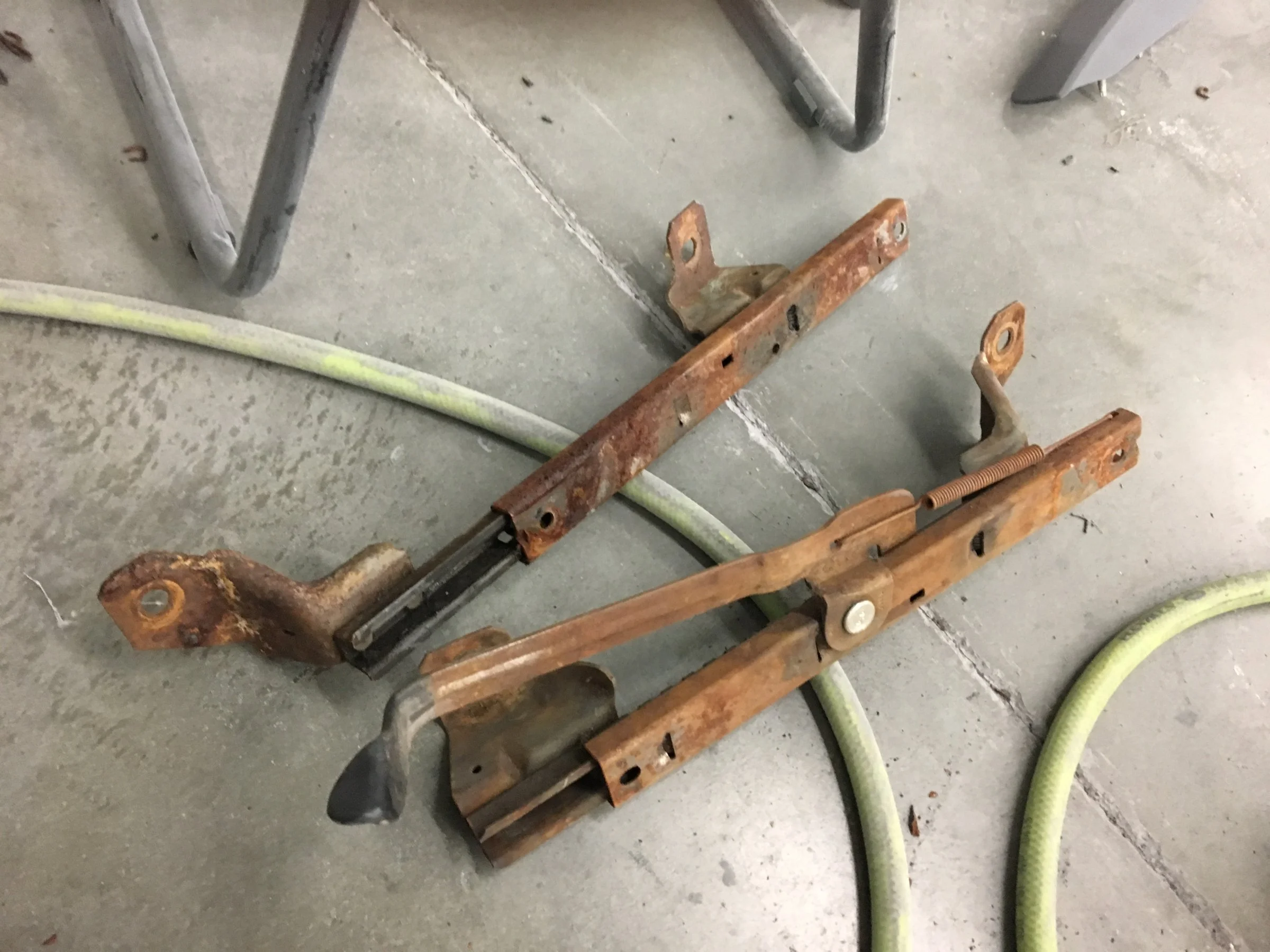

Back to the regularly scheduled program. I did a few things. One, I disassembled the passenger seat yesterday. the listings were almost completely rusted through! I'm going to get some piano wire from the hardware store tomorrow and make new ones. The problem i had with the seat sliding turns out to be simply a rusted up mechanism, easy fix there. I'll sand down the frame and seat rails and spray them flat black. I'll take the rails home and WD40 the crap out of them then.

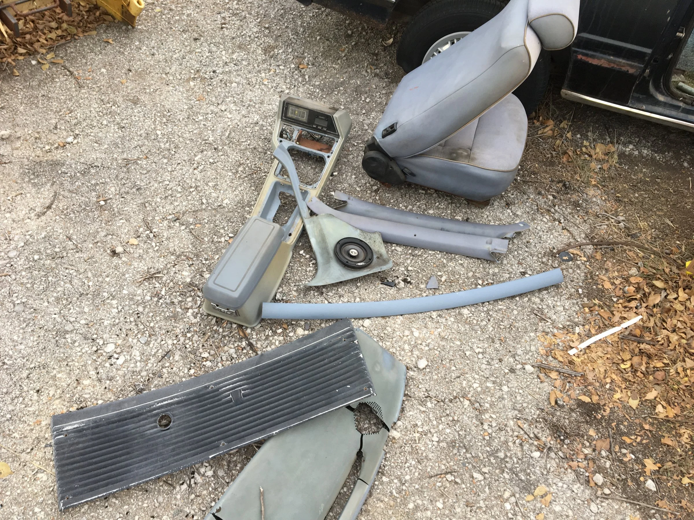

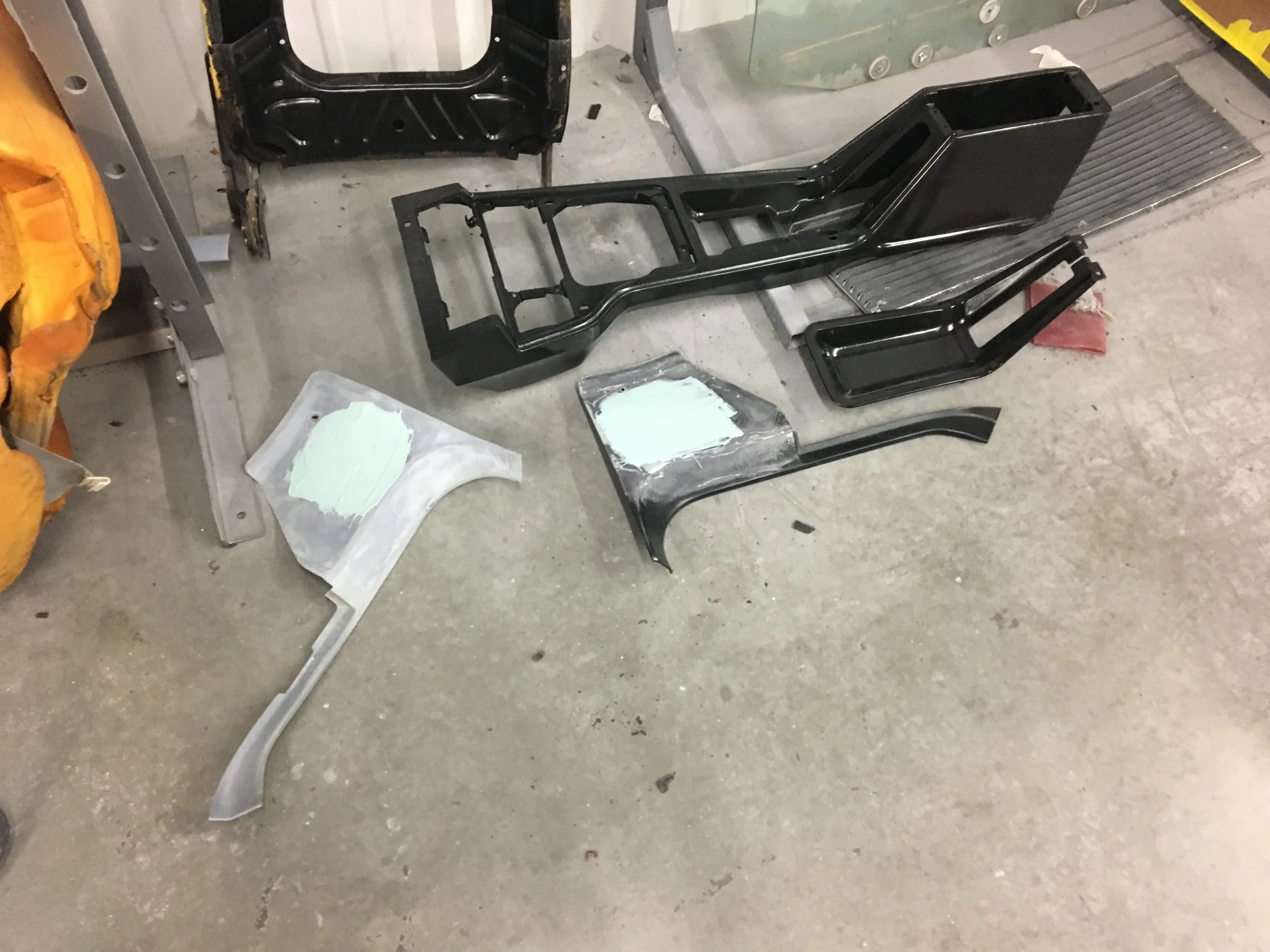

I also finished repairing the center console and e-brake cover and got them in primer. I will at least get them shot with the rocker chip guard (RCG) tomorrow. Hopefully painted by friday. There are a couple parts that actually didn't need repair that will go straight to RCG. Though the passenger windshield trim will need a bit of work. I'll show pictures of all the stuff on it tomorrow or the next day.

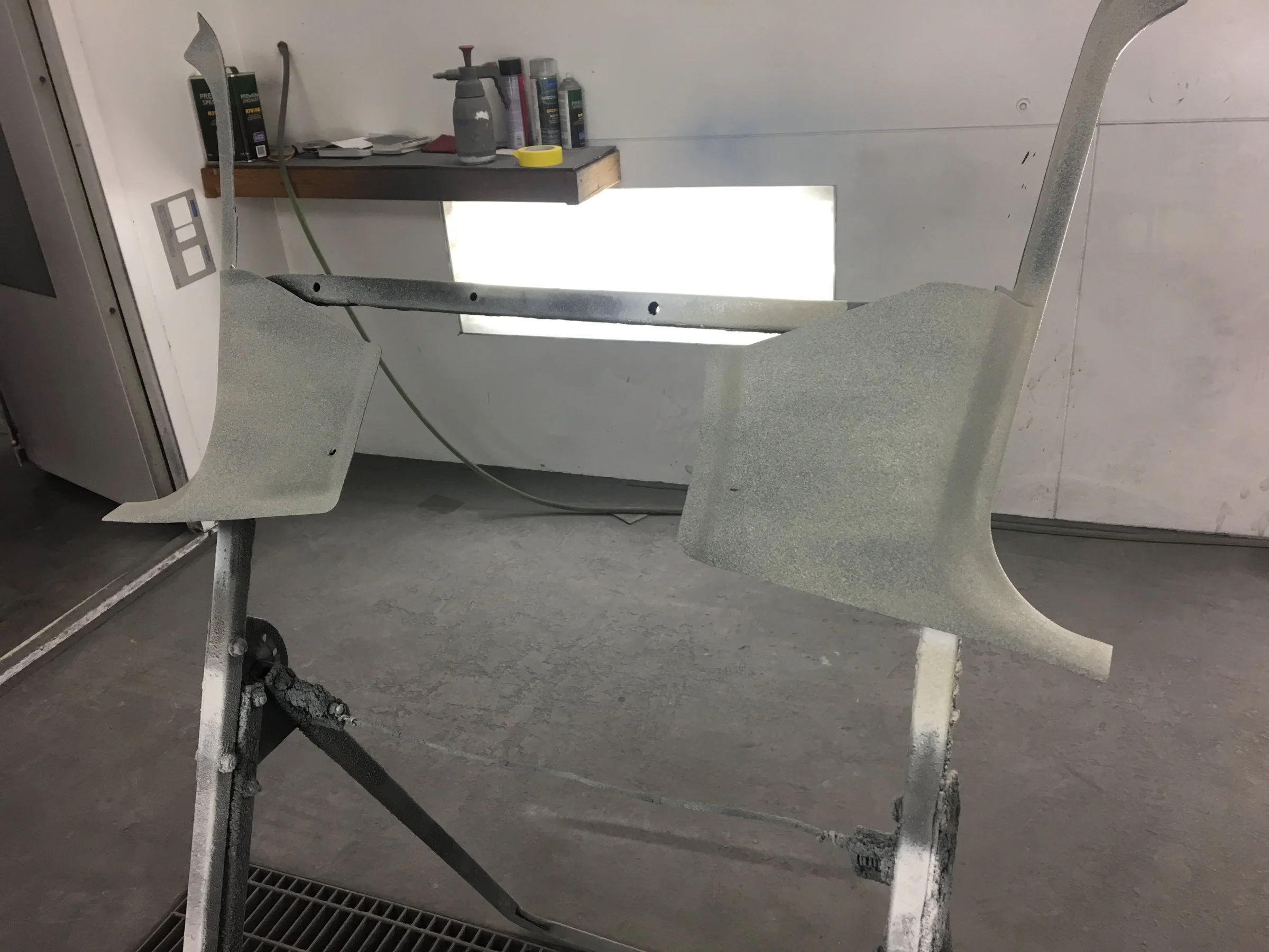

I finished patching both kick panels and have a light coat of polyflex on them that i still need to sand down. BTW, this brings up an interesting point. I had to sand down the right kick panel to get the repair to stick. Remember I had already done the paint job on it. The RCG and paint is freaking tough! Sort of yay! Great for the panels I have already finished.

Let's see, i finished disassembling the passenger seat. The bottom is yucky. I need to replace the springs and all of the listings in the seat.
I dropped of the seat frame bottom and sliders off at the sandblaster today. I'll paint it back to black and lithium lube the slide.
I bought same new high strength steel rod to trim to length to replace the listings.
I ordered the spring kit from LMR.

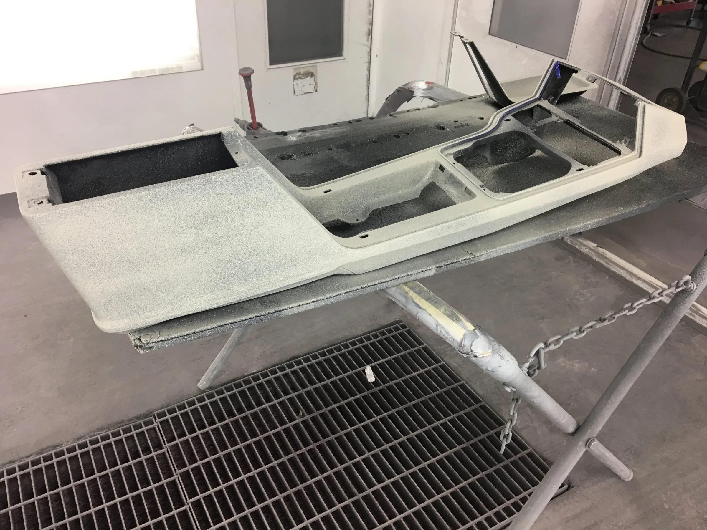

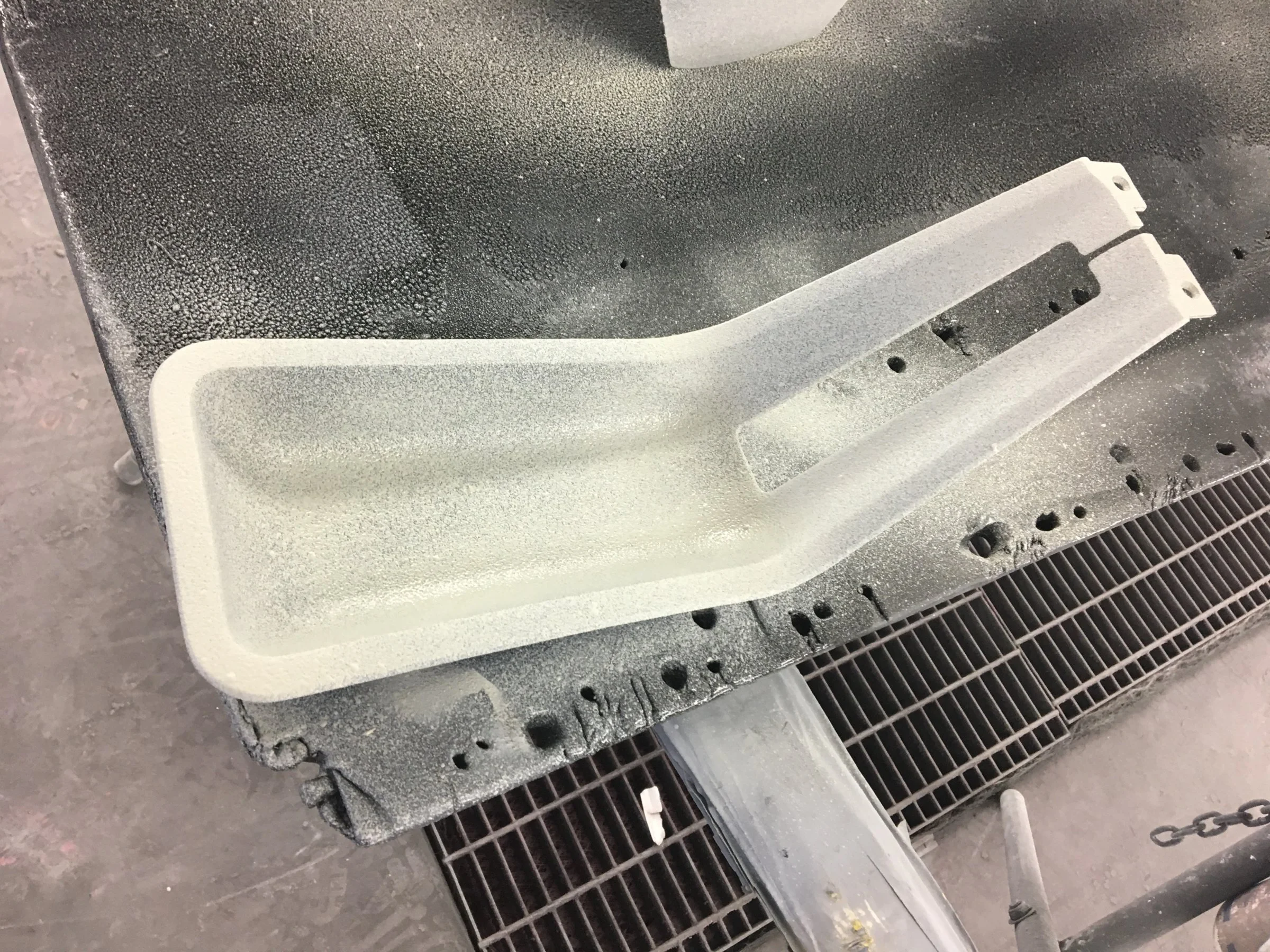

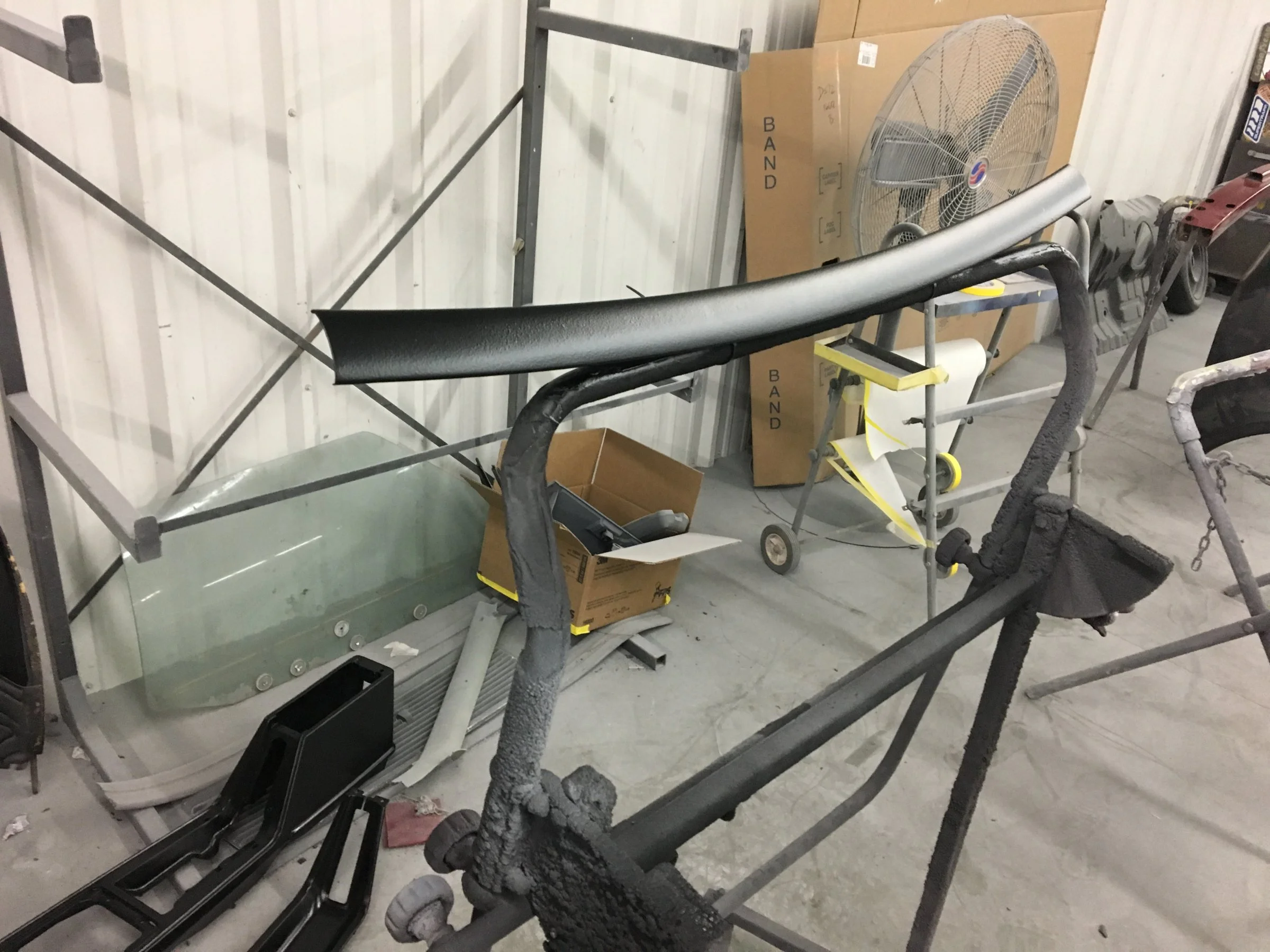

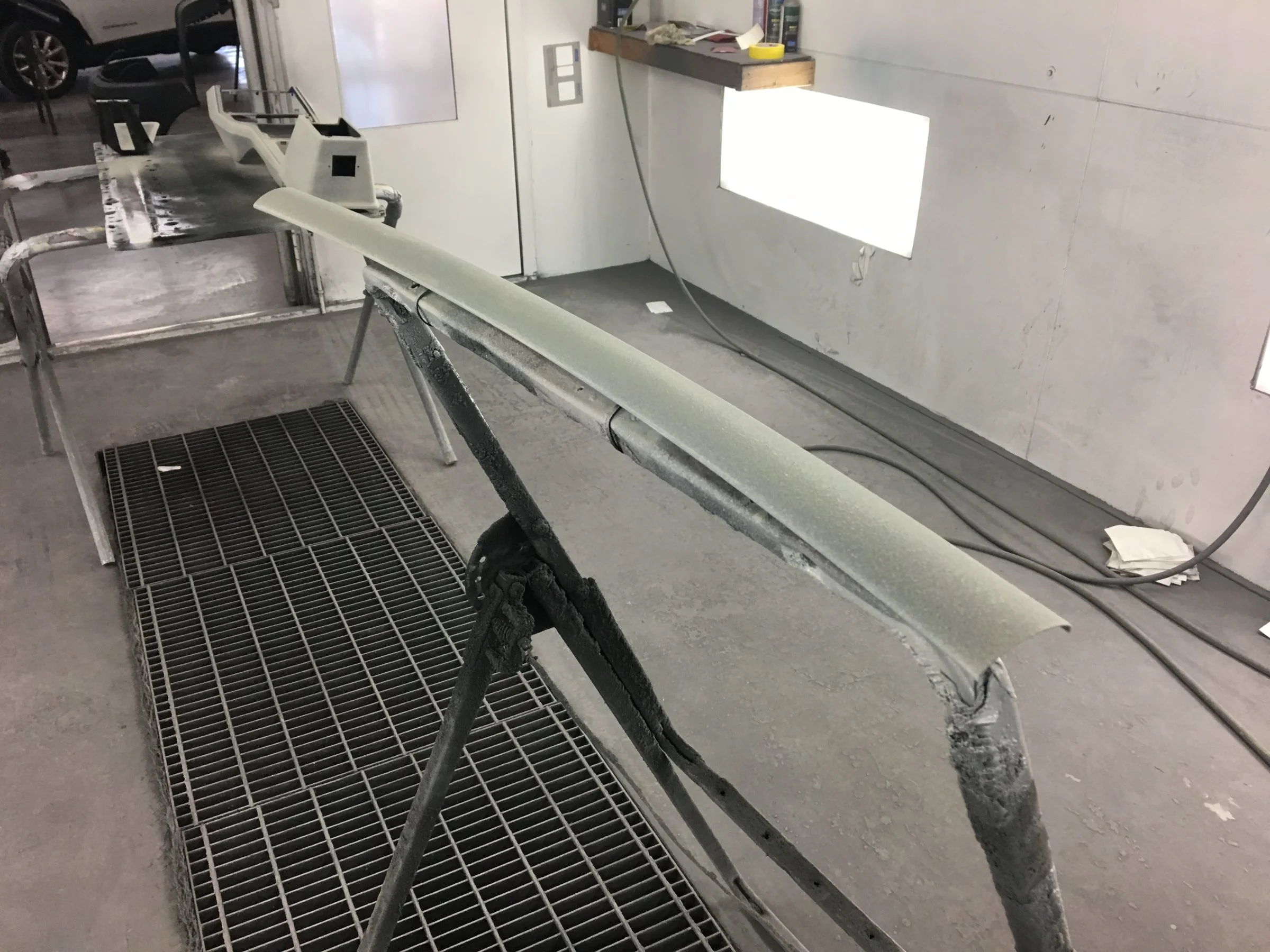

I also sanded down the primer on the center console, the eb handle cover and the interior trim that goes across the windshield and sprayed the rocker chip guard on them. I'll scuff that with 400 like i did with the other trim pieces and paint them. Maybe tomorrow i'll get the kick panels primered. I got to spend time with the interior side trim from the windshield too.

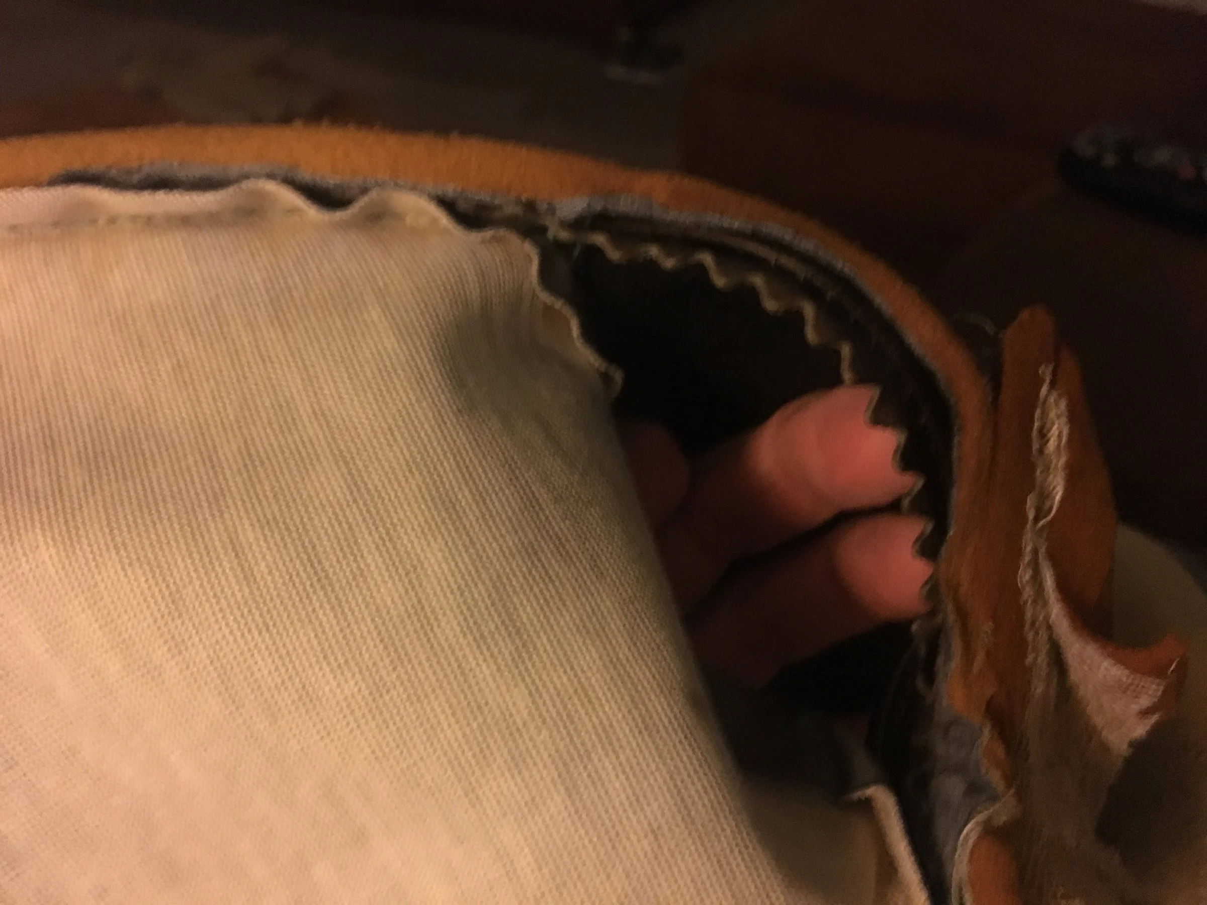

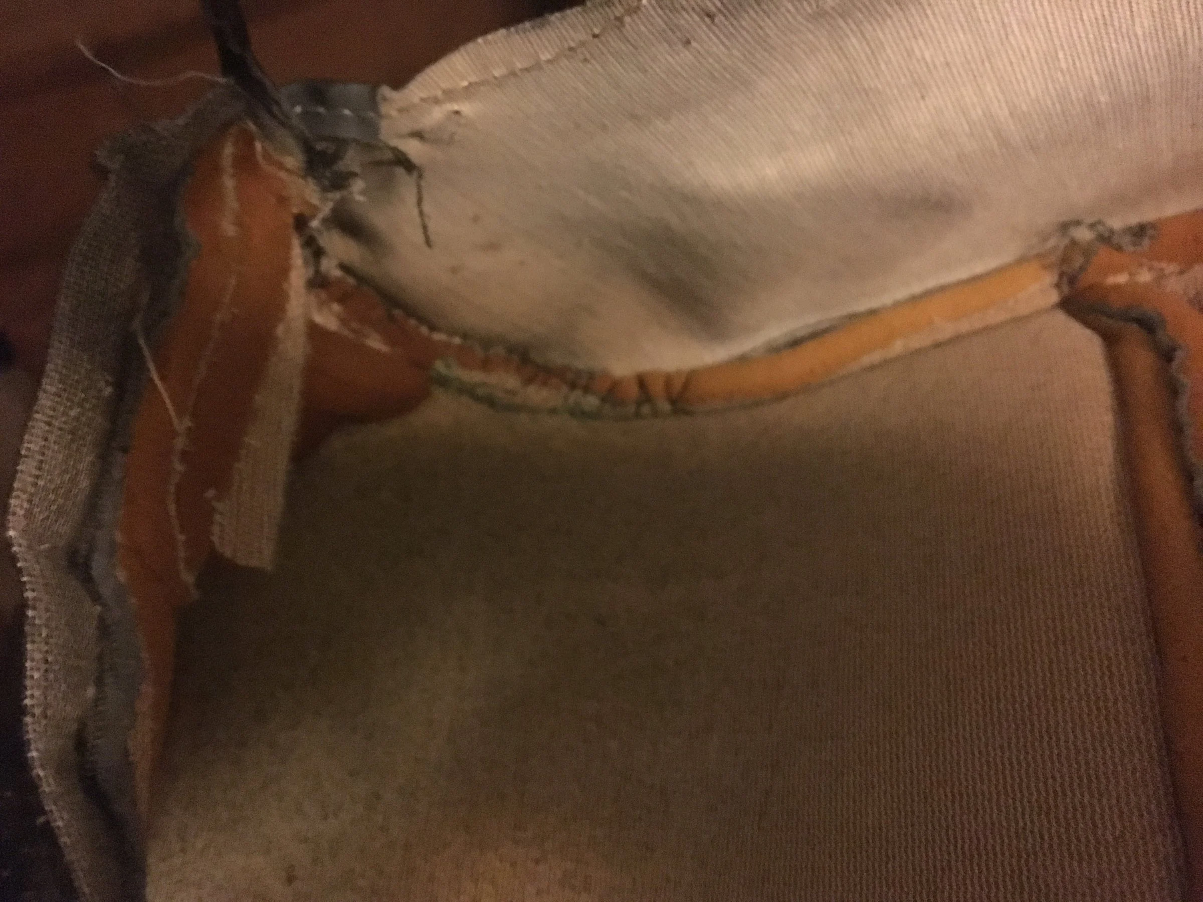

Oh yeah, I started sowing the rear seat upper cover. The seams had split out on the upper corners and in the middle. I've sown the right side and one middle seam. I had to stop. My fingers HURT!
Upholstery thread is some strong stuff, btw. It's 50 pound test strength. You don't just snap this stuff.

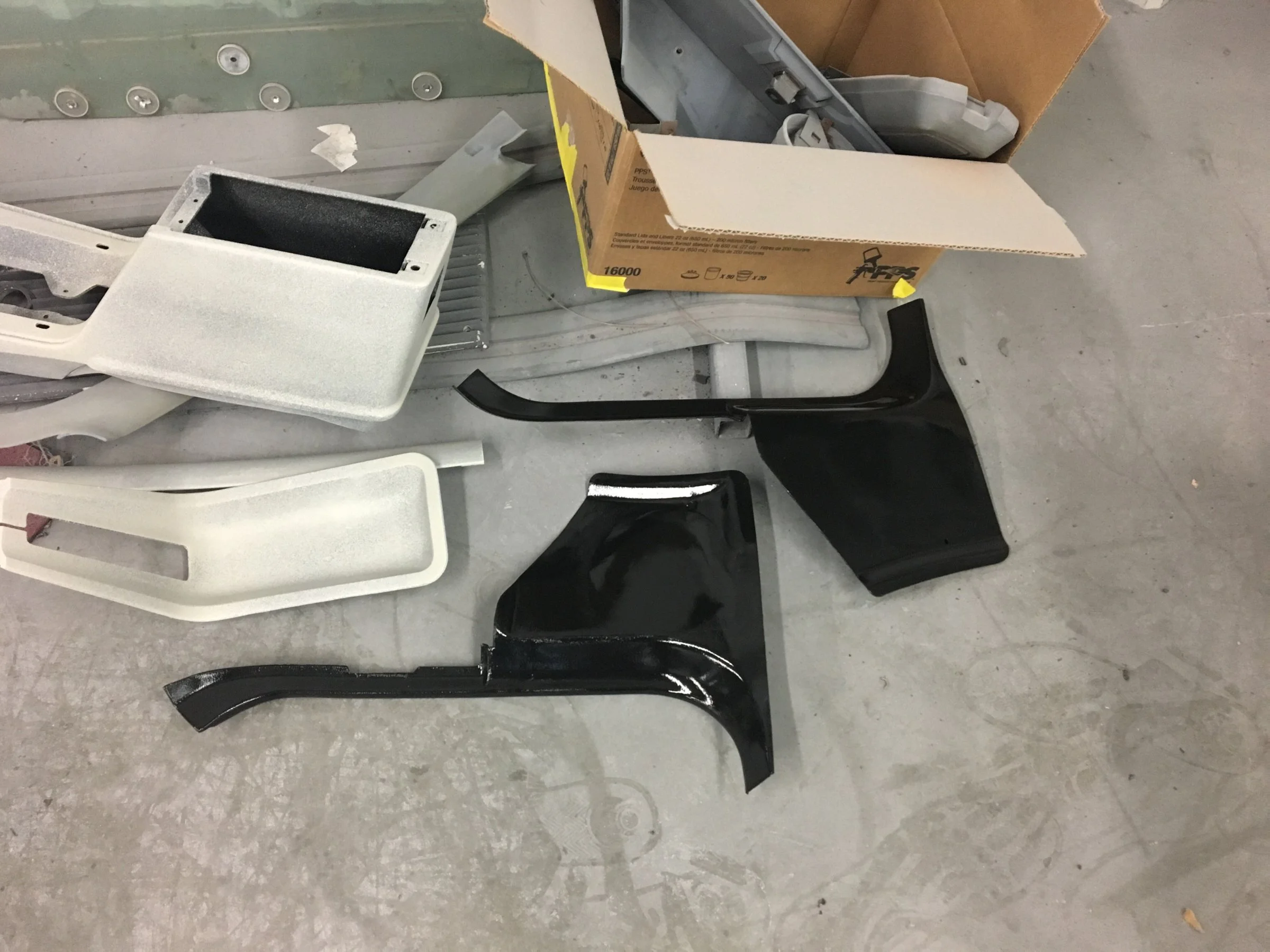

I did a couple more things today, first i sanded the kick panels and sprayed rocker chip guard (rcg) on them. I'll sand them tomorrow and paint them.

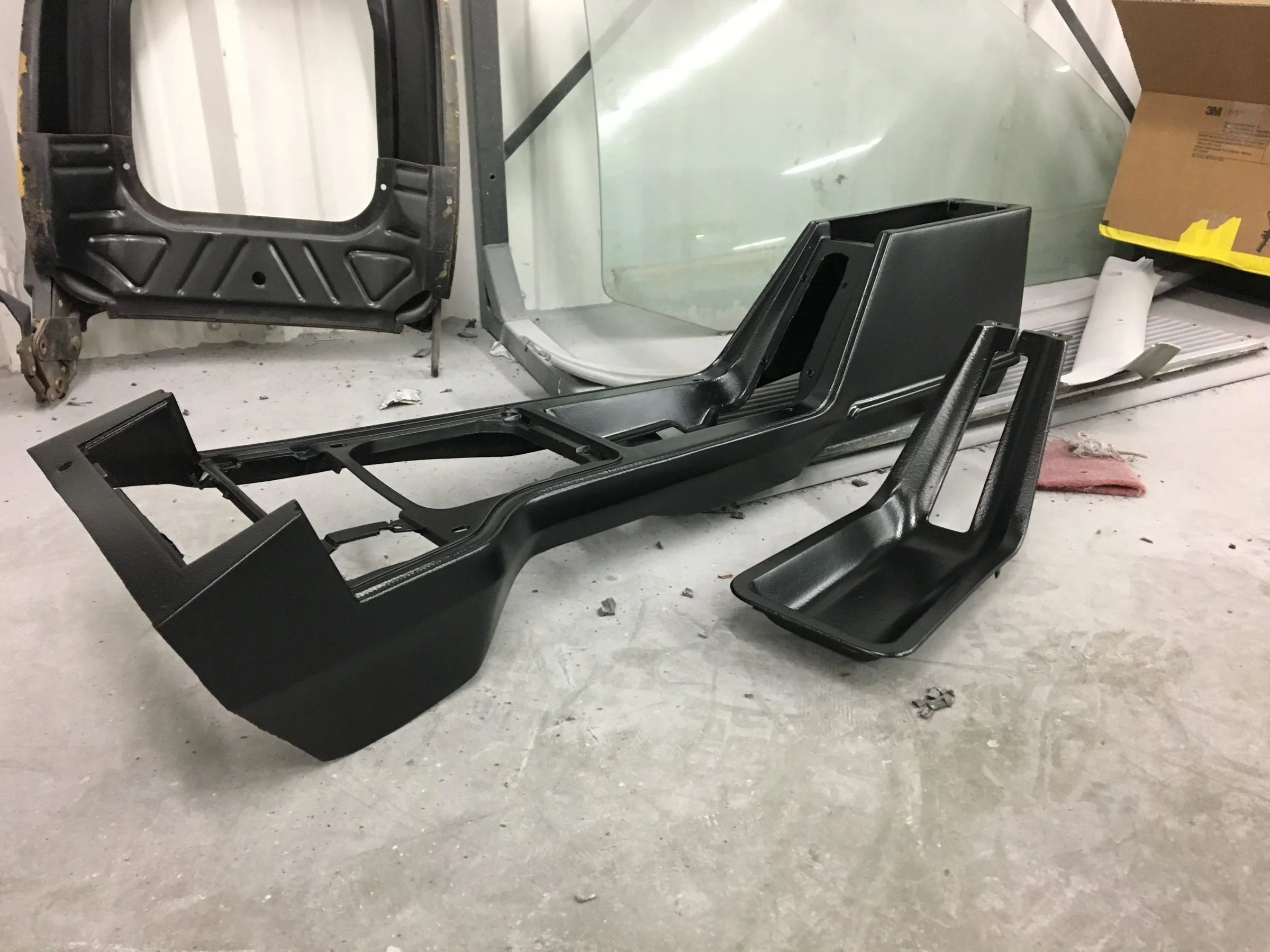

I sanded the rcg on the center console, eb handle cover and the windshield trim and painted them. Looks so much better now. I'll reassemble the console with all of it's brackets tomorrow. I need to get the chrome tape to redo the chrome piping on the console and console instrument cover too. EDIT: Before picture:
After:
