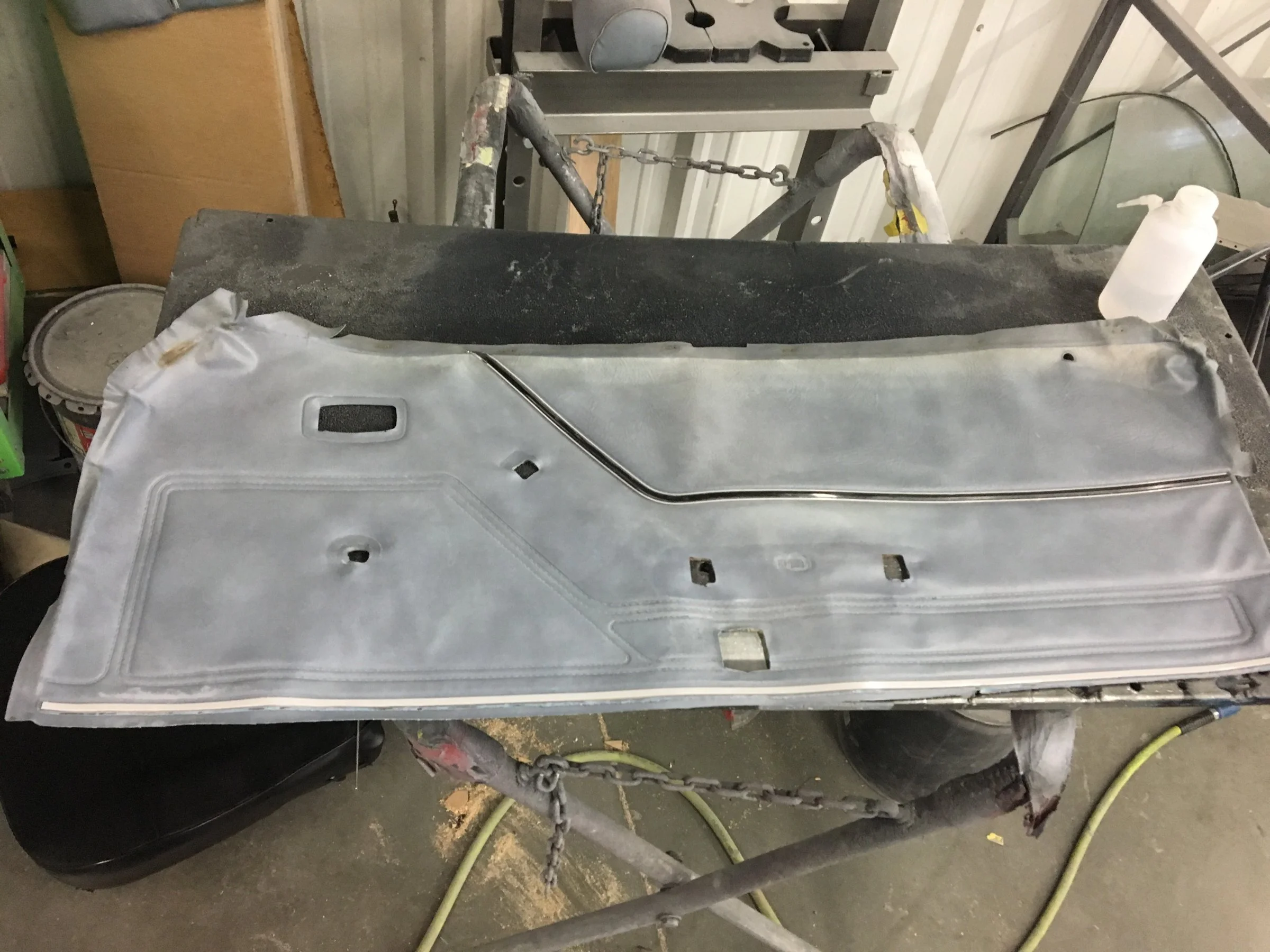

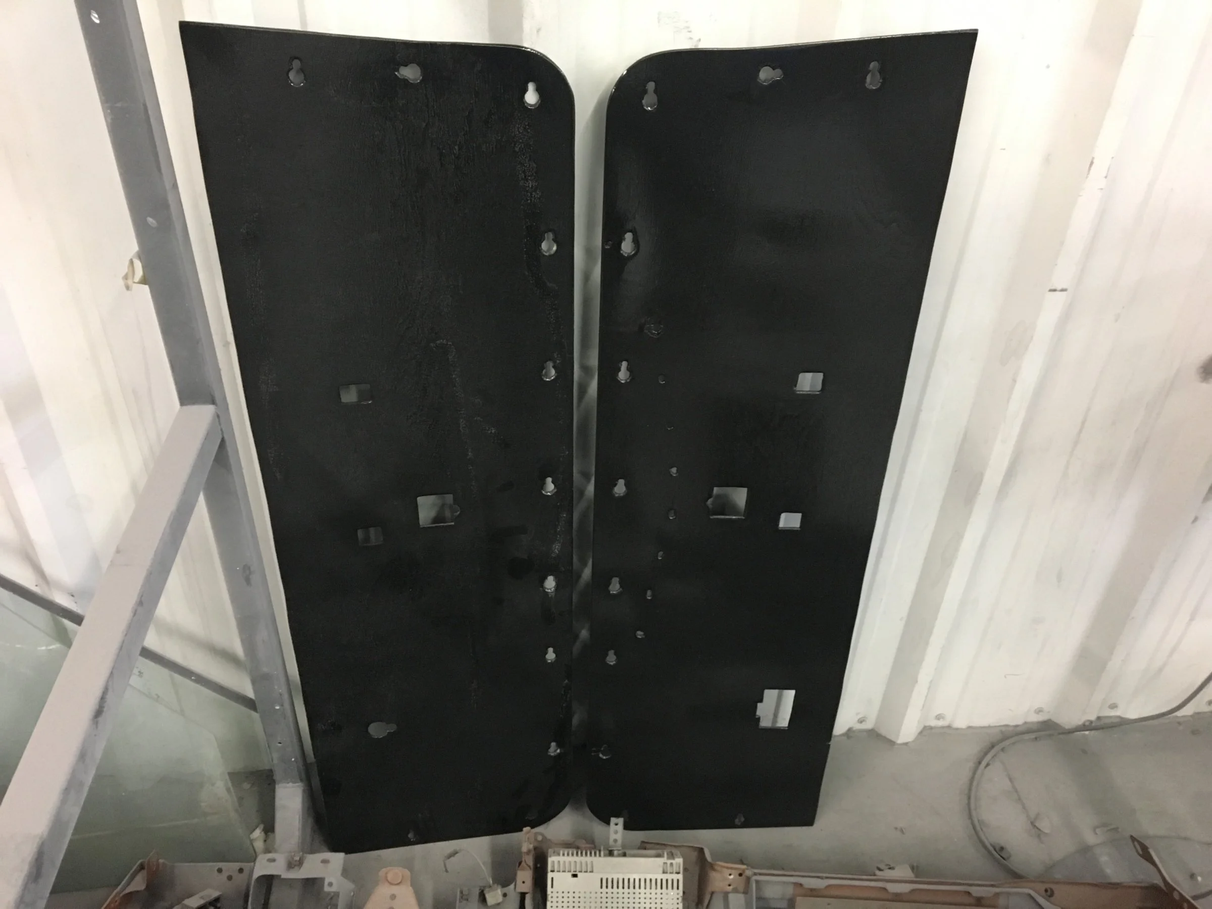

Let's start with the backing board, got the other one shot.

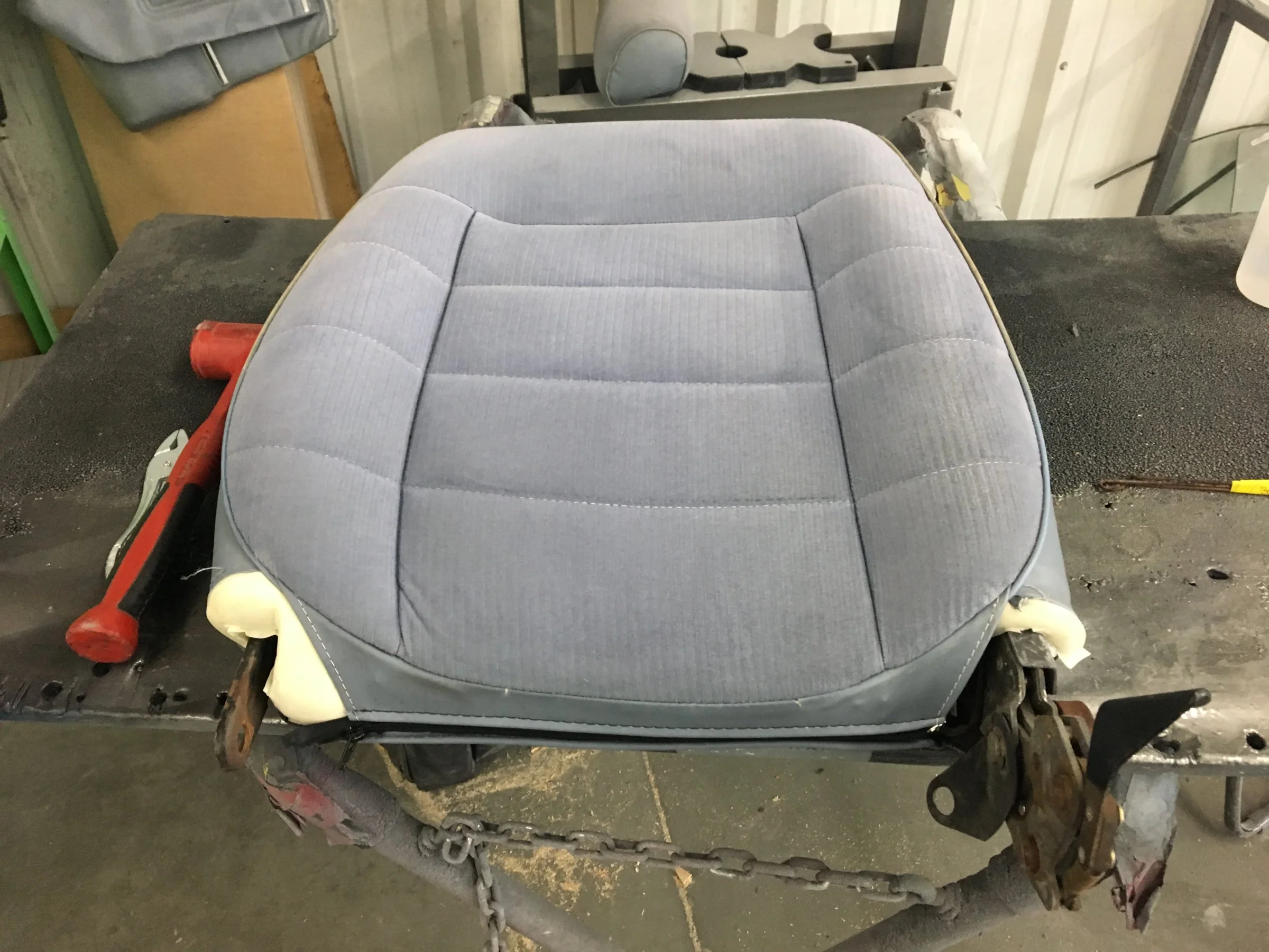

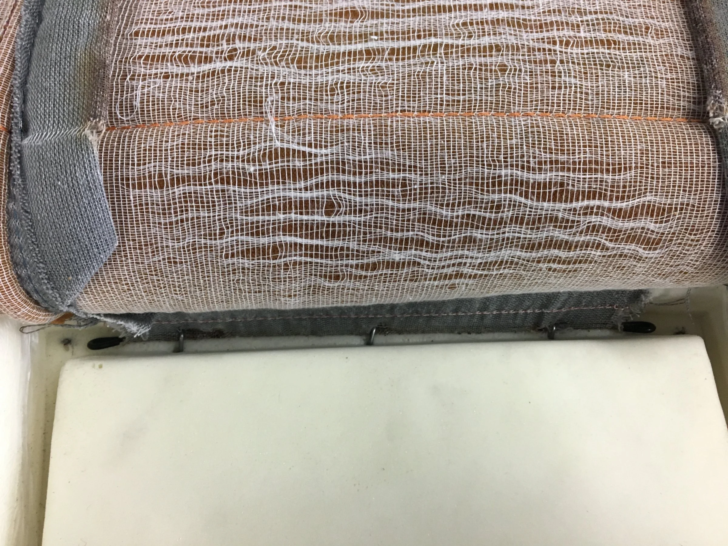

I rebuilt the back, but haven't painted it or the headrest yet. I started by glueing on some thin plastic across the top and the bolsters (it helps SOOO much to do this step).
Then I rolled on the cover and put in the necessary hog rings.
Done for today.

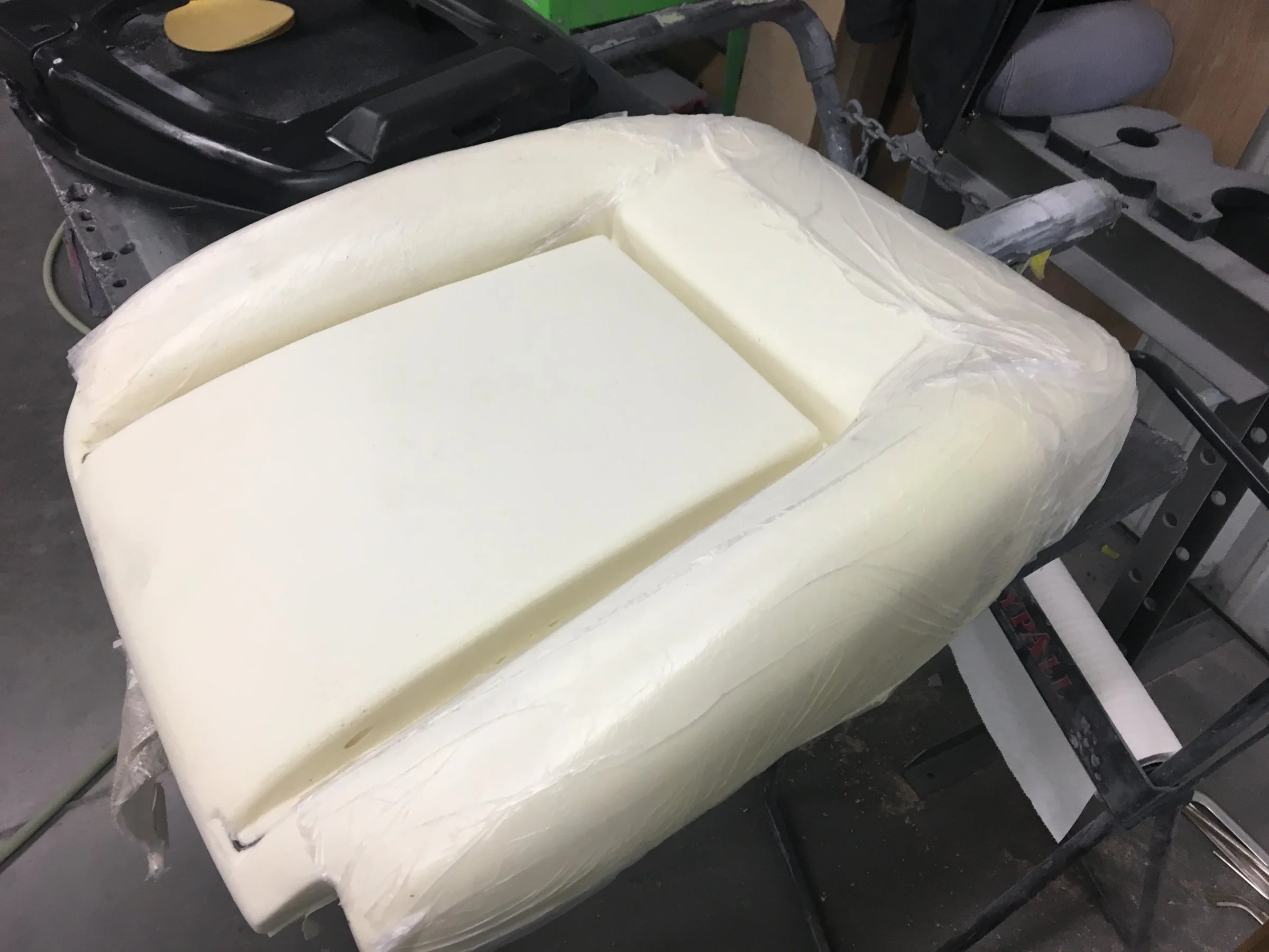

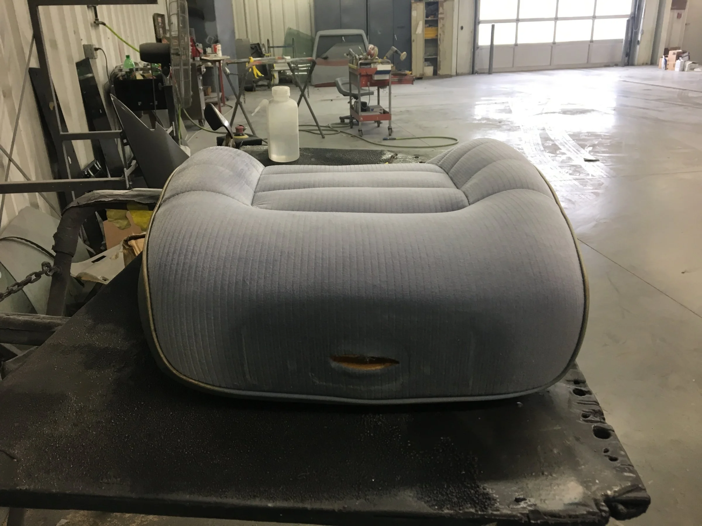

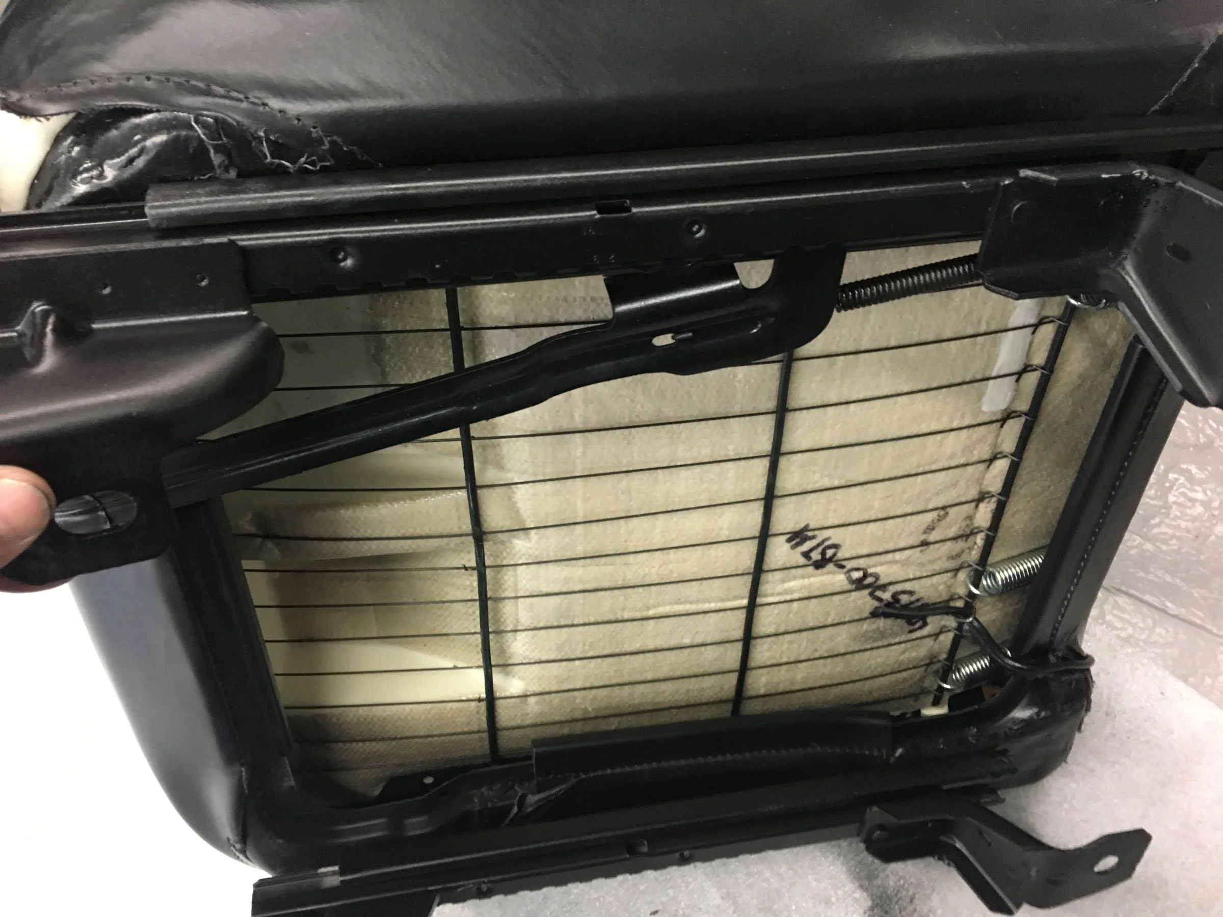

I rebuilt the bottom. I made new listing rods for it at lunchtime. A before and after photo.
