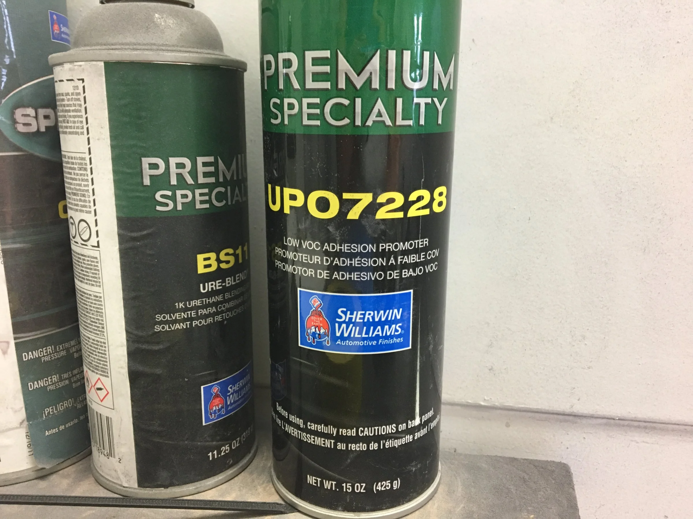

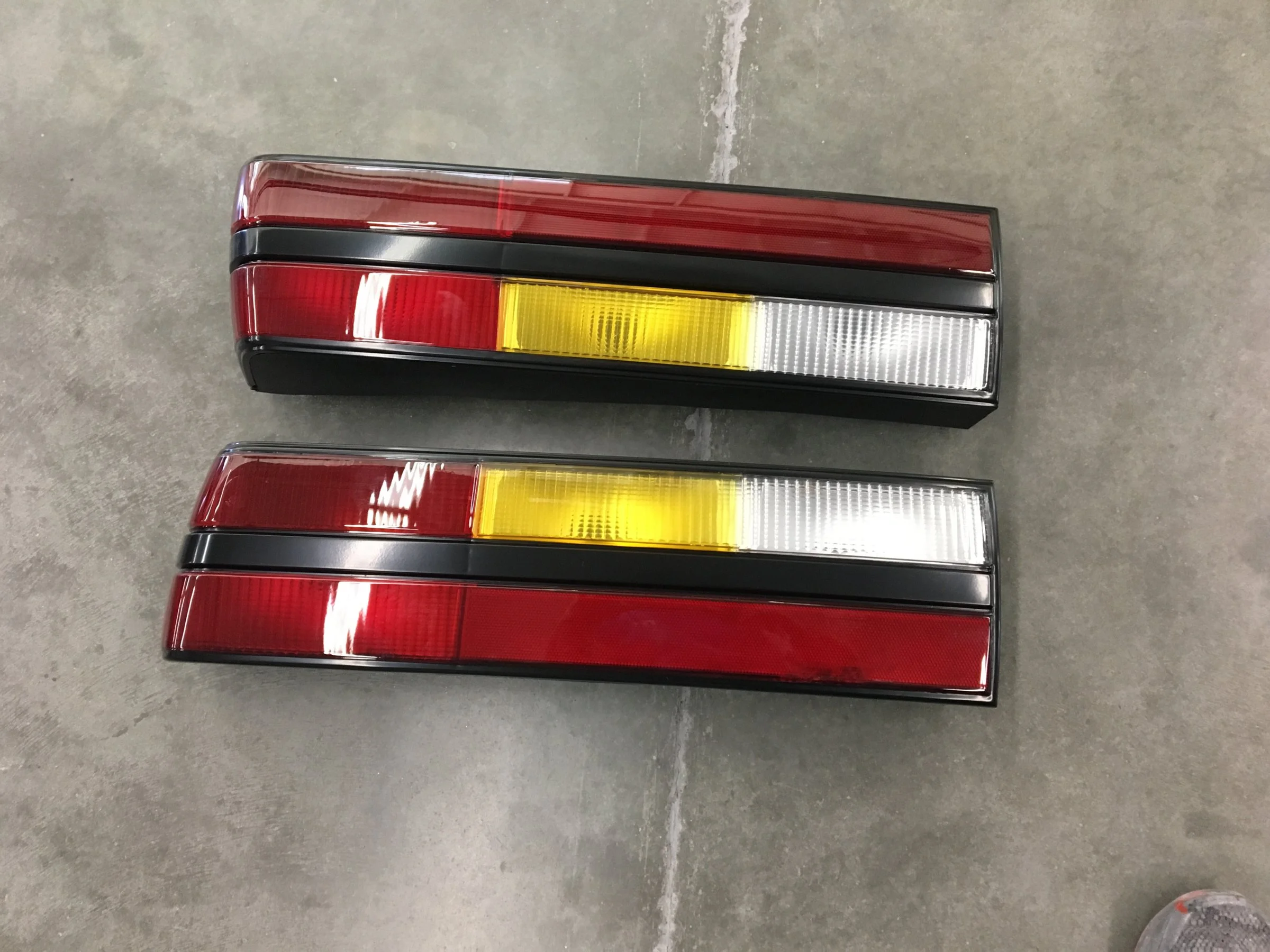

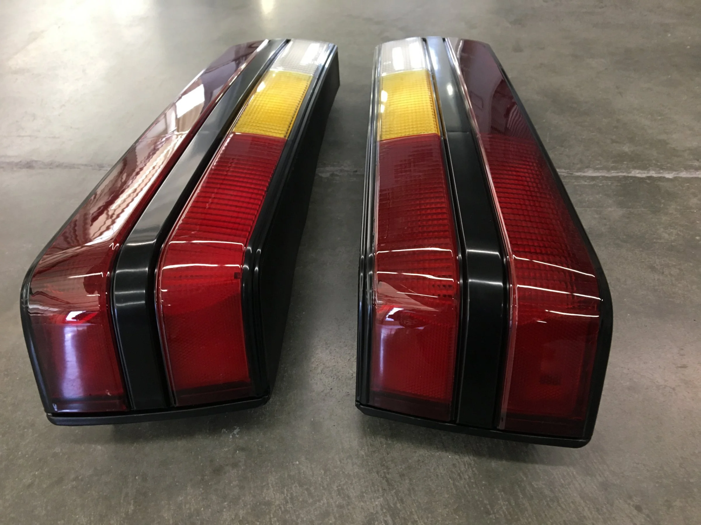

Does that adhesion promoter come in rattle can? I don't have access to a paint gun nor do I have the experience to use one. But I really wanna revive my taillights like you did. So if everything needed comes in rattle can I'll do it. I have buddies that paint but trying to get them to do ANYTHING in a timely manner is practically impossible.
I second this question.
I was also wondering, @Davedacarpainter what size butyl tape you used to put the lenses and housings back together? I need to redo the tails on my '90 Mercury and would like to take them apart and do the chrome paint and clean up the lenses as well.
Yeah Craig, it's in a rattle can. i used a sherwin williams adhesion promoter, but any brand will work.
Isn't it amazing how good they turned out? I say this meaning everyone can get these results, not that i'm a special taillight wizard or something. No filmy look at all.
Reactions: stangboy
I'm going to take whatever size our glass guy has. I did him a couple favors so he's taking care of me with my glass and extra butyl for crap like this.
It has to be pretty narrow though, that channel is maybe 1/8" wide. If he has wider stuff, i'll just roll it out like dough to make it a smaller diameter.
Reactions: General karthief
The great part about that is I work for Sherwin-Williams(2nd job). So I get a discount!:banana: Do you have all the part/product #s? I would like to get the exact same stuff you got.
I'll get the AP # for you on Monday. I used SW's HPC15 clear with UH80 hardener and US2 reducer for the clear.
I'm pretty sure you can get the clear and additives in small quantities. Though we just use the gallon can versions in our shop.

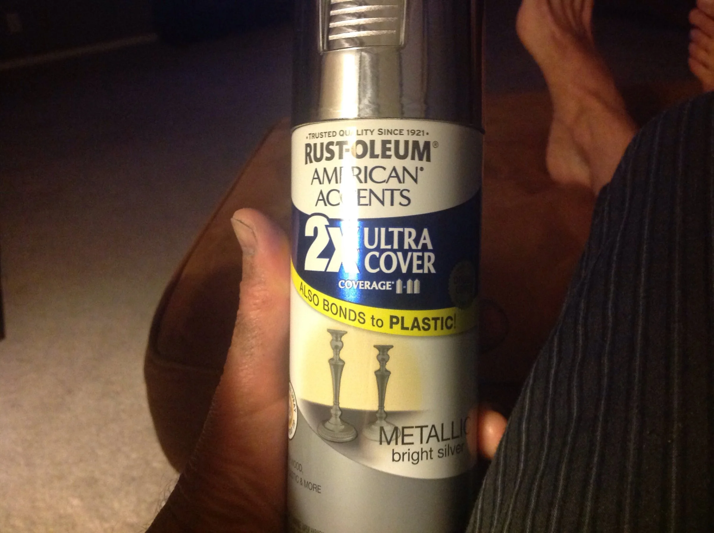

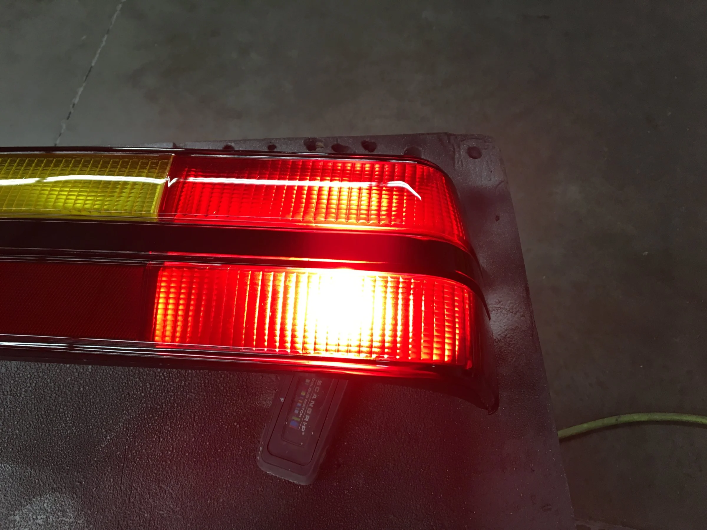

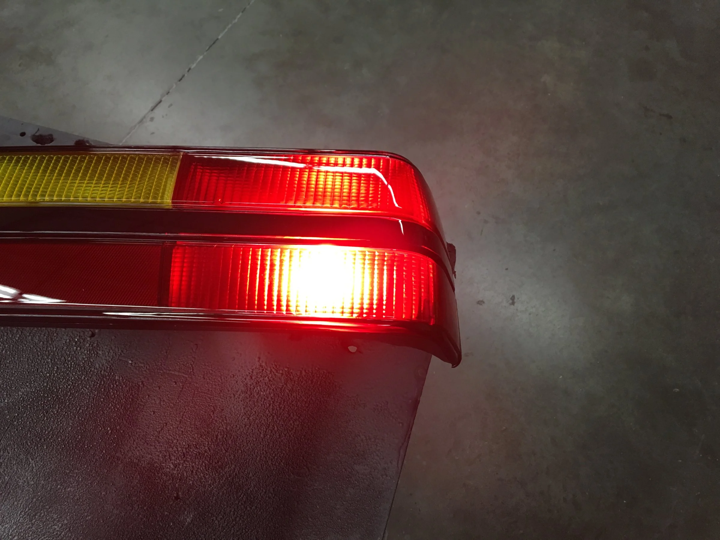

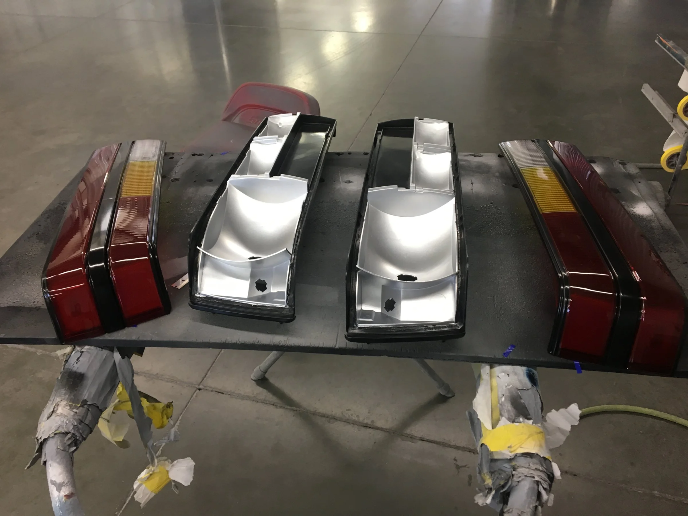

So I used my new silver paint this morning on the housings. Here's a before and after photos showing how it brightened it up. Keep in mind this is with the bulb shining up through the back of the housing, I would assume the difference will be even more pronounced when the bulb is inside the housing.
