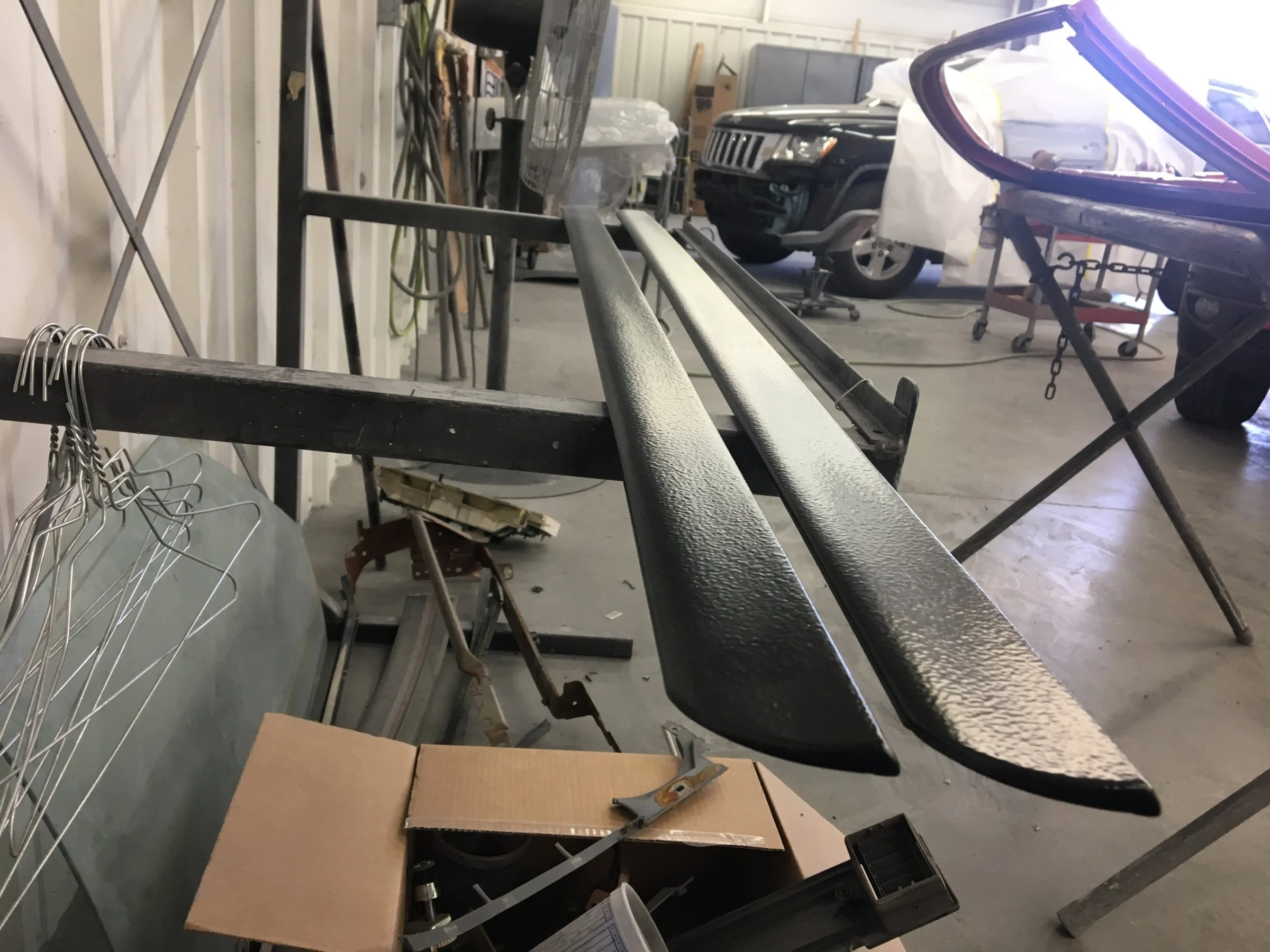

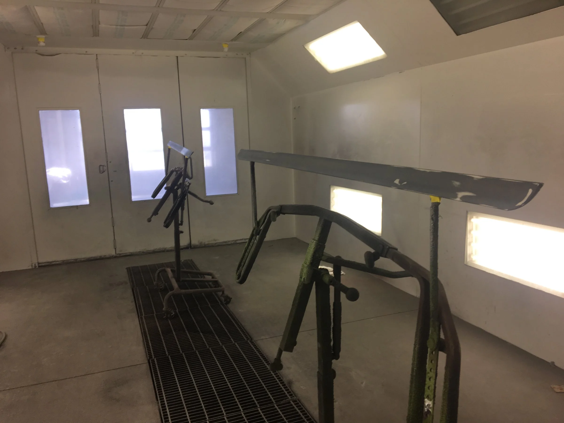

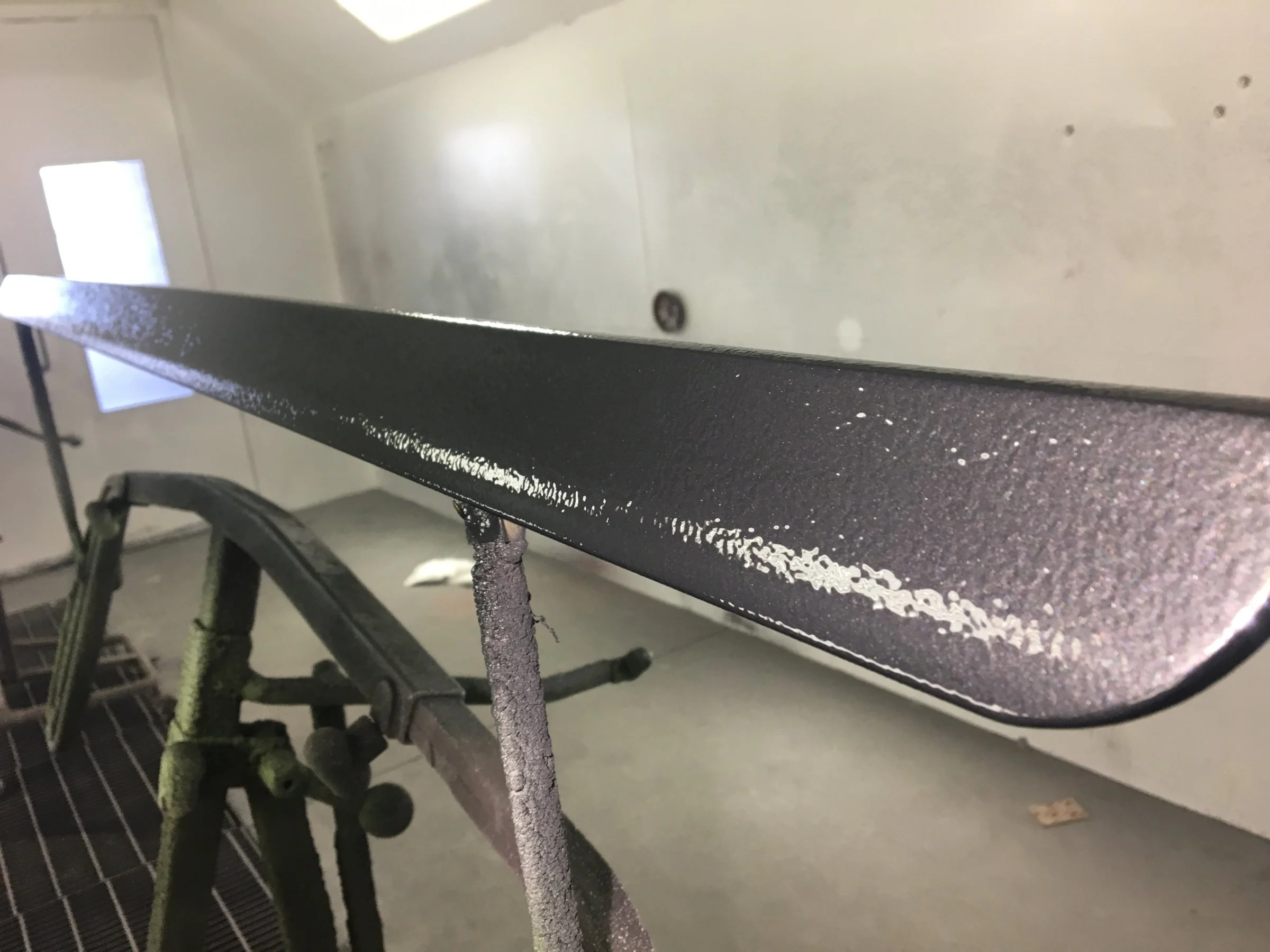

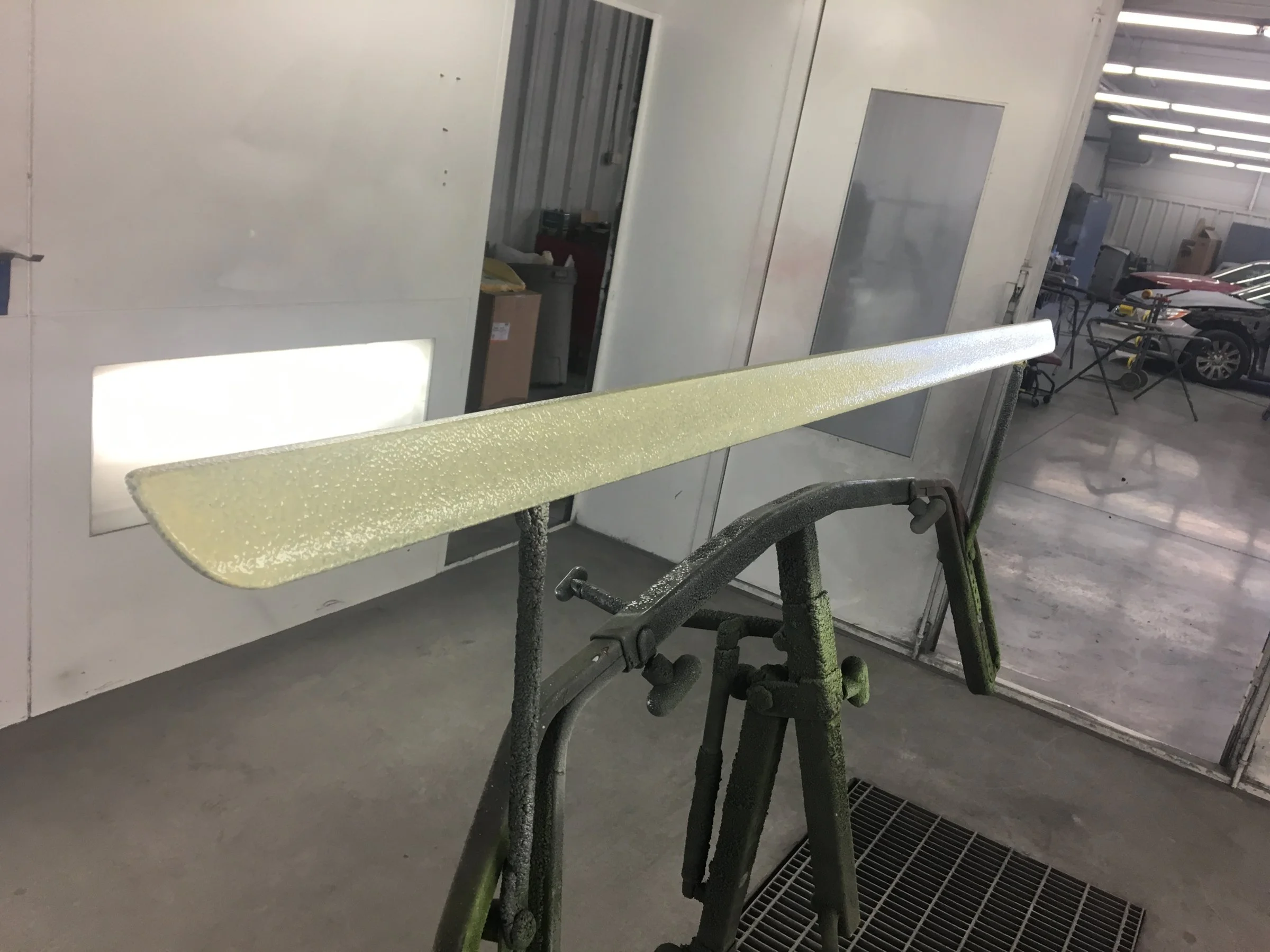

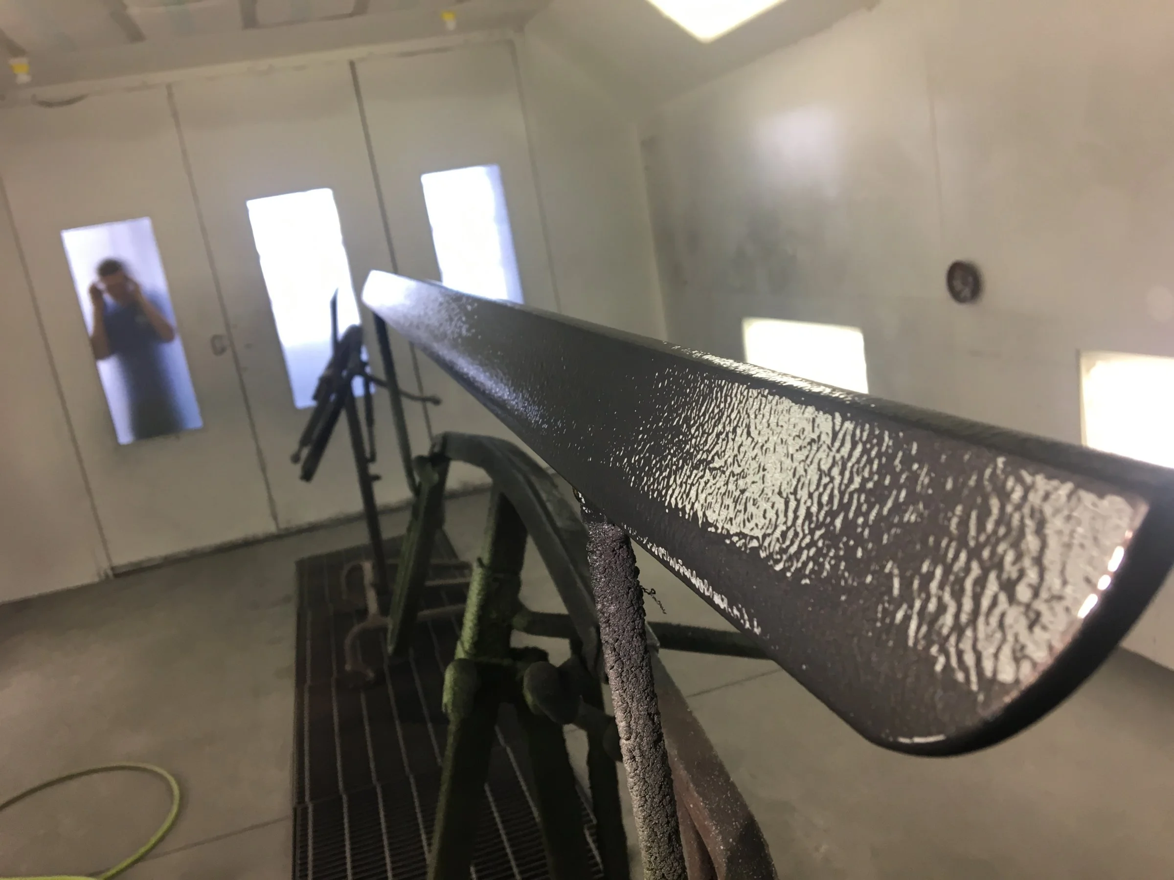

Alright, I got them painted and am very satisfied with how they look. My pictures aren't that great though. I know they look heavy duty orange pealy. That's just the rocker chip guard. I'm very cool with it. The picture shows them while the clear coat is still wet. The gloss died back to a nice eggshell. I'm very pleased with how straight they turned out considering the lack of time I put into them.
In this picture you can see my idiot ex-helper who is a painter now. Dumbass boy.
What made you decide to have them textured, rather than smooth?
It's just the nature of a heavy rocker chip guard.
Those panels will see lots of abuse when the car is driving and would get chipped up horribly without the chip guard.
Plus it's not a high visibility exterior area, except for those people that will look at the undercarriage.
They're noticeable while standing up, just not very....rock chips would stand out when looking at them though.
An additional reason is that there are thin metal and without the chip guard their Rockwell rating is pretty high. Meaning the only thing to absorb the impact of rocks and stuff would be the paint....chips, chips, chips.
I'll post another picture of them today. I really like the sheen of them after the bake cycle.

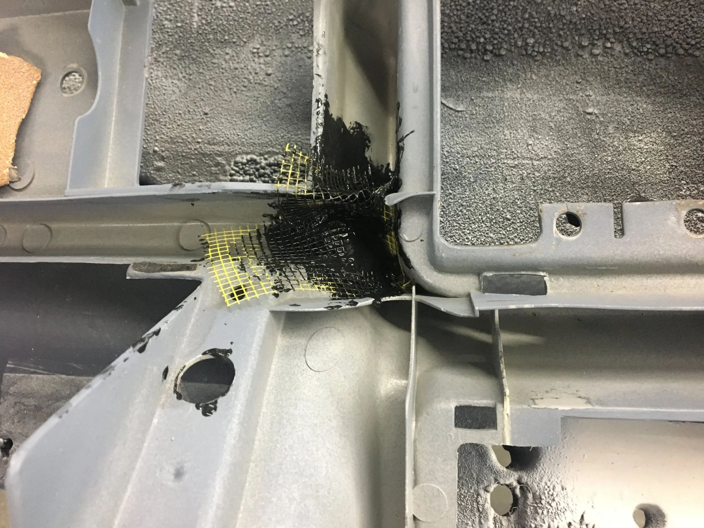

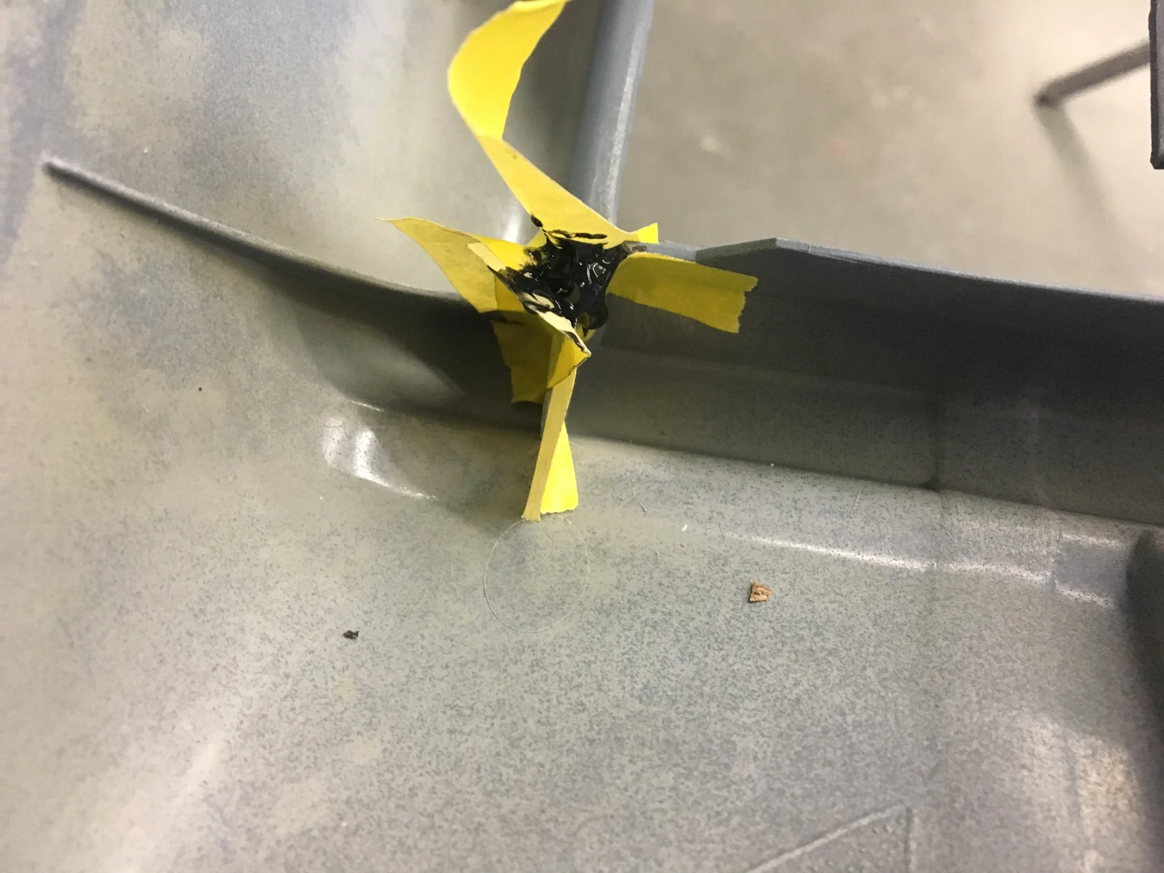

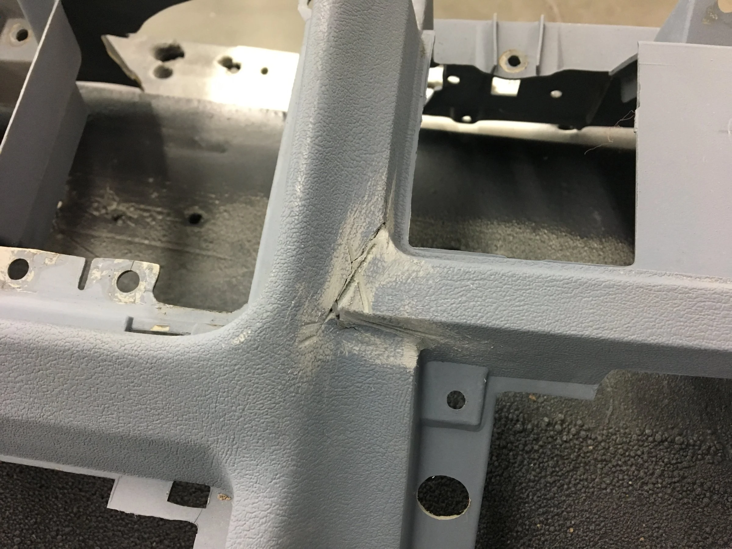

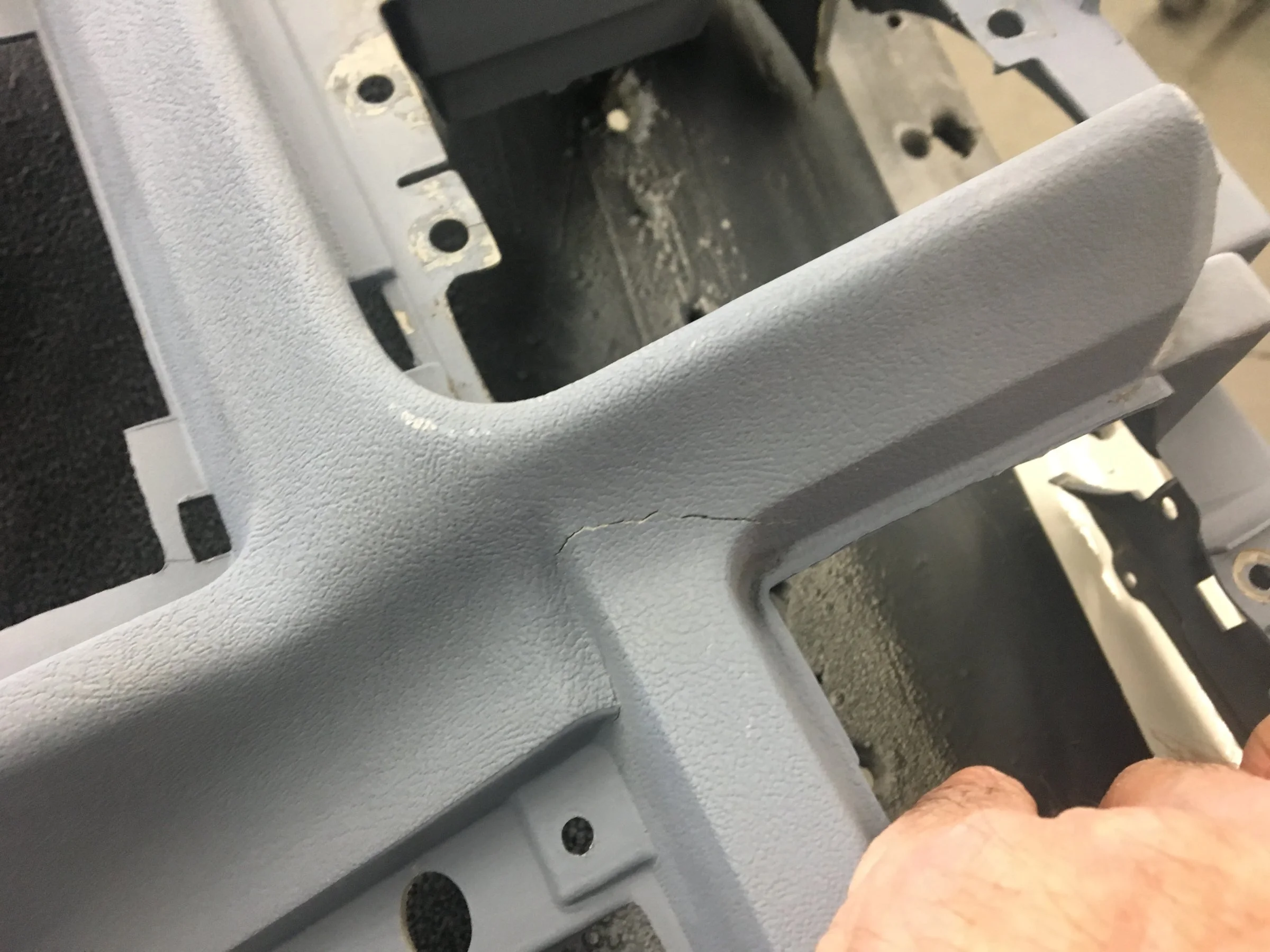

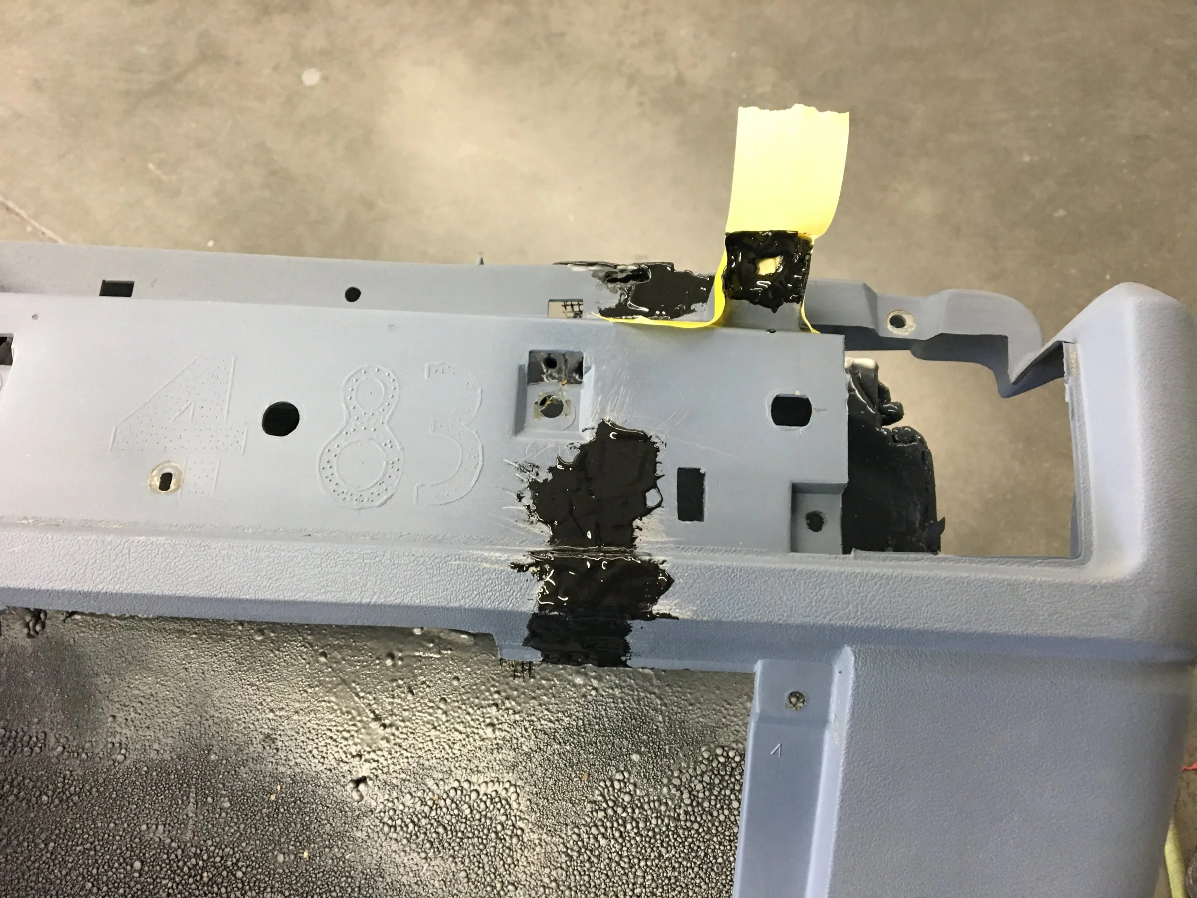

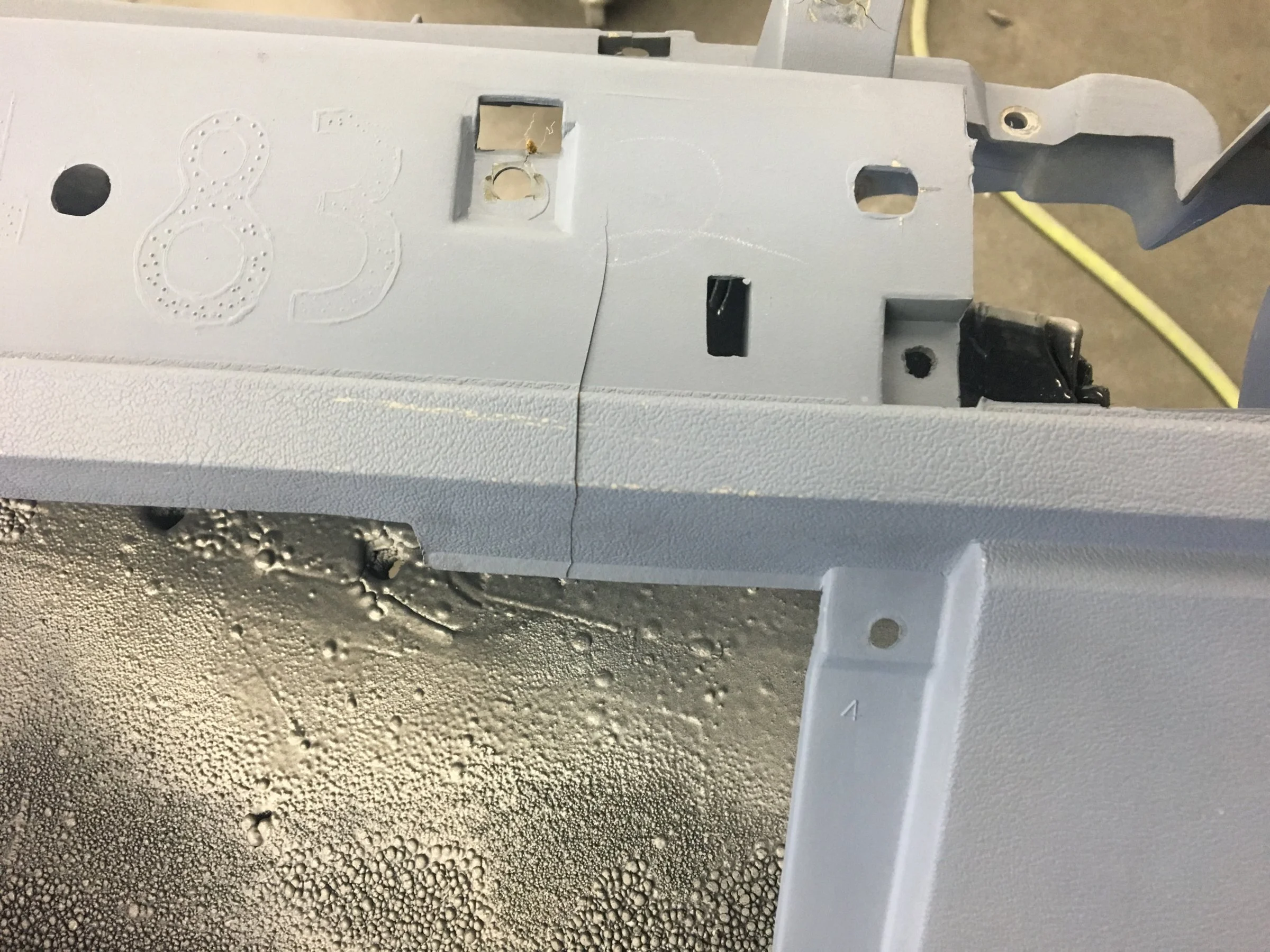

So I got started on the IP. I picked four cracks to work on. The two that will be seen from the outside one by the right speaker hole and remake one peg the metal frame screws to.

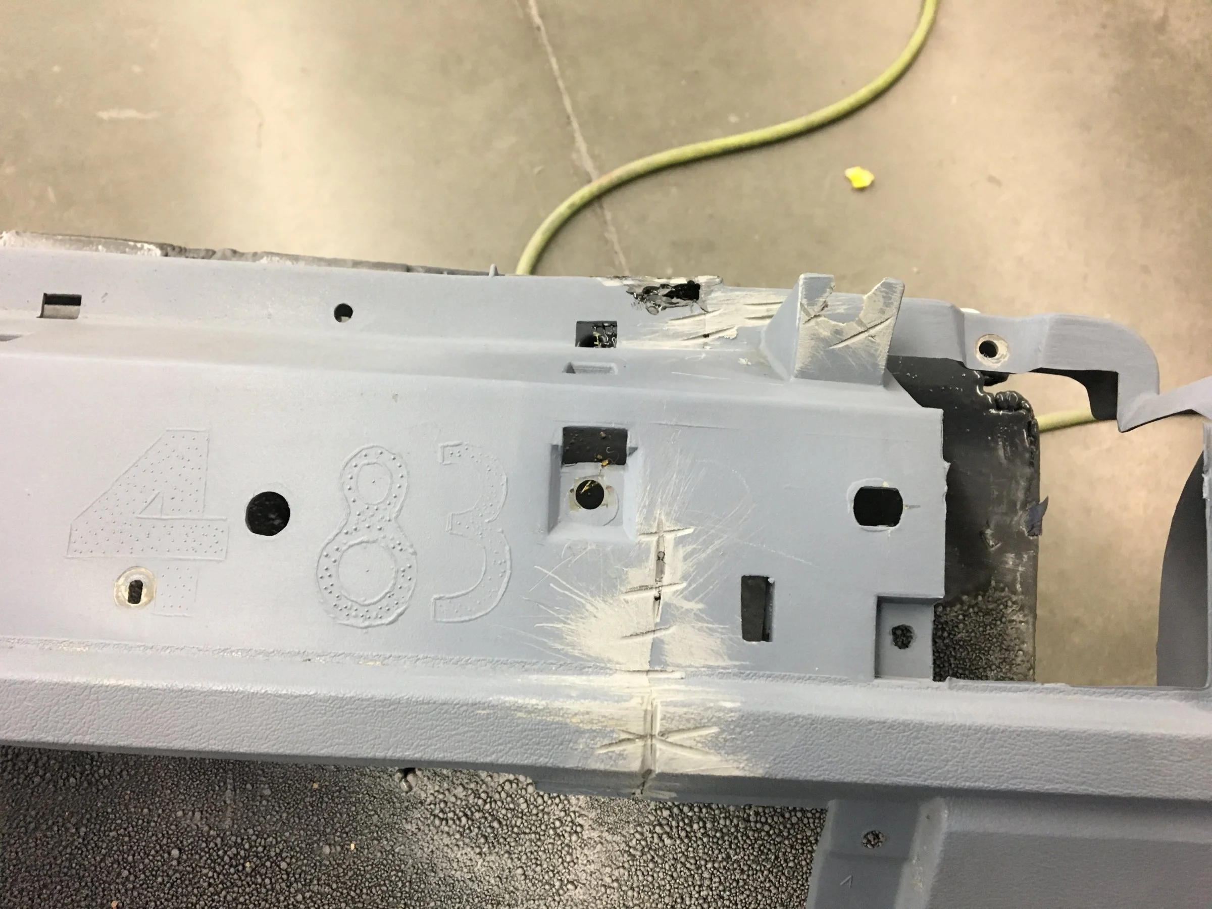

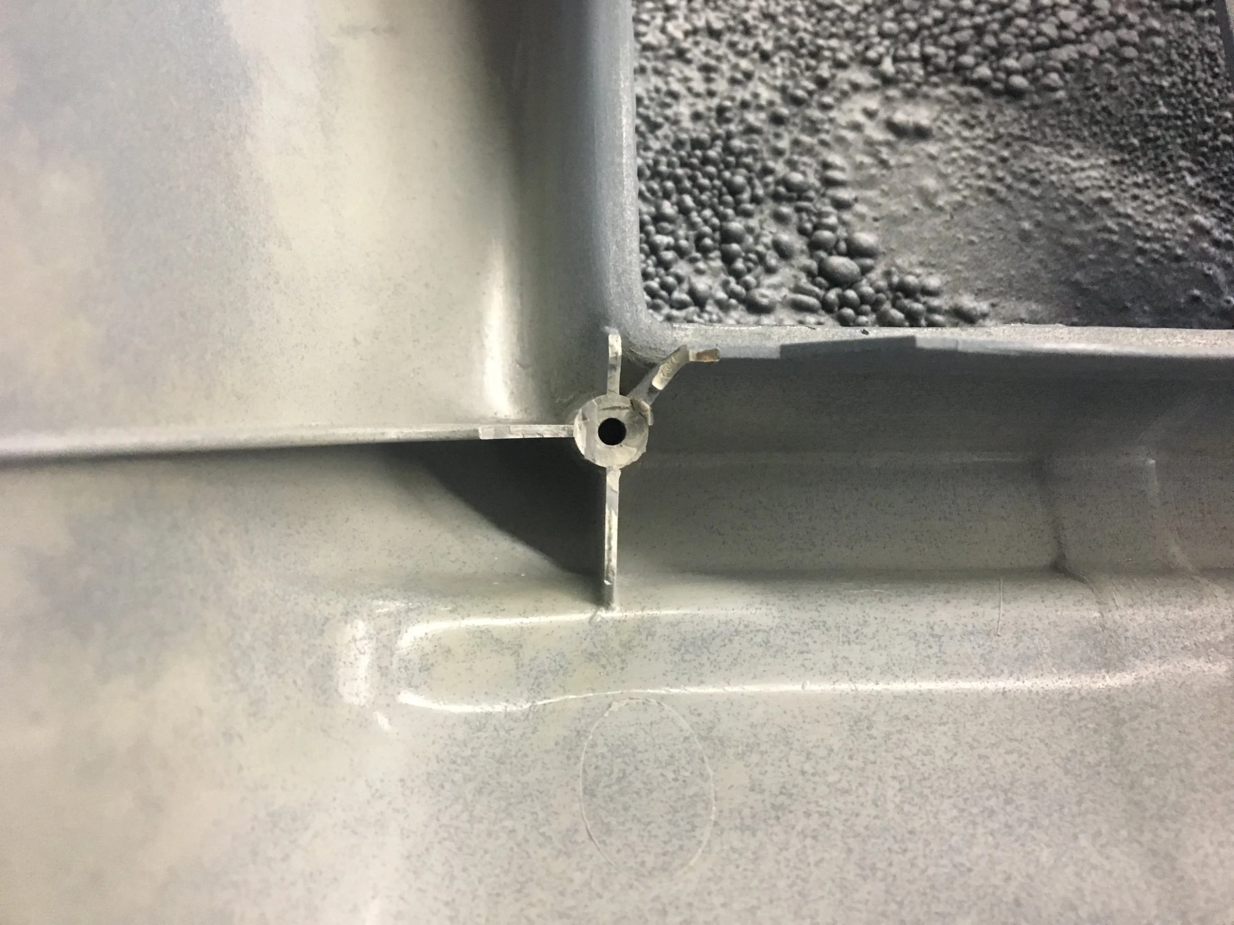

The usual prep, I used a dye grinder to v out the cracks and started the repair on the back side, tomorrow I'll flip it and get the front. I made a tube with tape to make the peg and squirted the Panel Bonding Adhesive into that tube.
I had to use some zip ties to hold a couple of the cracks together.

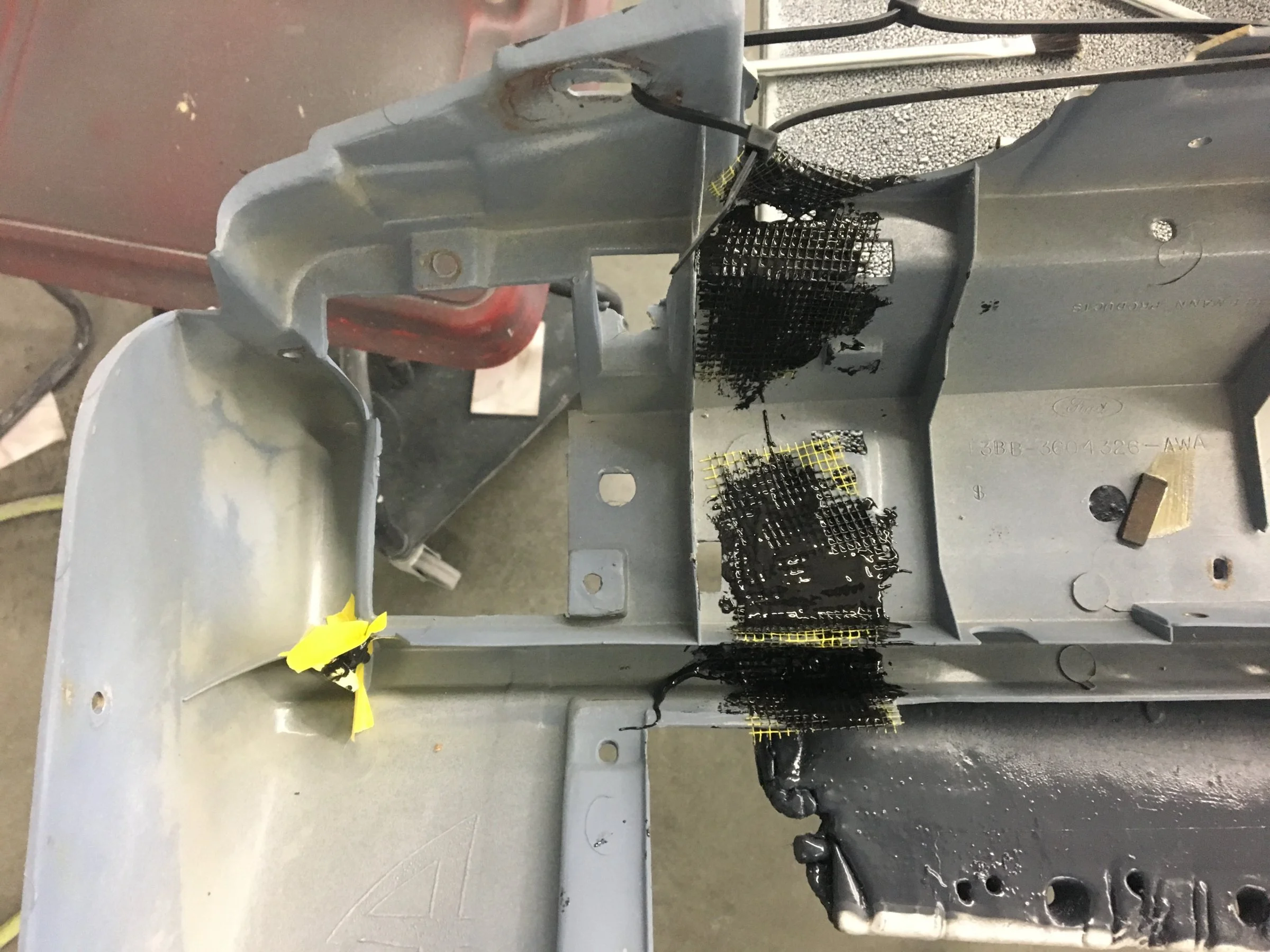

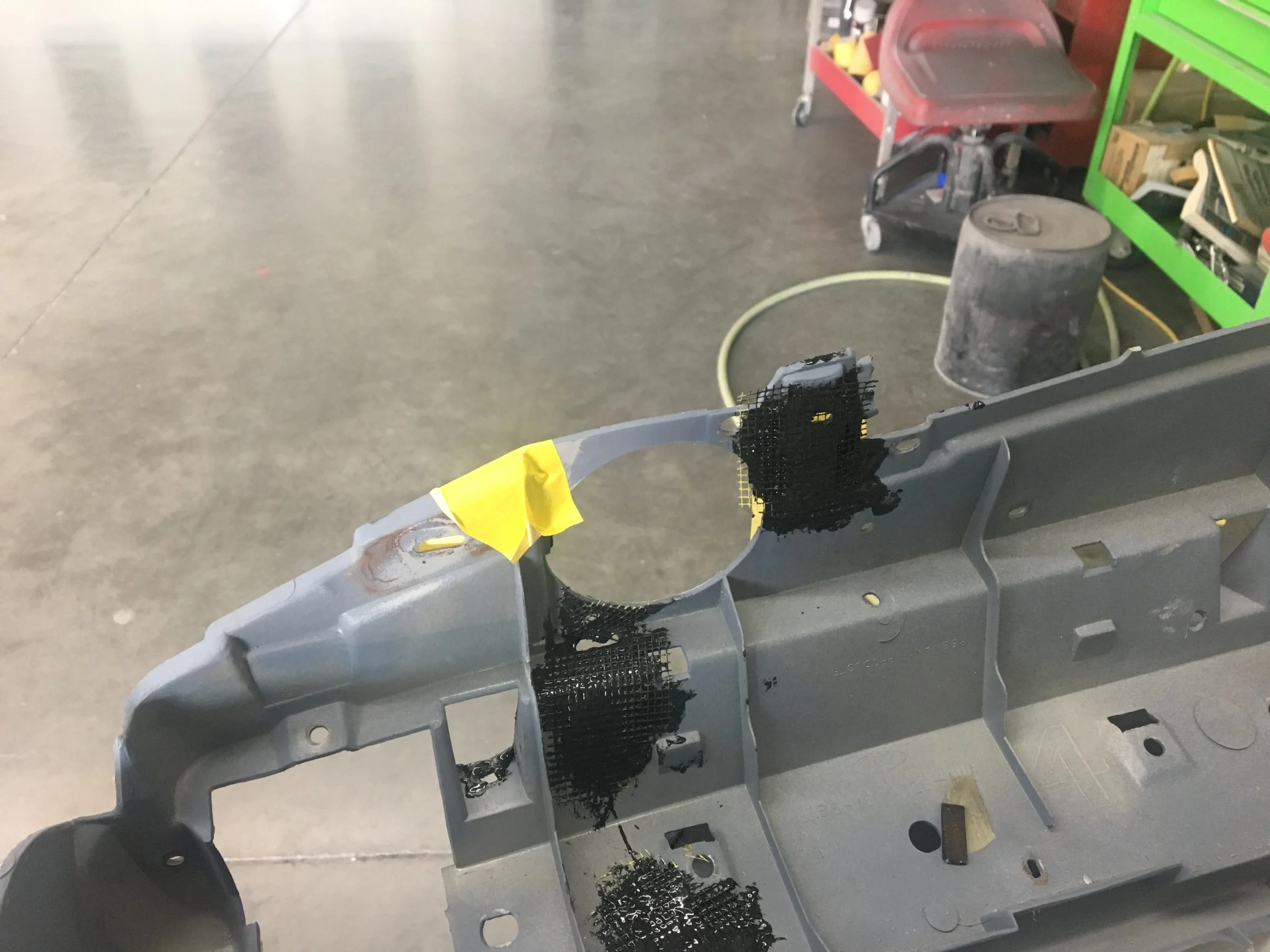

I sanded the backside with 36 grit and did some deeper cuts criss crossing the cracks with the dye grinder. I used my dry wall mesh, sprayed some adhesion promoter and went to town.
That's it for now.

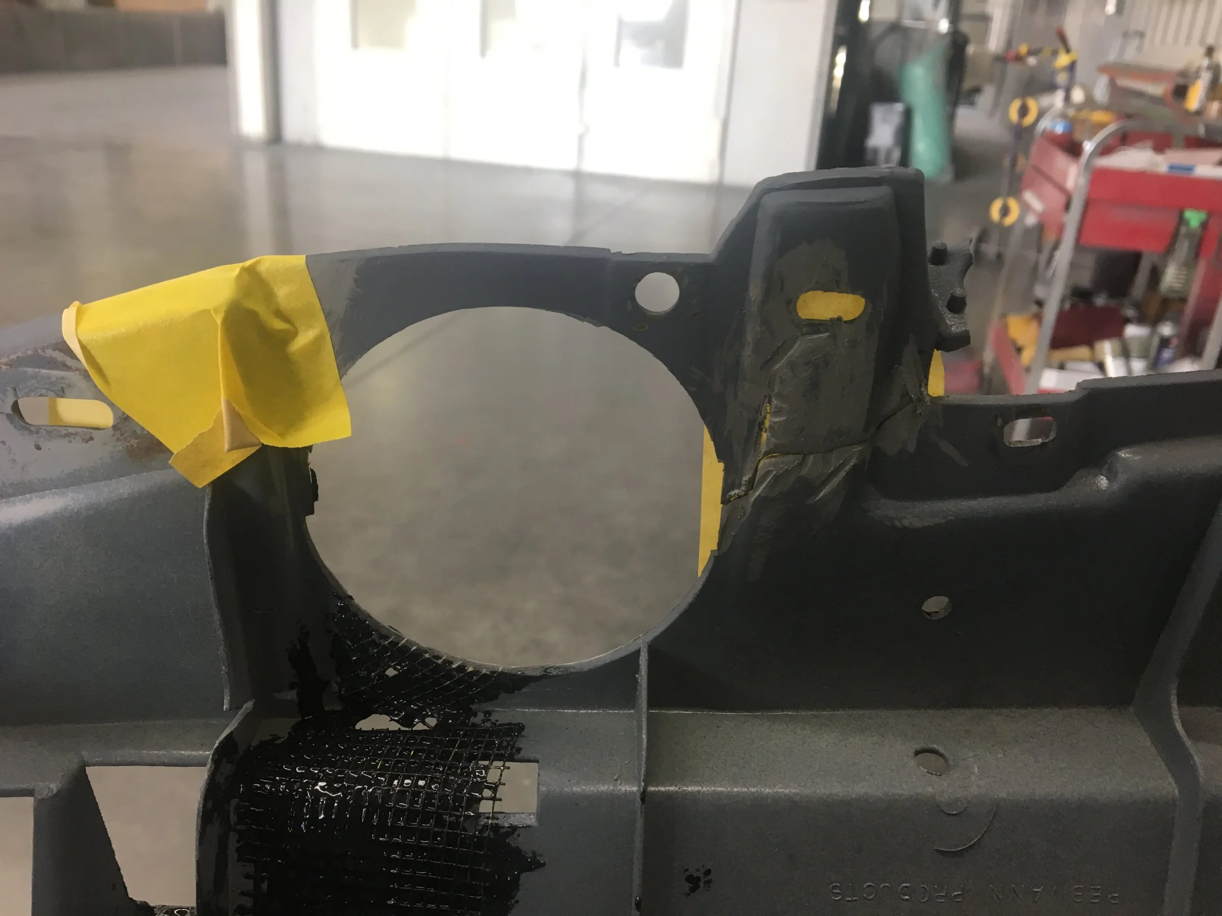

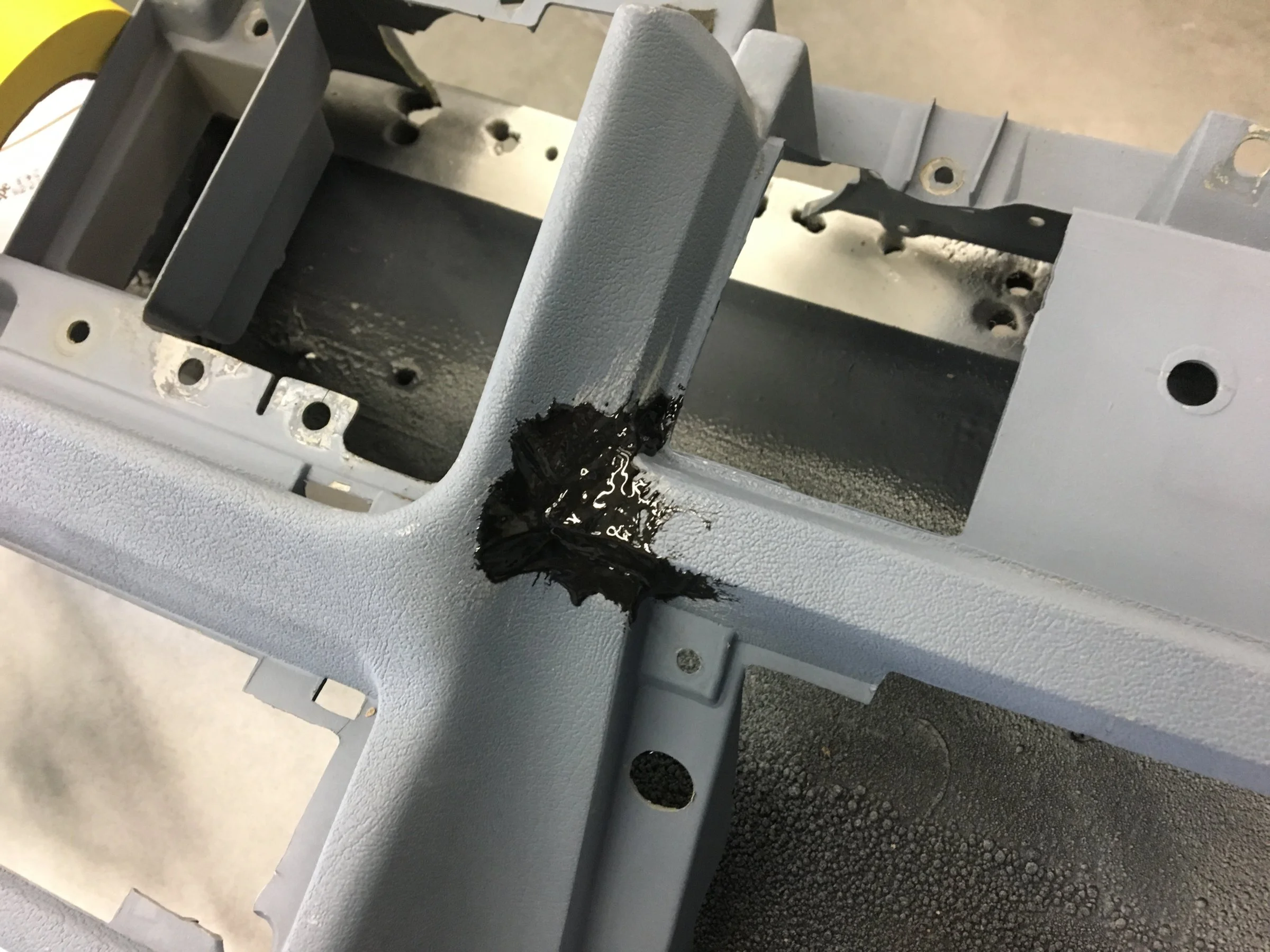

I had a little extra free time and fixed one side of the crack underneath the stereo opening and began the reconnection of the piece that surrounds the right speaker.
As you can see, I only got one side of one side glued. This stuff takes time. It'll take at least two more days to finish reattaching that piece. Then I have the long piece that goes along the windshield area to reattach, and it's two pieces.
