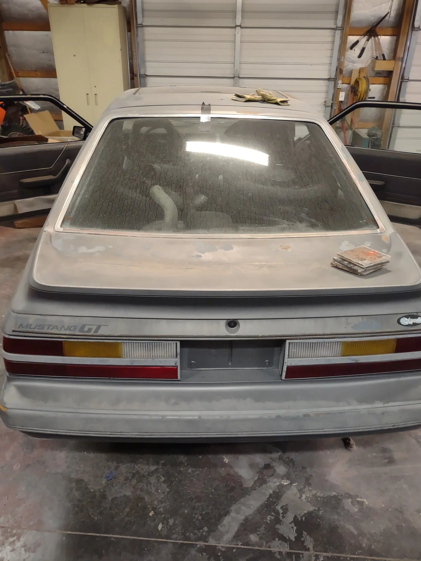

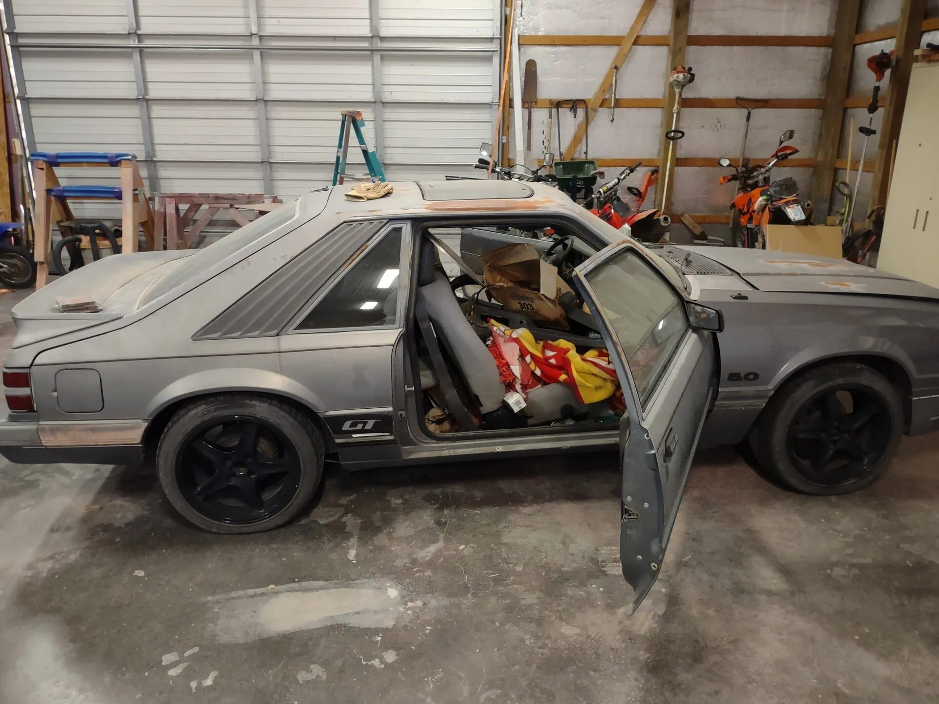

Lifelong Chevy/Dodge guy. NEVER dreamed I would have a Ford anything. But my 16 year old had to have this 85 Mustang. it is an incredibly rust free, arizona car. Anyway he and I just finished a total redo on my 85 Ramcharger and well... Your kids come before your dislike for a Ford so here I am building a Mustang with my 16 year old. We have a HUGE pack-rat problem, he has chewed every single wire in the car. NOT SOME!! EVERY WIRE!! So here are my first questions and my thank you for having a Dodge guy on your Ford Forum, lets see if I become a Ford guy.:rolleyes:
I have searched and cannot find a complete wiring harness for an 85 GT mustang, is this available? We will be putting in a Blueprint 307 Carb engine with the T5
Does anyone produce a new dash for these cars? not the pad, the actual dash? (hate pack rats!)
is a 5 lug conversion worth the hassle (after bringing hp up to around 360)? This 85 seems to be the hard one to do this to compared to other years, just want to make sure the juice is worth the squeeze...

It is carbed. And as far as future rats... well it probably won't sit still long enough to get another problem. This car had been sitting in a covered car port that joined a corn field for 7 years. We just bought it and started tearing it apart. Now it is in my shop with AMPLE rodent death warrants around! We have vacuumed over 100 lbs of corn out of the car since we got it home. It is literally unbelievable how much corn and we are not done. Everytime any part comes off, more corn. Truly a miracle. If humans worked as hard as this pack-rat the world would be a different place :) and I had never seen the rodent tape before! That may be handy for my dump truck. The rats like to chew the two stage axle wires this may help! Where there is farming, there is pack rats they love wires. This rat chewed the big plastic connectors up he didn't however enjoy fuel line, but took a nibble. We are just taking it down to steel gonna media blast and build back. No connector or wire can be trusted at this point.
