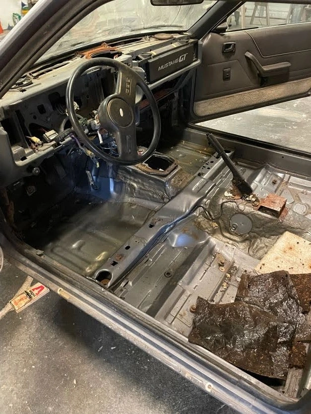

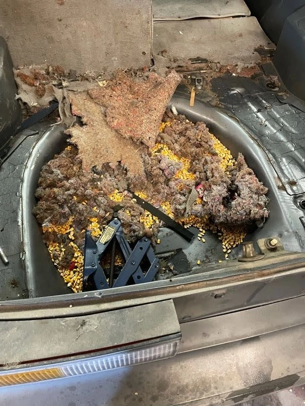

Ok the people on here are quickly making me like the Ford folks. My Dodge forum guys are such smart asses they are hard to get the information you need, cause nobody makes dodge parts and you have to be part horder to build one. I really appreciate this forum. I am going to a guys house tomorrow to get every stinking wire out of an 83 and spindles from a 94 which my son says we need to do the 5 lug conversion, and I believe a dash as well, we will see what else we find. The boys is already spending the savings on his wishlist on LMR. Gotta love it. I think I will start a build page and tell the whole story, its a good one. Oh and the packrat and his trail are long gone from the car, just his damage remains... well and the occasional corn stash. Thanks again guys!

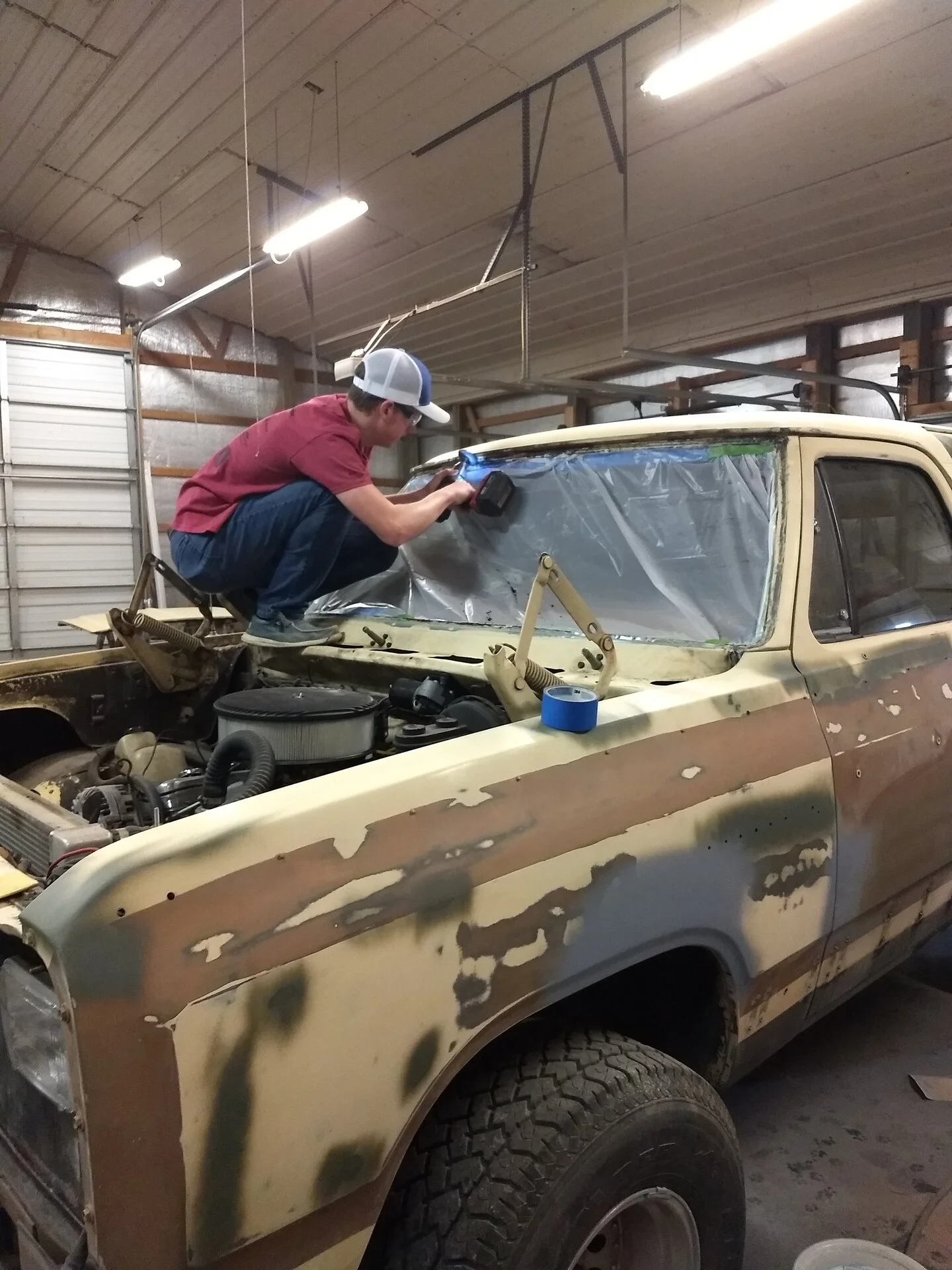

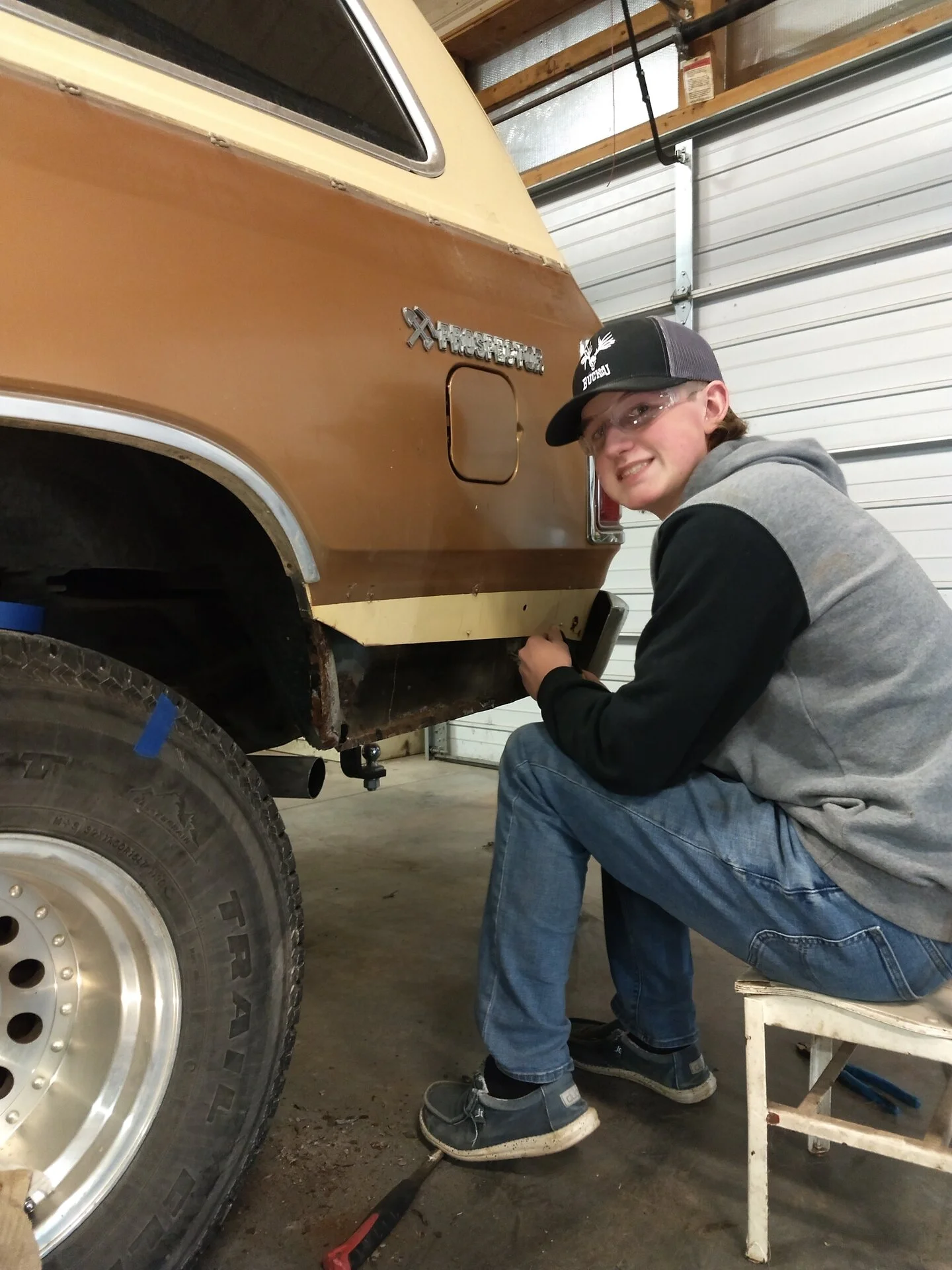

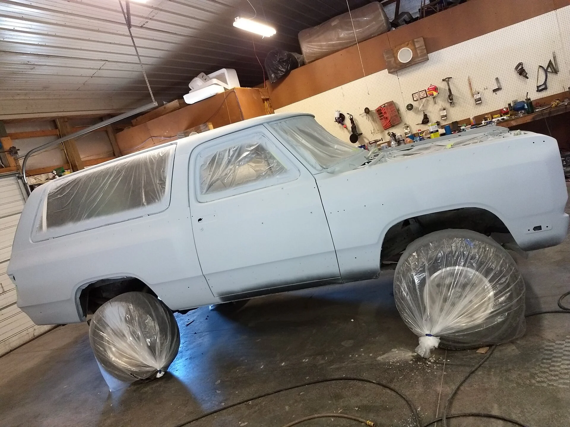

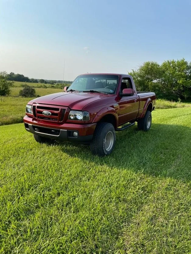

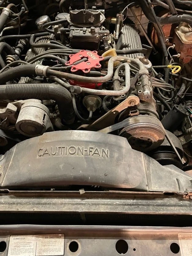

Gonna try to turn this into my build forum. My son is very mature and intelligent for his age, though he can be a knuckleheaded teenager on demand! This all started out with him getting rear-ended and totaling the "first vehicle" we had bought for the kids to drive (2001 Chevy short bed step side 4X4). So we then bought Ranger Rick which was my first Ford. He promptly wrecked it being a teenager at our local reservoir. I then explained how he needed to get a job and fix the truck himself. "You have the Google" I believe I said. Well, he did exactly that. Sourced parts, ordered them, and paid for them. Then he disassembled the truck and we painted the parts and he re-assembled the truck. BUT I was scared of the airbag install for a 15-year-old, so I paid the local body shop to install that for us. To which they saw his work and gave him a job at the shop, where he worked last year. In this process, he incessantly badgered me to get rid of the Ranger and buy him a Mustang that was sitting at my sister's house that belonged to one of her stepsons. This is where it gets interesting. I knew I did not want another Ford, so I threw out that I would buy an old car to restore if it was interesting. I knew there was no way in hell he could find a Ramcharger that wasn't a pile of rust. Well in a couple of days he did exactly that. So we went to check it out, and I bought it. We then set out to restore the thing together, and well we did that in just under a year altogether. But he never stopped with the mustang despite me teasing him about it... Brutally teasing him! What he didn't know is that his mother and I watched him work every single day at the body shop and not complain too much so we decided to reward the hard work, secretly. Momma was thinking she liked the way the Ramcharger was turning out (for herself to drive), and well I called the mustang owner and bought the car for $2,500. But Eli did not know this! Every time he went to my sister's house he would go out and take two laps around the mustang and dream as I rolled my eyes. Well as fate would have it, literally the same day I bought the mustang as a surprise, he wrecked that damn Ranger again. See the result above. So he had to save up buy parts and redo everything (except the airbag) and he did, but this took several months. So we had to sit on the surprise during this time until the Ranger was fixed and we promptly sold that thing! It looked great as you see in the picture below but was just bad luck.

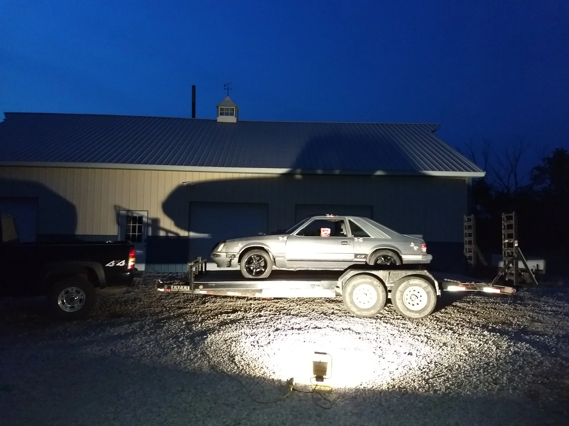

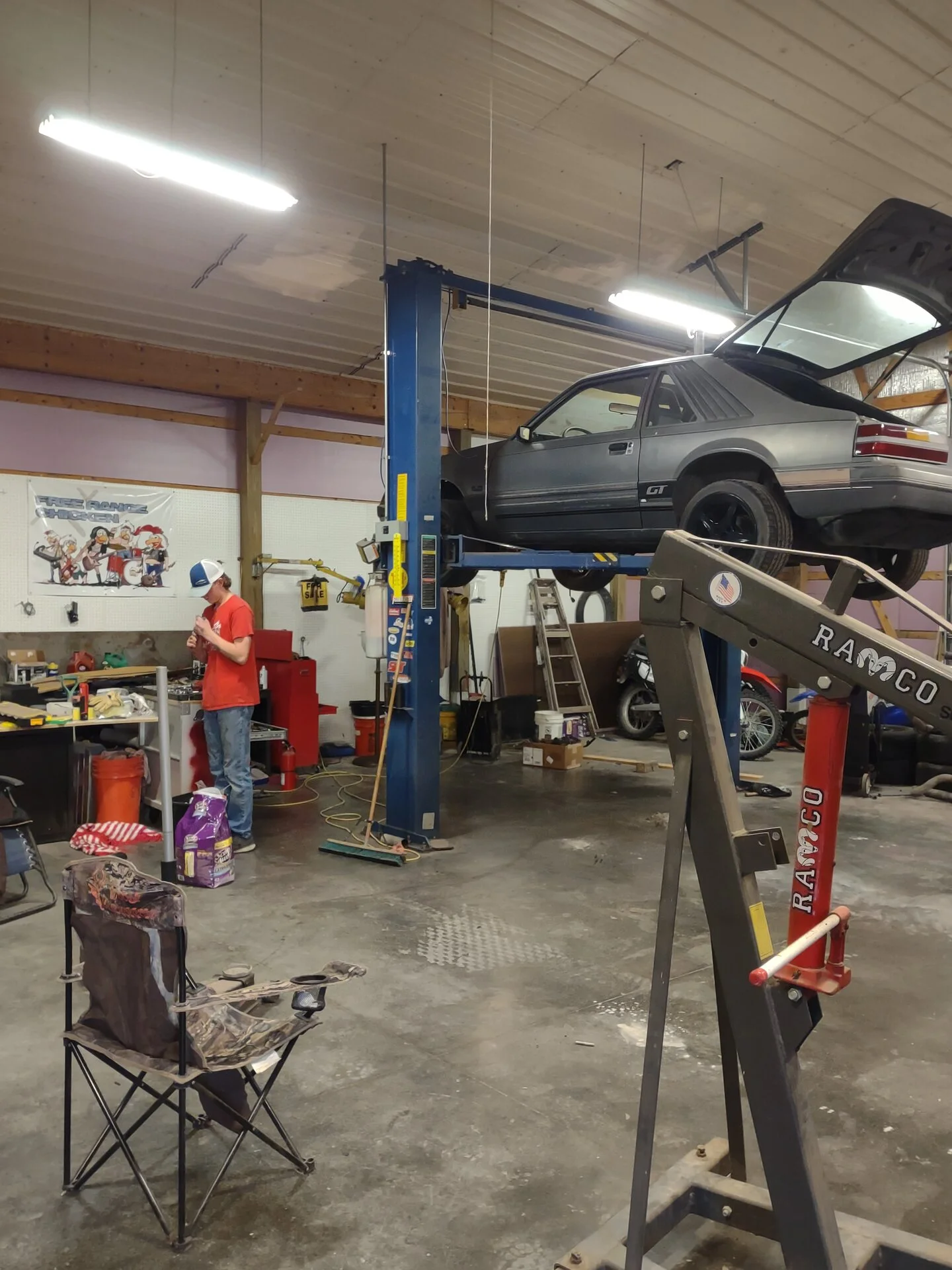

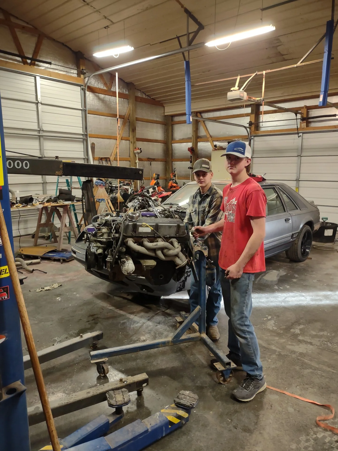

So now the fun part, time to give him the car. It is demolition derby night right next to my sister's house (fairgrounds) and Eli and his gearhead buddies were headed to the derby, so I took the morning off, hauled ass over there and loaded up the mustang and pulled it back home and hid it at my office warehouse. While he and his buddies went to the derby that evening we pulled it out by the barn and put it under a spotlight for when they got home. My sister knew he was coming and that he was going to show it to one of his buddies who may want to buy it since he knew I wouldn't let him have it. Well, when they got there my sister and her husband laid it on thick that they had sold it and he should have bought it blah blah, and he got pretty upset about it and was a little poopy pants. Until he got home that night and in front of all his buddies there it was under the spotlight waiting for him, with a card that said: "We love you anyway". Needless to say, he was pretty stoked, called Sis and apologized. So that brings us to about a month ago when we pulled it in the barn and he tore it apart, packrat issues and all. Now we are learning what all has to be done to it and sourcing parts and gonna get after this thing. We have placed the order for the Blueprint engine (see ya in 5 months) sourced a wiring harness, dash, and some other stuff. Thanks for sharing our story. I try to keep the kids busy while learning something valuable helps keep em out of trouble, mostly. For me, the best part is the Ford Chevy fight. My Dad was a Ford guy, which meant I had to be a Chevy guy. Keeps it fun. Thanks for tolerating me, I do love cars but the cars wouldn't be any fun if it wasn't for the people you get to share them with along the way.

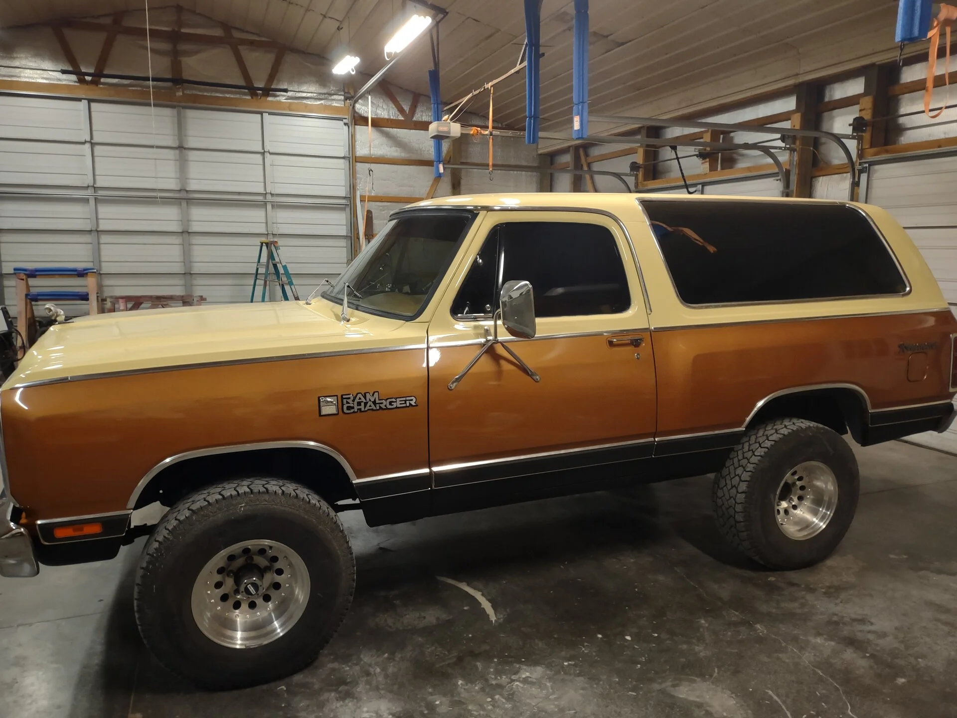

Eli better be careful with that posi rear end. When I got mine a couple times I spun it around on a main road. So glad I didn;t hit anything, and I would never do that anymore. I don't know dad. Eli better not crash another because he's going to have a hard time getting another.
Reactions: LAFF
Very nice Ramcharger. I have a friend restoring one as we speak.

So the engine we pulled out of the 85. Stock 5.0 engine turns free, i bet the thing would run with a fuel system clean out. But we bought a full dressed crate engine for the 50K mile warranty. That said, what is this thing worth? Blueprint engines told me they are getting scarce but also said they would not buy/take it because they are casting their own blocks now... Anyway looking for opinions of a fair price.

I've sold those valve covers alone for $150-200 all sandblasted and cleaned up. What parts of the engine are you keeping?
It probably would run fine if you messed with it a bit, but as a non-running core engine, it won't be much. Maybe $400-500ish and you might struggle to get that since it's an earlier non-EFI engine. Parted out, it would likely fetch you more, but it will involve time and you'll still be stuck with parts you can't sell, like the E5TE heads that are likely on there. You can probably get $100-200 for the short block. The accessory brackets have value. The intake manifold and carb (if original) have value.
I need to keep the accessories/brackets off the front except the water pump. I ordered the below engine.
