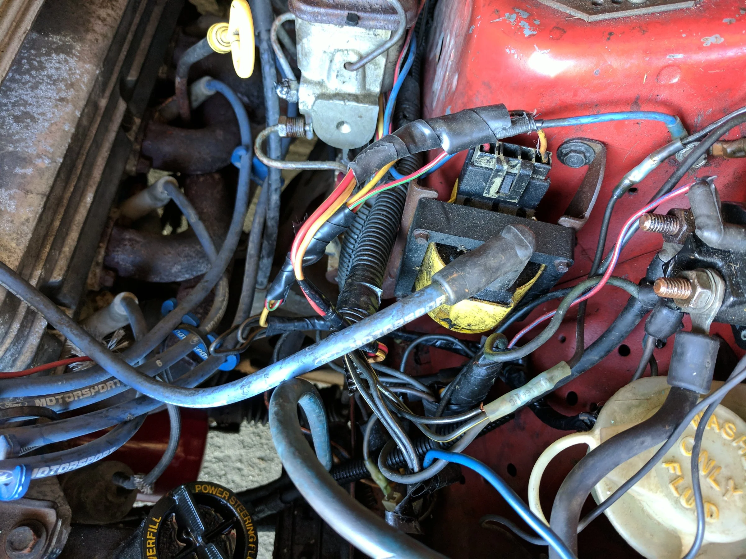

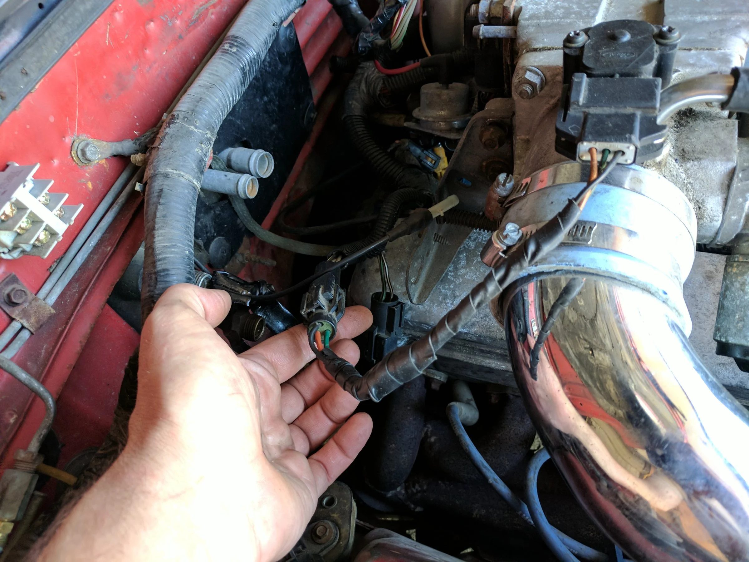

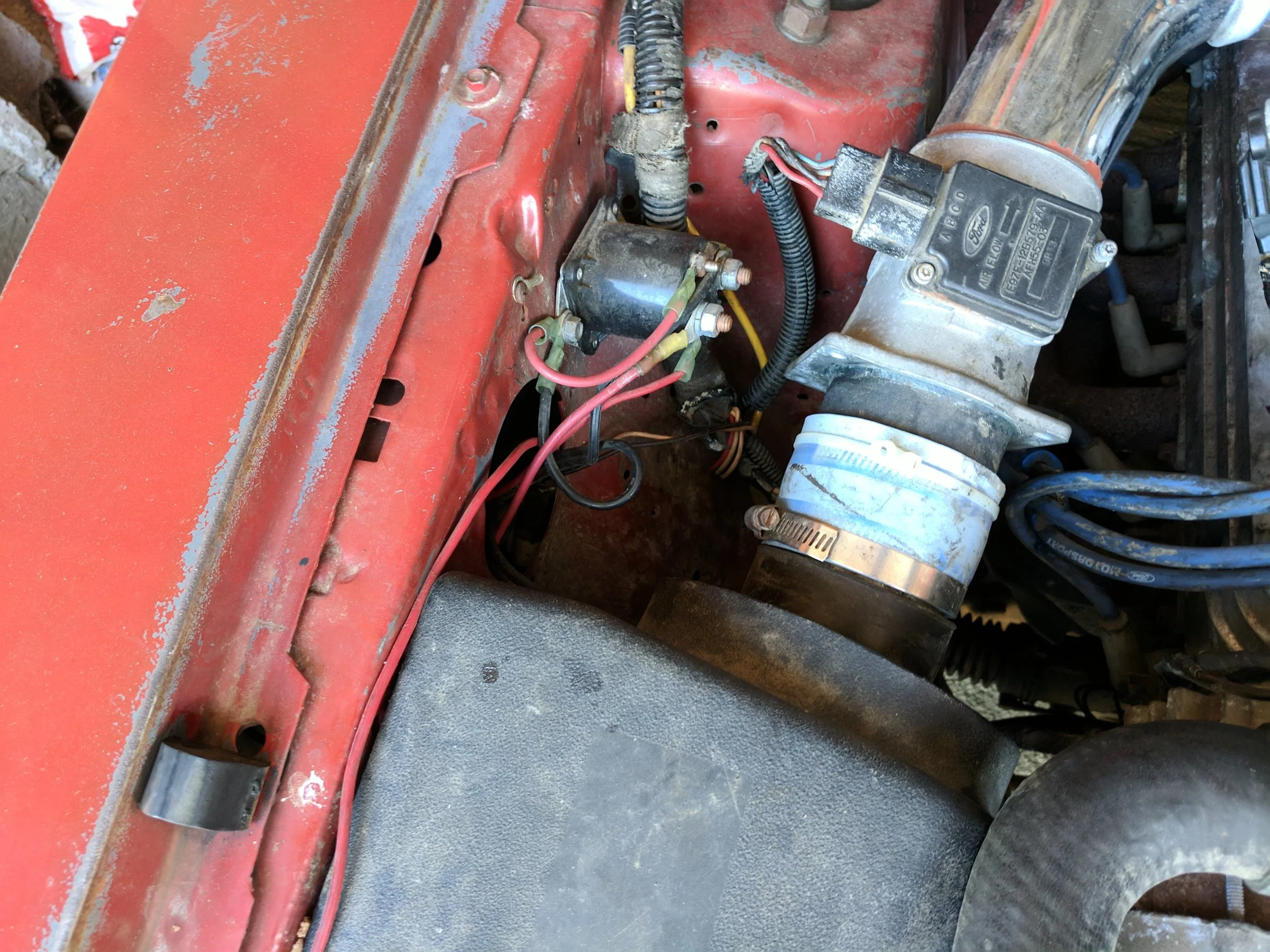

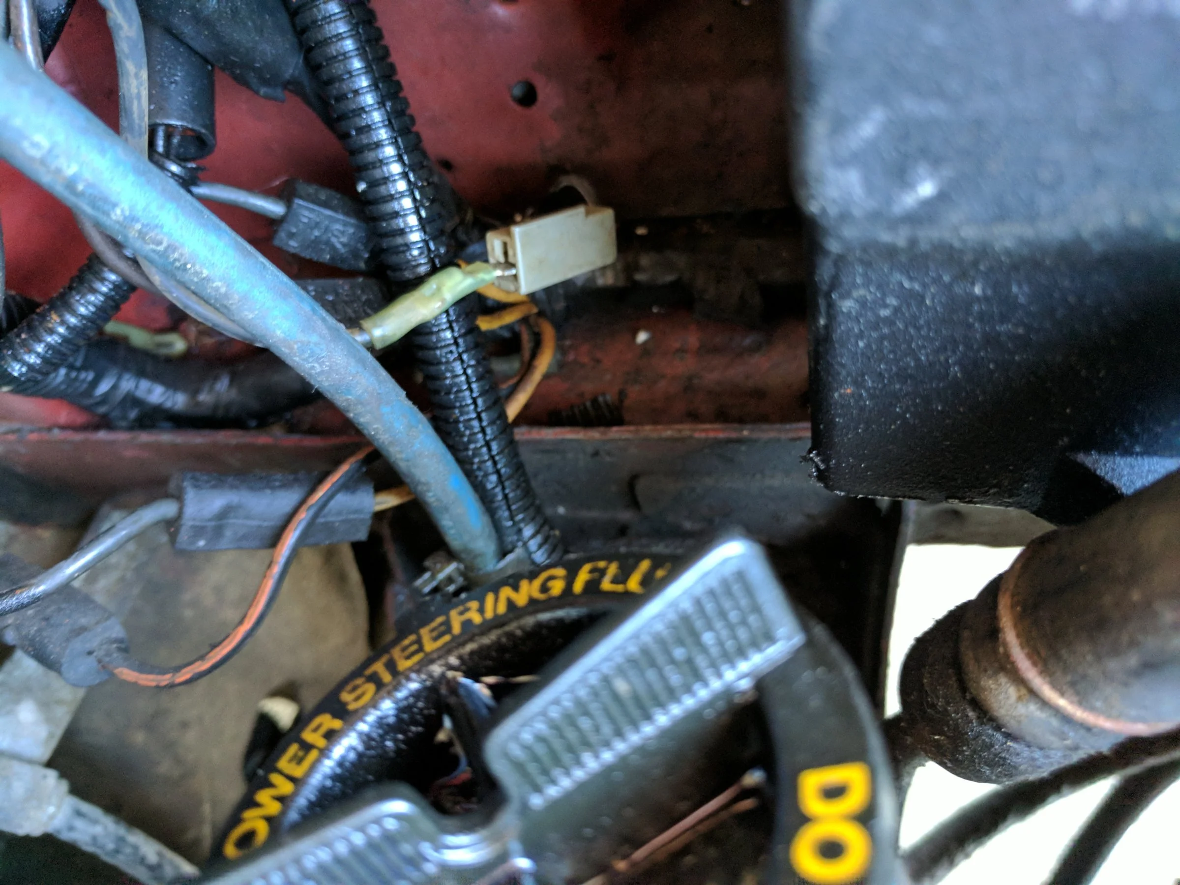

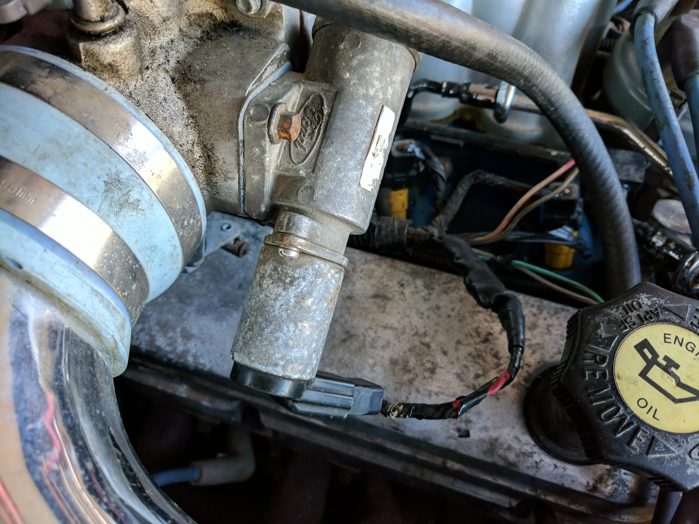

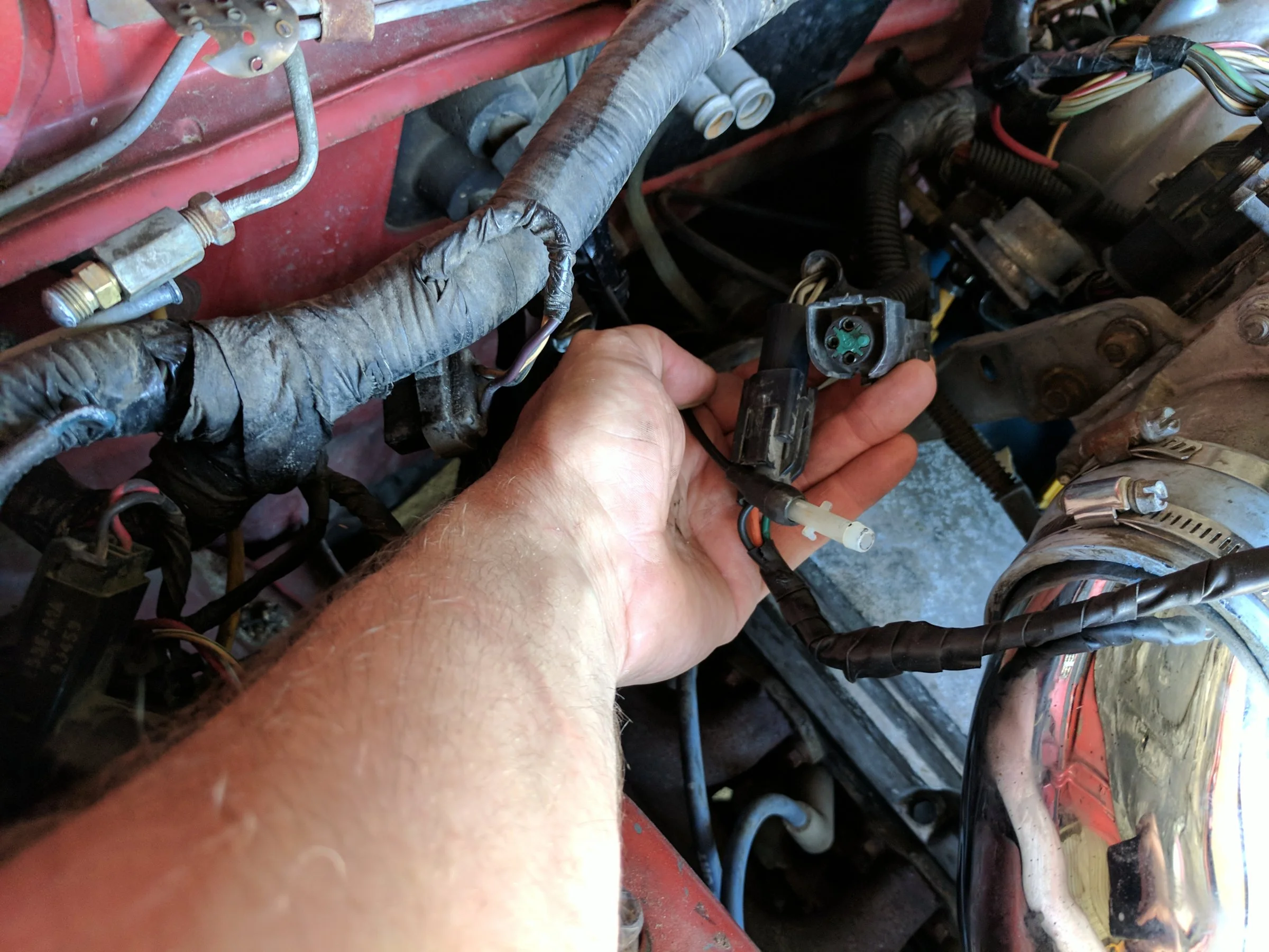

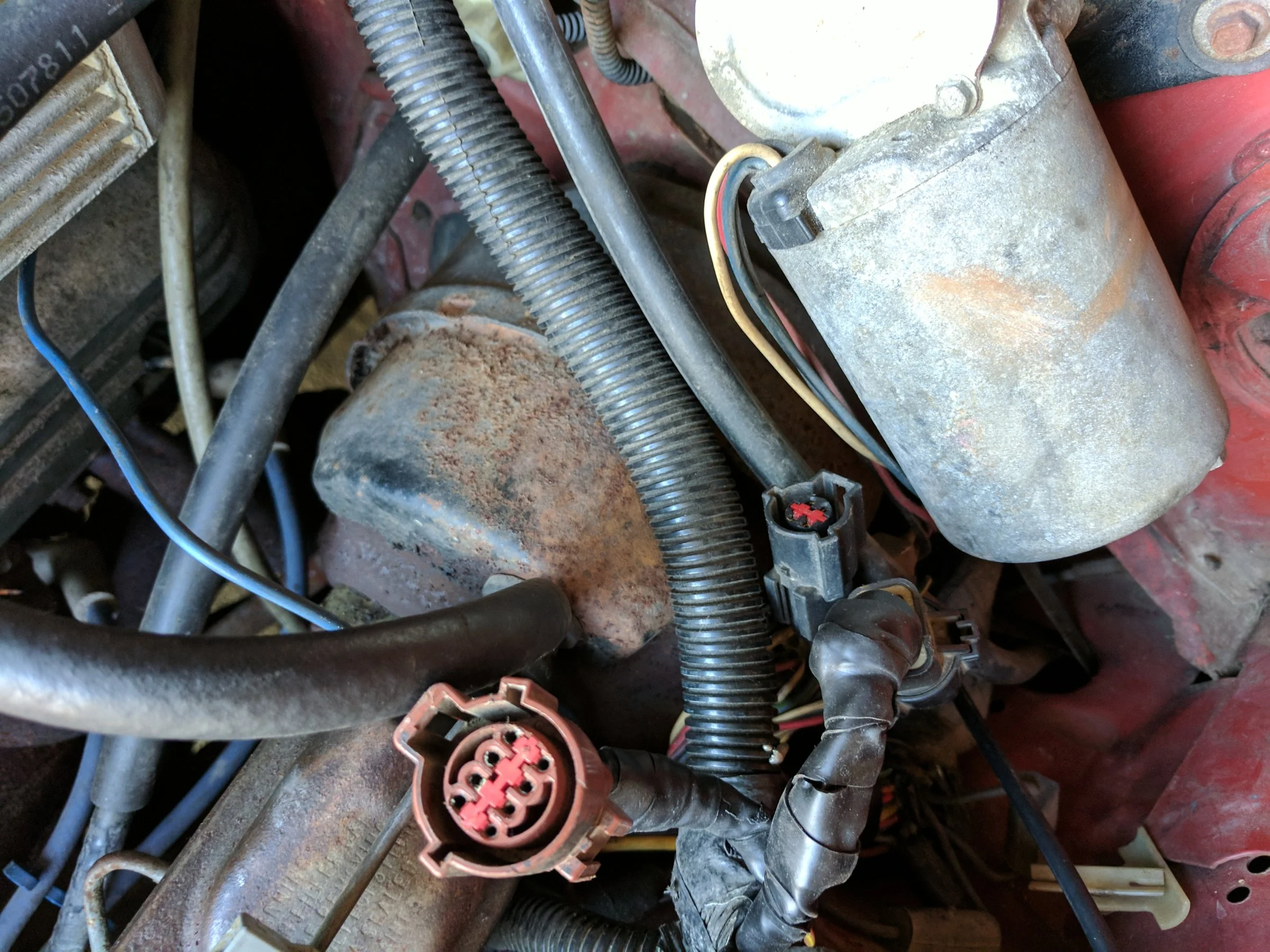

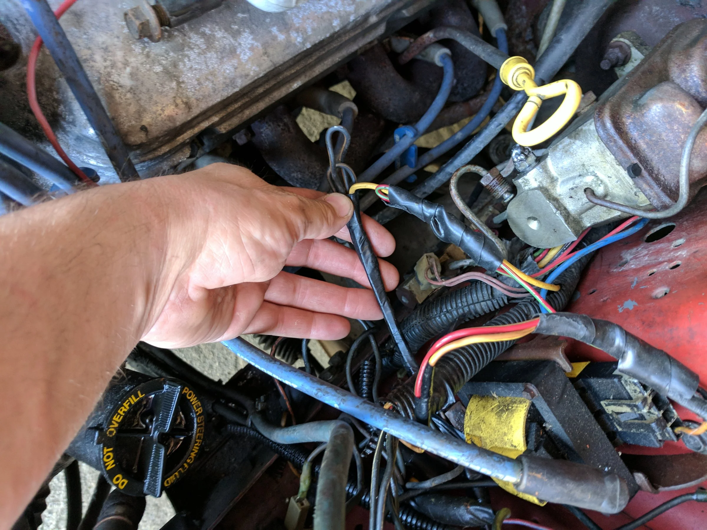

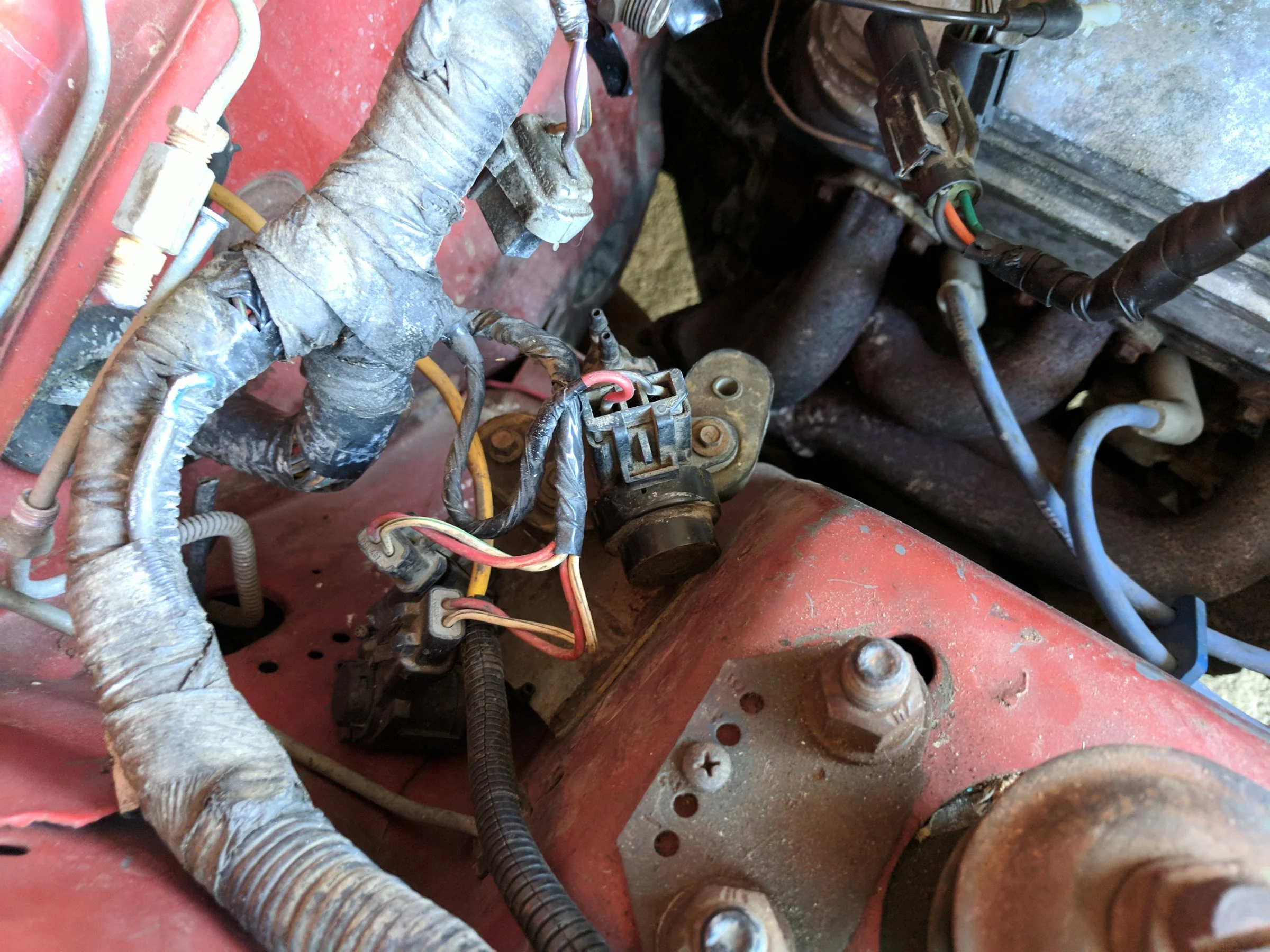

Here are some better pictures of the various splices and disconnected fittings. It looks as though the mass air has been wired in. And I'm wondering if the PO had wired everything to work with the old computer. I seem to remember reading how it could be done when researching the mass air conversion on my bronco?

You can't run a MAF with a speed density ECU. It's one or the other. You need an A9L.
The issue here is determining if the Originsl owner changed the wirinhbsround or just pinned in the 4 wires only for the MAF.
87 and 82 are codes relating to fuel pump relay fAilure...however you say the pump runs?
Code 31 is EGR
Code 54 is air charge temp sensor out of range. I don't even see it mounted in the lower intake. Possible nothing is even plugged in here
Code 31 is EGR

There looks to be the intake manifold air sensor lying on the intake plenum , plugged in but not installed anywhere.
Will a MAF ECU plug into the existing harness? Will it all need changed, or just check the splices they made and be sure they're correct and go?
You may need a wiring diagram to help you out, you need to get the wiring sorted out.

By the way....the air temp sensor dies not have to go in the intake. Some explorer intakes are not drilled for them. You can put it in the intake pipe going to the throttle body. You'd have to seal it in with jb welds or epoxy. The wires and connector will route over there without cutting but you will have to unwrap them. That could be why it idles high and stumbles.

The dreaded throadel body whistle!
You can try to knock the sharp edges around the iac opening down a little but you likely will have to live with it, I have for years. Mine is a cheap edelbrock/bbk, what do you have?

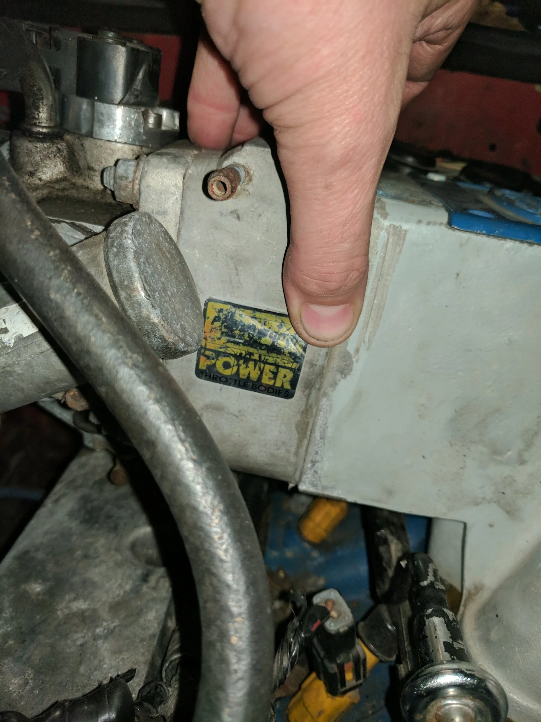

Picture of the throttle body, stickers about gone but maybe you guys recognize it.

The object you have your fingers on is not the tb, thats an egr spacer, dosen't matter anyway. You need to get the wiring sorted otherwise your chasing your tail.
