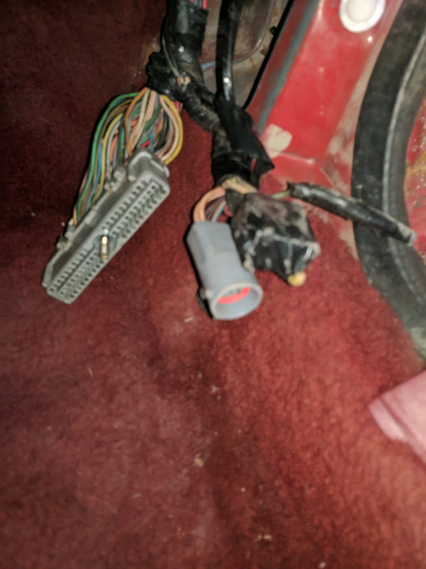

I ordered a A9l computer. Looking at the harness, it doesn't look like the MAF has been spliced, is it possible that either the explorer or later model mustang harness was used? Is there a good way to ID it. Seems like maybe he ran out of time or money to finish the conversion? Or fried the maf computer and swapped the vm1 back in to get it to run?
your gonna have to try to match up some wire colors for your car to the colors that are supposed to be there, try veryuseful.com for some wire diagrams, see if the colors on the computer connection is the same and in the same pin locations. that's the best suggestion I have.

Best way to make sure things are pinned right is to unhook the battery and ecu then check continuity on the wires.
check the wiring to the ecu pins using a multimeter a length of wire soldered to a safety pin makes it easy to probe wires.

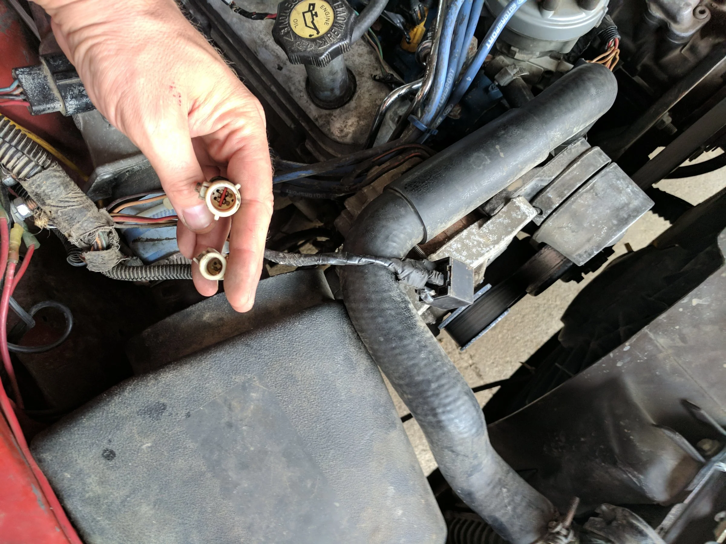

I got the A9l today, getting ready to start installing it, and I keep finding open connectors. These 2 and a home made relay, up front on the pass side out of the same trunk line the MAF is in.

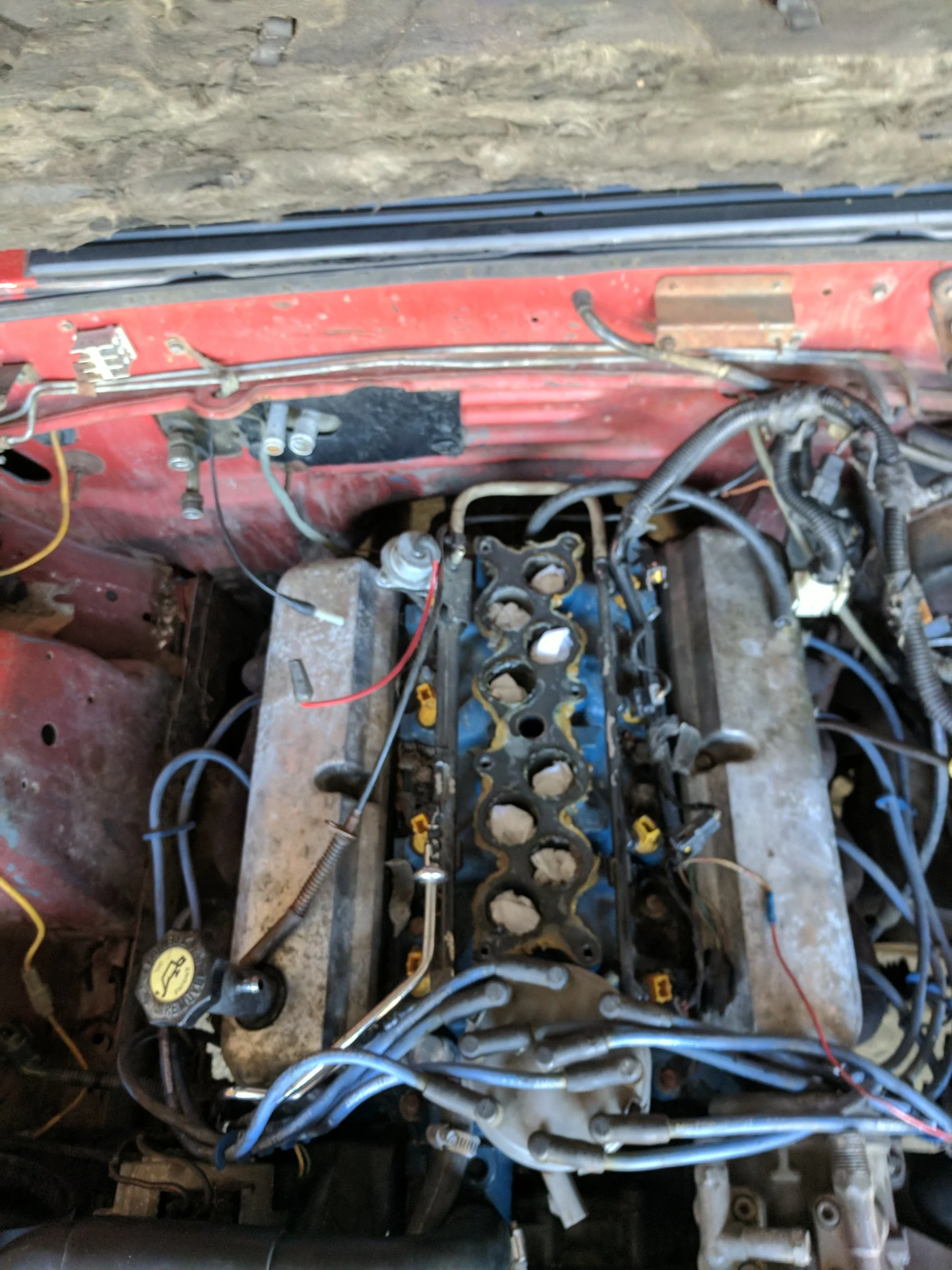

I'm finding all kinds of changes, in the pic above the red wire on the plug has been cut and spliced into whatever that block is and runs to, under the hood I found by the test port, the green /yellow cut and spliced into what looks like brown. Some sort of old school computer bypass?

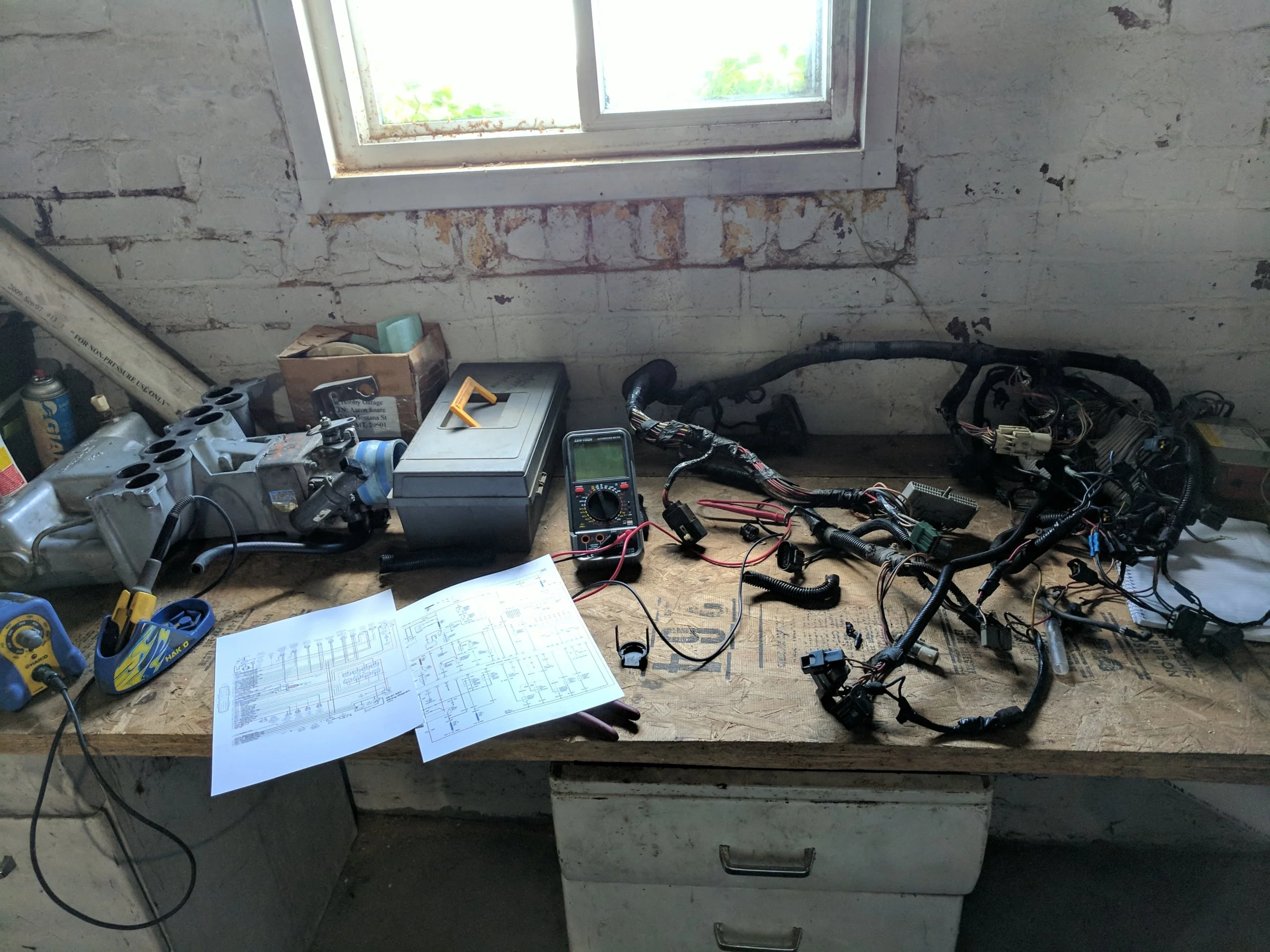

I'm going to look up and print off an 86 harness, because nothing looks to be where it should be like the 89+ harness that i hoped had been swapped in. If I find the right schematic I think my best option is to pull it all, rebuild it to stock then make the MAF mods instead of hoping it's right and frying the A9l I just got.
Started to do repair work. Looks like it's mostly the 86 harness, but the injection harness looks like it's from an 89 or later based on the only factory date codes I could find.
Pulled the intake to clean up the vacuum and make harness removal easier. DO NOT USE BATHROOM SILICONE.
Cleaned all the crap off the intake was fun, 99% sure there was a vacuum leak at that gasket.

So.... This is what I've found out. I have a complete 92-3 harness from the computer to the fuel injection. I've gone through it all and fixed nearly all the crap splices and junk solder, with good soldering and shrink tube.

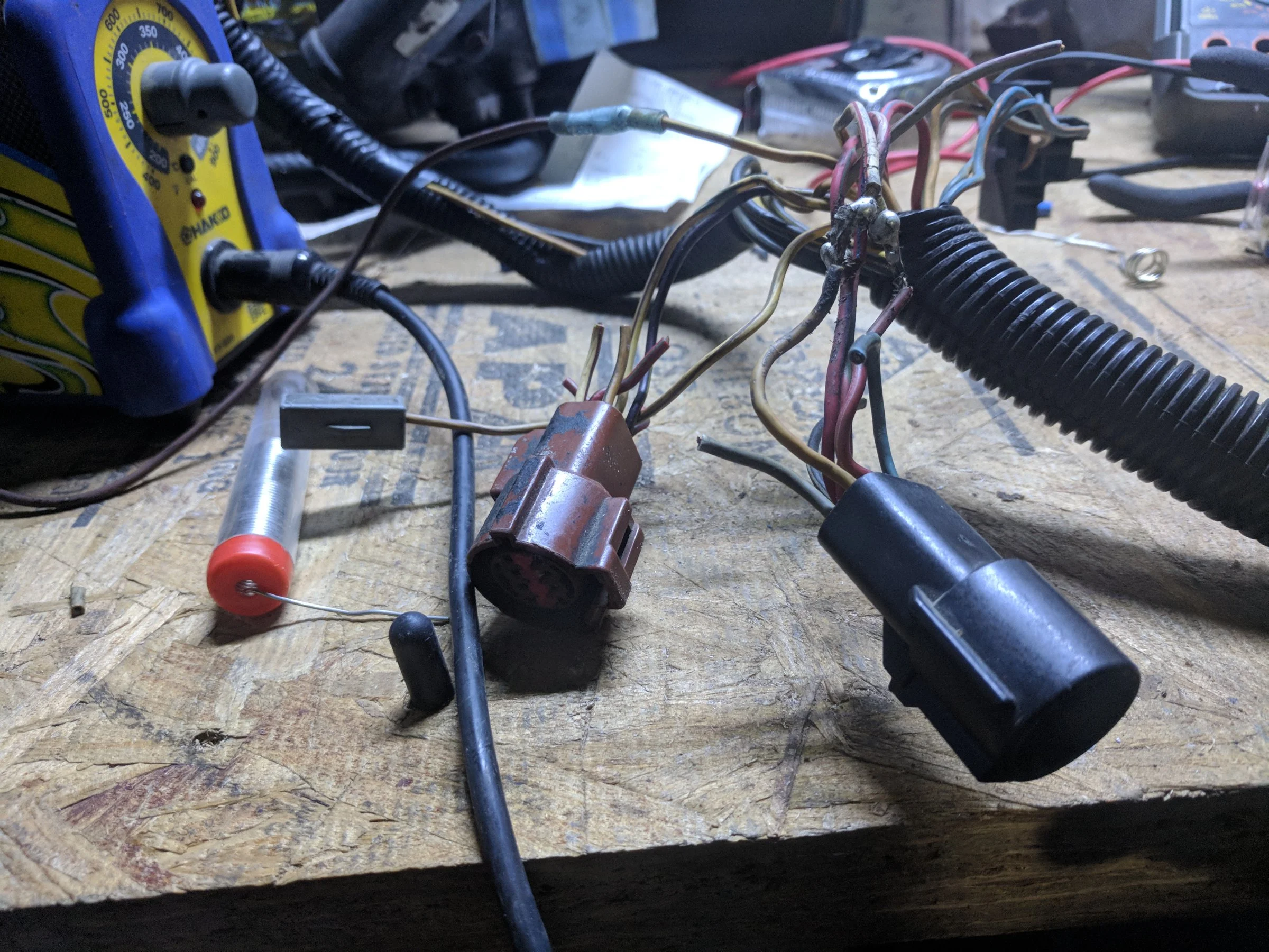

I'm down to the 8 pin connector on the drivers side fender and the rest of the harness on that tail. At the 8 pin, the MAF had a red female connector, and the SD harness has a black male connector. It looks as though the PO had spliced a hand full of the wires over to the old style connector, but left some cut and wrapped, and others still connected to the MAF red connector. I'd like to correctly graft the 2 to clean it all up and function properly.
Not my soldering btw. Lol
