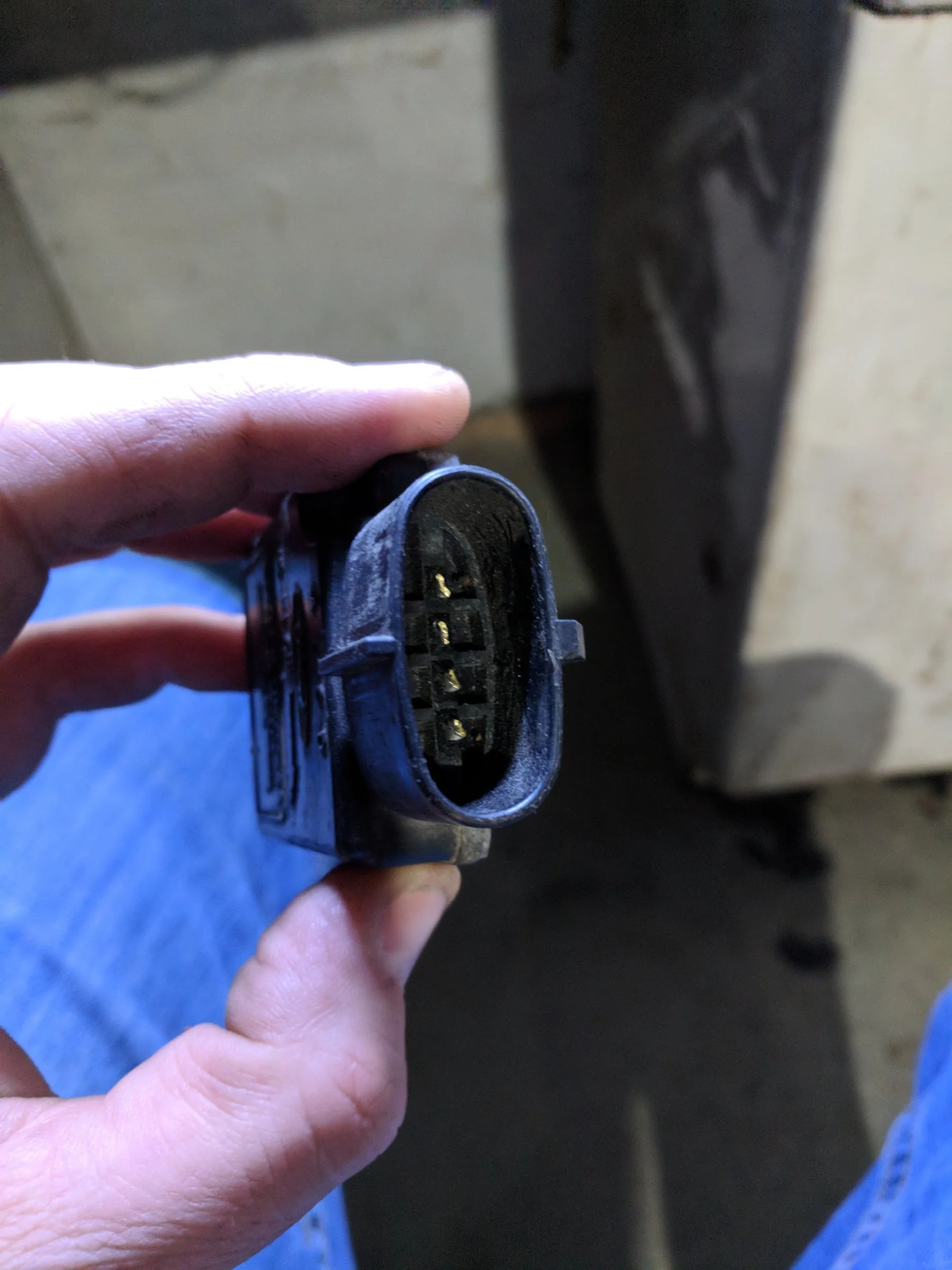

If it isn't one thing it's another..... Got everything hooked back up, and all the tabs inside the MAF have been removed... WTF!!

WTF?

Mustang5L5 said:
WTF?
Right!!

So much win.

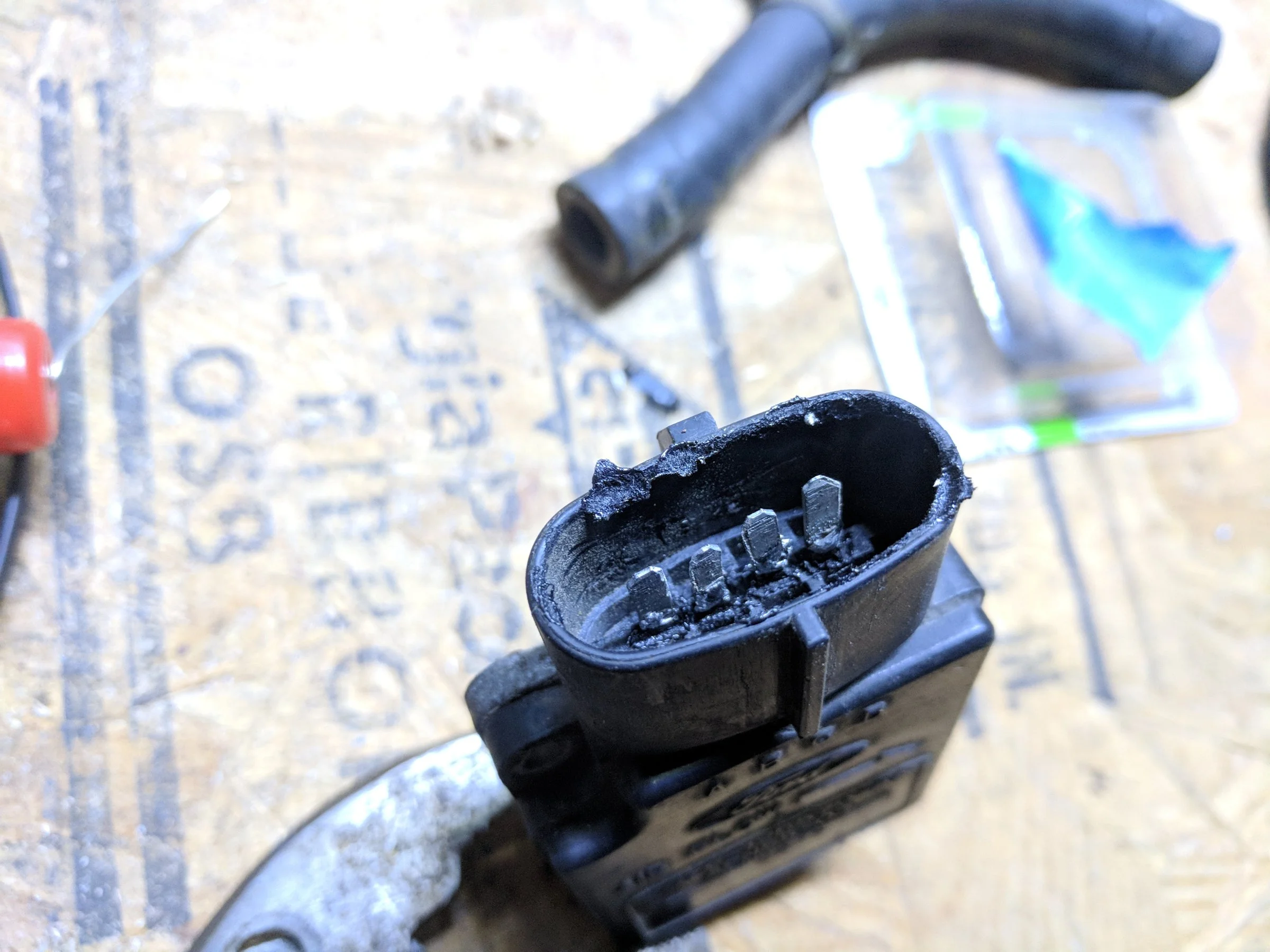

I made new tangs out of old blown fuses, and soldered them on to the nubs, maybe this will work.

Thats some shade tree sht there.

Why would someone do that ? Smh

I can't figure it out, can't think of any good reason

wow never seen that before
