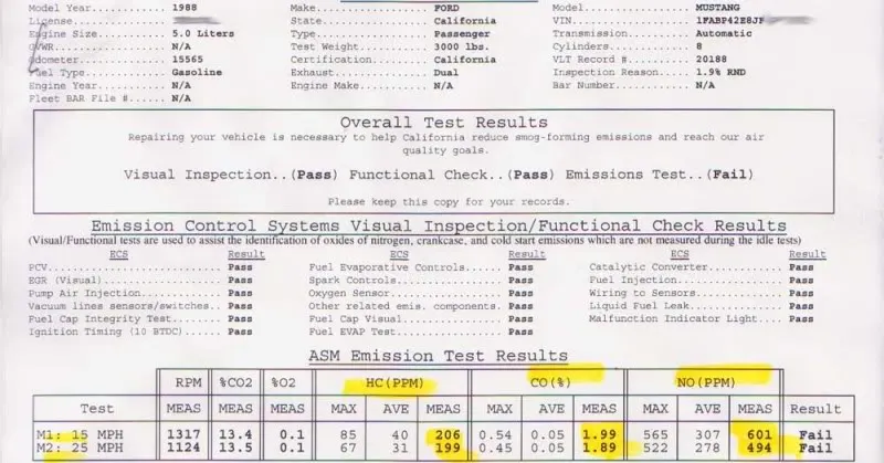

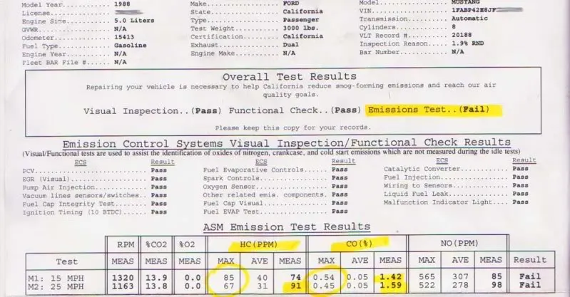

Chasis: 88 California Mustang w/MAF
Engine: 302 .040+ Stock Comp Pistons Roller Rocker Conv
ALL SMOG EQUIPMENT Attached. Stock Exhaust W/ 4 Ford Cats

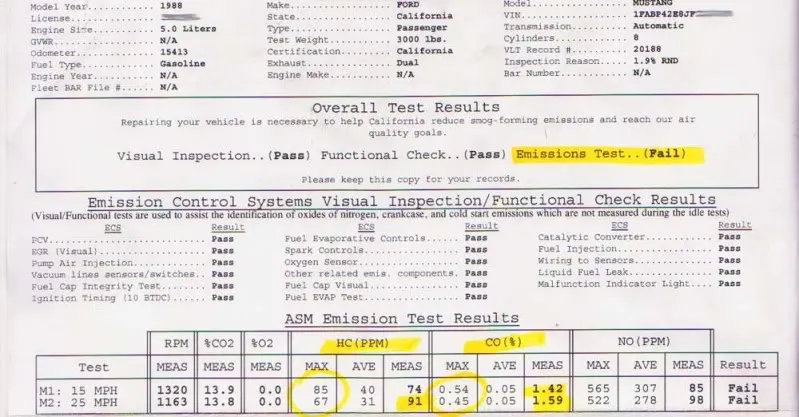

I am failing smog miserably - -
I failed smog the first time with high CO and HC on both speeds.
Took her home after reading on here about Vac lines, smog equip, & seeing the post that seems to deal with all things emissions(egr/rough idle/rich/lean/IAVC) I realized one of the vacuum lines running to the tree under the upper intake was rotted away. Everything ran correctly, and voltages check out, and i have searched this forum and seen only info on smog delete or "what if..." scenarios. So this engine is for the better part stock and just is failing like a mother(see first pic for numbers)
Fixed that, ran the OBD tester came back flying colors (all green dots and an 11 code on both KOEO/KOER) No codes and I do have a functional CEL light because it's an Original CA edition.
The salt and peppers have been cleaned and all the pins were/are straight.

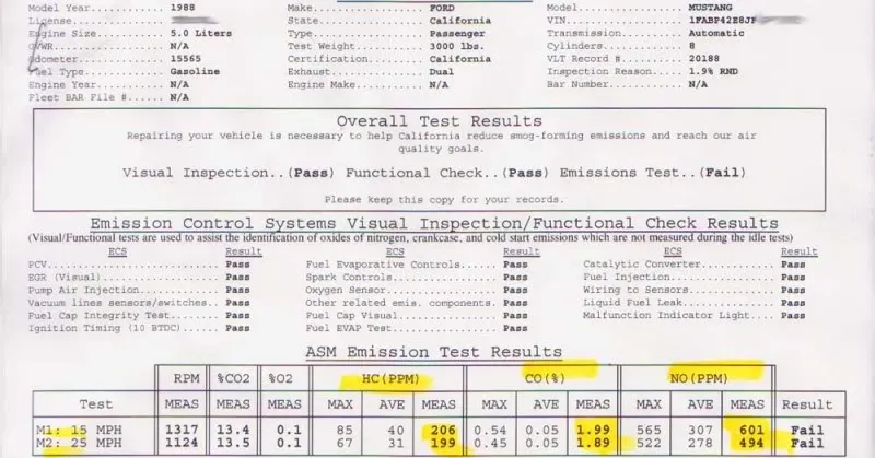

I took it back and failed even worse! Almost 800% increase of NO and about another 100points on the HC(PPM) over it's original. So now i'm failing all categories and the references in the almighty smog post says bad cats, bad smog eqp. etc)
Driving me nuts!!!
Emotionally and Financially exhausted(pun intended) with this car.
The engine being rebuilt about 1 year ago has about 8k new miles on her.....when i first took it in it passed - -barely.
I keep everything clean and i have gapped my plugs to spec, timing is at 10 with the harness equipped(the thing that advances/retards timing under load) Also the EGR has been replaced, fuel pressure is right on(stock injectors) I am stumped and i don't want to take to a specialist because i have a feeling they'll charge me out the ass just to tell me what the gen. consensus is on this page...bad cats, bad smog parts.
Anybody offer some help why everything F****n skyrocketed into failure.

Was she warmed up real well for the second test. A cool car will sometimes report high. What you changed should not have had a negative effect, There is a possibility that you created another problem by fixing the first. Could you have pulled off or caused a crack in another vaccume line or have one or more loose plug wires. Did you recheck everything again. Some people recommend changing the oil before the test and adding a can of guranteed to pass stuff to the tank.
Did you take it to the same place?
Yeah she was up to op temp for the second test. I think you maybe right with, "fixing one, creates another" idea. I checked the map pressure was good, cleaned the MAF, checked for pinches(nada) It's actually at a test and repair place off the smogcheck.ca.gov website near my zip. 60$ for the full diagnosis(at least the stuff i can't do at home) and then they are due to call me soon for the "suggestions" then i take it back and try and fix what they found.
I'll post again when i get the results/ hopeful fix.
Begin the process of elimination....:(

So no codes, so that means everything is probably working properly. You are failing everywhere, not by a whole lot, nothing is off the charts, just a little too high for the left coast to allow you on their federally funded and deficite spent highways. Due to the fact that nothing is off the charts, and there are no codes and everything is there, and because a shop said this already, I am willing to put my name on it to say YOU HAVE WEAK CATS. I work in a shop that repairs fail emmisions cars.
2 reasons. For one, they are probably old. For another, cats from our generation cars were no where near as efficient as new cats.
If you were to install new cats on your car (even just the back two) you would get higher flow, and you won't have to worry too much for a while.
@90Gt: Thanks for confirming my thoughts. WEAK CATS! ARRG! :notnice:

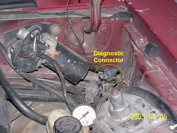

Dump the codes and see what the computer says is wrong…Codes may be present in the computer even if the Check Engine light isn’t on.
Here's the way to dump the computer codes with only a jumper wire or paper clip and the check engine light, or test light or voltmeter. I’ve used it for years, and it works great. You watch the flashing test lamp or Check Engine Light and count the flashes.
Be sure to turn off the A/C, and put the transmission in neutral when dumping the codes. Fail to do this and you will generate a code 67 and not be able to dump the Engine Running codes.
Dumping the Engine Running codes: The procedure is the same, you start the engine with the test jumper in place. Be sure the A/C is off and the transmission is in neutral. You'll get an 11, then a 4 and the engine will speed up to do the EGR test. After the engine speed decreases back to idle, it will dump the engine running codes.
Here's the link to dump the computer codes with only a jumper wire or paper clip and the check engine light, or test light or voltmeter. I’ve used it for years, and it works great. You watch the flashing test lamp or Check Engine Light and count the flashes.
If your car is an 86-88 stang, you'll have to use the test lamp or voltmeter method. There is no functional check engine light on the 86-88's except possibly the Cali Mass Air cars.

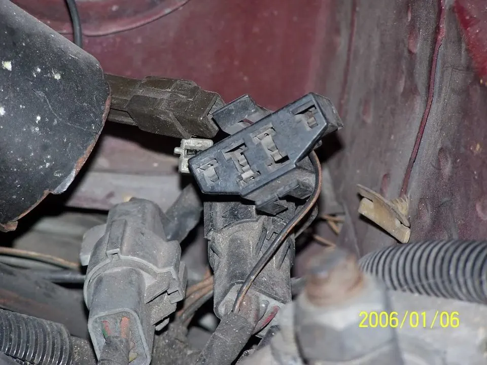

The STI has a gray connector shell and a white/red wire. It comes from the same bundle of wires as the self test connector.
89 through 95 cars have a working Check Engine light. Watch it instead of using a test lamp.
attachment.php
WARNING!!! There is a single dark brown connector with a black/orange wire. It is the 12 volt power to the under the hood light. Do not jumper it to the computer test connector. If you do, you will damage the computer.

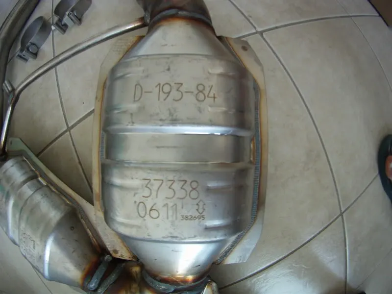

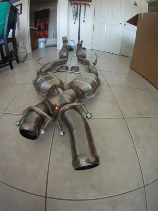

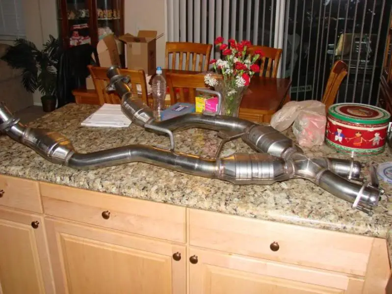

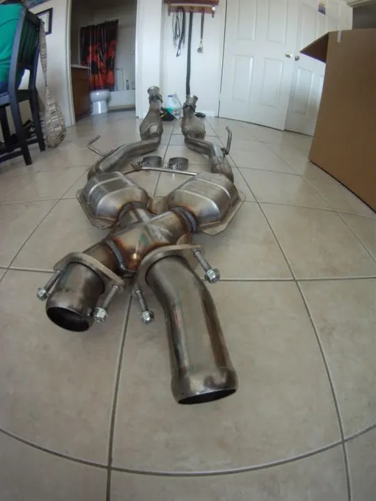

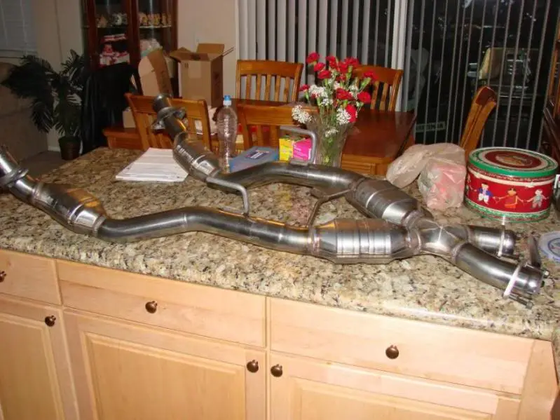

@Chrisboss429: Yeah the magnaflow ones seem to be the best bet in staying both VISUALLY(keeping placement and QTY of Cats) and SNIFFER passable. For anyone who needs a link and a good price here it is:
MagnaFlow 37338 - Catalytic Converter | O'Reilly Auto Parts
$374 - - Hopefully to pass smog and continue dealing with crappy roads and ridiculous smog regulations.

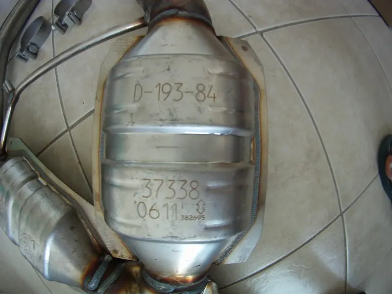

Here is what they posted as an image:
and Here is what someone posted in REAL Life....*oooo-aaaahhhhh*
Notice it still has a place for the outlet from the Smog Pump to the exhaust to connect. Mind you that piece is probably the one piece i hated the most during rebuild. It bends, it folds, and truly is the definition of frustrating.
Hope this info helps. I will be posting a video/review of numbers and installation once i get it all done.
Hopefully this thread will help another frustrated CA Resident trying to keep our V8s planted on the streets out here in CA.

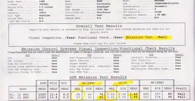

Before you spend $320+ on a new set of cats, check the smog pump output. Insufficient airflow from the the smog pump will result in low catalytic efficiency and high HC & CO numbers. Check the EGR system vacuum to make sure it works like it is supposed to work. Low EGR efficiency means high NO output. The two tech notes on EGR & Thermactor Air System have enough information to get you pointed in the right direction.
About 6 months ago i had the entire smog pump lock up on me and tore through my main Belt. So that smog pump has been replaced as well. I already went and purchased the cats seeing has how the ones on the car have a a date stamped from Ford- - $$$$- - Stamped in 97 so it's due time for these cats to go.
I took pictures - -
This was a pretty weird slip in the box. No CARB sticker? I am going to call Magnaflow on Mon and see what the dealio is.
