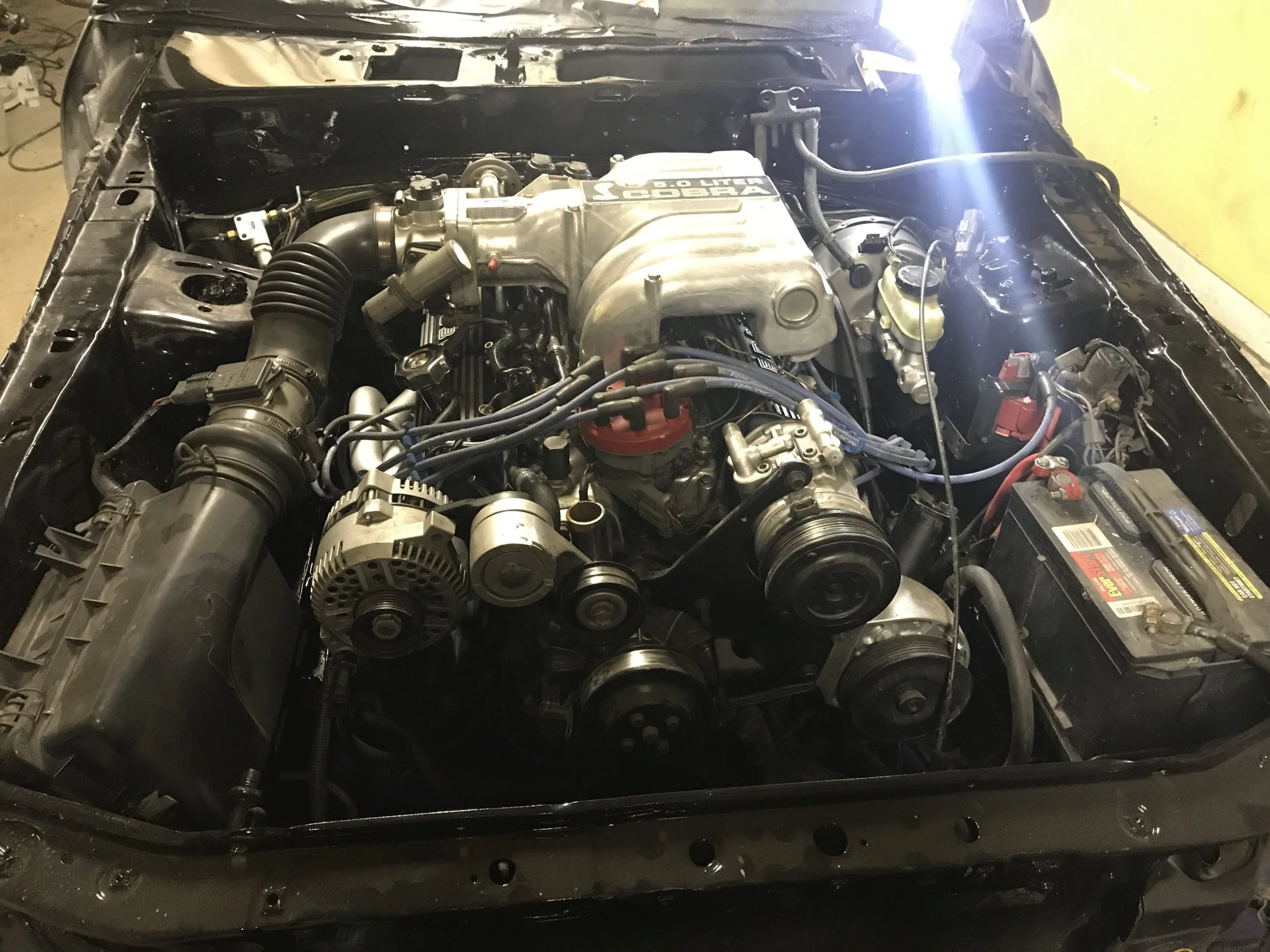

Terrible pic, and everything is dirty. She fired up for a few seconds. No idle so far. But I only
Had about half the vac lines hooked up and I know I missed at least one ground. Gotta wait till I get the rest of the exhaust hooked up before I do much More, woke both kids by mistake ...

Yup! My oldest was up outta bed thinking it was joy ride time lol.
Discovered a few fun things tonight. My
Car is taking odd spark plugs. And I'm
Missing the exhaust mount that goes by the trans.
Also realized I didn't hook up the fuel pressure regulator or the bap sensor . Should fire up properly once those are done

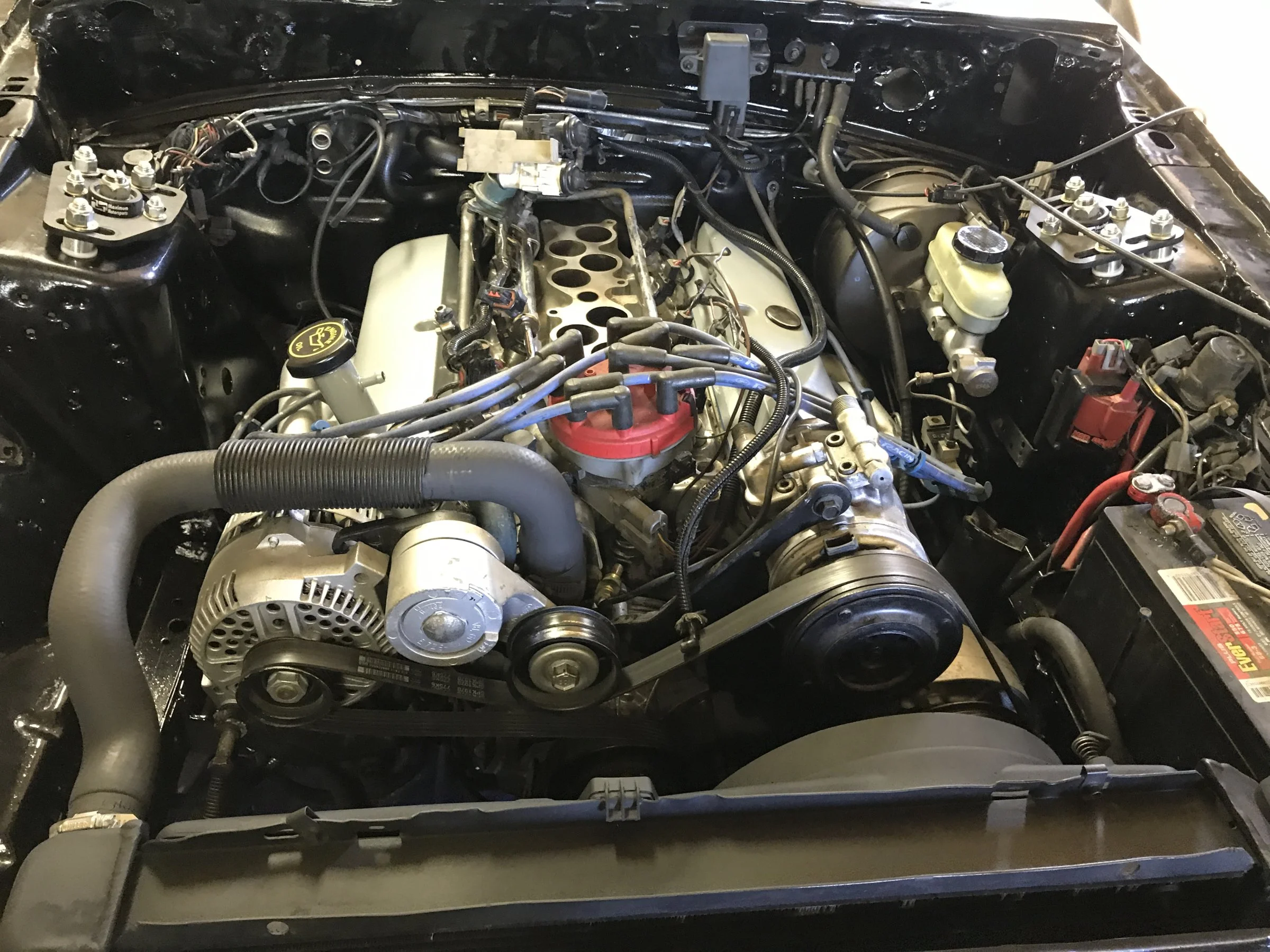

Ok, got a bunch done.
Swapped the cobra valve covers for powder coated stockers.
Made new egr vac lines and ran them through the rear main harness.
Tossed the cc plates on
Got mid pipe and mid pipe bracket installed ( thanks mstng93ssp)
Tucked the hvac vac lines
Ordered a power distribution block
So I can move the accessories off the solenoid and into the fender.
Just a few odds and ends left before i start on the rest of the paint.
