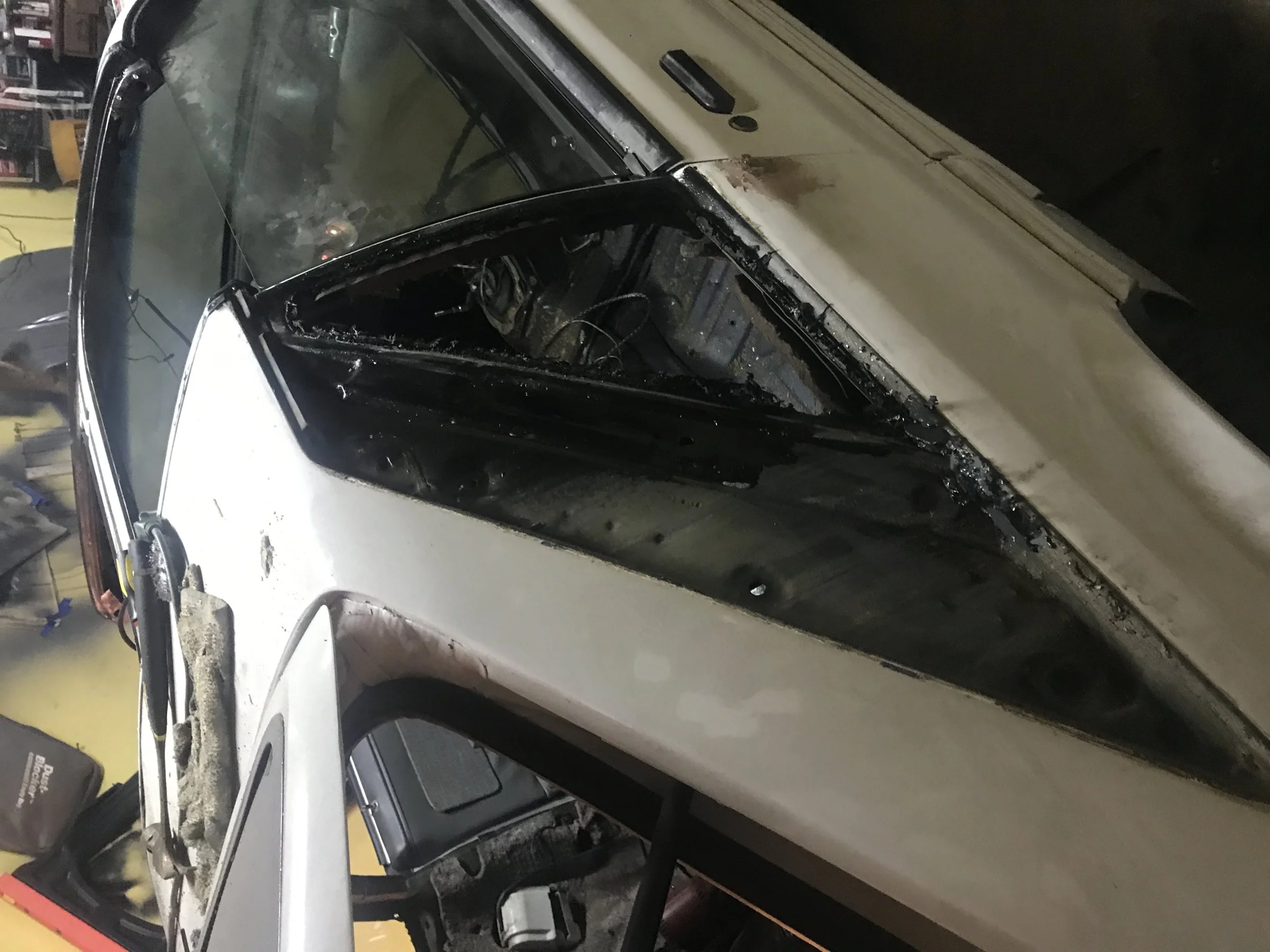

Just a crappy looking pic. Got a quarter glass out. Busted one by mistake. Gonna take a day to clean the work area back up and vacuum all the dust and glass up.
Then it's adheasive remover and new rivets.

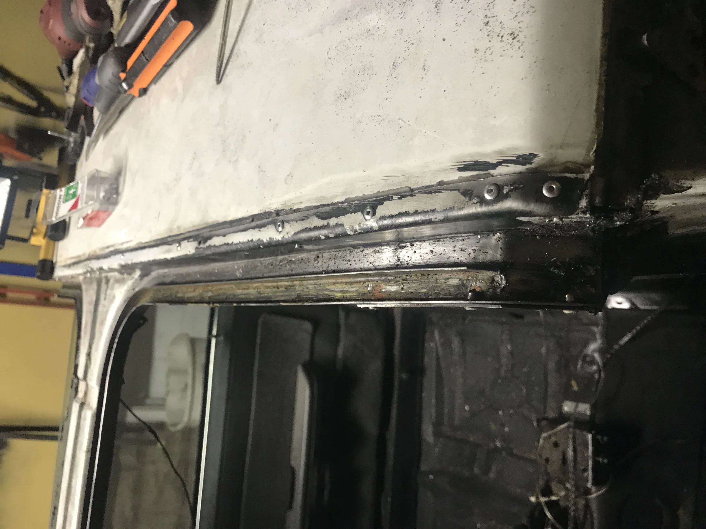

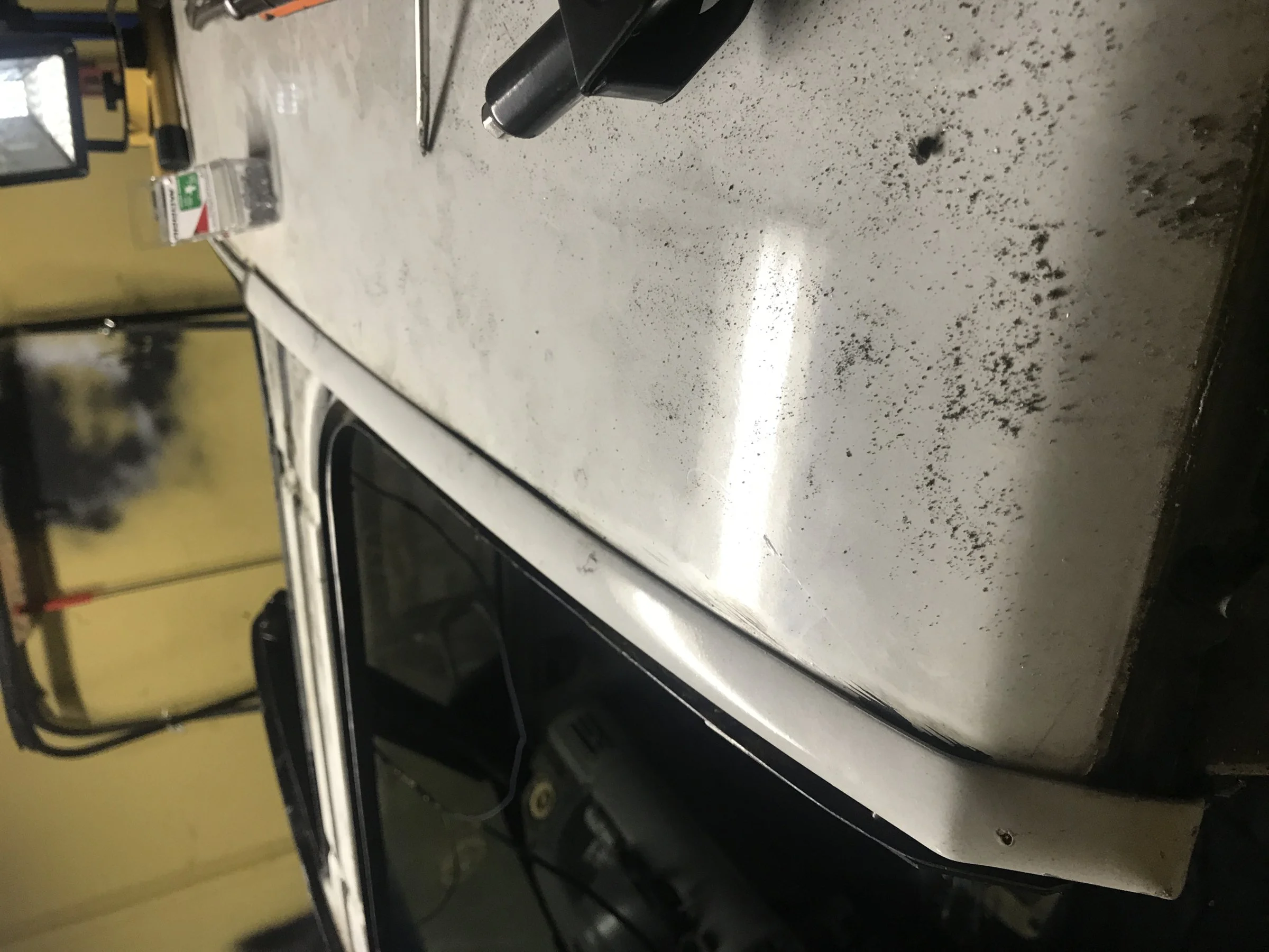

Got some progress tonight. Got more of the glue out of the t top channels. And I started replacing the rivets. The front needed 4. And I replaced them all in the back. Ended up removing the support strip completely as it was only held in my 2 rivets. Pounded out the old rivets and put it back. The very center one was a pain!! I may drill and add one or two while I'm at it, but it's almost complete straight now.

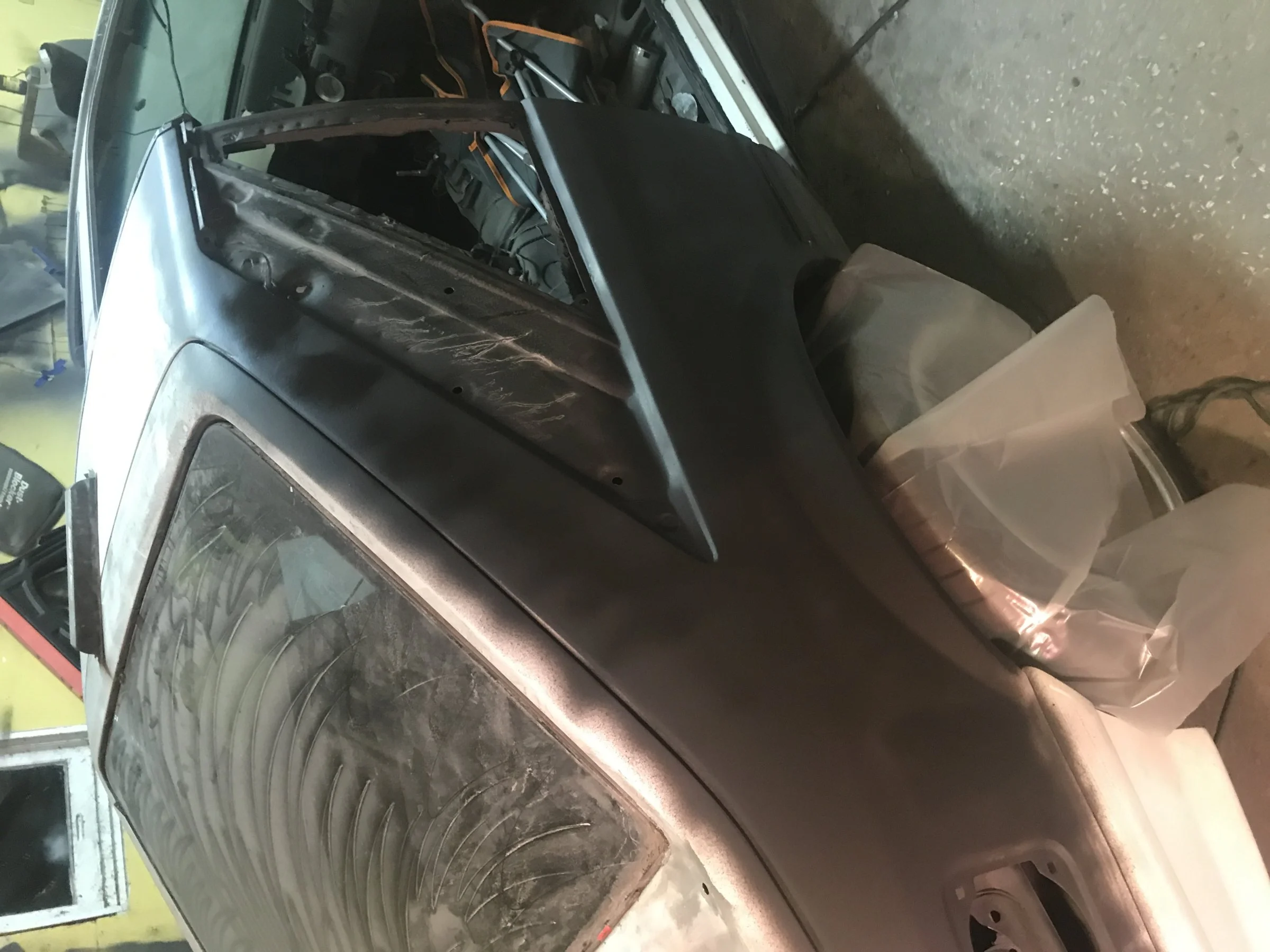

Ok. Been a slow month. Lost motivation... but I'm back at it. I was pretty reluctant but after a couple talks with Dave I've started the process of stripping the car of the old paint jobs.
Spent the night stripping the old paint off, going back over the metal with a da and a quickly in primer. Shooting to have the rest of the back half done this weekend. The a pillars and front roof and t top frame are already stripped and in primer.

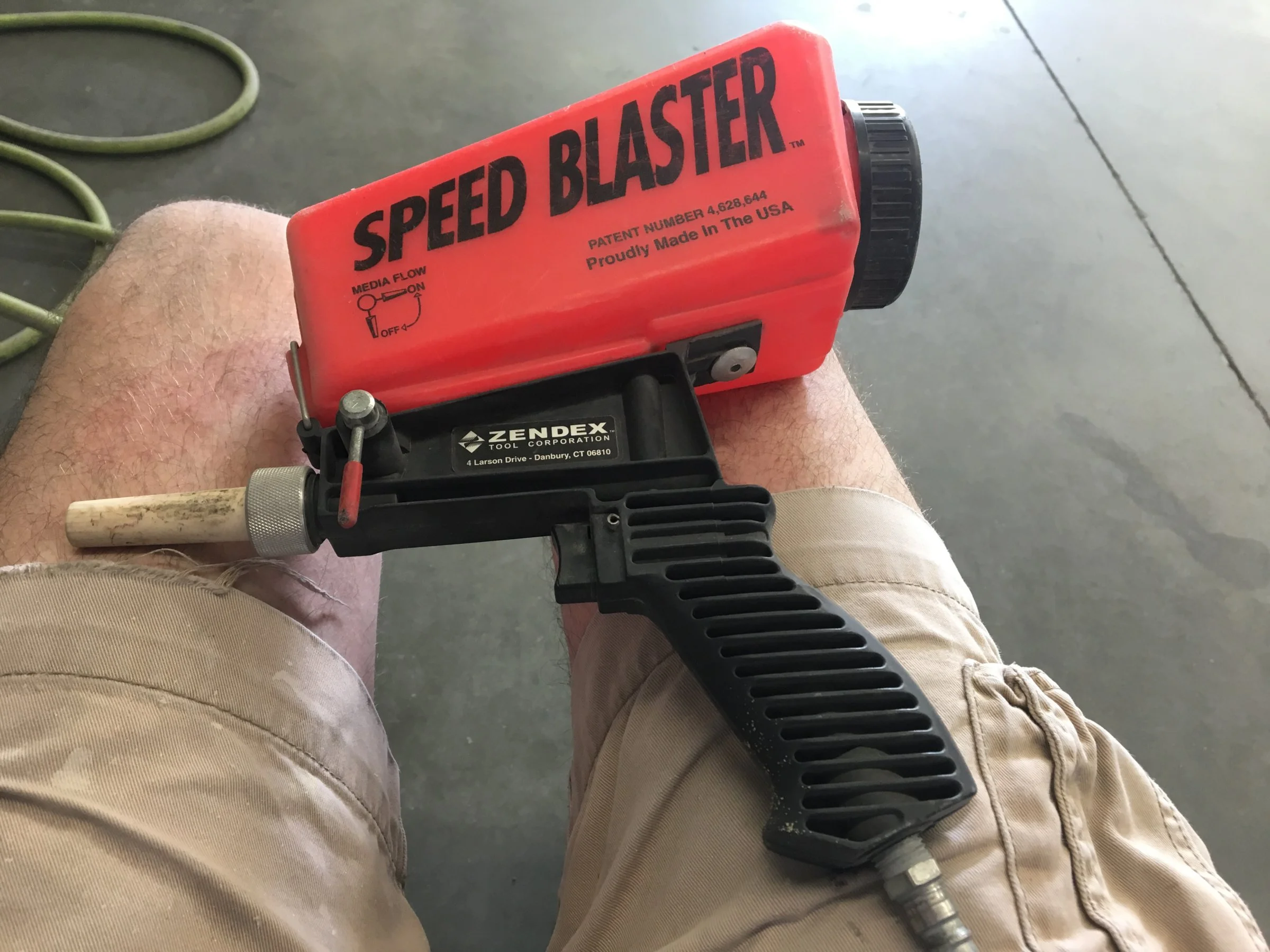

Do you have a mini hand held sand blaster Bill? They really help cleaning out the hard to sand areas.
Do you have an example picture/part number for one of these? I've seen several siphon guns (like the harbor freight version, I think ir makes a cheap one too) that just pull from a bucket, but don't know if that's the type you're speaking of.

I've used that little sucker on all sorts of sht.

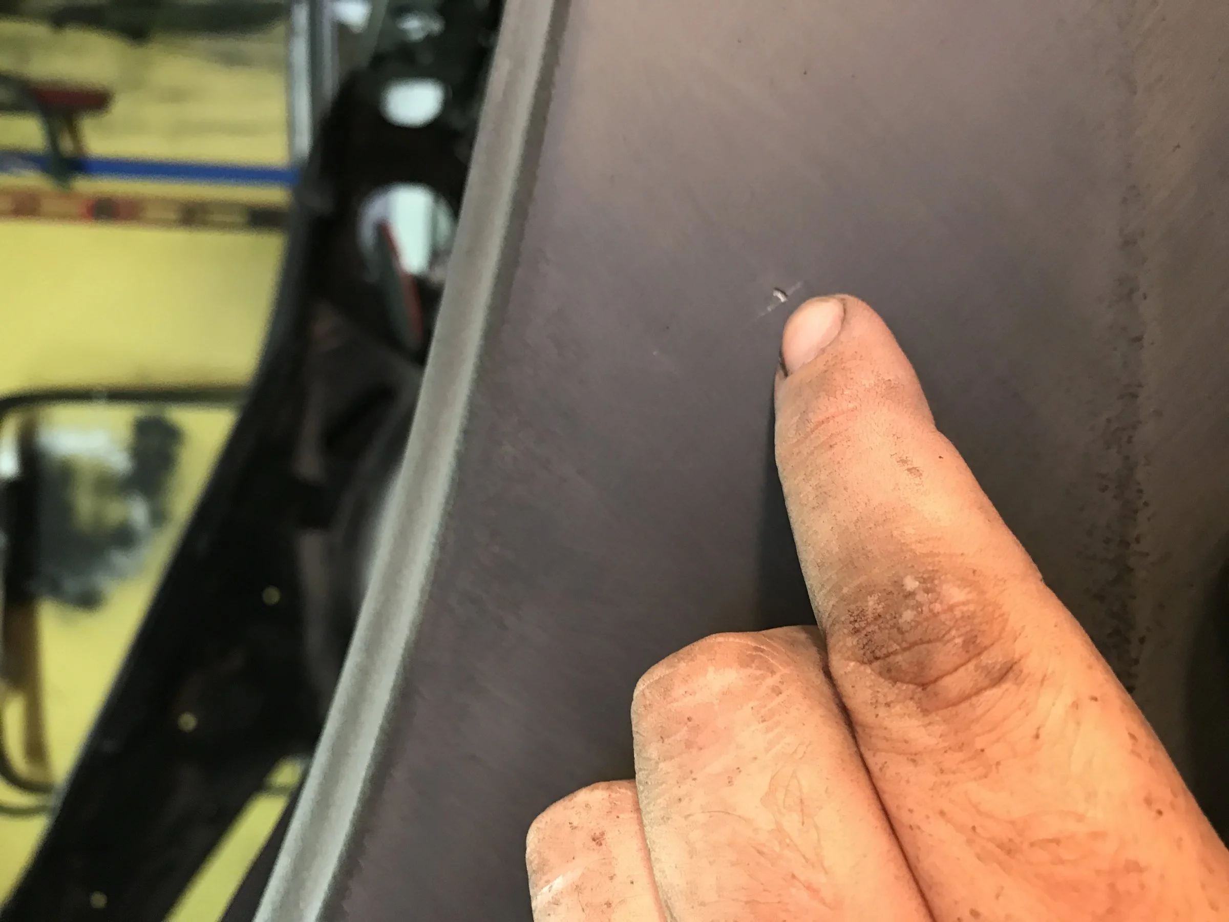

Just a few pics to keep the thread alive.

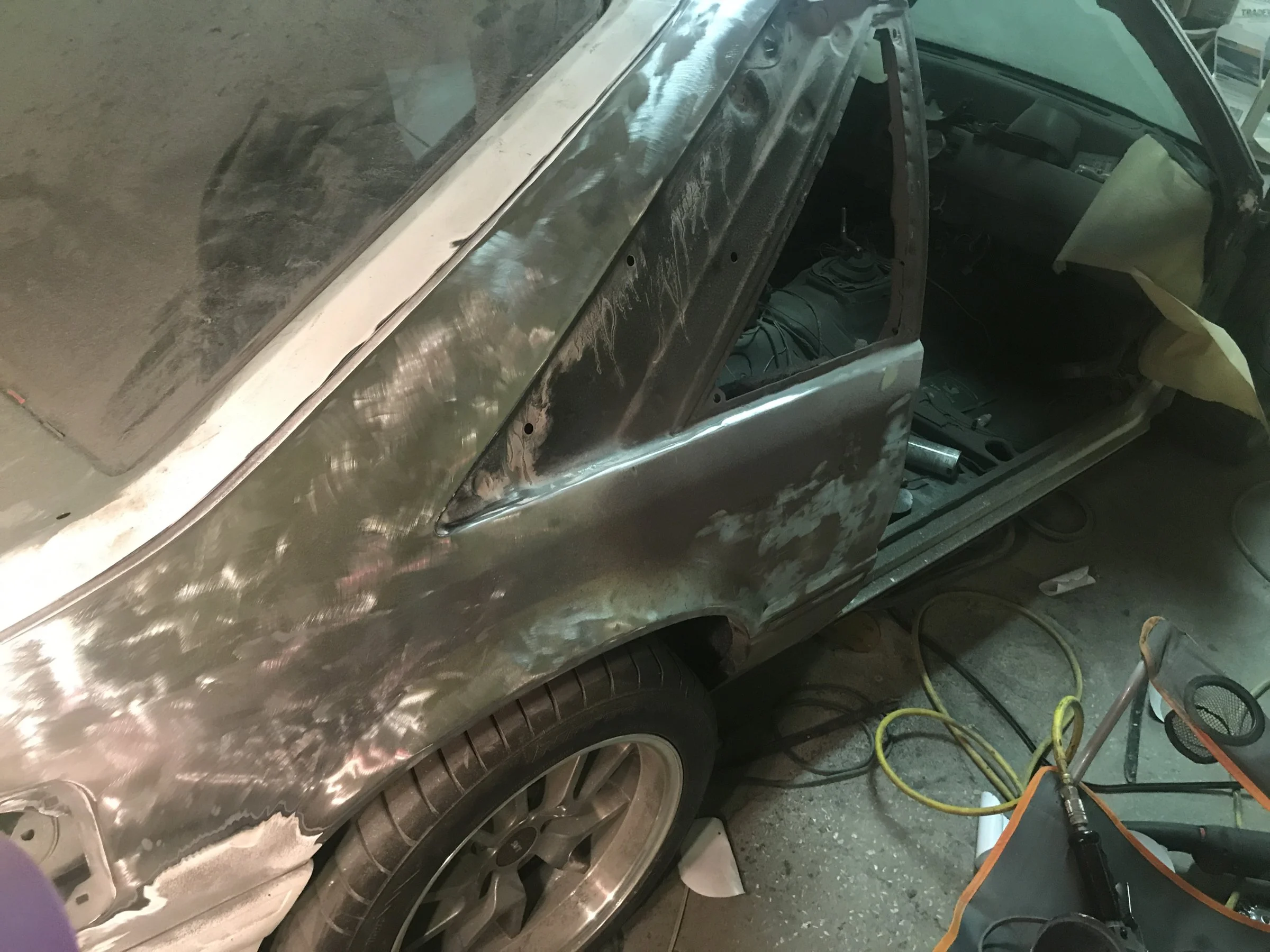

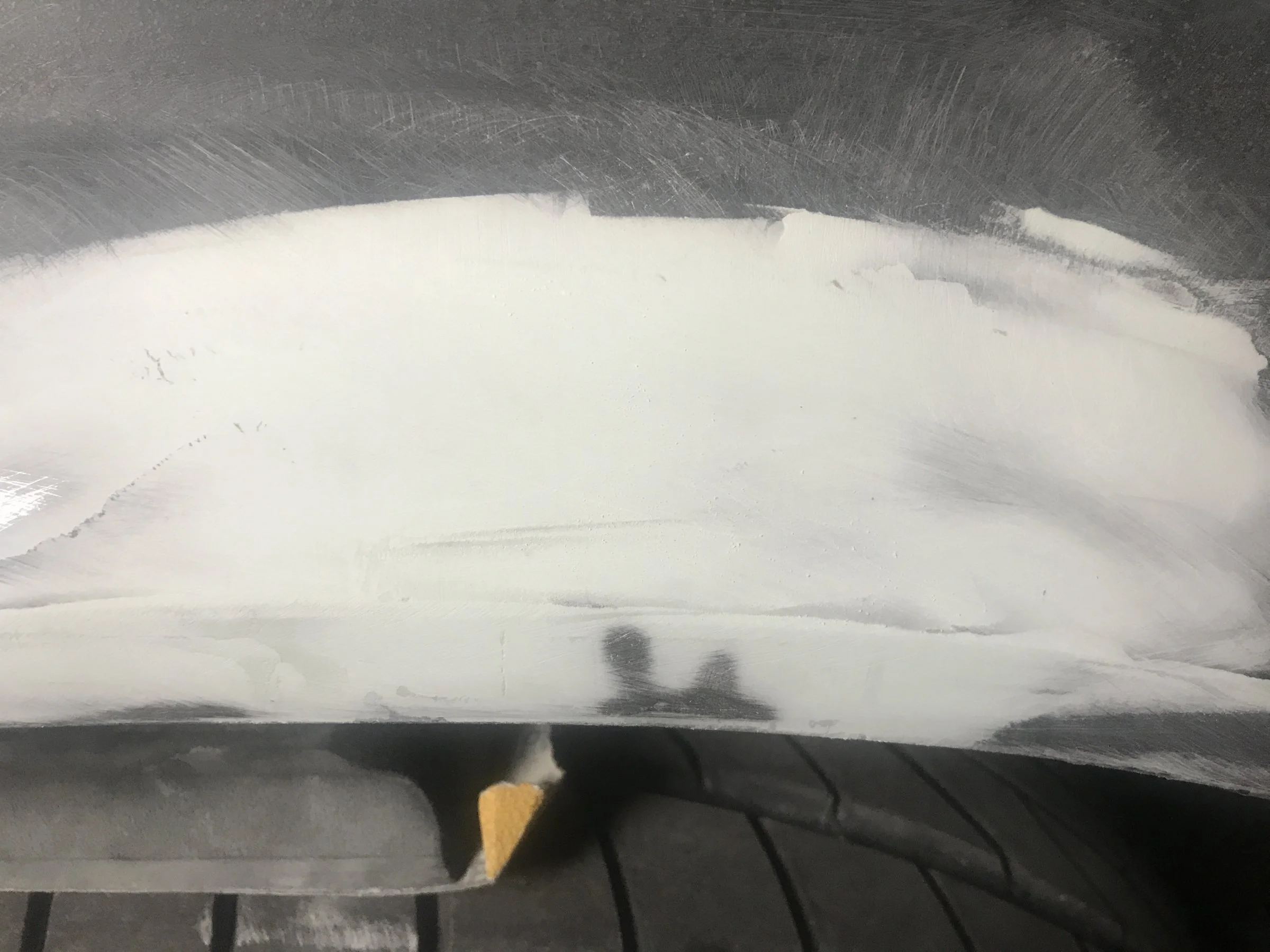

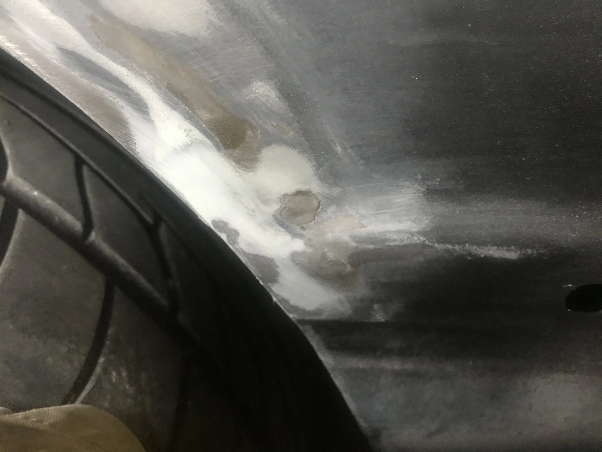

The drivers side quarter needed a little work. I didn't get a good before pic. But I stripped the filler and me and a buddy popped the dents out. Filled it and blocked it. Learned a cool trick with using a pencil and a paint stick to map the fender lip and keep the body line.

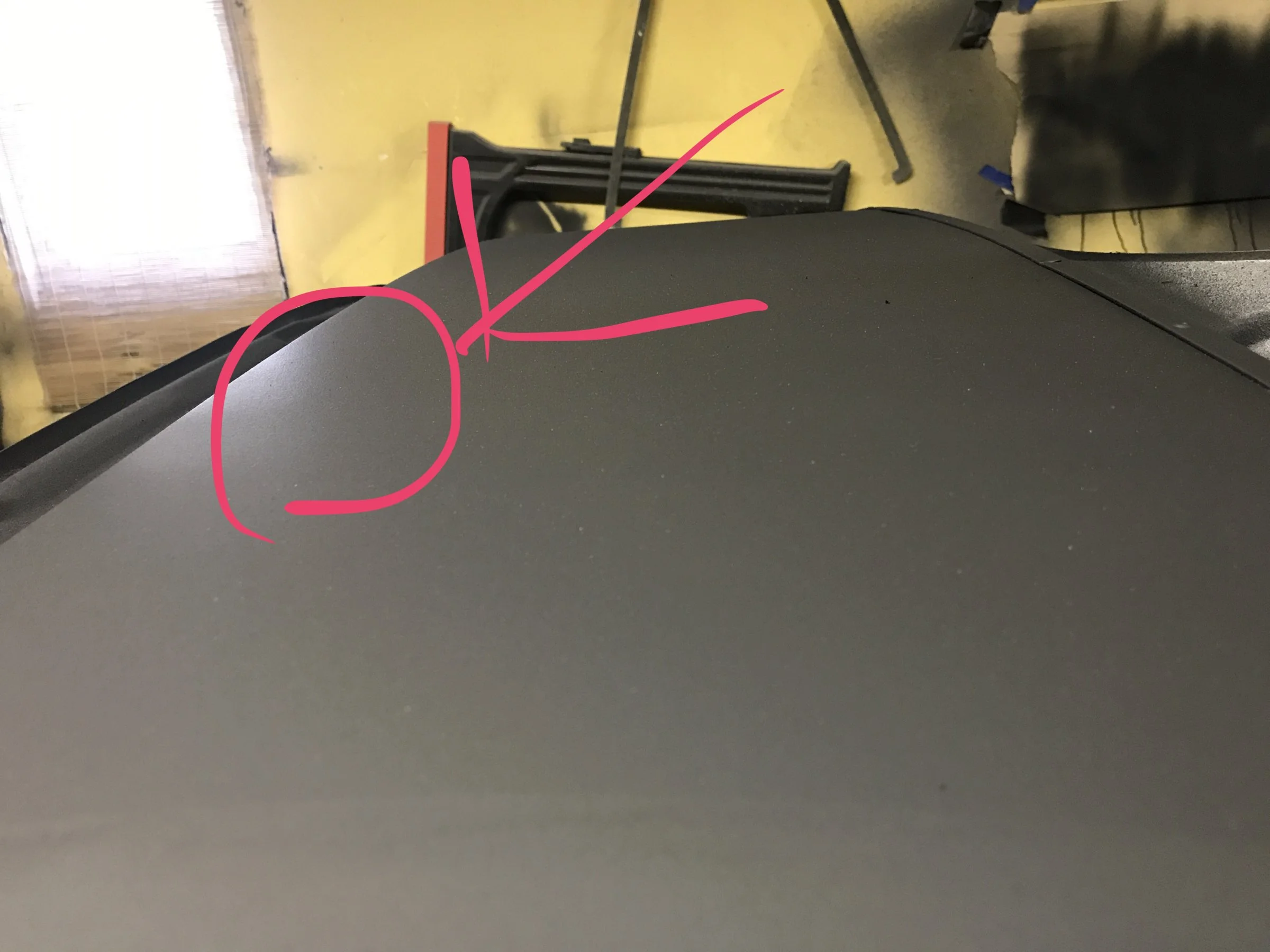

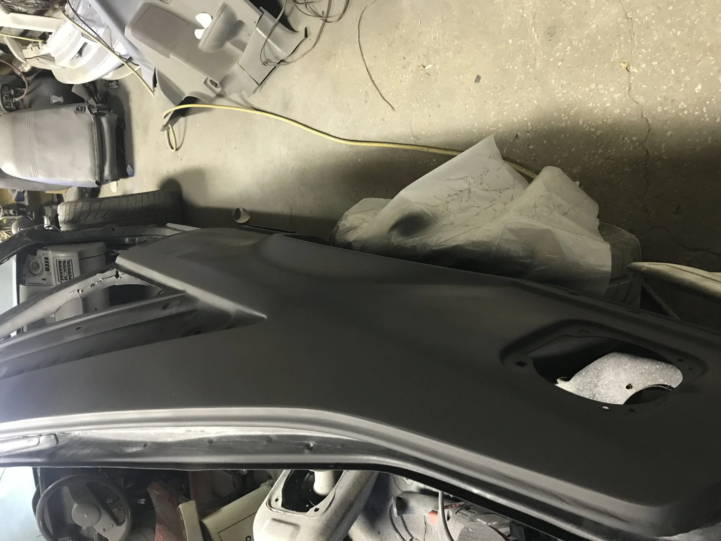

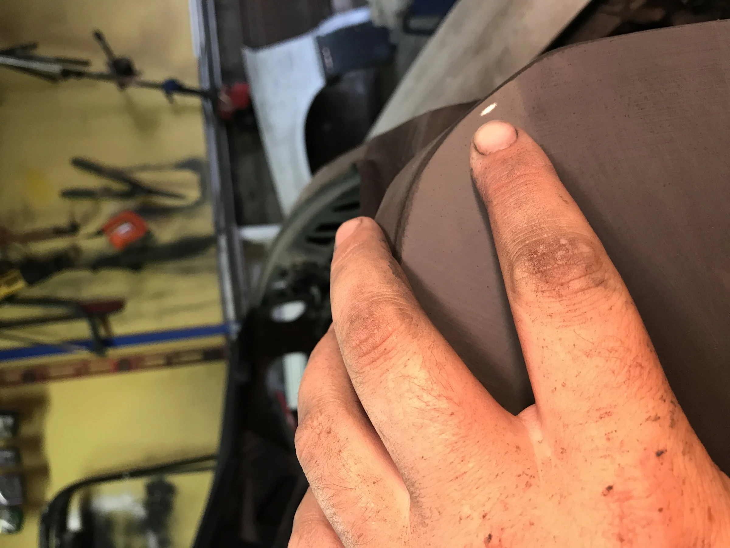

Added 2 coats of high build primer and blocked with 180. Filled the lows ( all but the one I missed) , 4 coats of primer and then blocked with 320. It was almost perfect except for where there was some trash in the primer and I burned through in one spot by the edge and then I found a low on the roof I missed. The roof has some flex to it so it only shows up if I use the long block. Got it filled last night. Gonna prime one last time ( I hope) and start the final sanding before I paint the body. Then I can get my interior out of my man cave.
