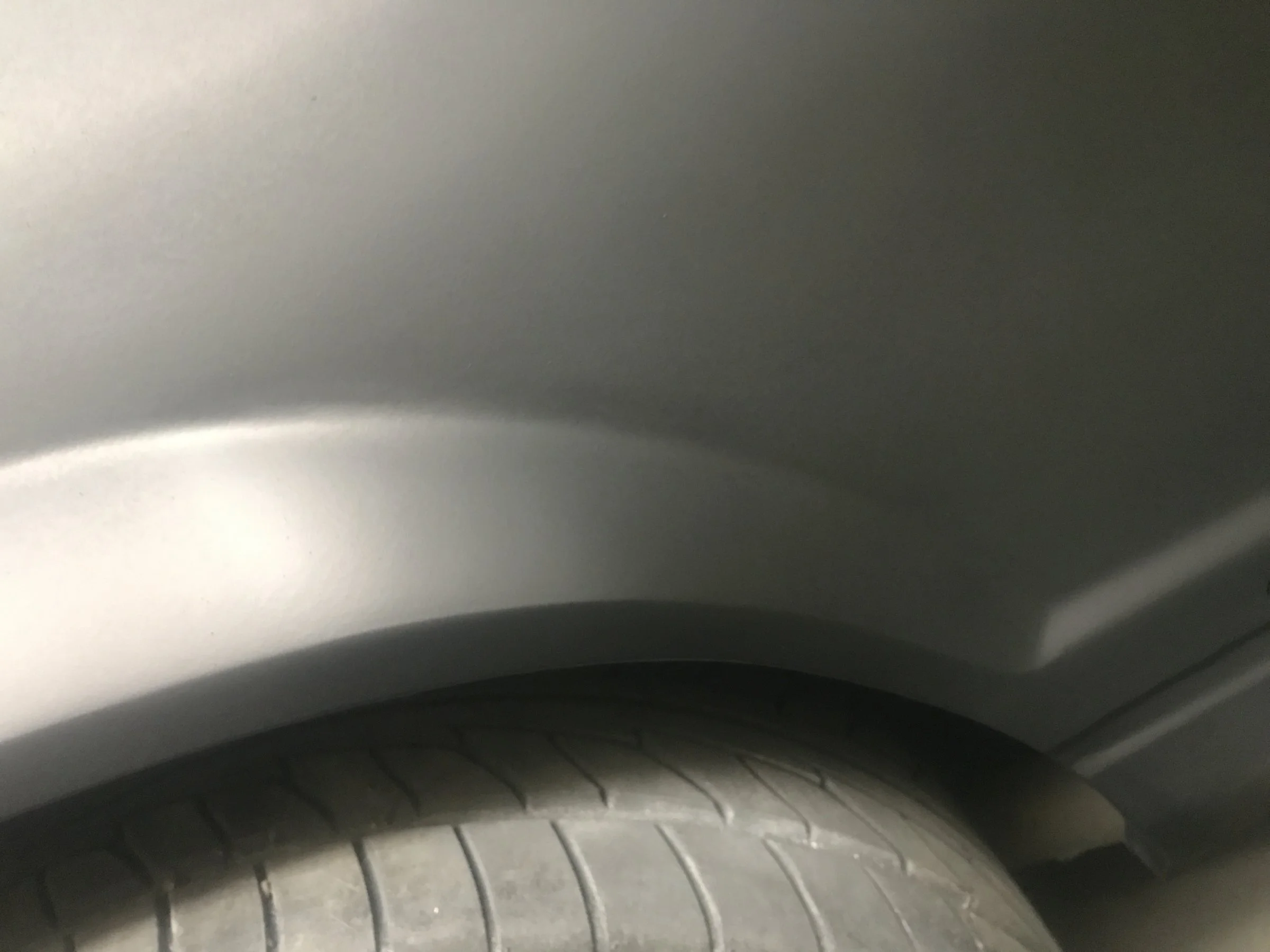

Feels like 2 steps forward and 3 steps back, but some small progress. I rolled the rear fender lips. Primed the wheel wells and a couple small
Spots again. The small areas are getting wet sanded and I'm back to blocking the wheel wells. Door jambs got a second coat of primer before they get a final block. Finish these areas, wet sand , double check it all, wash and I'll be ready

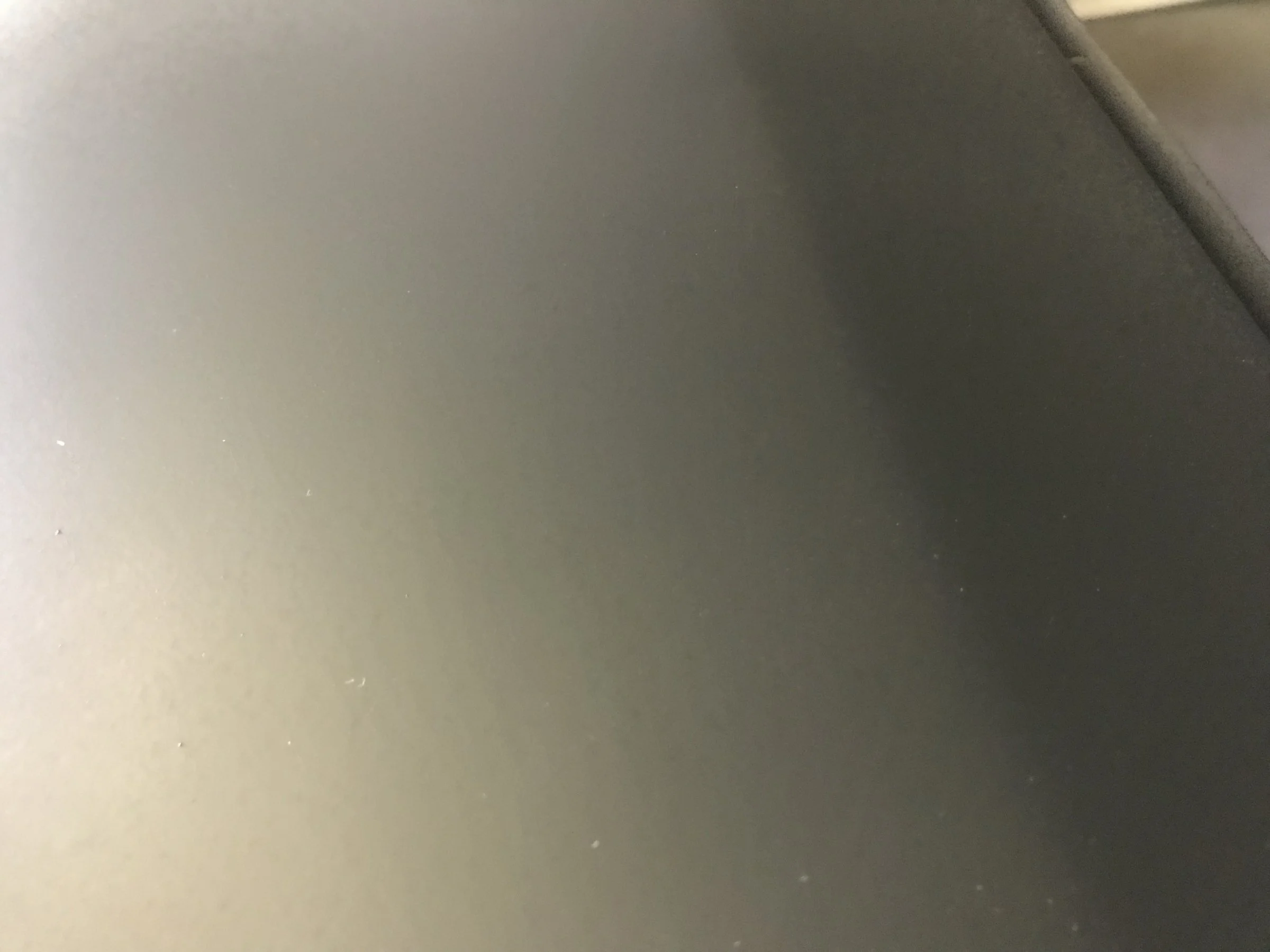

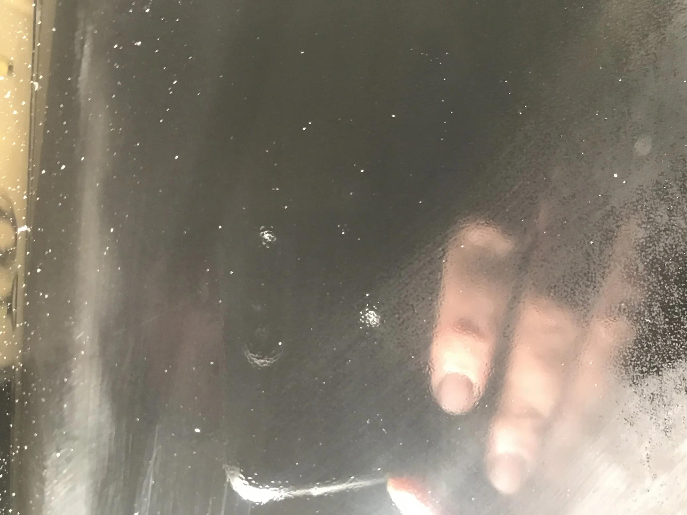

Ok, 2 weeks ago I started to shoot some paint
And it looked fine till I did a cut n buff. I had tons
Of solvent pop. Spent a week going through my air compressor and doing test panels. The issue was my painting, I was way too close and fluid was way too heavy. Below is a pic of the dots that were killing my progress, followed by a reflection of the test panel once I sorted my issue.
This was the first ups and downs.

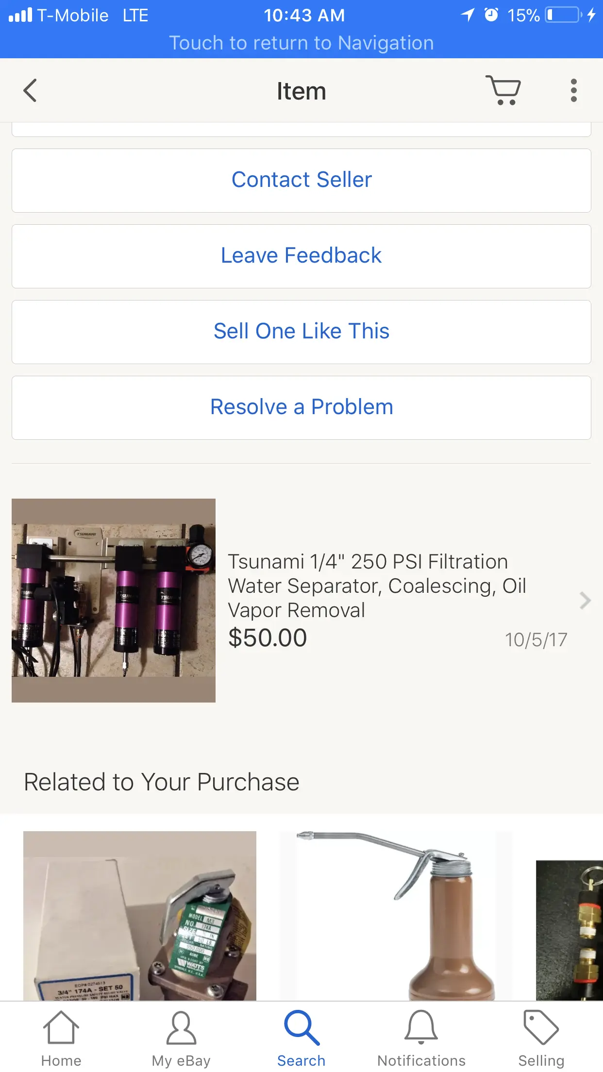

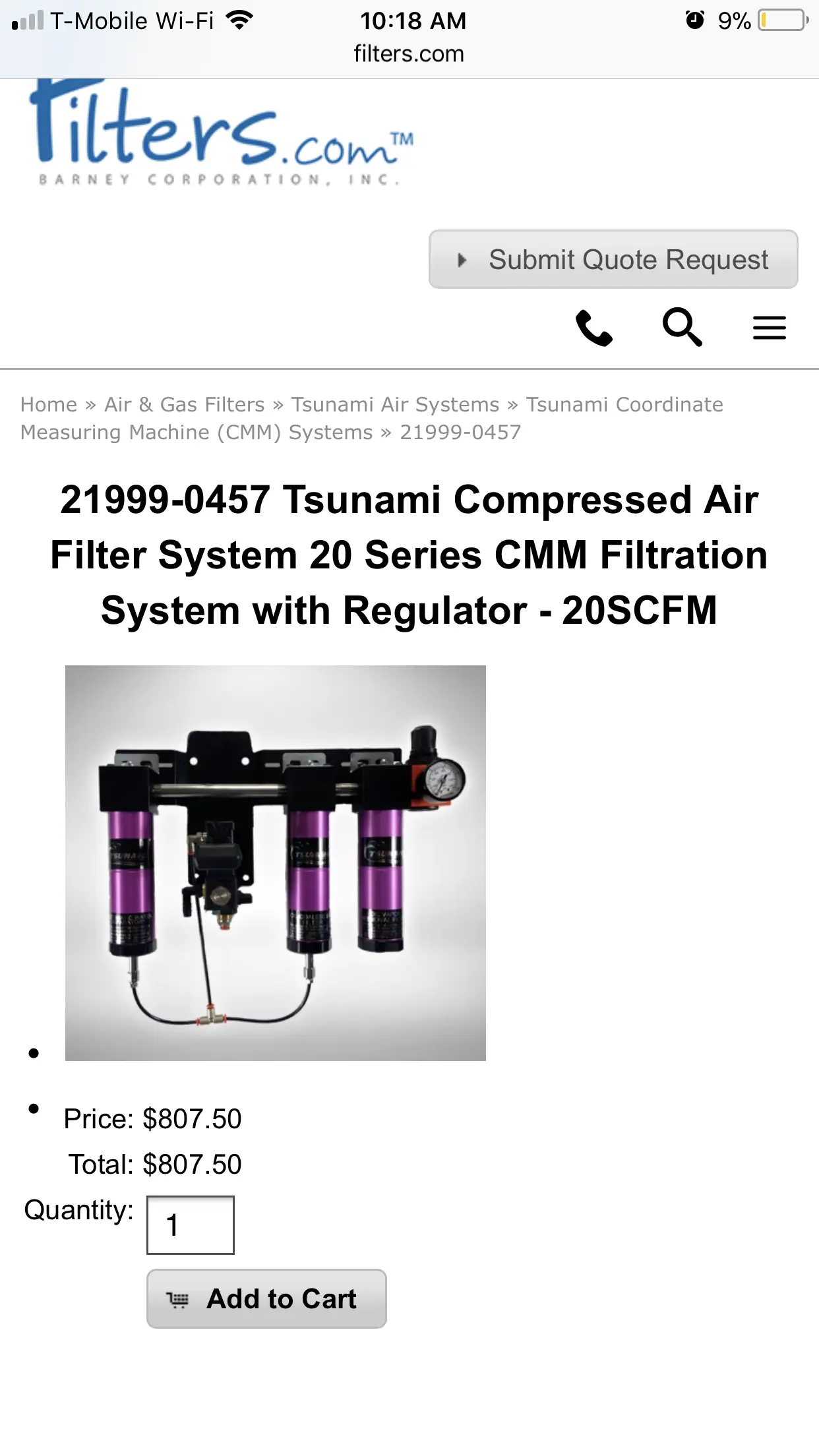

so I stripped and primed the areas preparing to try again. I decided to add some more filters to my air lines. This is where I got lucky. Someone had a higher end filtration set up for cheap on eBay. It had good reviews so I jumped on it. This was the first good buy. Below are the pics of the unit with the retail price next to what I paid. Very happy.

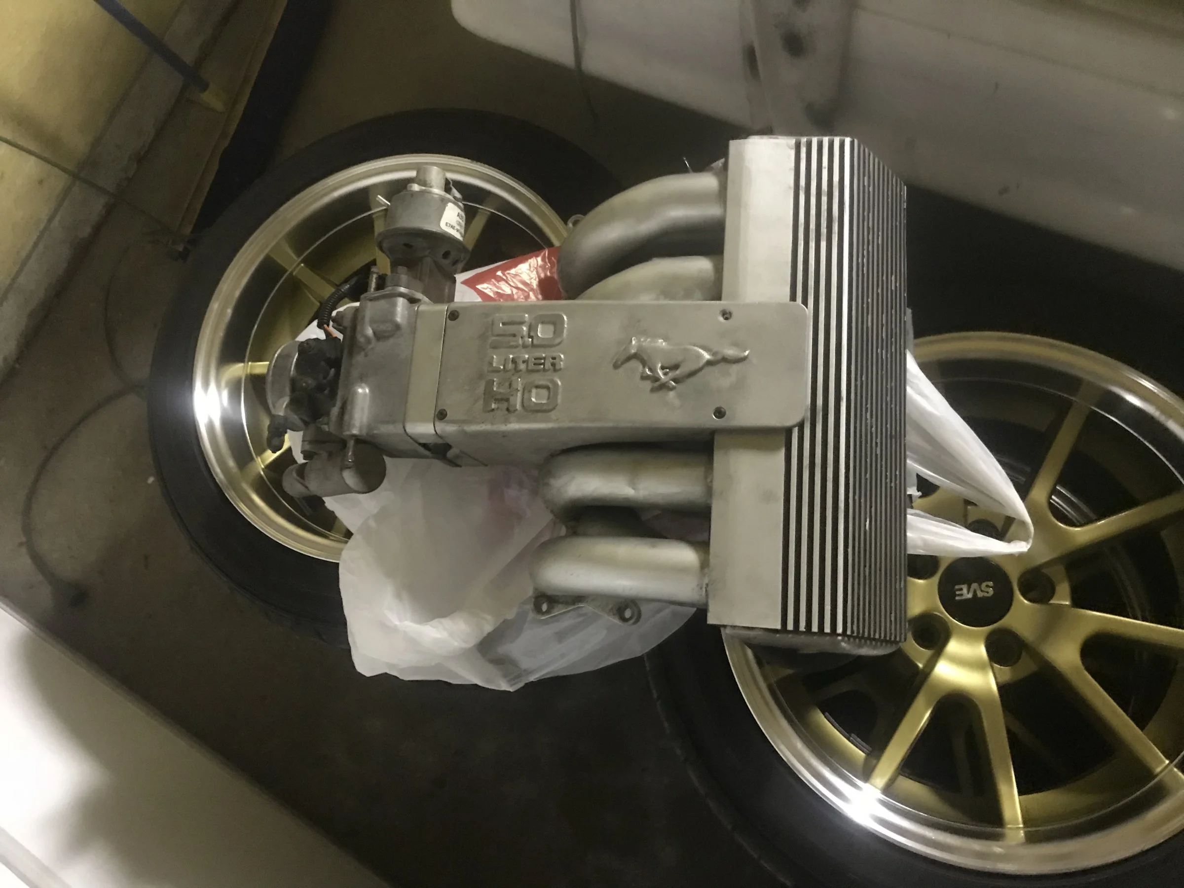

Next was some changes with the wheels I have. My rear tires were 285s and even with the quads gone and the lips rolled I was running on the inner well. So I posted them up locally hoping to trade for the same wheels but smaller tires. A local guy with a 20k mile 04 offered me his 18” chrome steeda wheels and a nice chunk of cash to trade. It was an offer I could not refuse. I used the cash to buy a gt40 tubular intake , upper and lower, the cover and throttle body. I’ll have them in a few days. To make this a perfect deal, I listed the wheels I got in trade and was offered the same style wheel I had before but with the tire size I need. I’ll have them tomorrow.
This was nothing but dumb luck.
Below is a pic of the set up and a pic with the guys luck I borrowed .

Wow Bill, what a great score on the filter:nice:

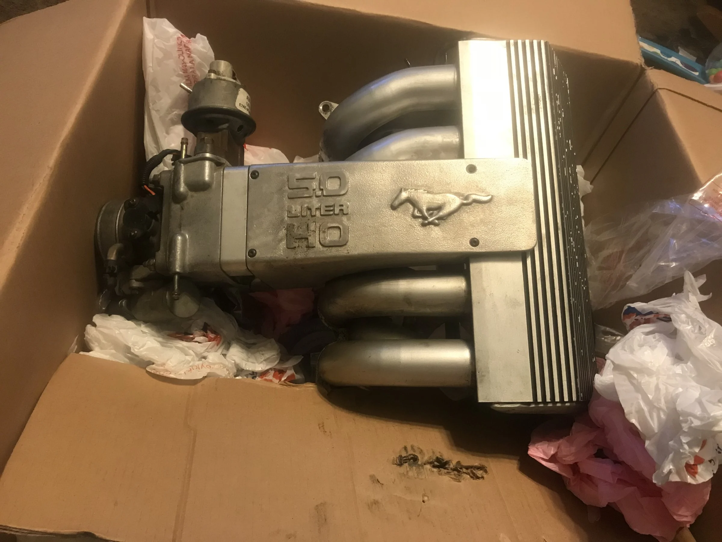

Plus I got the gt500’s today. I’ll paint them back gun metal. Plus my new prized possession was waiting for me when I got home. I’ll swap the uppers soon so I can sell the cobra intake.

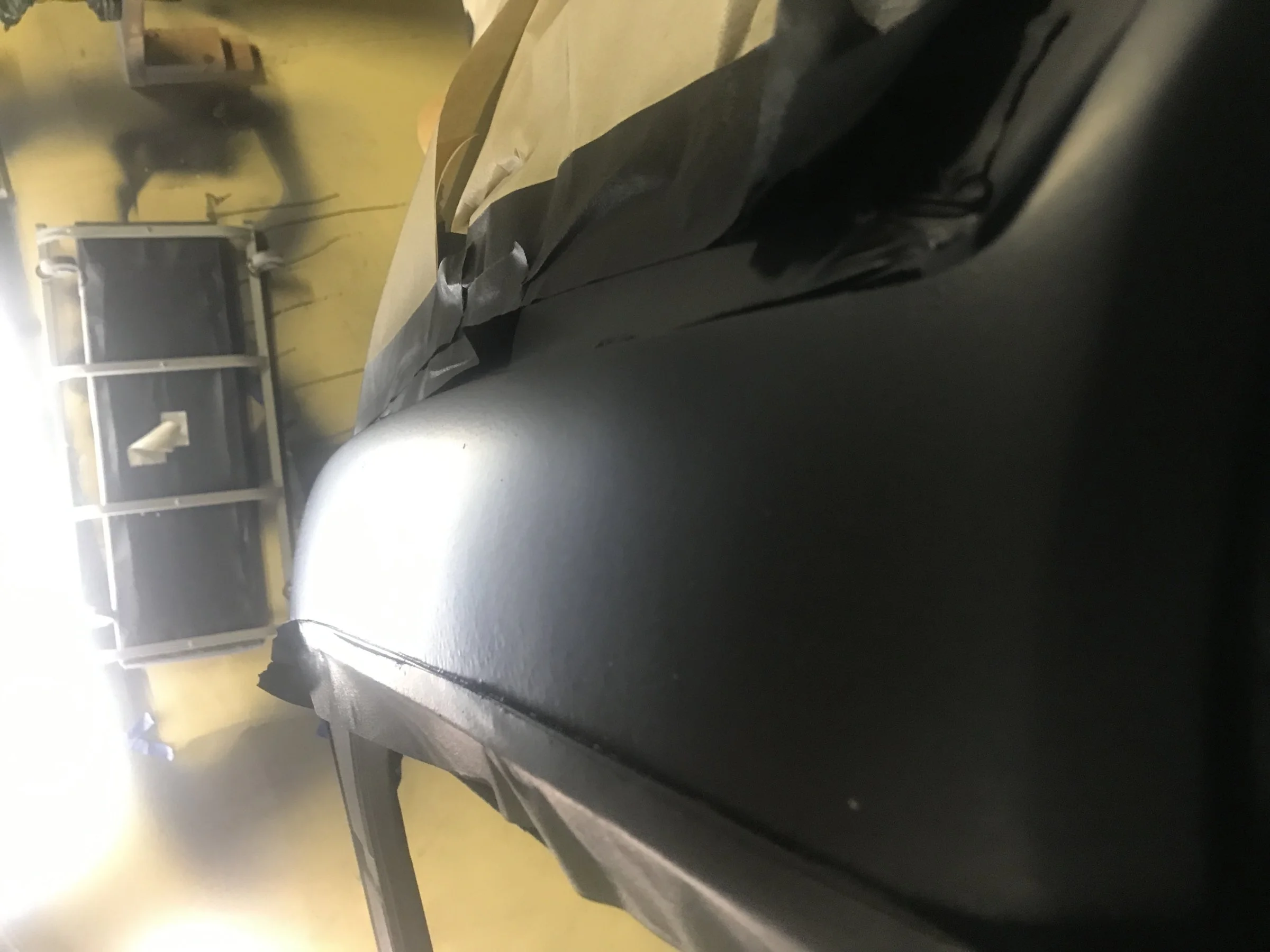

For the car. The hatch is done minus me scuffing the underside. The rear bumper is done. This was my least favorite part of the job so far. My arm and shoulder hust simply hurt from all sanding.

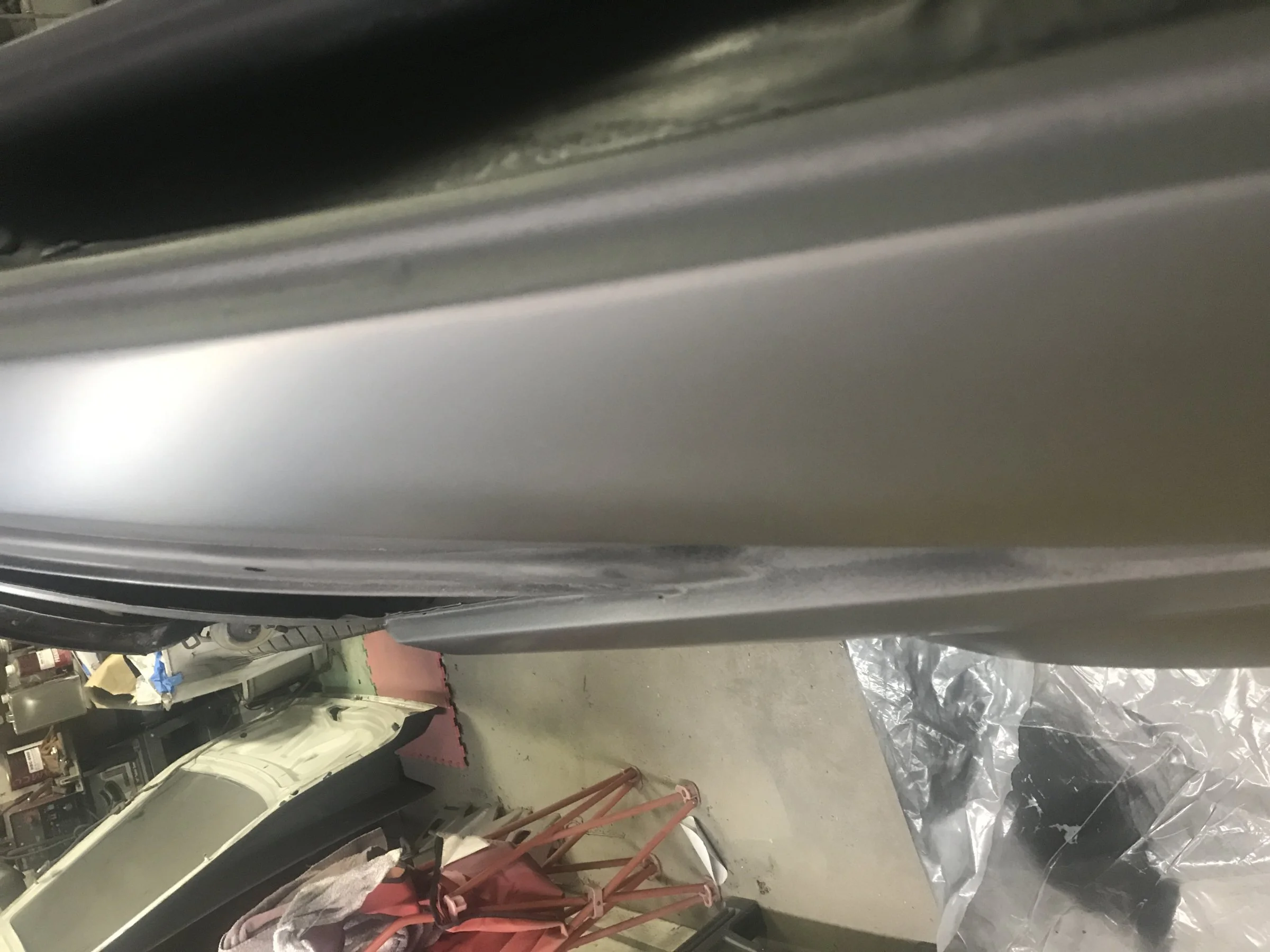

The one plus side to replacing the door is now I have an extra part to practice painting when the time comes. A quick side note, stripping a part with just factory paint is so much easier it’s funny.

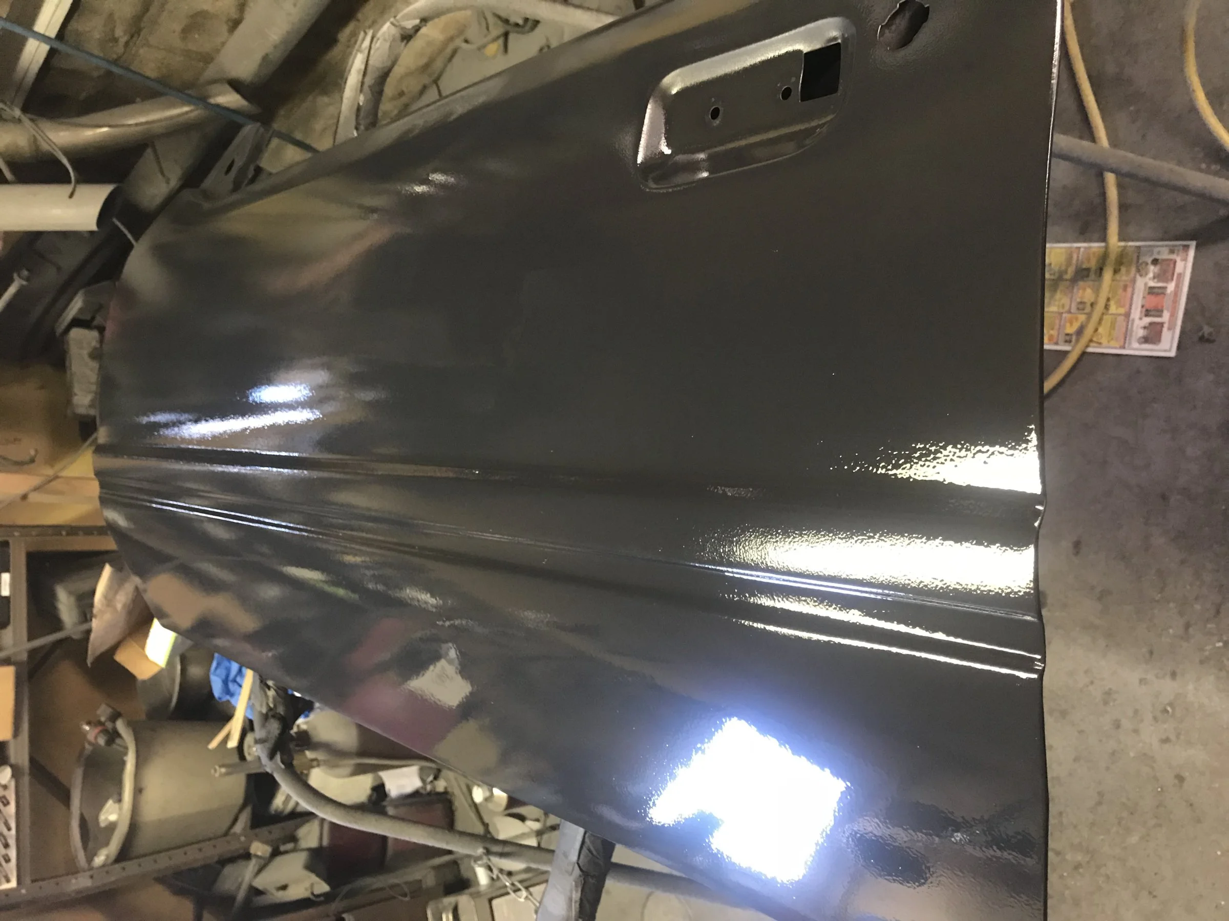

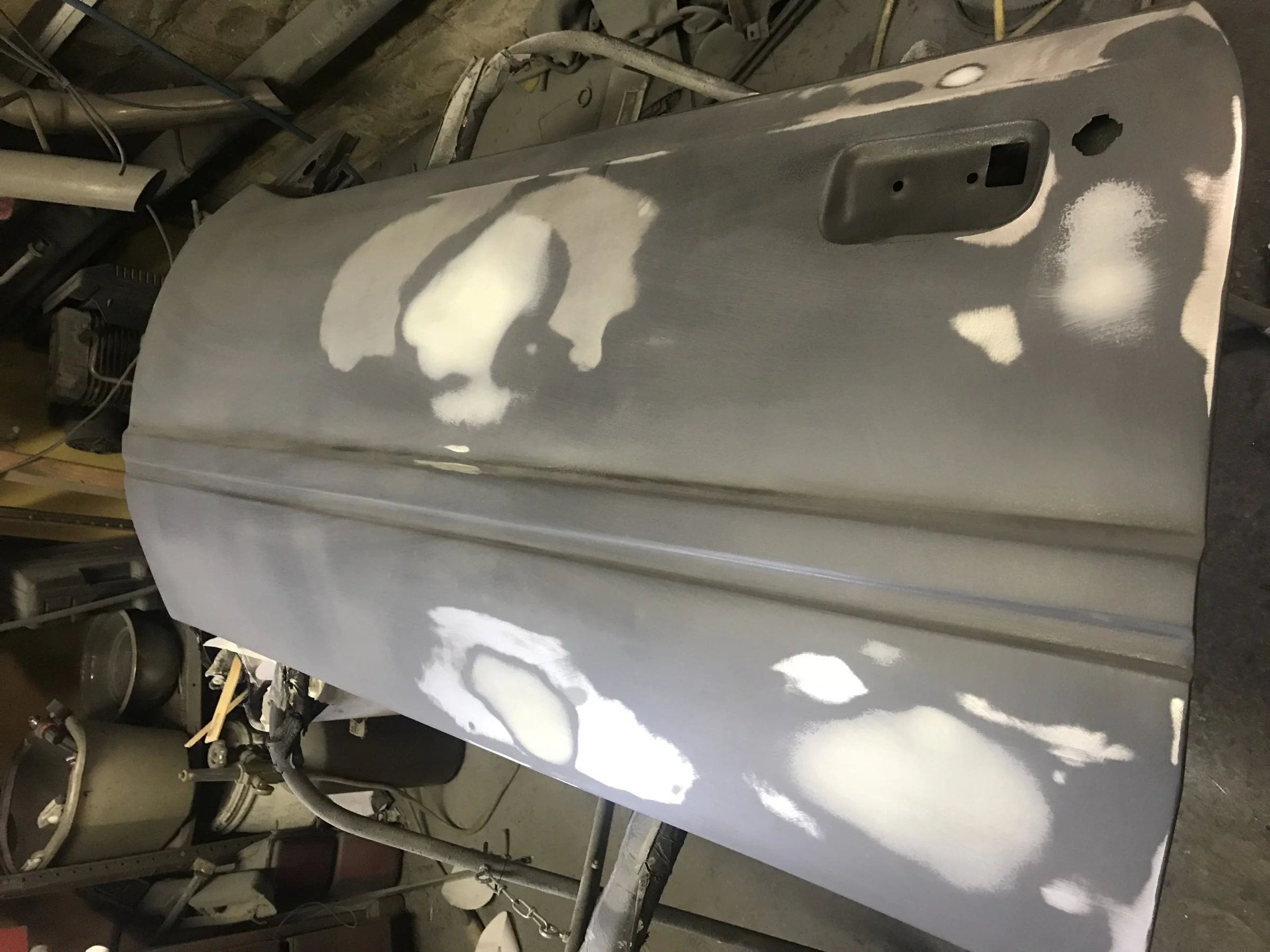

Filled most of the dings ( missed one) and got a couple coats of primer on it. In the reflection on the last pic you can kinda see the one I missed. We’ll see if it blocks out.
The more I spray the better and easier it gets. Now that I have the extra air compressor I’m getting more air and can actually use my gun properly. When I started out my primer was always like a dot matrix and tons of fun to sand. Between better mixing of the primer and gun set up/experience it’s getting much easier.

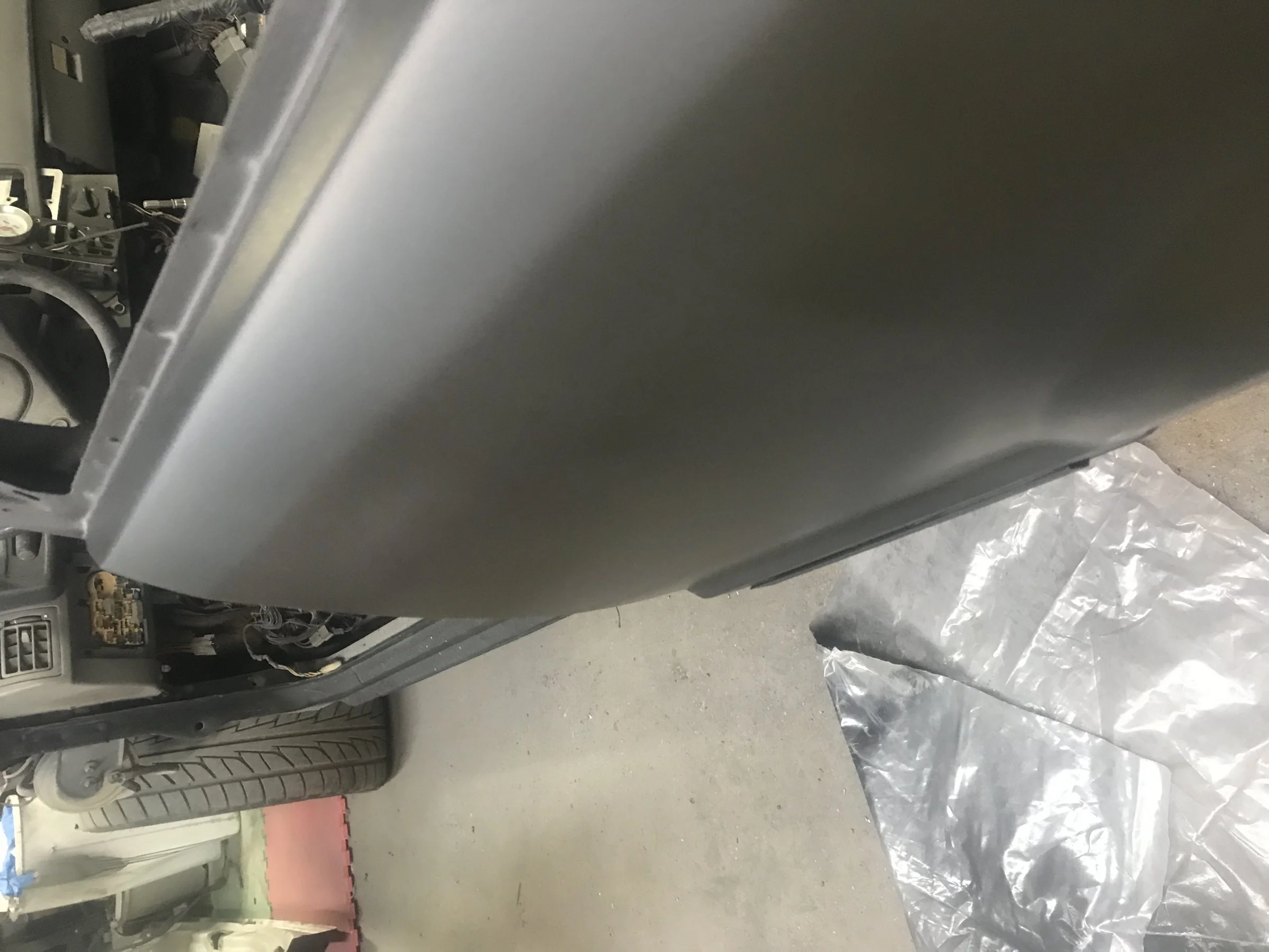

More done over the last few days. Blocked out the surface of the door, 3 more coats of primer and a second primer and she’s straight . Flipped it over. Removed the seam sealer, very happy to see only a super small amount of surface rust. Sand blasted it and removed the hinges. What a pain, even with the door off and a cut off wheel they didn’t want to come off. Better now than later though. Anyway, should have the drivers side done tomorrow if I can sneak away after the kids go to sleep.

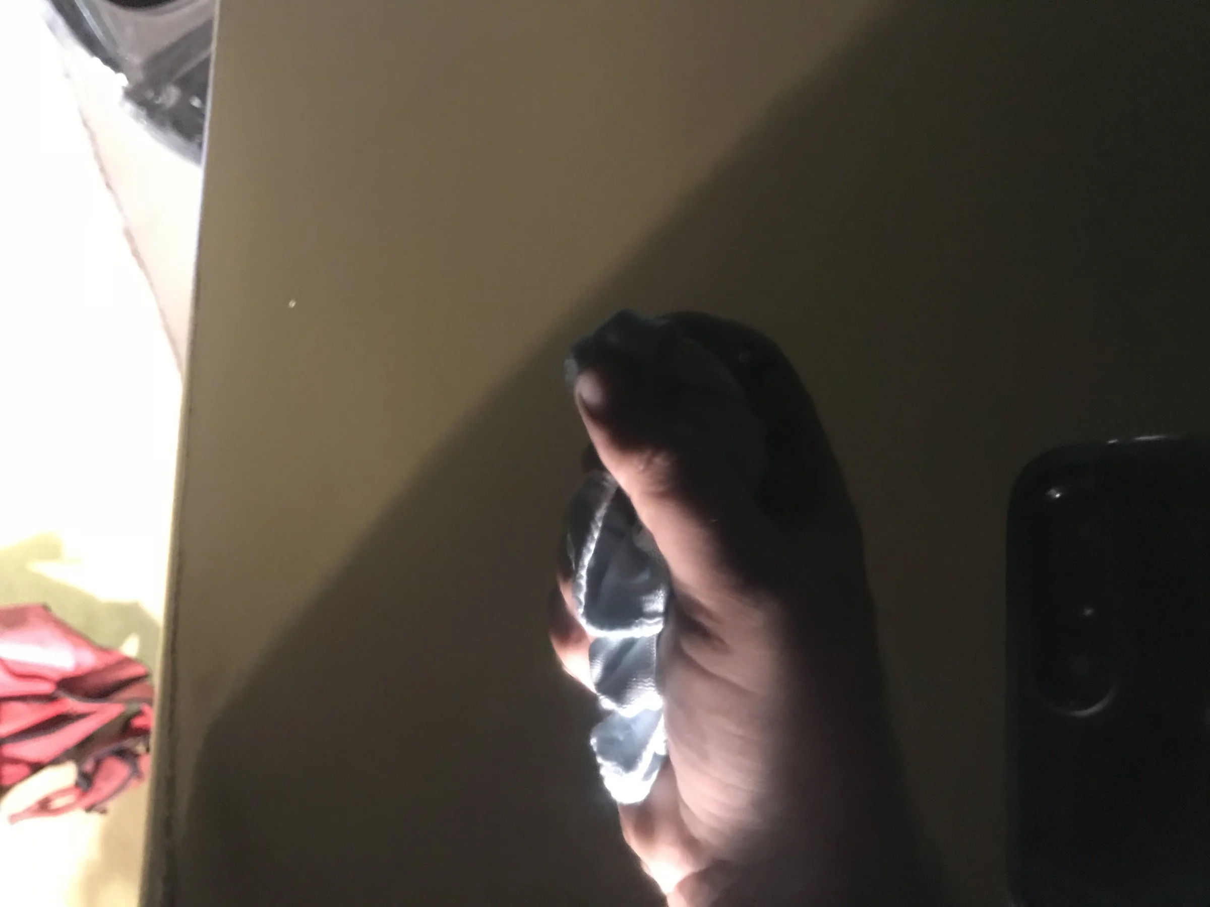

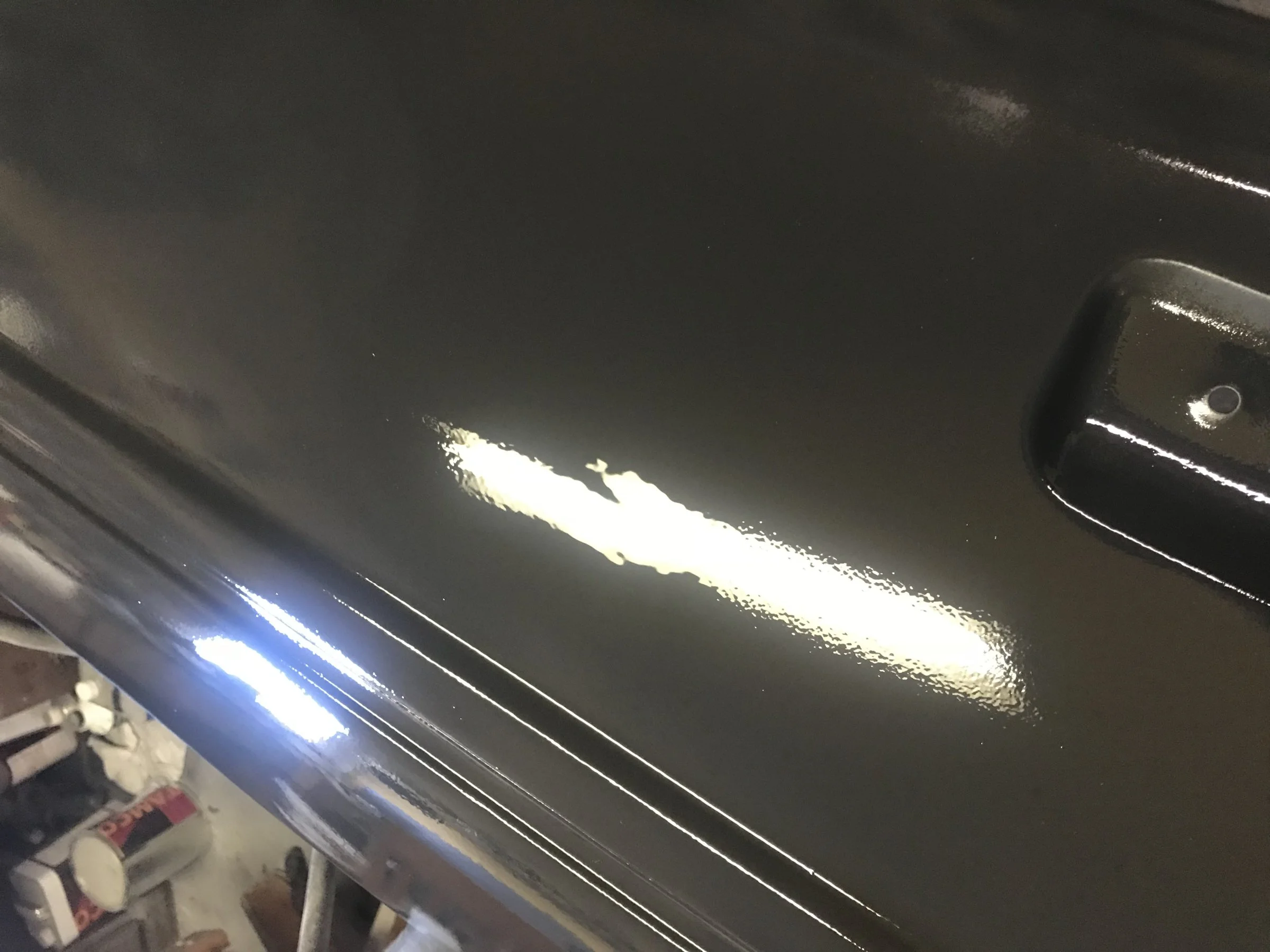

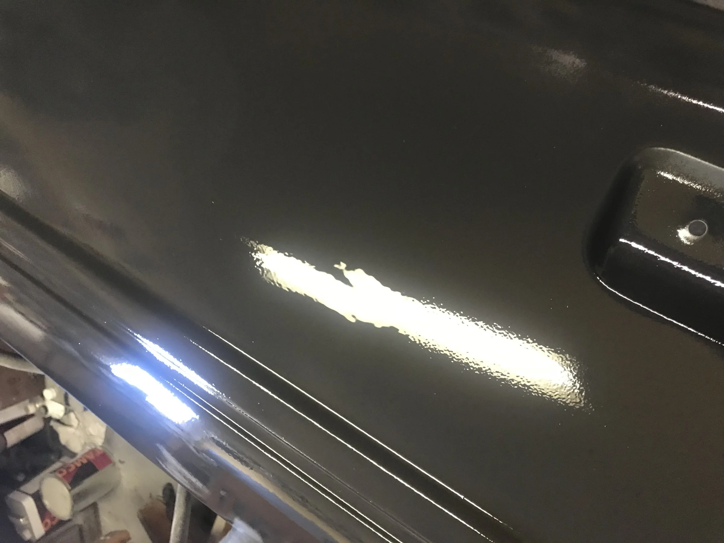

Is it just me or is this a serious case of Orange Peel?
Edit, yeah, I still have away to go till I’m real good at it. In that picture I had laid the primer kinda thick because of that low spot. I was hoping to build it up and block it out. It didn’t work. I ended up having to fill it regardless.
My first few coats of primer are always thick and have peel, but I’m focusing on build for blocking flat. Once it’s flat and I prime again i thin it out more and use a smaller tip gun that’ll lay smooth and sands easier.
You’ll have to pardon the dust in these pics. But the dry pic is a place where I had to do a spot prime. While not perfect, it’s much much smoother than when I heavy prime.
Used some wax and grease remover and the light to do a final check ( again, pardon the dust) for any low spots I may have missed. I think she’s about there.
