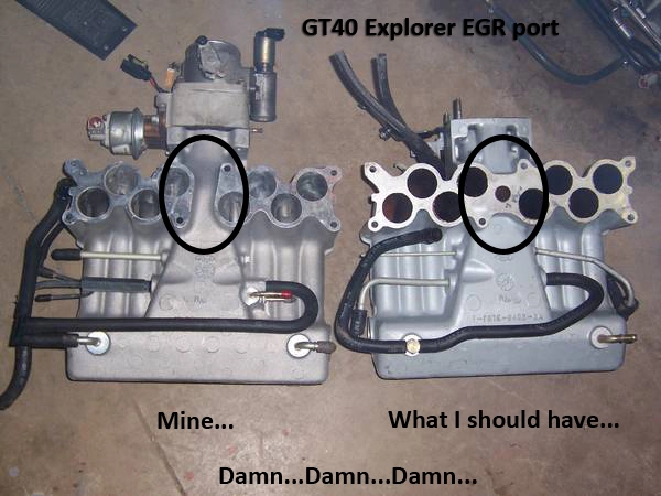

Starting to want to ditch the cobra intake. A tubular would be sweet, but I got more important things to worry about .
Reactions: A5literMan
I think a lot of people, including myself, think the Explorer intake is the most appealing intakes for our 5.0 when cleaned up real nice. So they try hard to make it work.
I agree. I've got a non-Chinese 93 cobra intake on my car but have always liked the Explorer, especially cleaned up and painted. When I saw one on CL for dirt cheap, I scooped it up. One of these days I may actually take my cobra intake off and put it on.

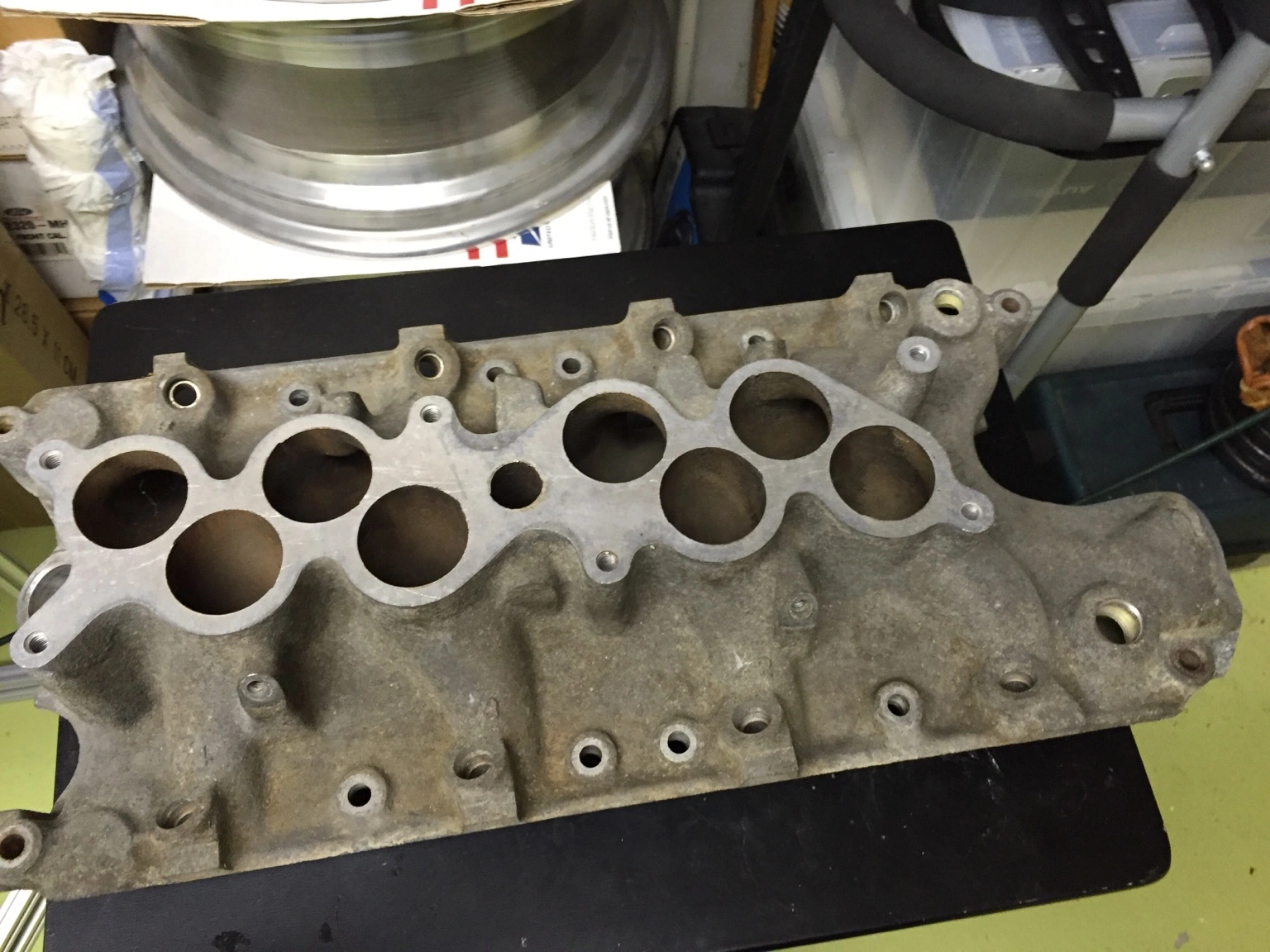

The lower is the same right? Cuz that could work. I'd need the egr thing right?

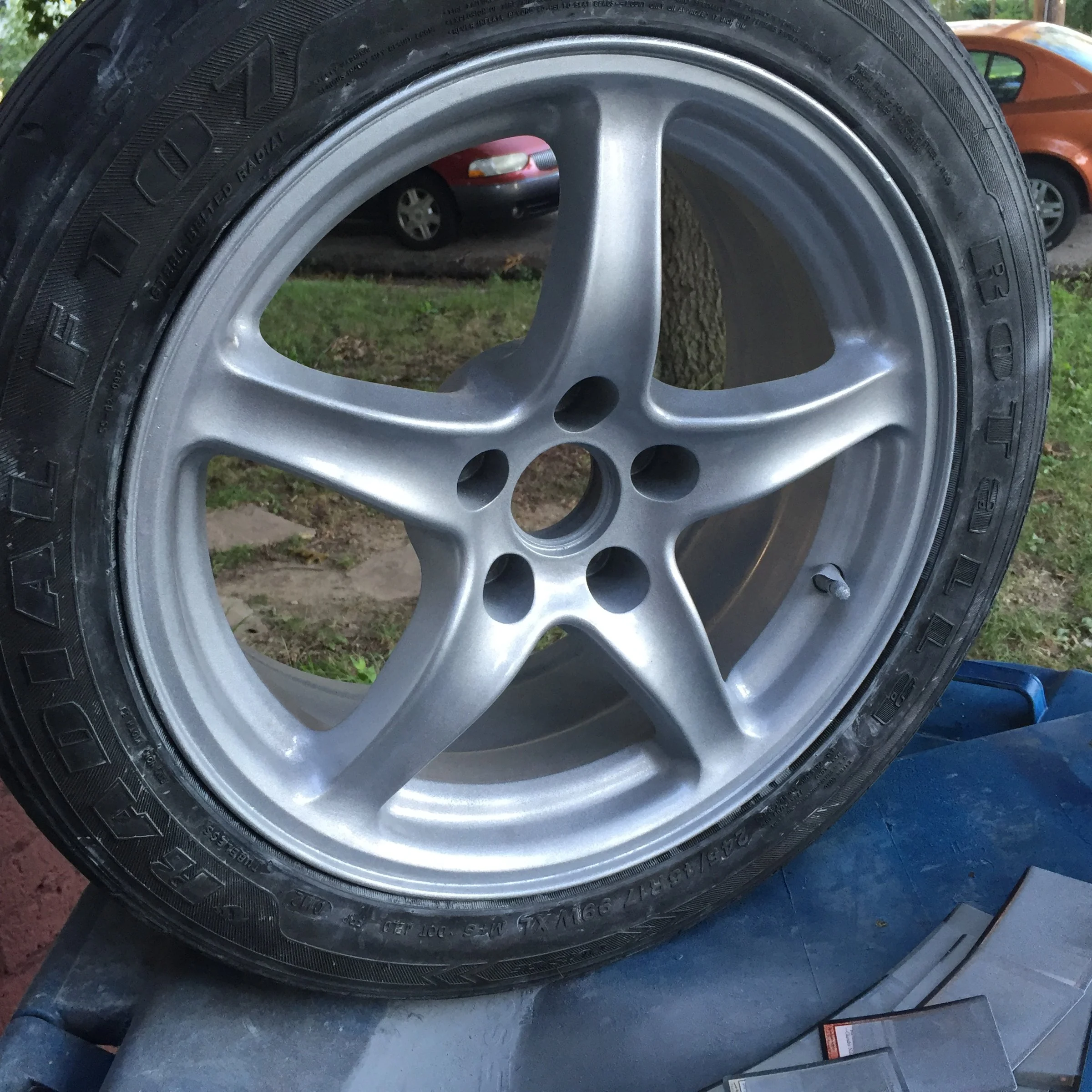

Finished painted the other 2 wheels tonight. Might add a bit more clear but we'll see. I did learn a neat trick, if the clear gets foggy, hit it with a heat gun and it clears right up.

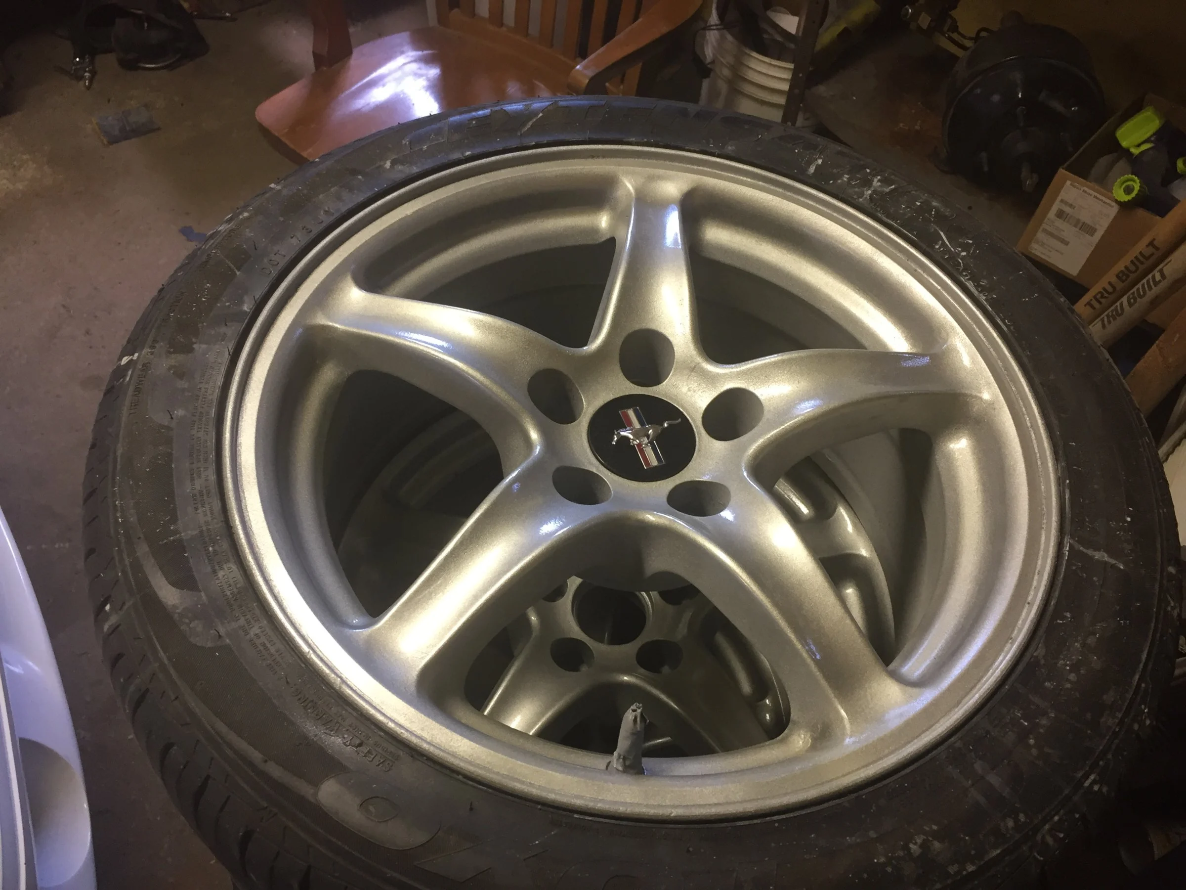

Gotta finish the kids play room and build the crib then I'll be free to do the 5 lug stuff.. As free as I can be once the baby is here. Just gotta paint the rear calipers and it's go time. Gonna drive it over the weekend before she goes down for the winter.

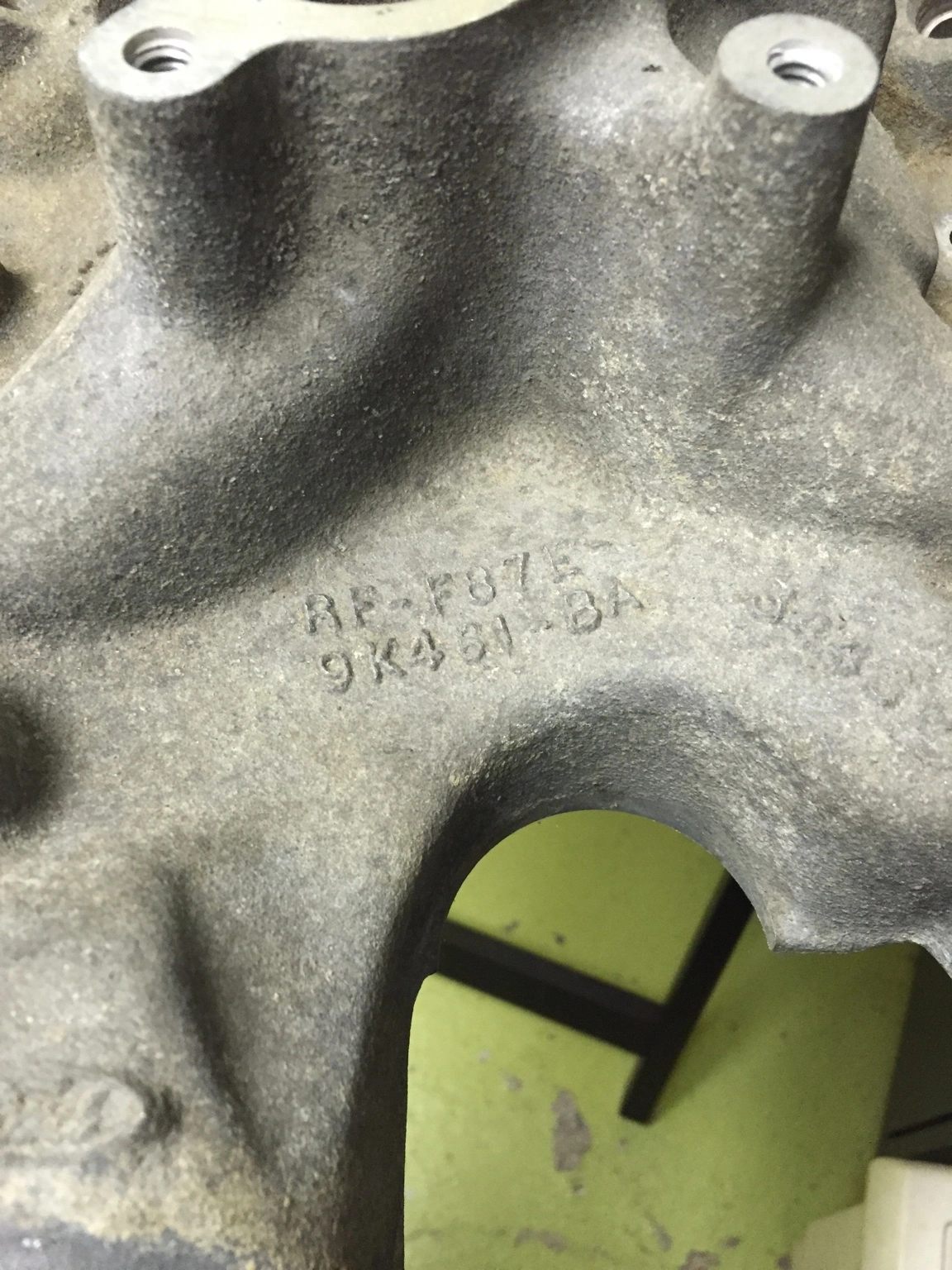

Early explorer intakes have the EGR, and the lower intake from those models is what comes in the ford racing cobra intake kit sold back in the day.
The only thing you need to do is tap for the act sensor.
Key is the part number. Egr lowers have a -BA suffix, while non egr is -BB

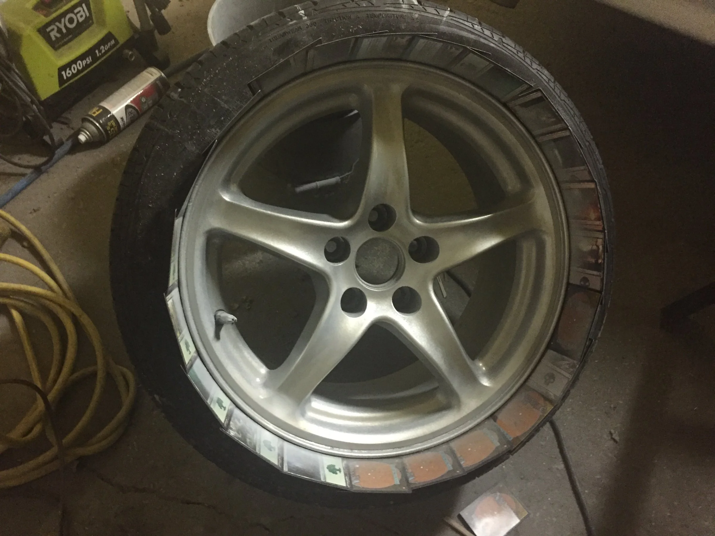

You used Magic cards!? [emoji33]

Yup, that's my neglected hobby. I have a box of junk cards, figured I'd get some use outta them.
Lol. I was trying to see what they were and I saw a bunch of land cards and some other things I couldn't decipher. I figured they were junk cards. I haven't played since high school.
The wheels came out great btw. [emoji106]
