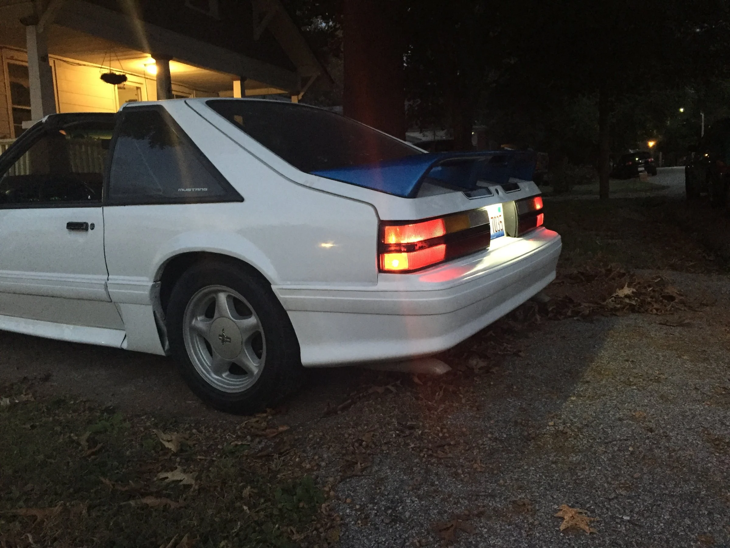

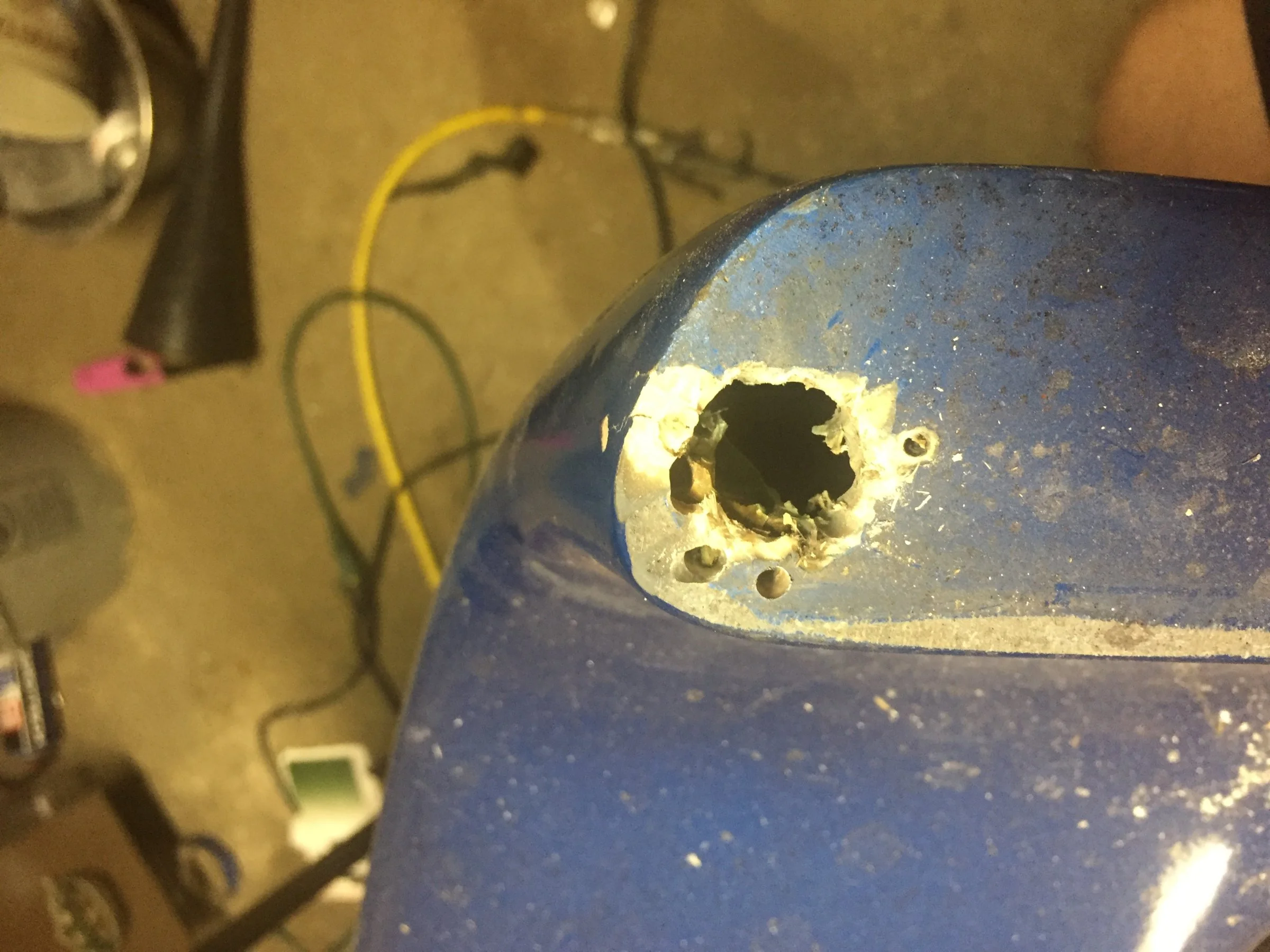

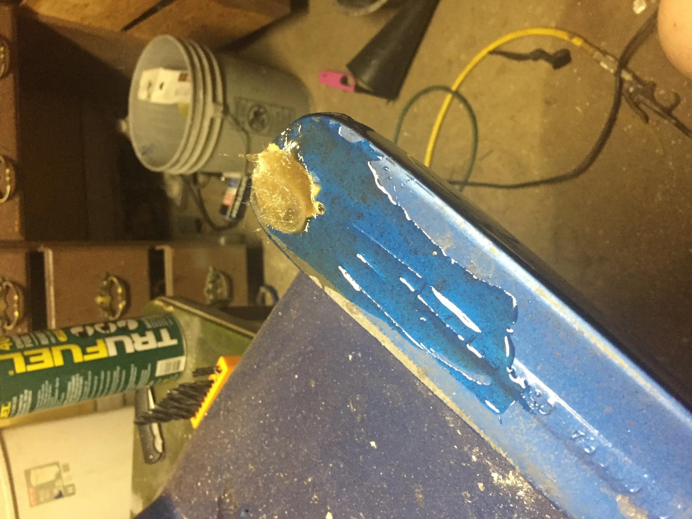

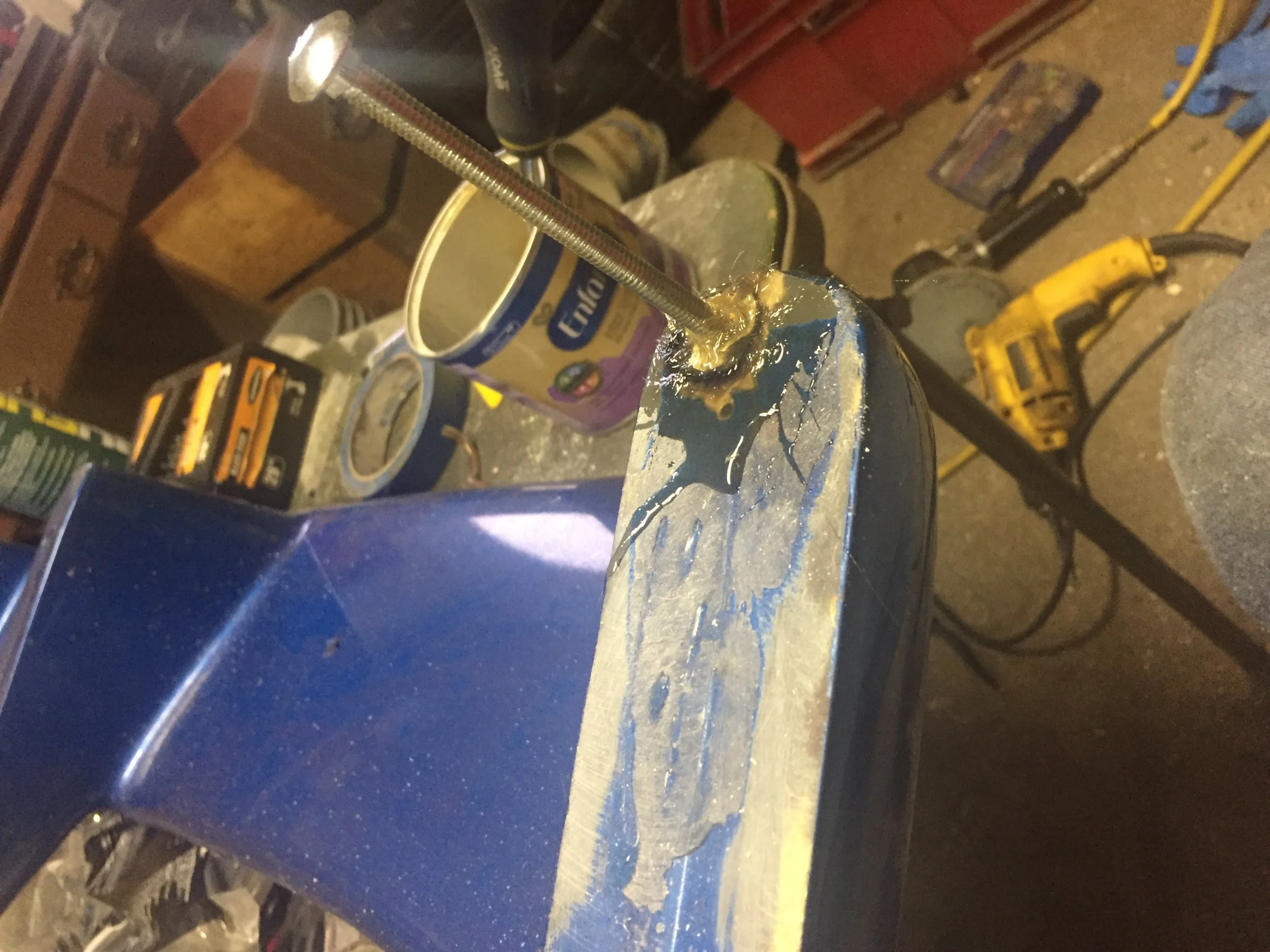

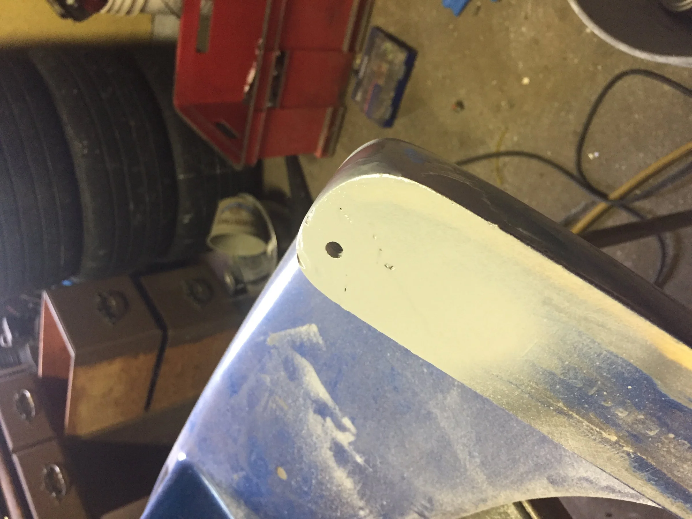

I decided to ditch the Saleen spoiler for a cobra. Found one local for trade. Only issue was a snapped off and rusted bolt.
So I got busy. Dug out the bad fitting, filled the hole with fiber glass, leveled and made a hole big enough for the new fittings, glasses it in ( big bolt to keep the threads clean) , knocked it down again, minor blocking to get the corners back. Next week my buddy will weld the extra holes shut and that'll be it for body work for now. After that I'll start the 5 lug disc swap.

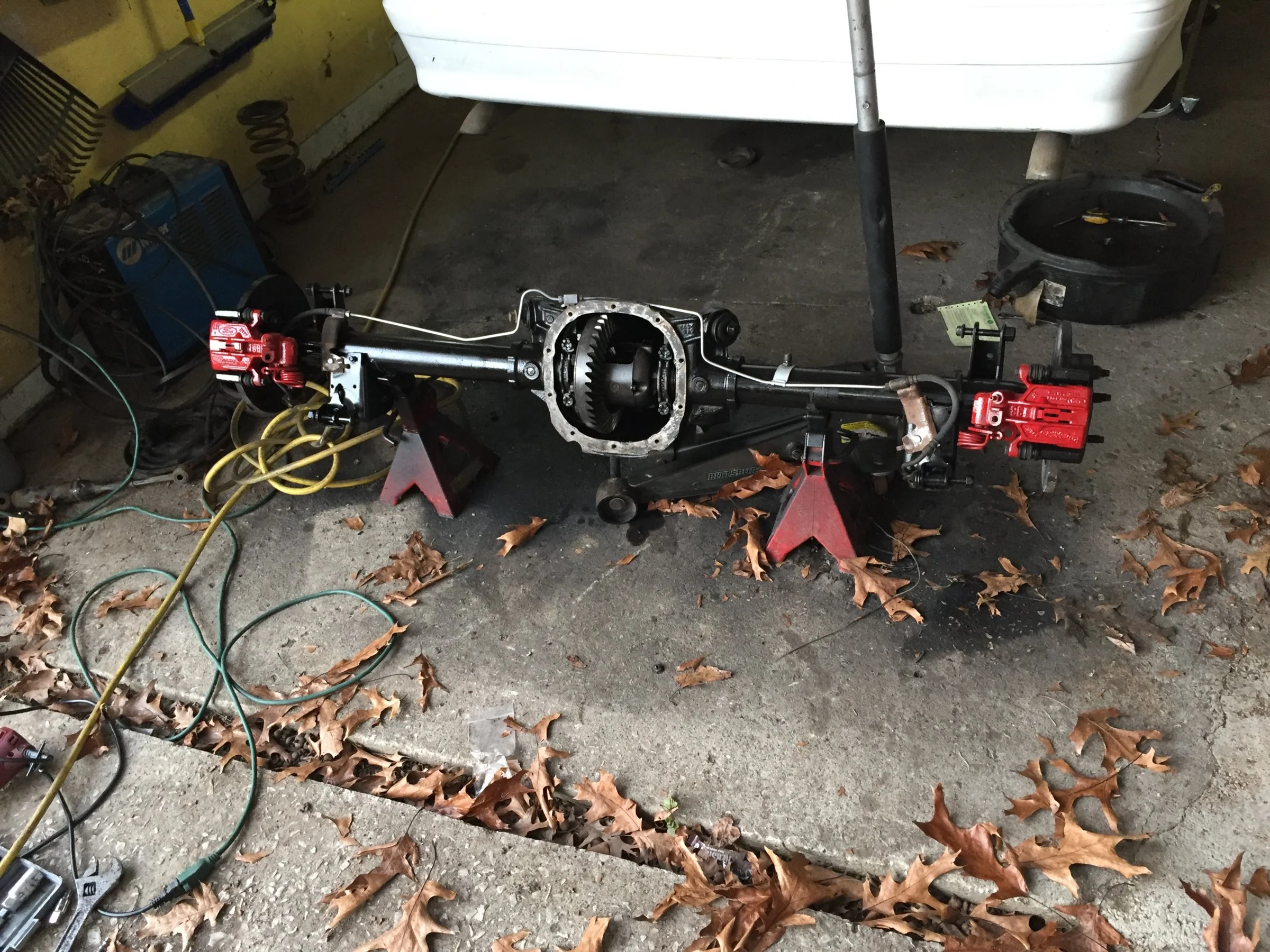

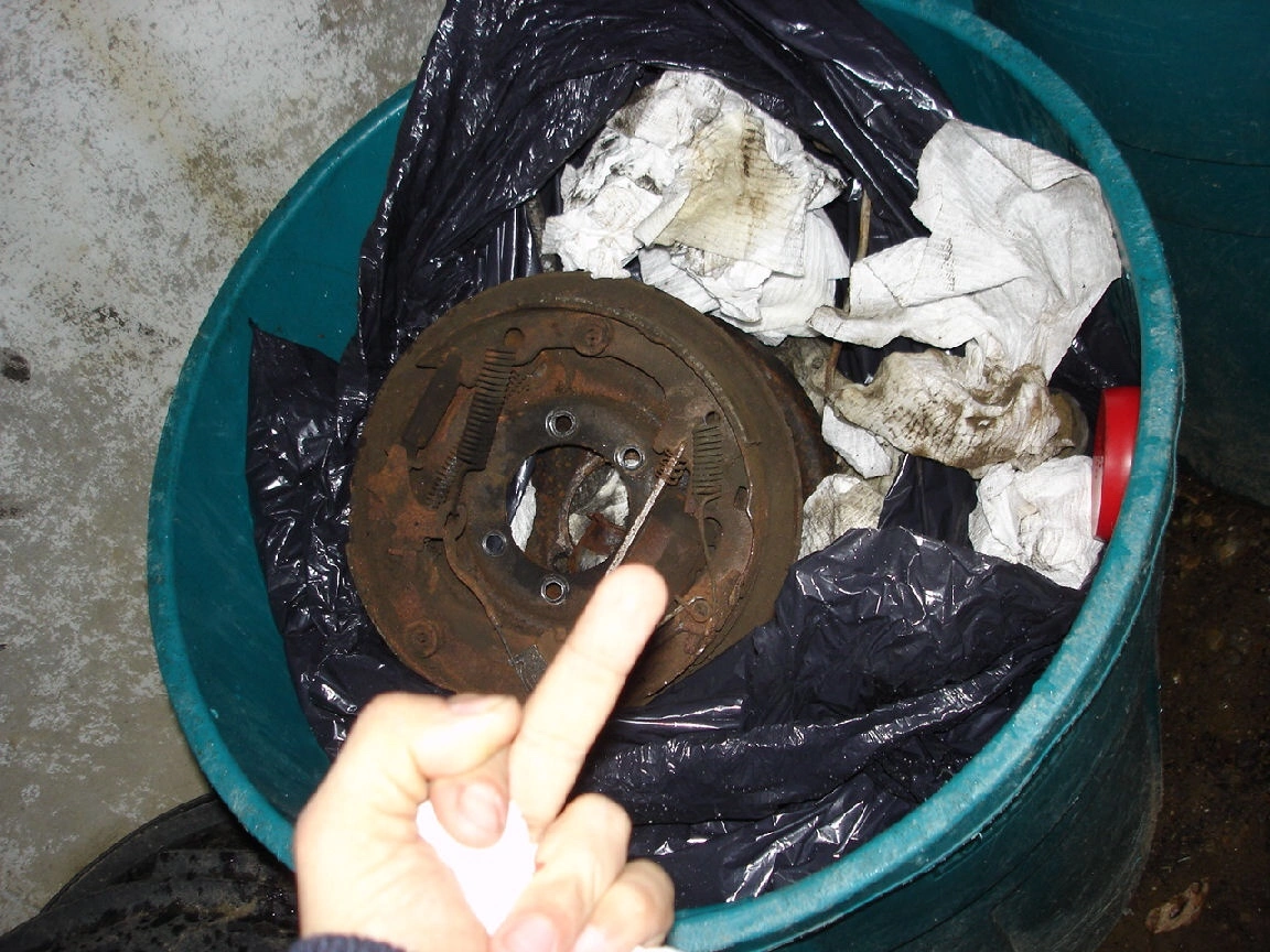

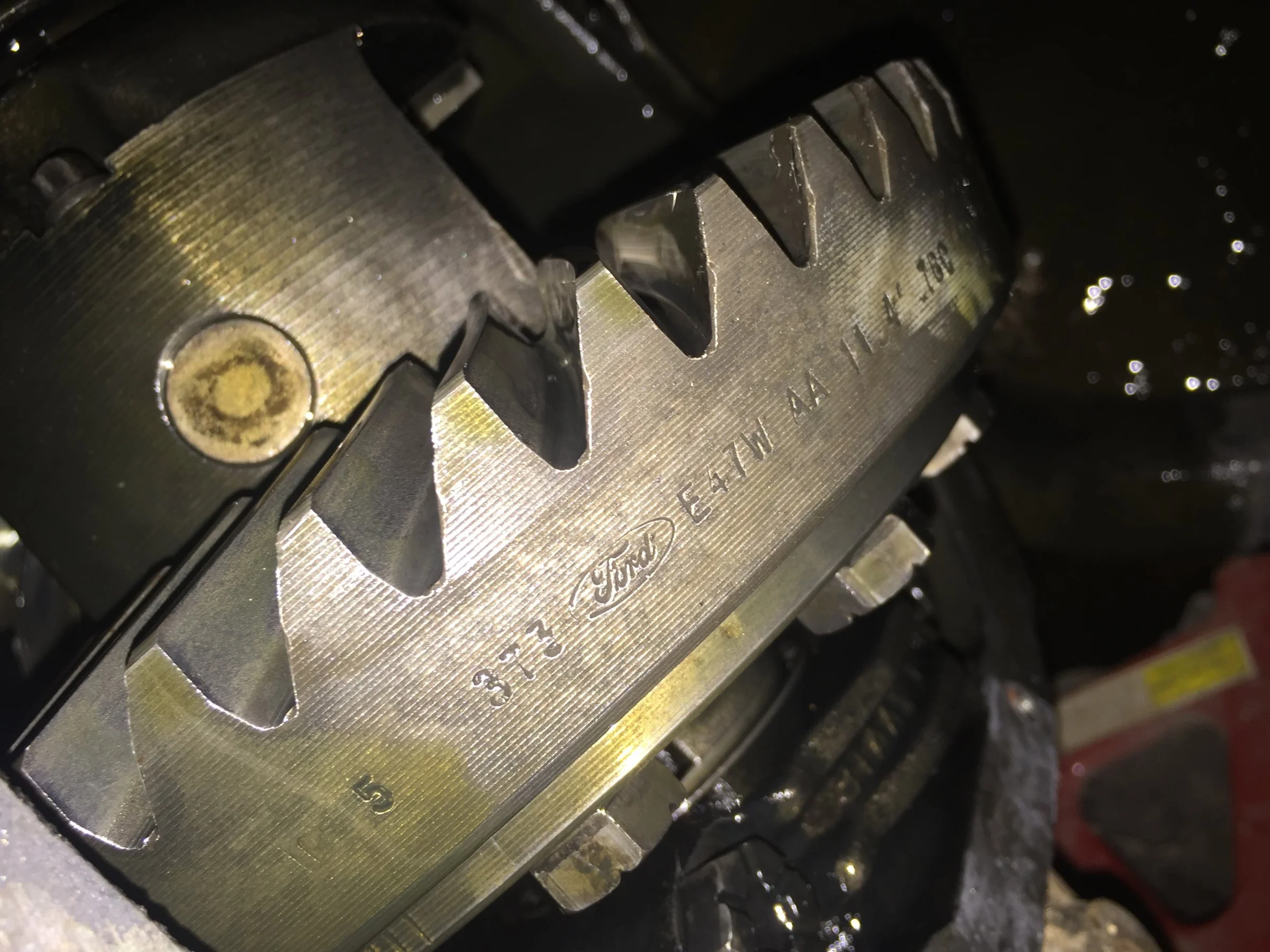

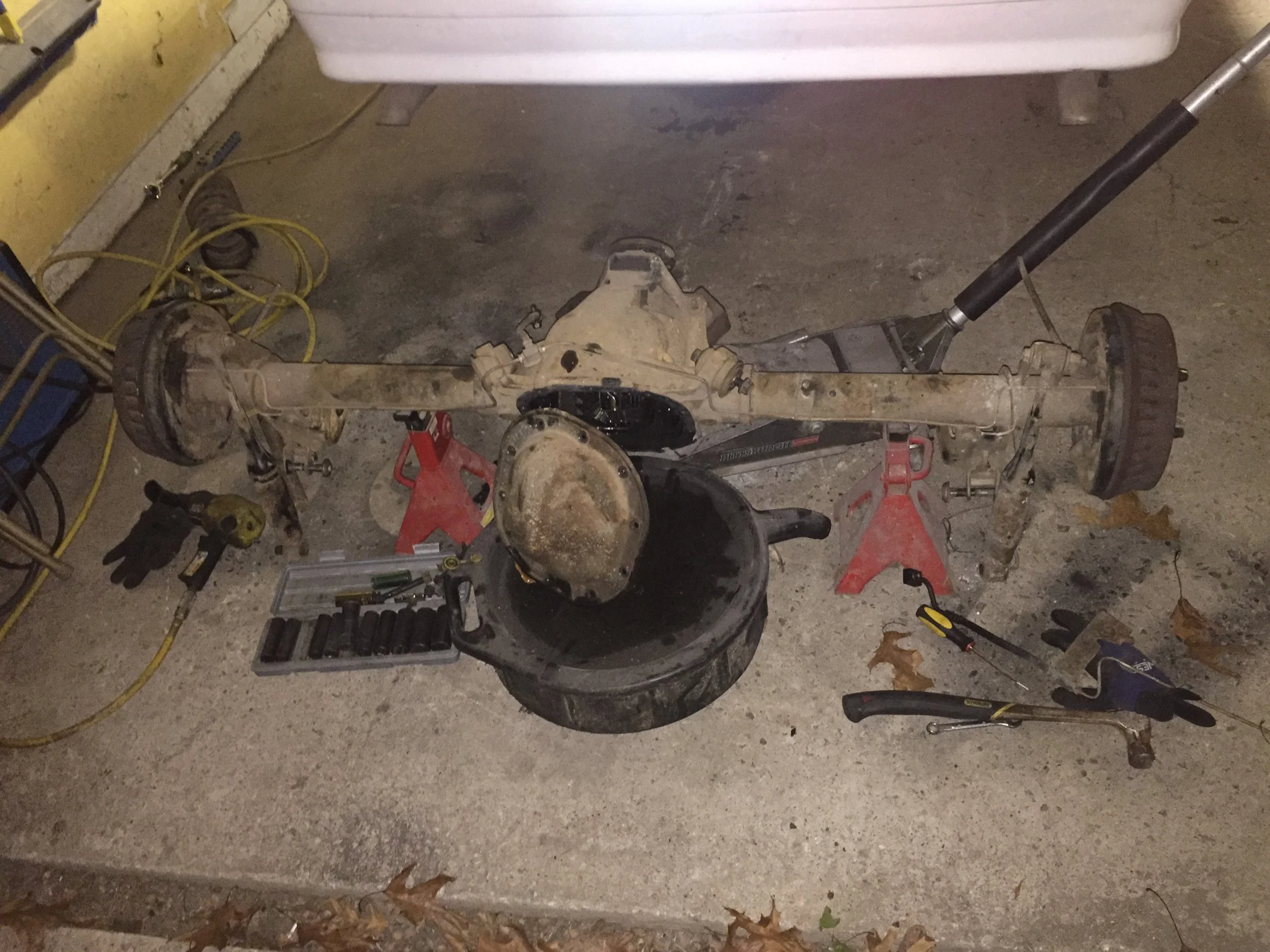

Ok, decided to get the hands dirty and start the 5 lug. Got the rear pulled and drained and confirmed the gears. Gonna start getting it ready for paint and tear down.
Really not sure what order I should do it in.
Maybe pull the drums, install axles , put the cover back on. Pressure wash /wire wheel, paint, then install the disc.
Is the differential and pinion gear still in the pumpkin? Then i'd do just what you said.
Ok, we have 5 lugs and discs.
Gonna try to start on the parking brake and get the cables ran before I get the rear back under it. But so far so good.
Side note, removing the drums without having to care was about the best feeling ever.
