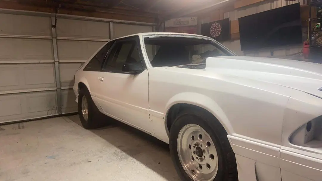

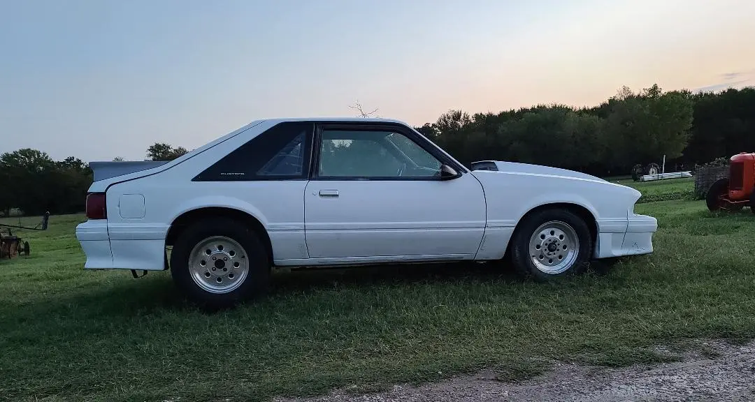

If there is a "members build" section in here, please relocate.
Just beginning this build. Little rough to start, but gonna have a good time with the process! That steering column and wheel are not staying.

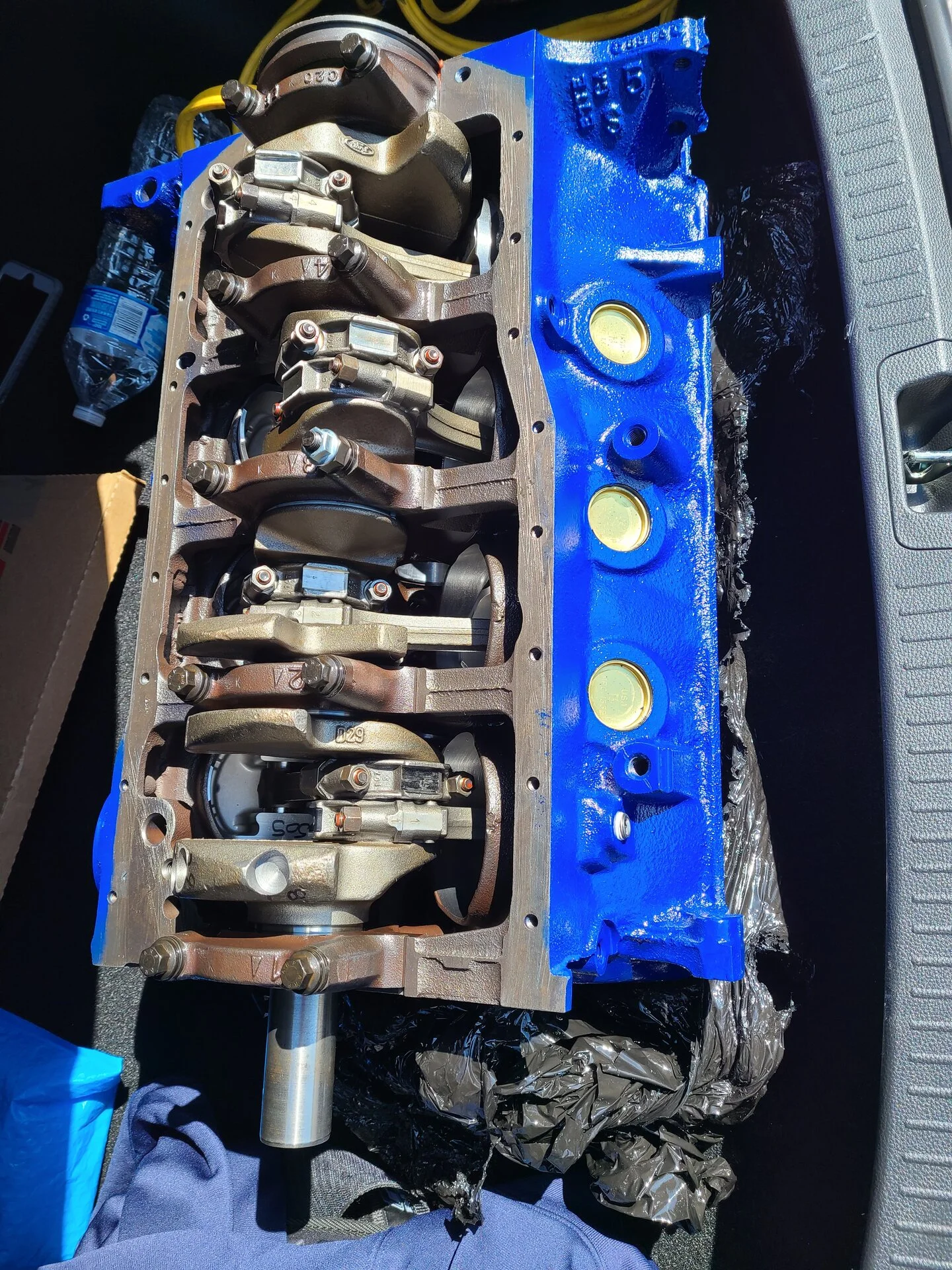

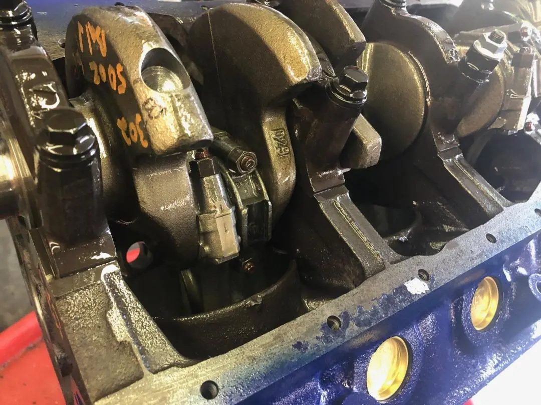

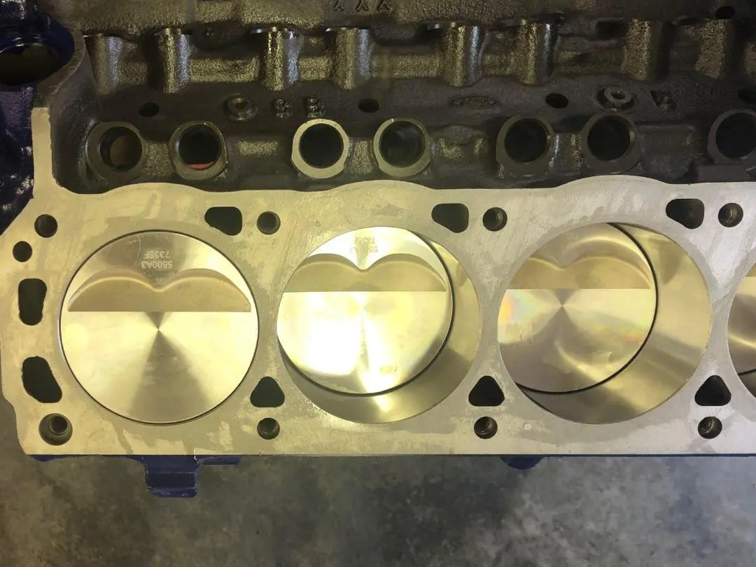

Have a short block 306 from Creb Engineering on the way. Parts I have ready for it= TW 170 61cc heads, F303 cam, 1.6 TW rockers, RPM Performer intake, Holley Super Sniper EFI, On3 70mm kit, C4 with 9" converter. Rear has 3.73s.

Looks like a cool little project . Heads are 61cc chambers . Not “ 61 mm”
if you didn’t buy the super sniper yet I suggest buying an hp or atleast a terminator x and putting port injection on the car with the turbo setup . If not I’d just do a CSU blow through carb if you don’t want to go through all that .

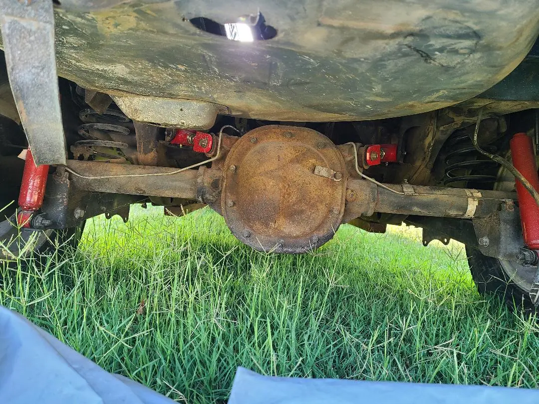

Also 3.73 may be a little too much gear for it depending on the tire size .
Didnt even notice the mm, all fixed. Will probably be going taller on tire, well, as tall as I can get to fit. Yes, already have the Sniper. Im sure there will be a lot of trial and error, some changes from original game plan as well.

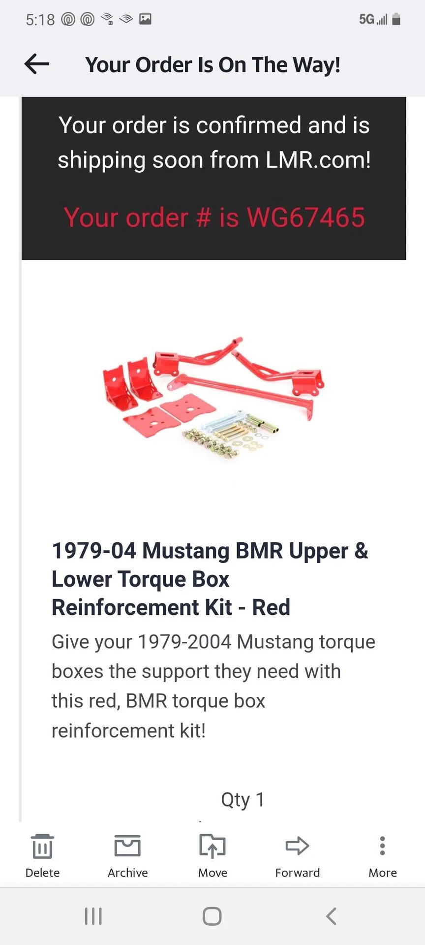

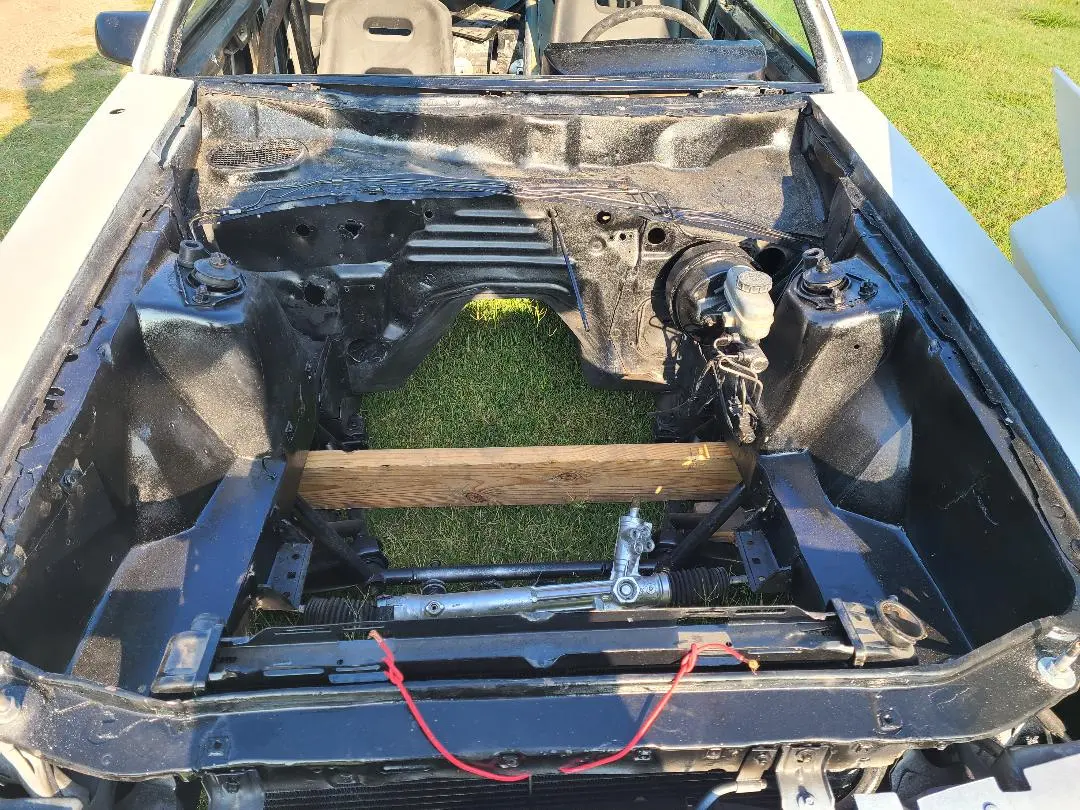

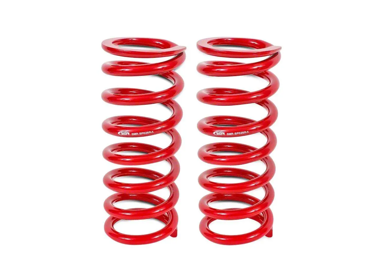

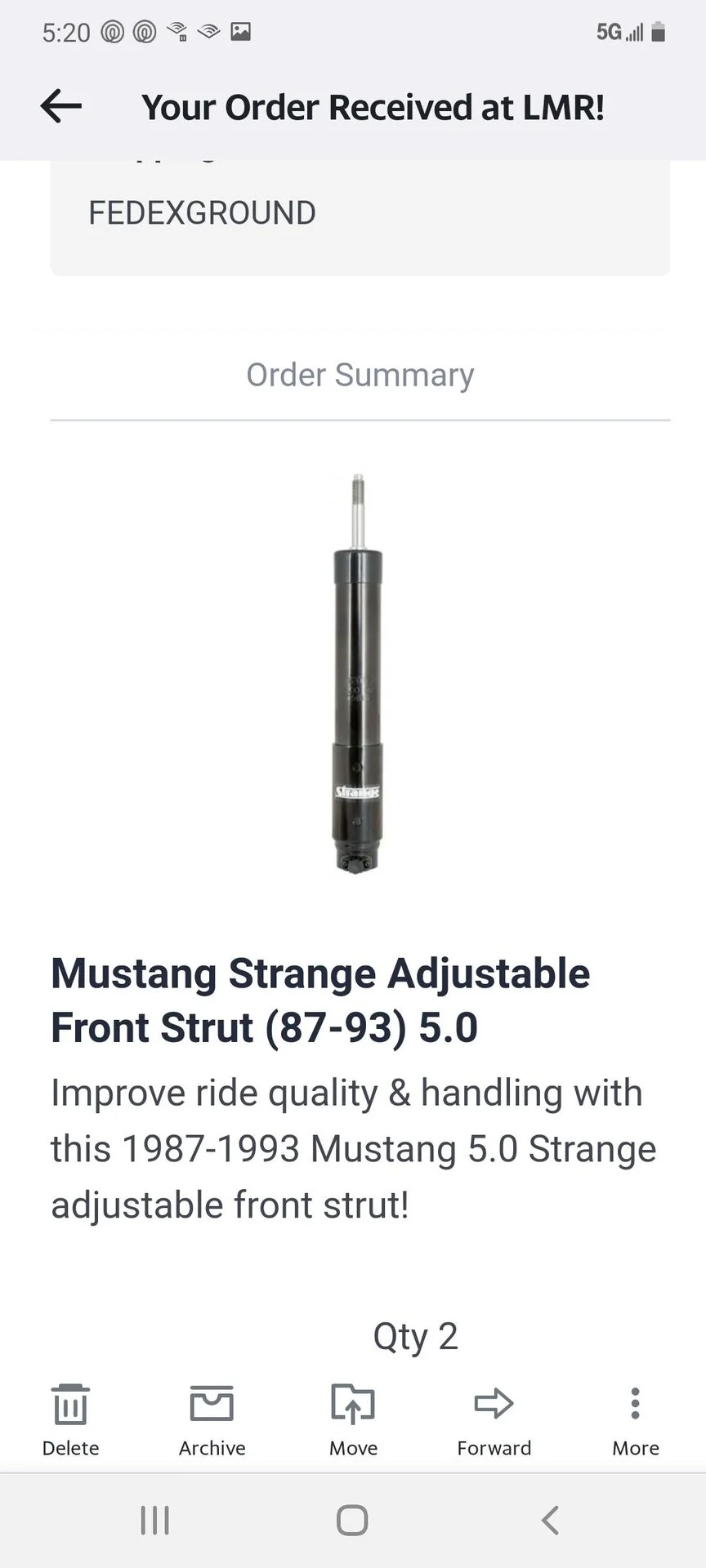

Sending her to fab shop Wednesday to have the torque box reinforcements, front springs and struts put in. Going to begin looking at upgrading to 31 spline and c-clip eliminator set up. Whats the recommendations on these, sticking with stock 8.8.
