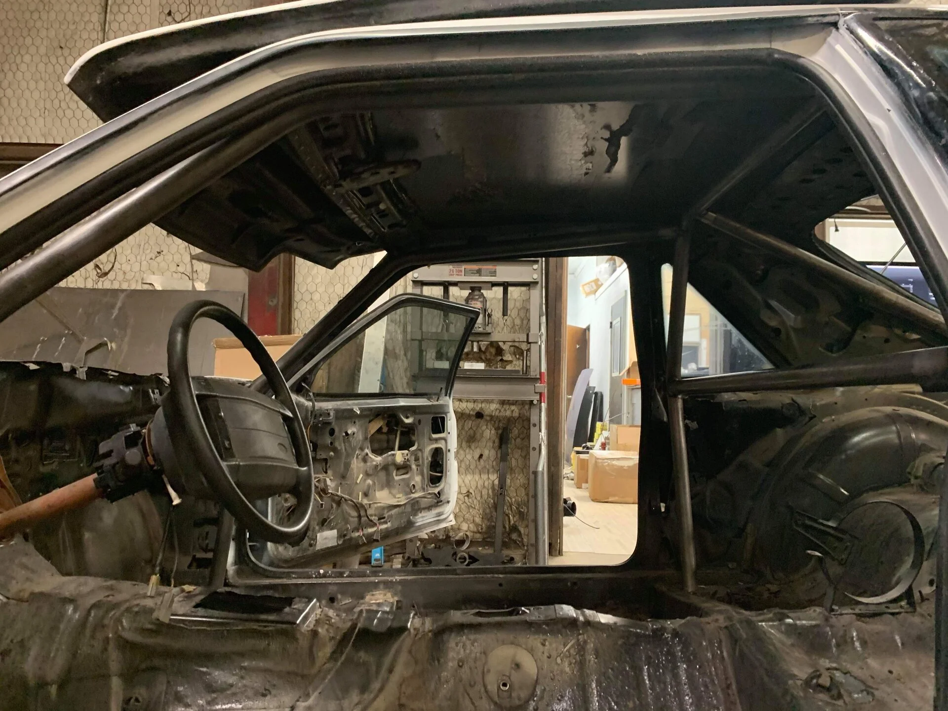

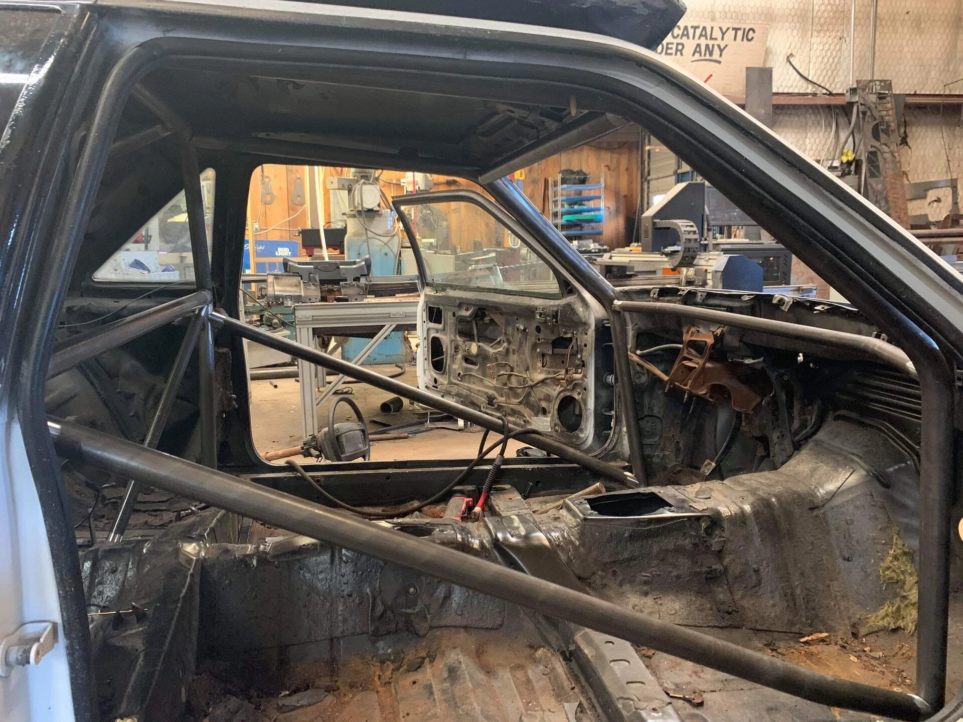

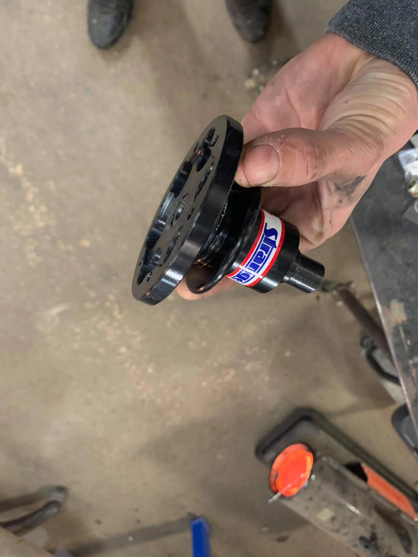

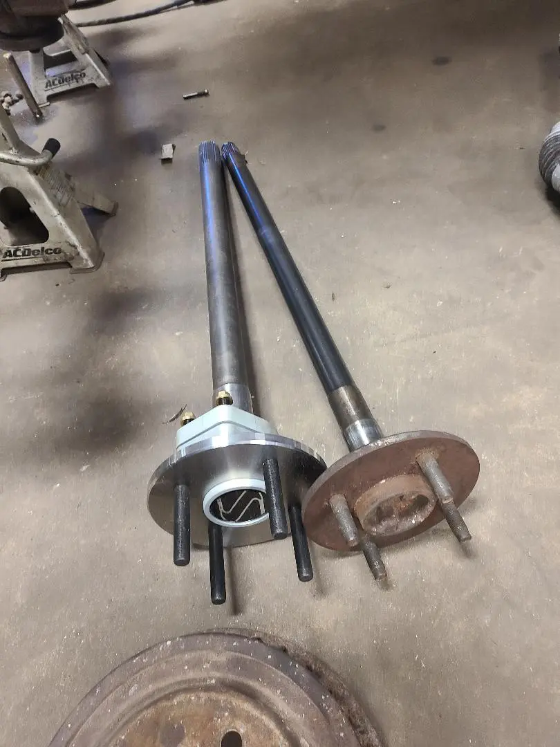

Found crappy workmanship on the cage, so having it removed and a new chromoly cage built. Just ordered the 35 spline Strange axles with c-clip eliminators and full spool. Trying to be patient and get all the suspension and structural reinforcements done before getting motor put together and installed, but very anxious to hear her run..... But, im going to take time and have everything done right. Goal is to have the car be capable of 600+ hp by time we install drivetrain. Then when I have an after market block built, the car will be able to handle the power, and wont have to go back and redo anything.

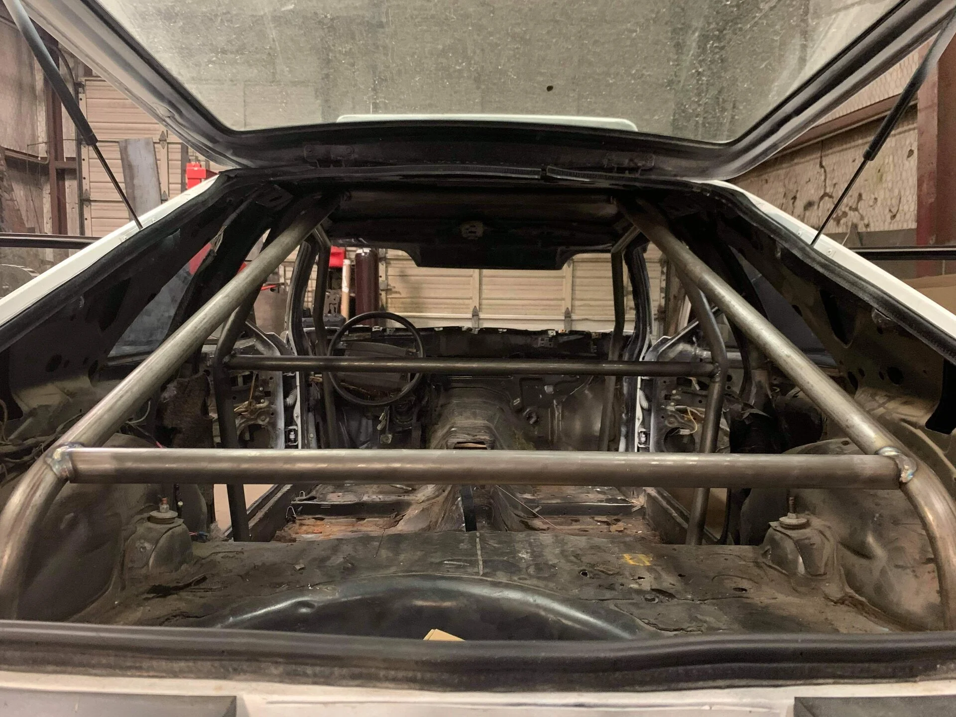

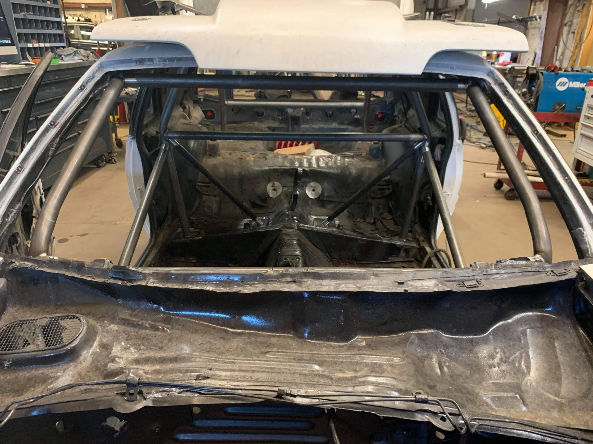

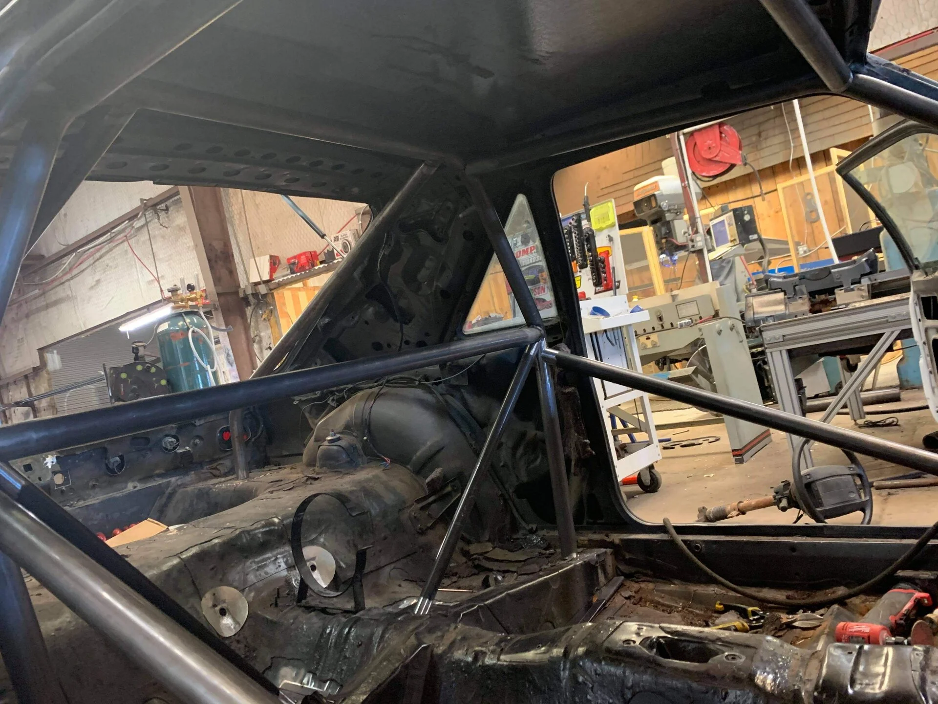

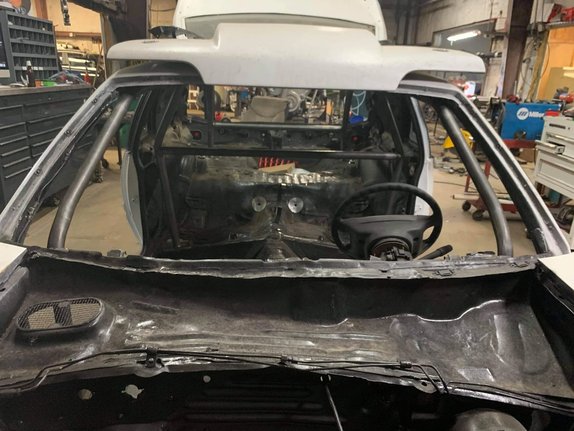

8.5 cert cage is about done. Having quick release steering column fabbed up today.

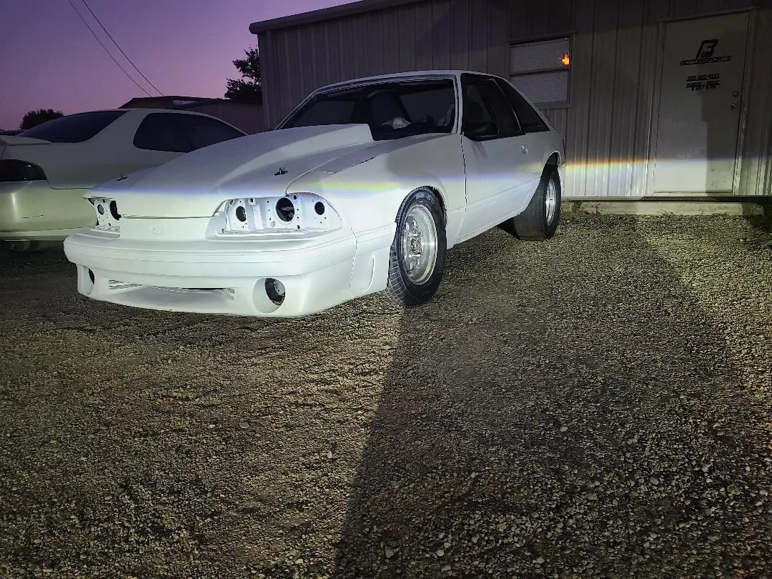

Funny to think about it, but the '93 Reef is actually a higher horsepower build then this one, but this one will be set up strictly for strip. Going to see if my 15yr old wants to race this one. He rode with me in 1/8th in my '77 383 Camaro strip car I had, and enjoyed it.

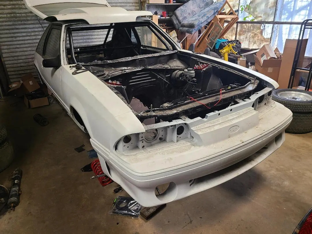

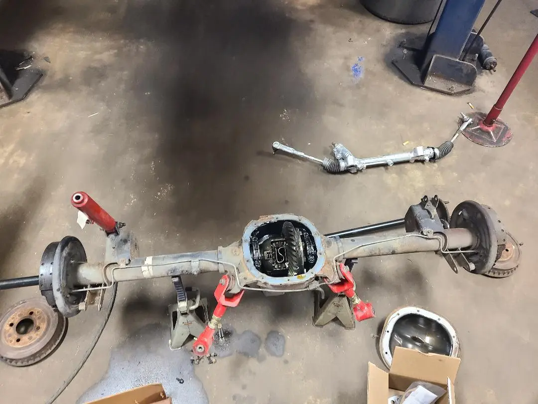

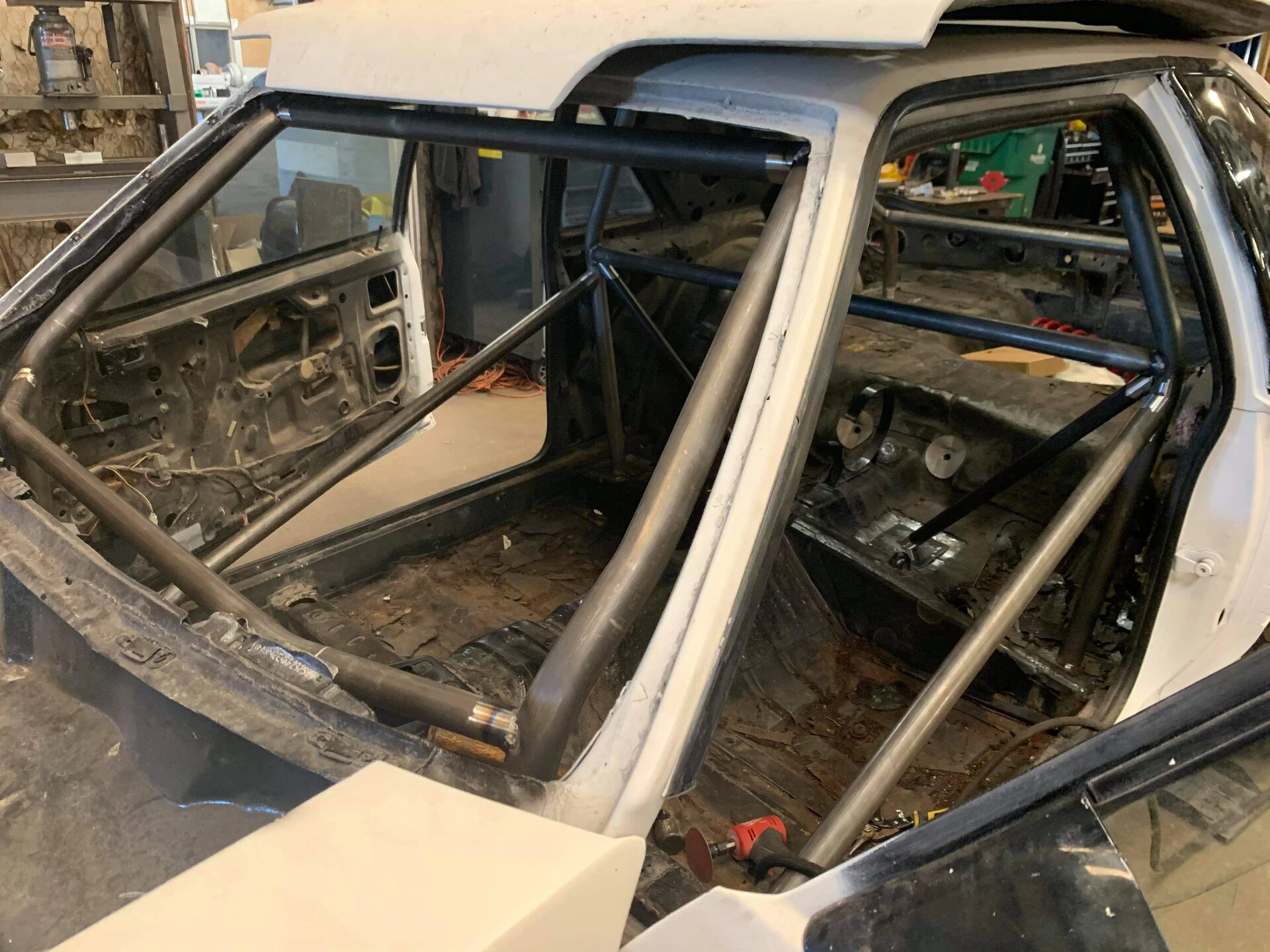

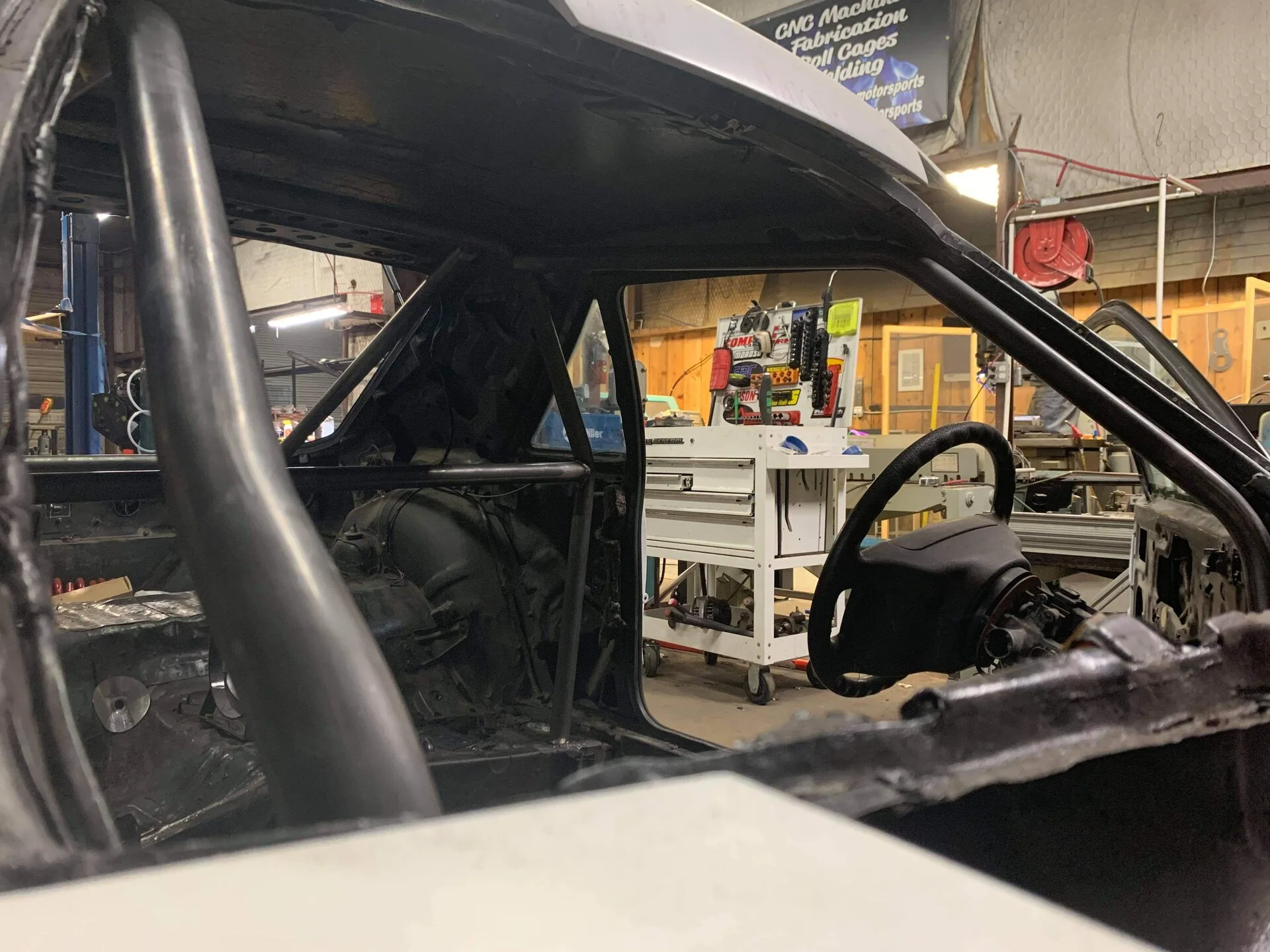

Cage is all done now. The axles are getting ready to go in along with the spool. Ends up we are going to have to go with a coil over set up on the front. The kit should be in tomorrow. Now I have these BMR lowering springs that can not be used. Haven't hit too many road bumps yet, so feeling pretty good about the build. Oh, and got awesome news the other day, the drag strip that is 2 miles from my house is about to reopen. It has been closed down the last few years!!
