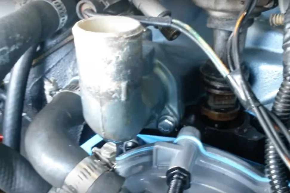

I guess I've just never paid it much attention but I don't seem to have trouble with the lower bolt. And I have giant hands that fit nowhere!! Maybe long fingers help but I've always threaded it in with two fingers then tightened with a wrench. Here's a pic. The bolt is wide open to me. Or either I'm missing something. Now is it as easy as taking the battery cable off? No. But it's not on my list of difficult bolts. One other thing I am fanatical about is cleaning bolts and threads. I never reuse a fastener without cleaning the threads on a wire wheel. I also chase the threads in the bolt hole. It's just a habit I got into years ago and it makes things go back together much better.

I appreciate your input, but this distributor doesn't have a TFI module that blocks a great deal of access to that area. The flex sockets solved a lot of the access issue though.
Yeah I just used the pic to show the bolt. My cars an '88 with the TFI. A regular wrench has always worked fine for me.
