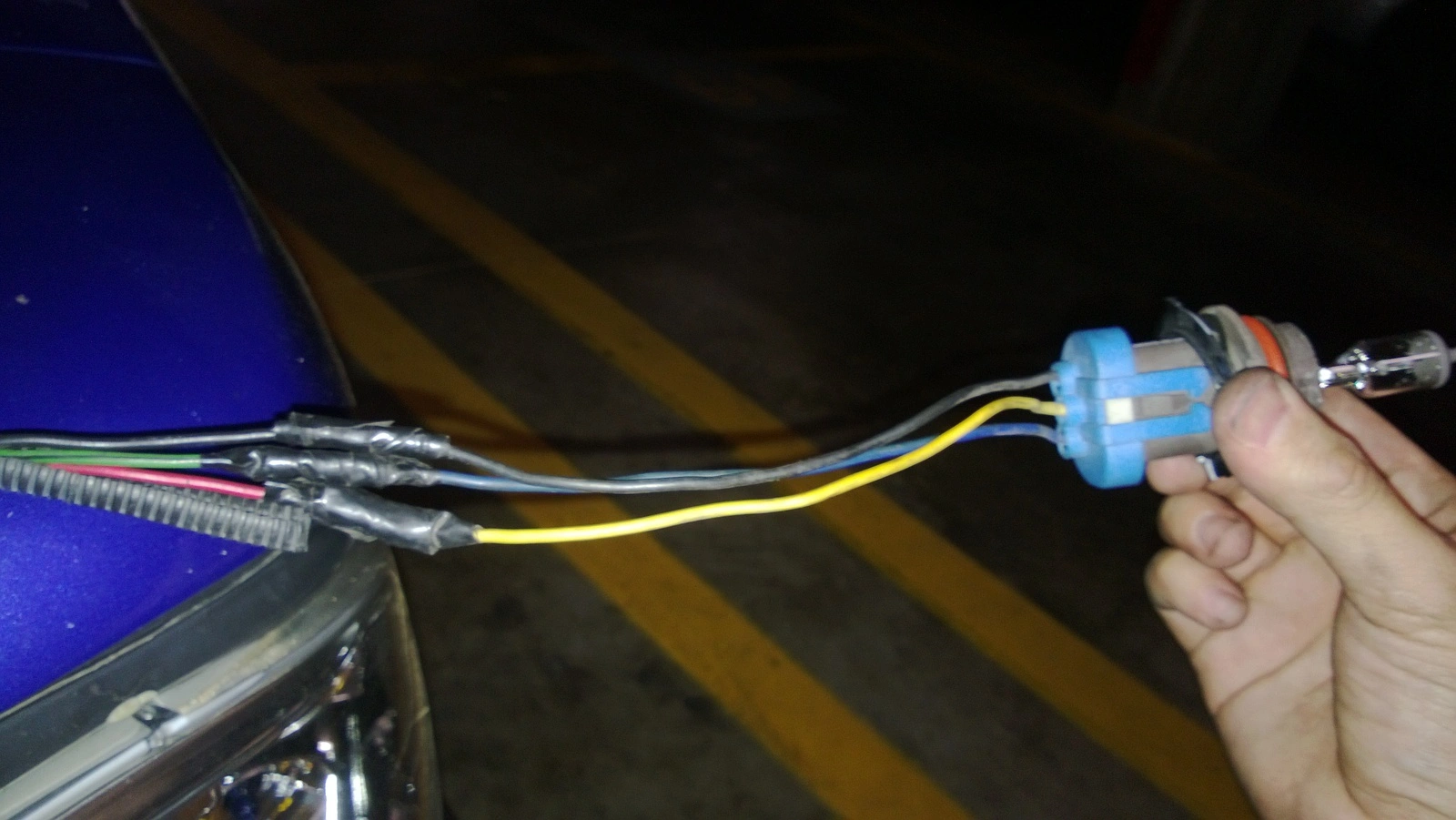

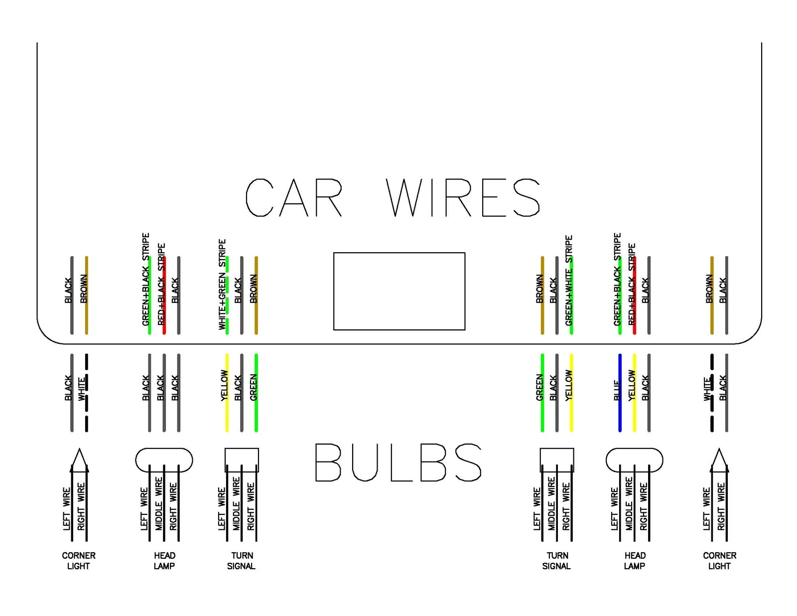

89 MUSTANG headlight wiring question. Hello everyone my headlights are all messed up, the high beams don't work and the regular beams are dim. I have searched the forum but I haven't found an answer.I put together this little diagram to show what i have.
Basically my question is.
What color wire connects to the middle wire for the head light bulb ?
What color wire connects to the left wire of the turn signal bulb ?
I was wondering i someone could take a quick look at their working lights and tell me the correct order before I start hacking away.
Thank you
