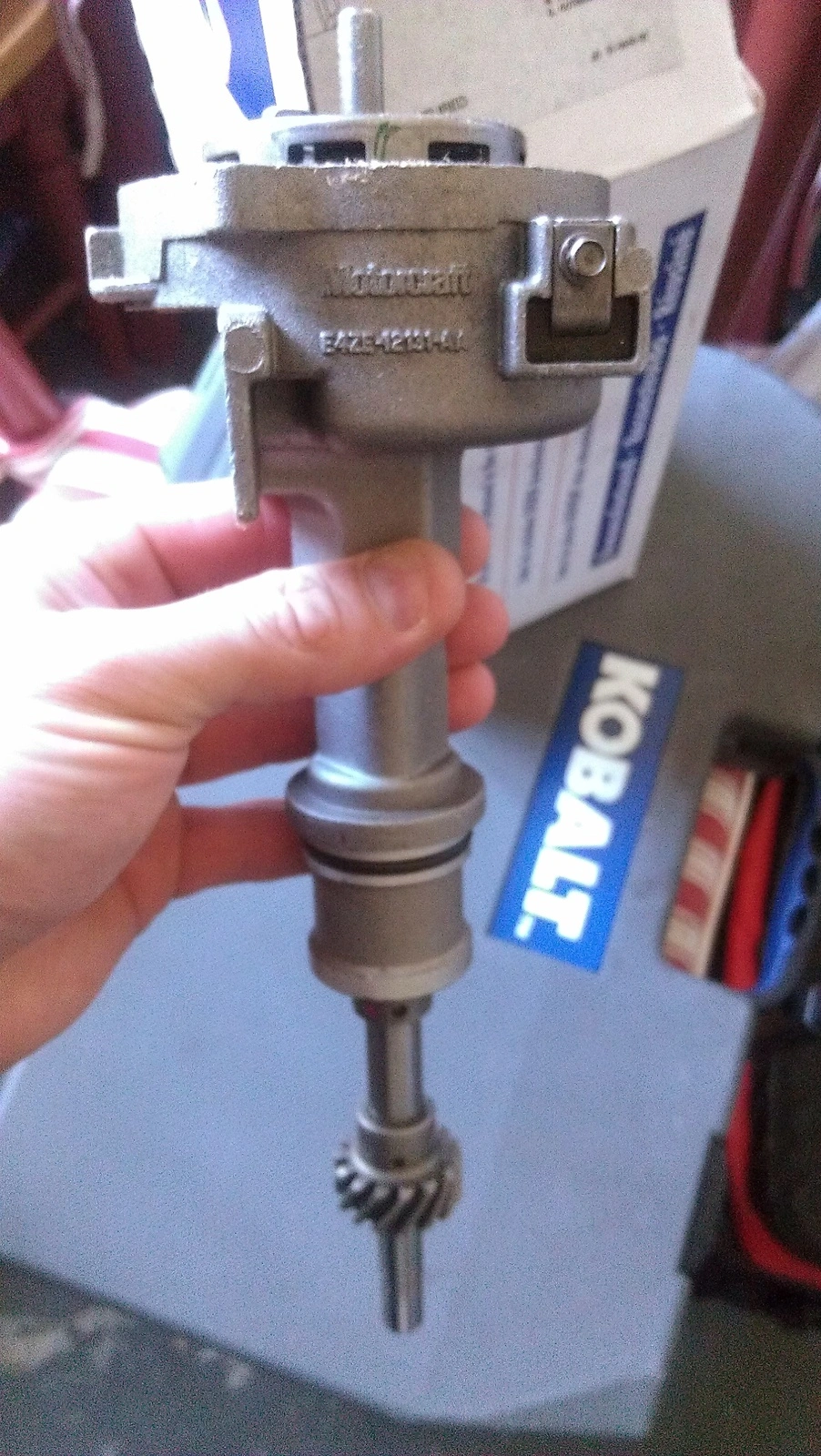

Go to napa, I bought a remanufactured Ford Motor Company one from them. You can get it without the module, just add your module to it, it was around $90-$110. I have it as a spare in my trunk right now, my mechanic swapped a used one so I just left it, the gear was perfect shape so I just left it.

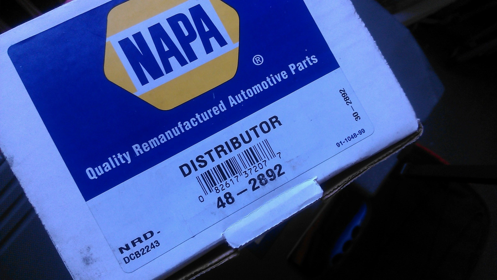

It was under another name when they looked it up but when they brought it to me I was pleasantly surprised, just get them to bring a few to you and see what kind they are.

Wait I will go take a pic of the part number and box, hold on.

Believe its under the Napa brand...
Awesome! Thanks
I've never replaced a dizzy before so forgive me if this is a stupid question.
I'm assuming that I will need to transfer over the top portion of the old dizzy (cap..etc)
Next question...do I need cast iron or steel gear? As far as I know it's the stock cam
